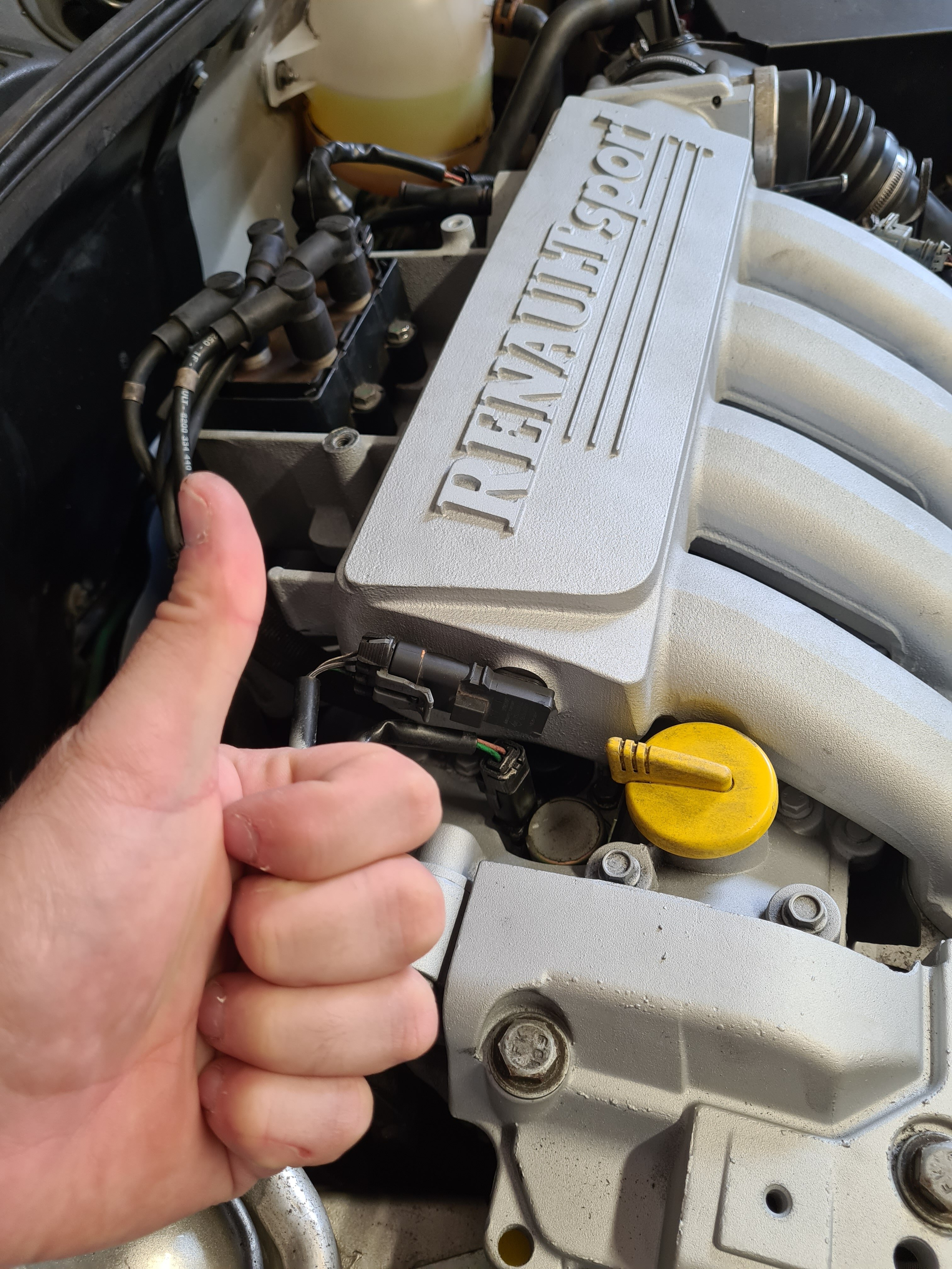

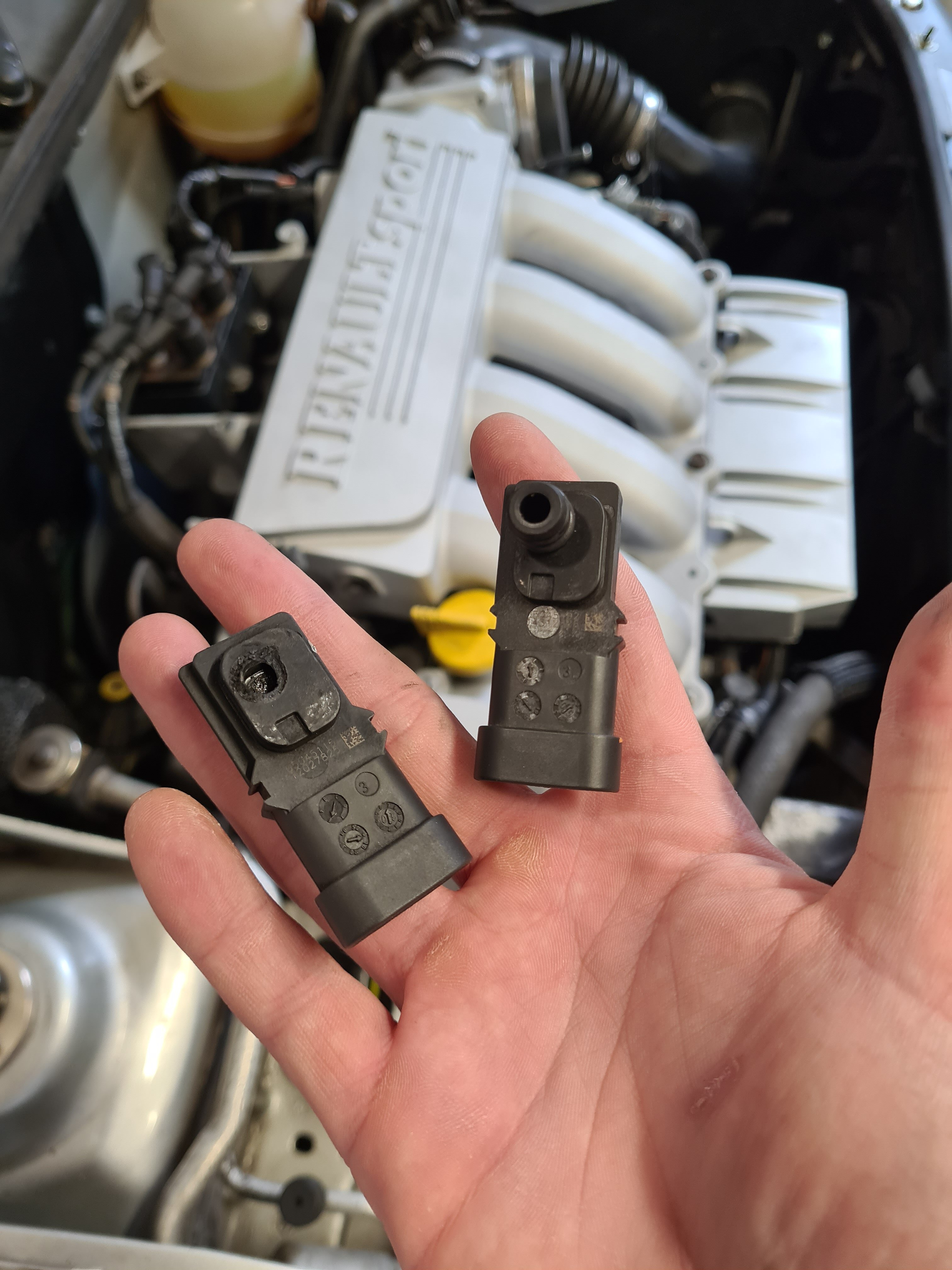

During the refresh of the engine bay I snapped the MAP sensor. A call out on here and @Louis came to my rescue and offered me a MAP sensor, I just had to cover postage. I gave him some beer tokens too and it was on its way to me.
Damaged sensor vs the one Louis provided.
In and the engine fired in to life and after a little while the idle settled nicely.
Thanks again to @Louis for sorting me out.

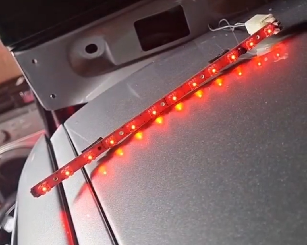

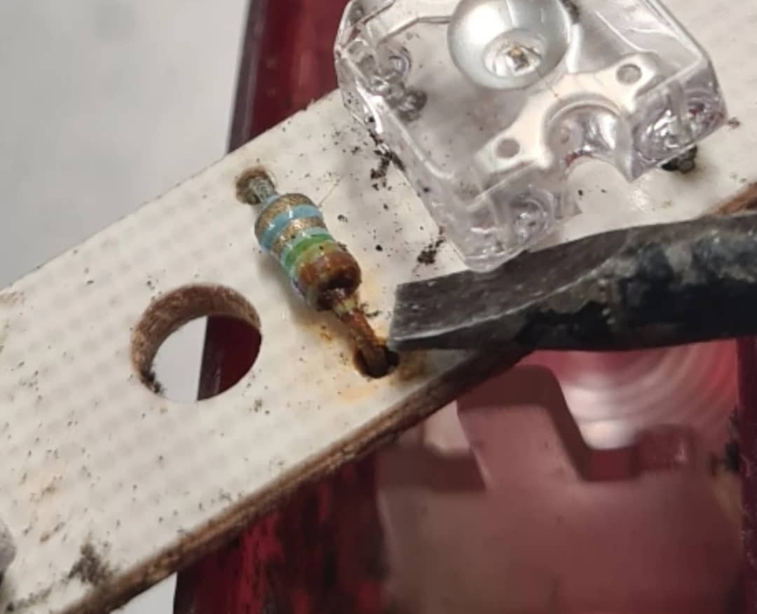

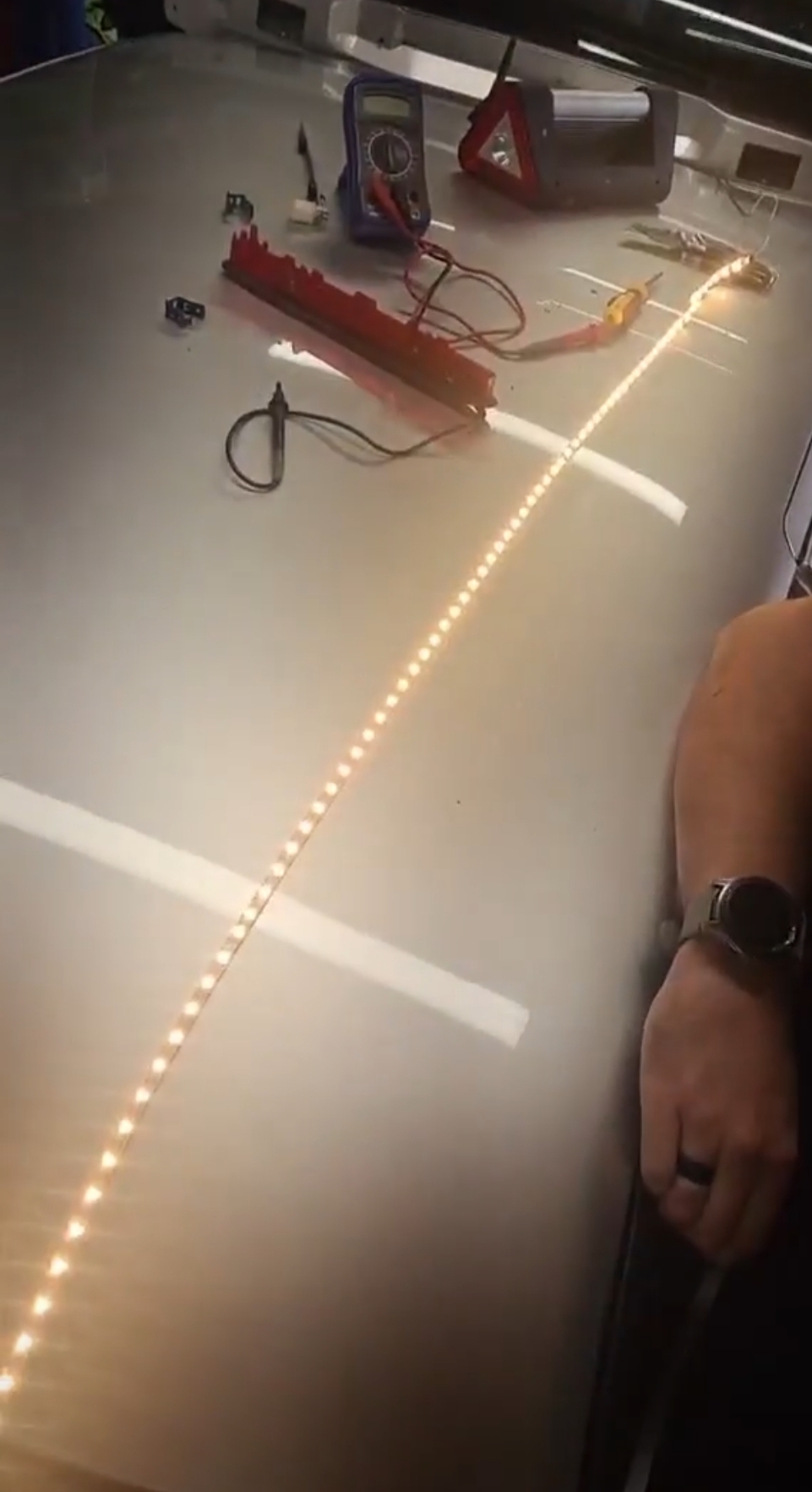

A little while back I lost the third brake light, I've no idea how. We'll, I have an idea and it involves my own stupidity.
Anyway. I did some deep investigation, taking the spoiler off, brake light out and the circuit board off the back.
Just to test if I had an actual feed to the brake light wiring I plumbed in some Christmas LEDS.
Which to my delight worked. So I knew the issue was with the light and not the wiring. I did contemplate cutting the LEDS down and putting them in the brake light housing, I mean of it works right?
I took my attention back to the renault brake light.
This little crispy bugger was barely connected so I ripped that off. Doesn't work so what do I have to lose?
I don't know what that Resistor did but it isn't needed it seems.
All back together and I have a working 3rd brake light.

Btw, that resistor is needed to a degree. It looks like a series current limiting resistor. LEDs will slowly die without it. There is a chance the resistor is also a fused resistor, designed to go open circuit if one of the LEDs fails.
In this case, over time an LED will eventually fail, sometimes they fail as a short so at best all the other LEDs will stop lighting at worst it might blow the fuse for the rest of the brake light or release some magic smoke.
Ok, don't remove it in that case.
I actually don't own this Clio anymore. Hope the new owner likes magic smoke!

Its a good fix though (y), just instead of jumping the resistor buy another on Amazon (or where ever) and solder that in - I am assuming its in series with the LEDs too.
I’ve never done any real soldering and wouldn’t know where to begin to look for what the resistor is as all mine are rusty brown lol
