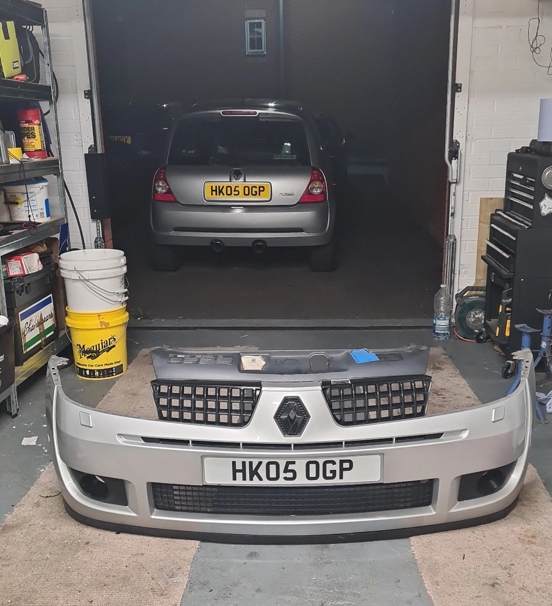

When I picked it up...
Assessing what I'd bought exactly.

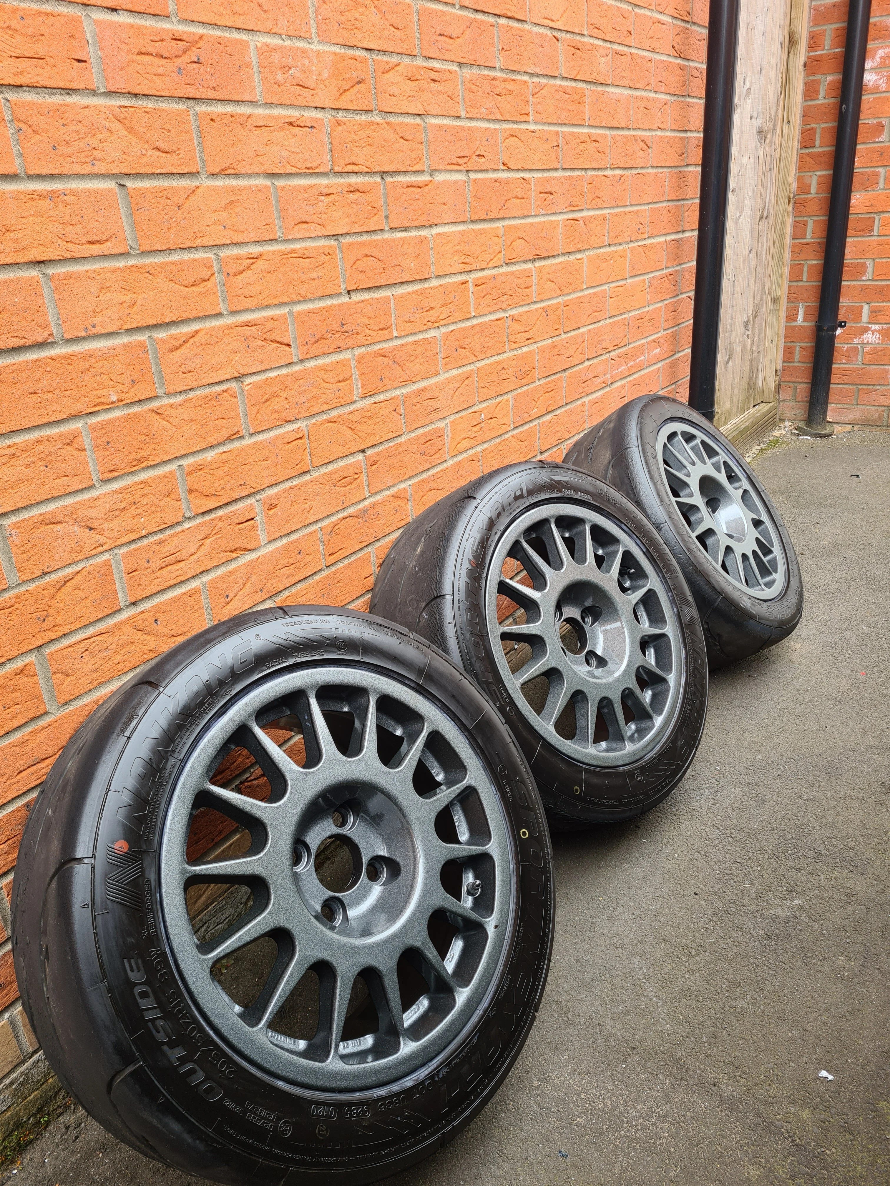

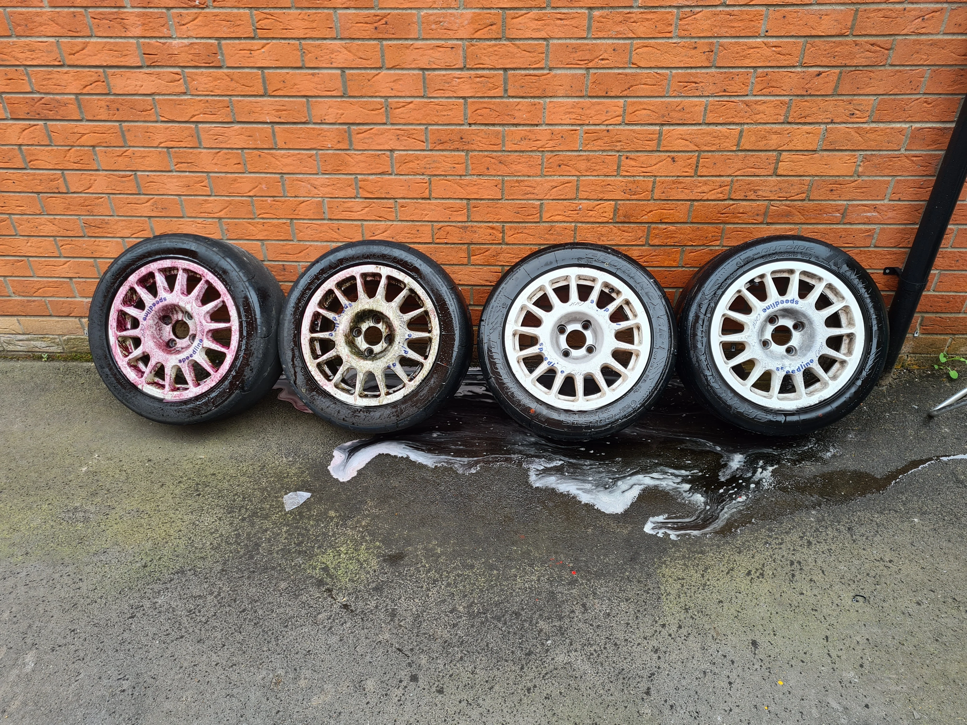

Speedlines had previously had a bad rattle can refurb. If you look closely you can see the letters have melted.
So I had these refurbed (only 3 in the photo, but there is 4)

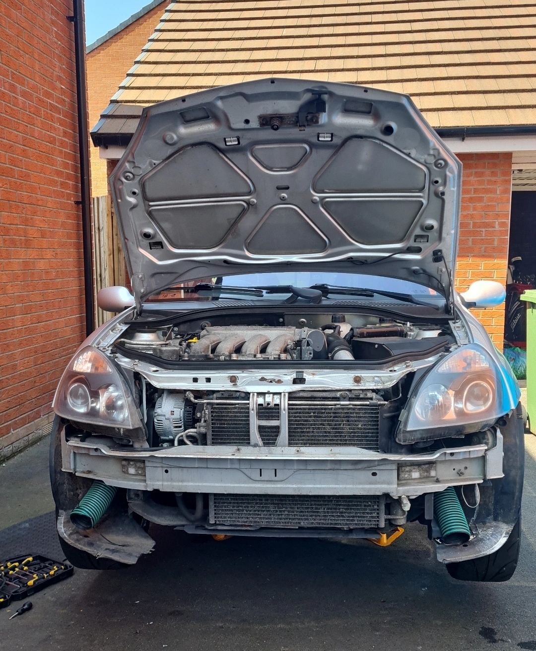

A bit of a preventative measure grinding down the rear of the block.

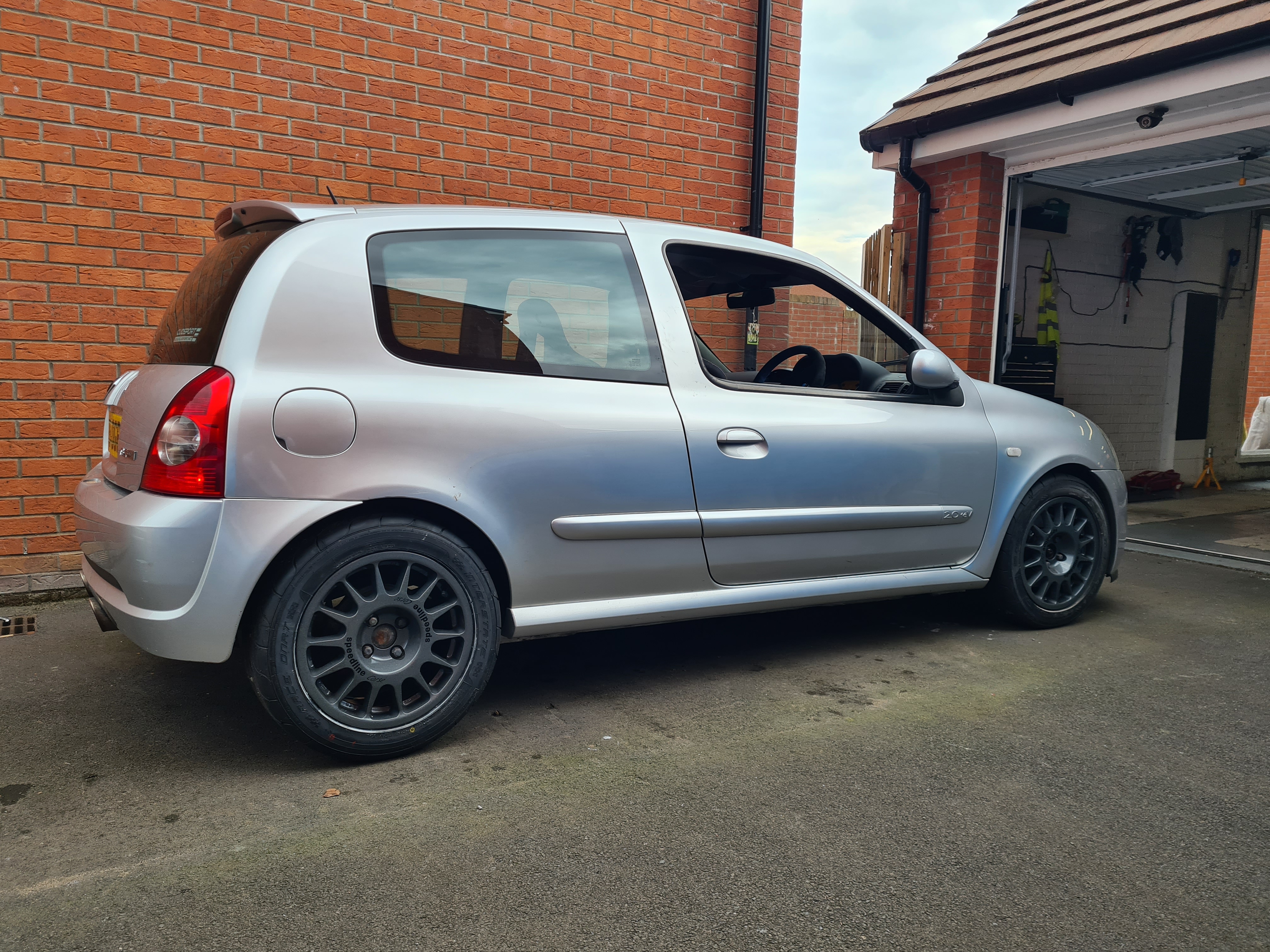

Whilst there I noticed the inner tie rod was floppy as you like, so I ordered a pair of inner tie rods and track rod ends.

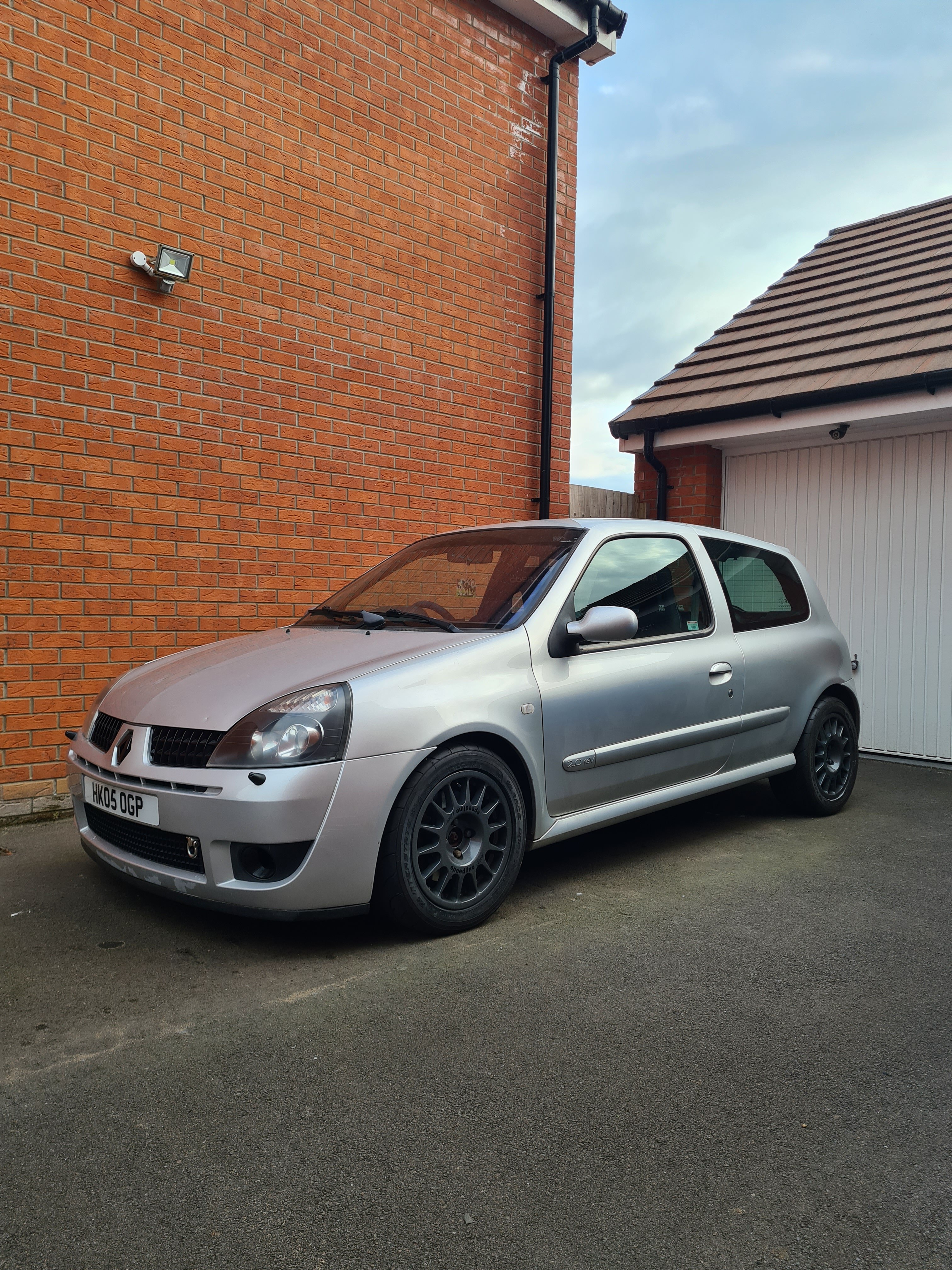

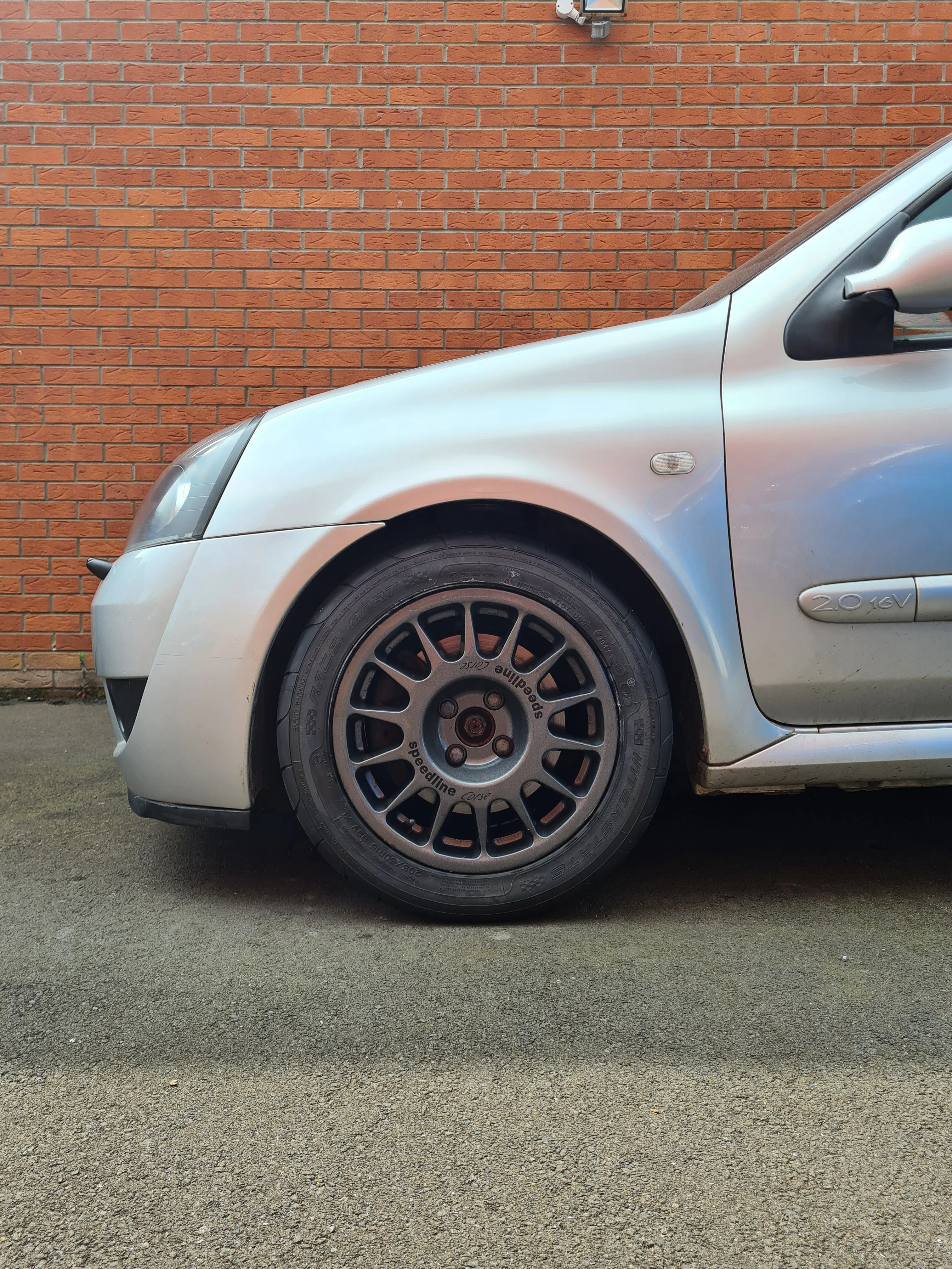

And here it is for the time being. I've put on fresh plates, X4 interstate DNRT tyres and some general tidying up.
Needs alignment sorted, fresh discs, pads, fluid and an oil change and a few other little bits but other than that it's good to go (a few bits he says)...

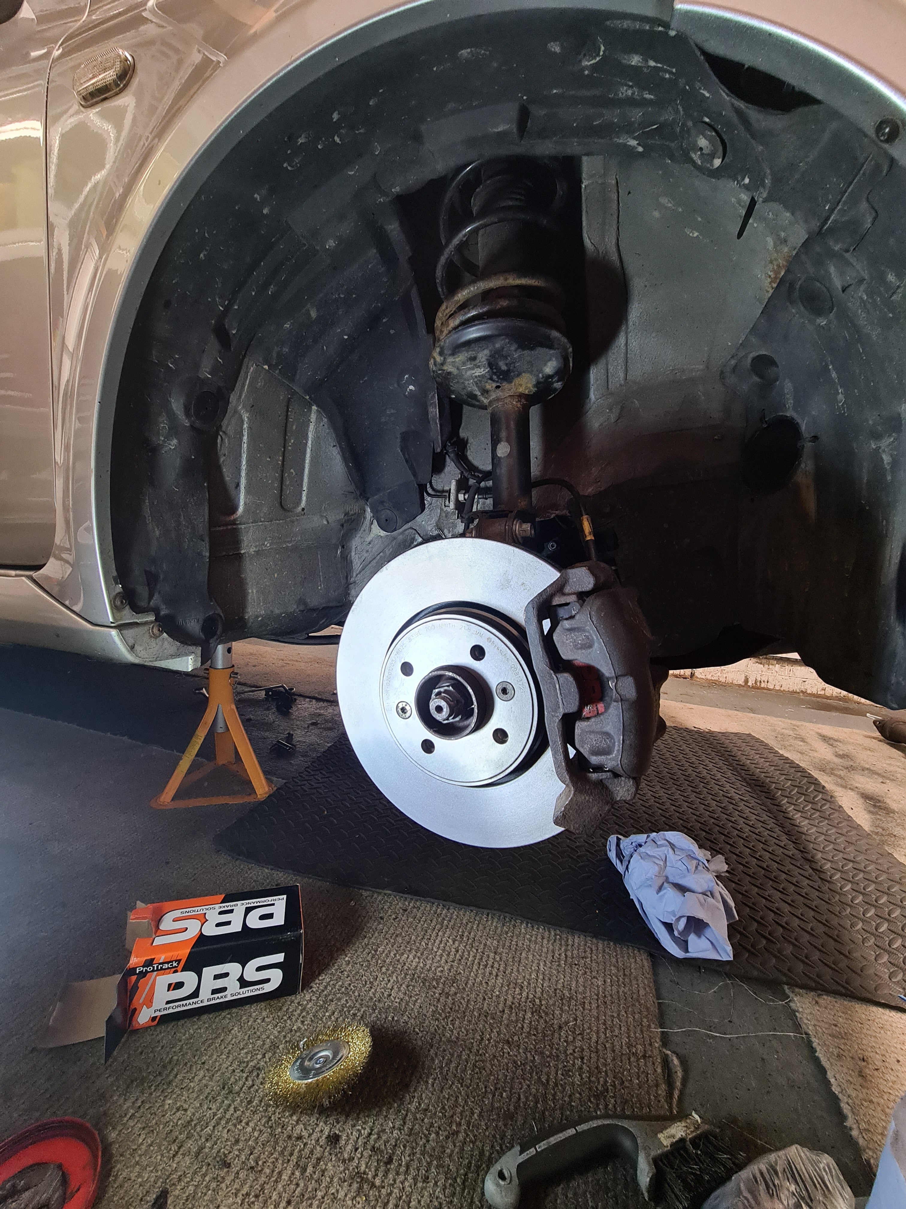

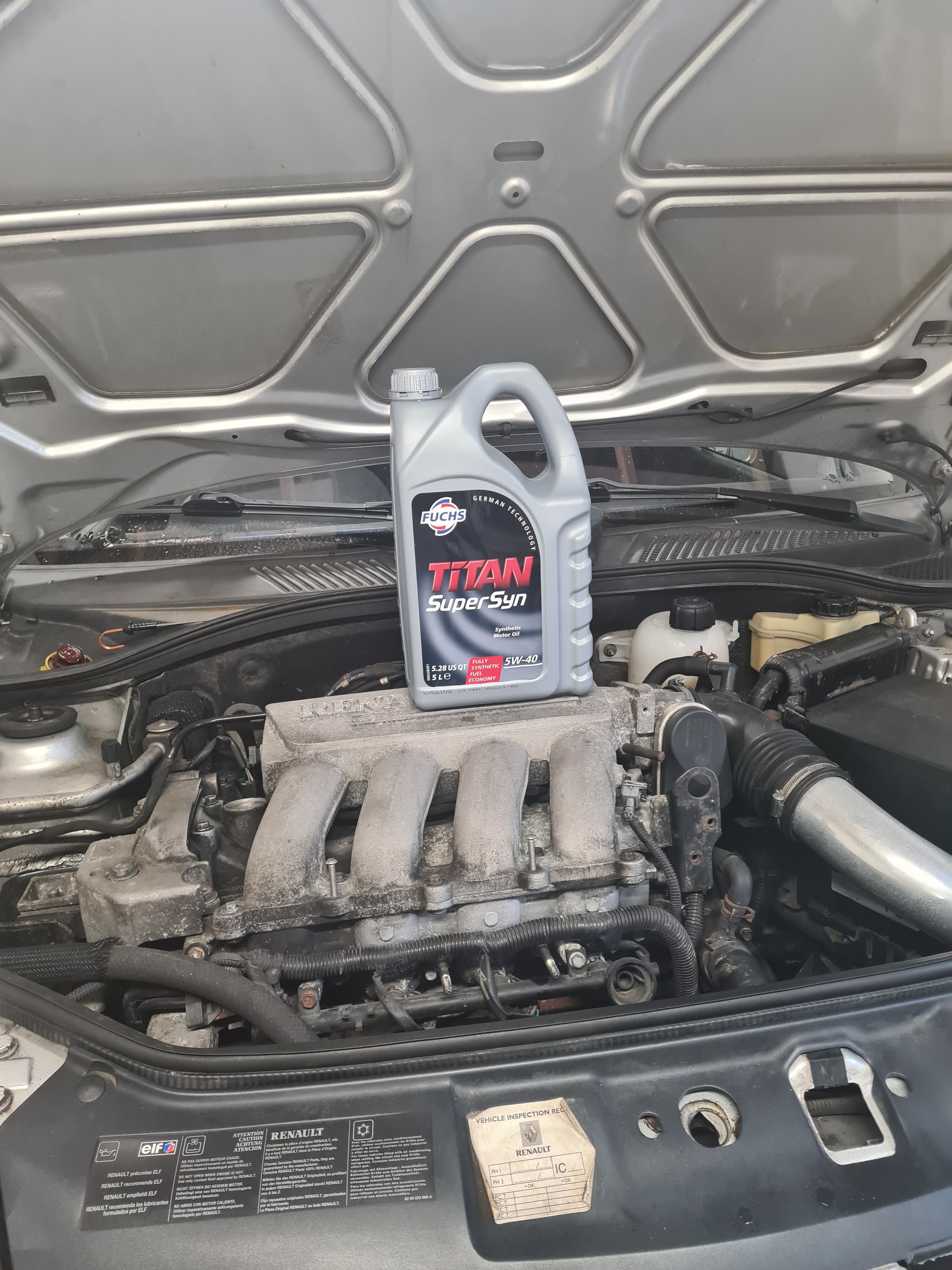

Oil and filter

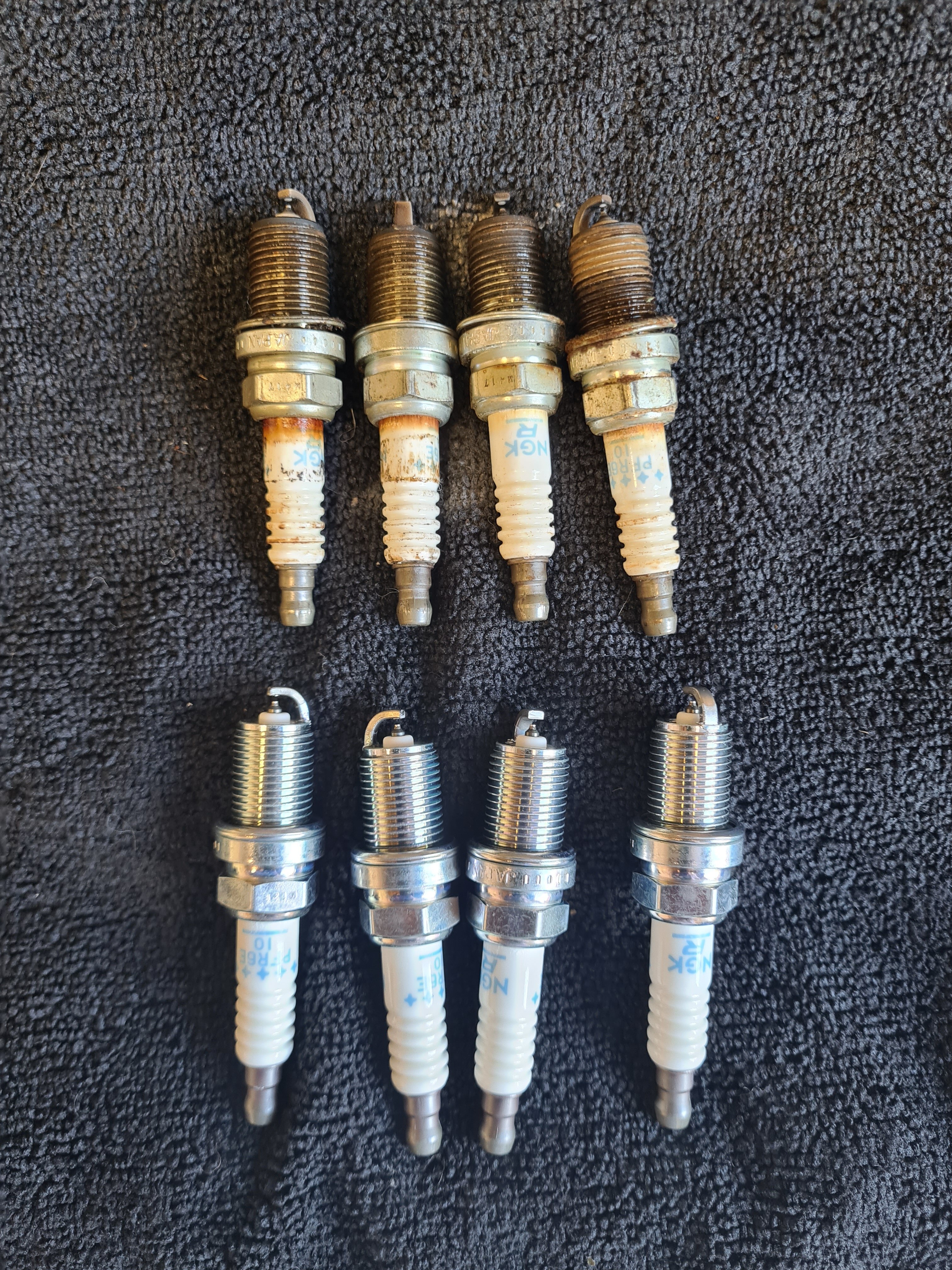

Fresh spark plugs
PBS pads
Brembo HC discs
Decat which I bodged where it meets the KTEC cat back. Will need to look at that again soon.

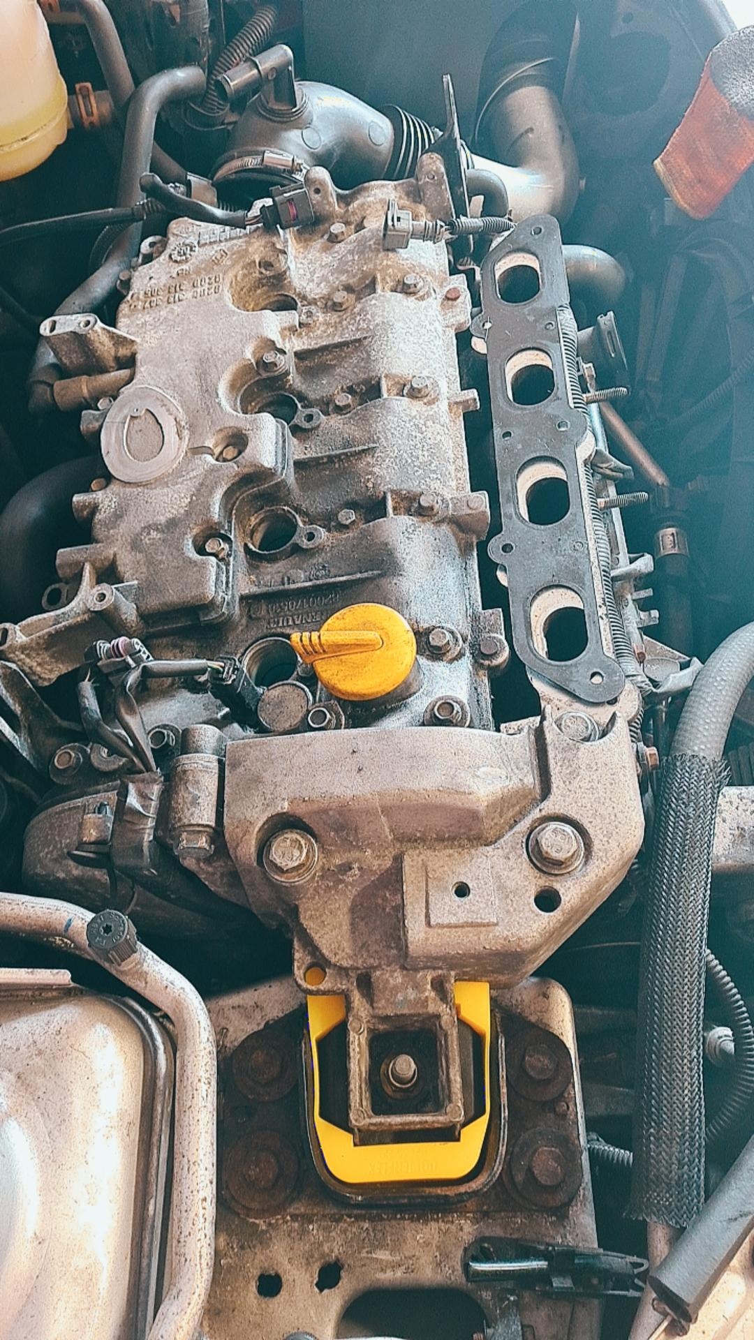

Powerflex upper engine mount insert.
Wheel alignment tomorrow and then I can use it!

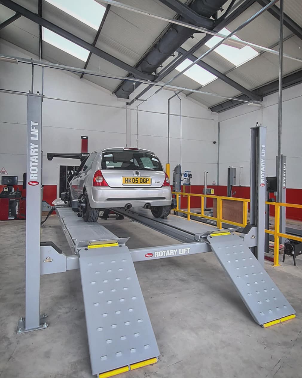

Straight to a local alignment place that opened up just across the road, wasn't sure if they were open, fortunately they were and it wasn't a long drive somewhere else.
On the drive there it felt good, not perfect but it wasn't fighting me.
Technician/mechanic/alignment bloke asks "what have you done to this?"
I explained and he replied "the driver side is within tolerance but the passenger side is off the scale, it won't even register!"
He should have seen it yesterday.
Again thanks to @Adeyspec for the help, really appreciate it.
Now, it drives straight.

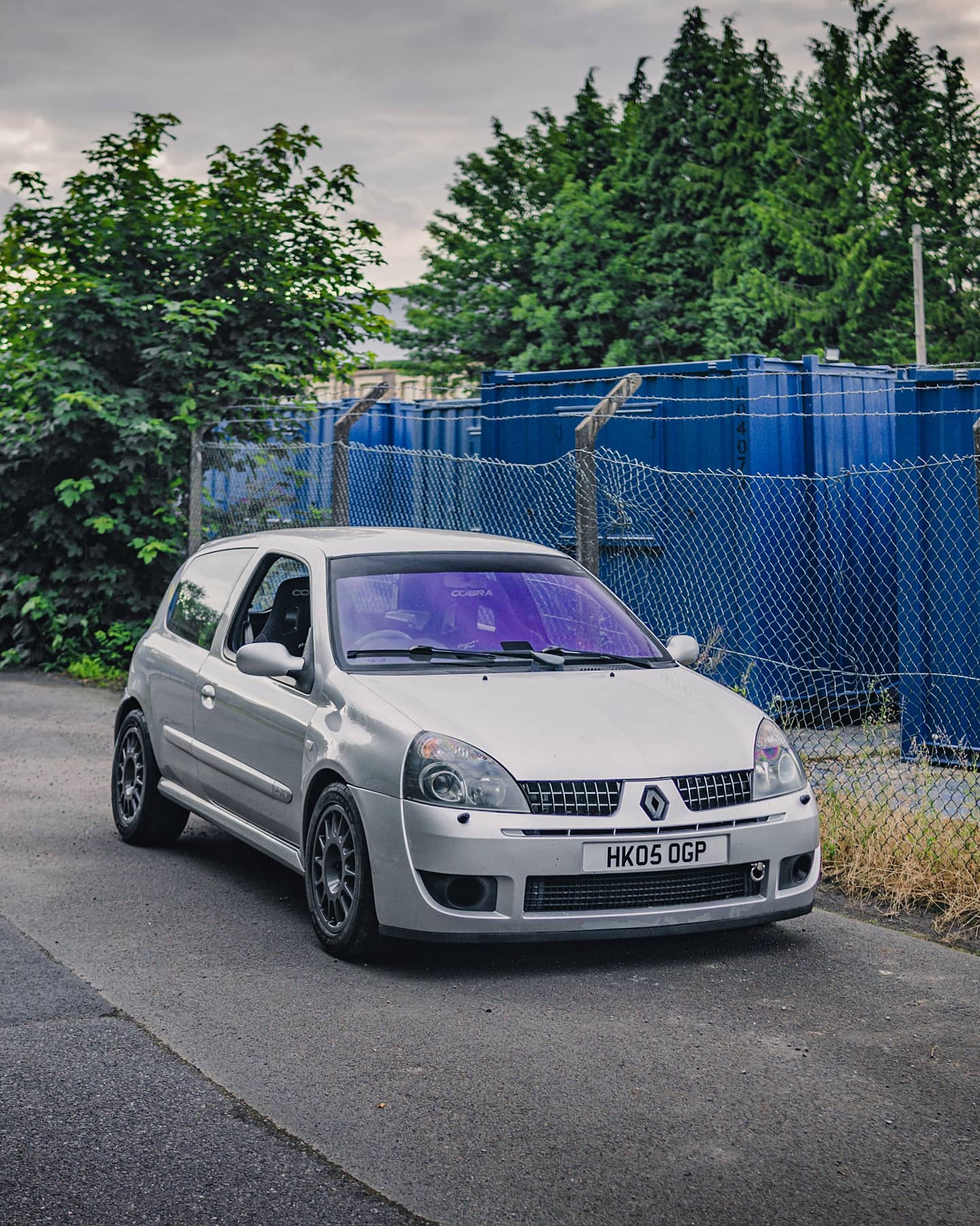

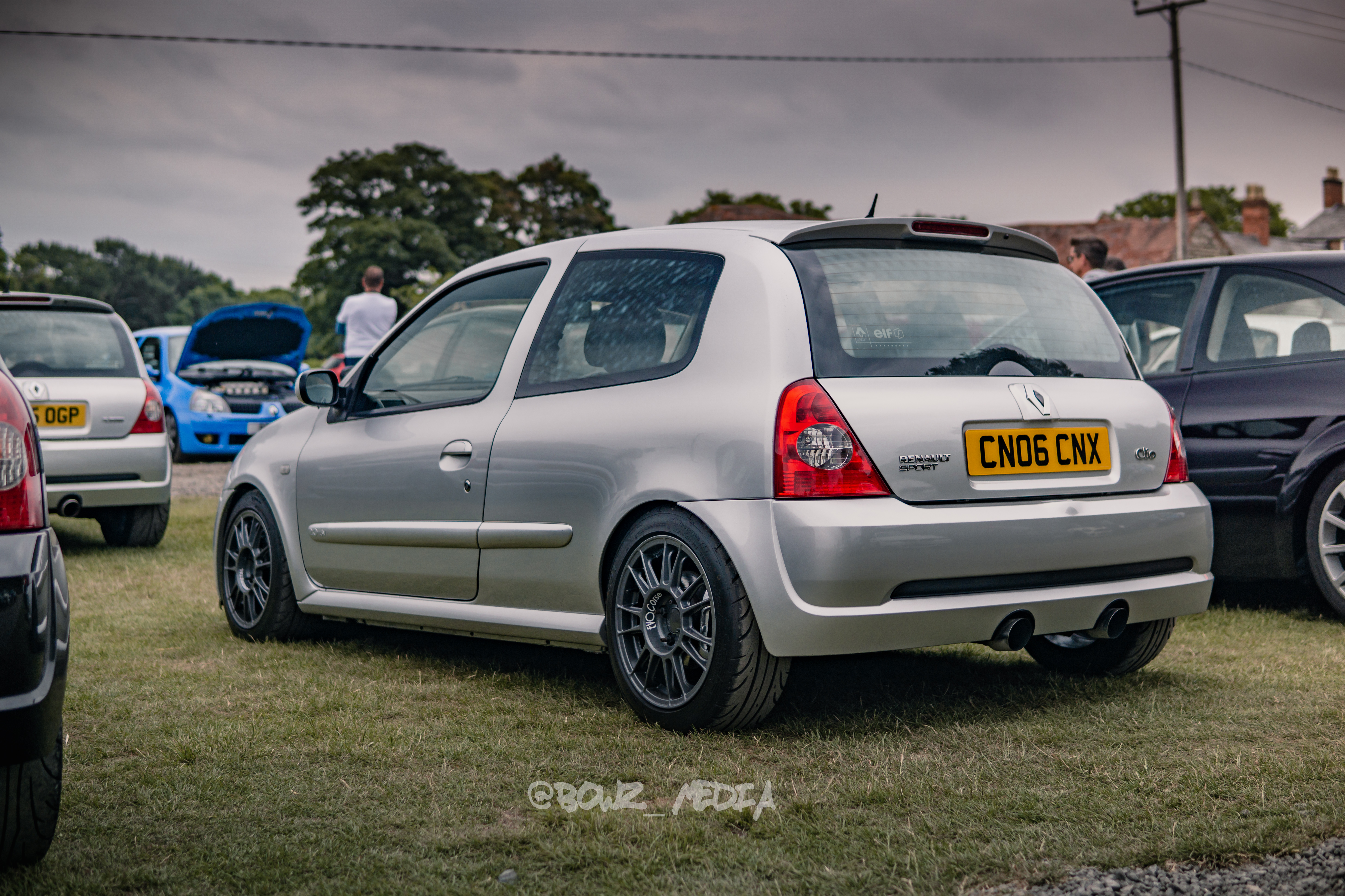

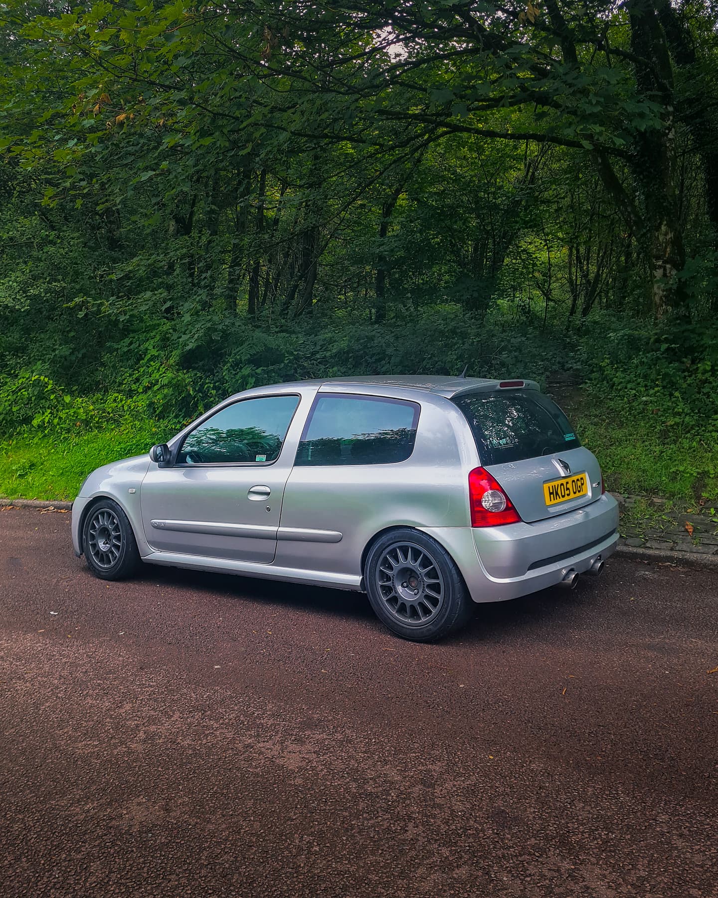

After having all of the bits done and the alignment sorted I took it out for it's first proper spin in my ownership.
Pleased to say it is awesome. Rattling heatshield and the heatshield under the shifter tower needs reinstating as it's no there. Slight blow on the exhaust.

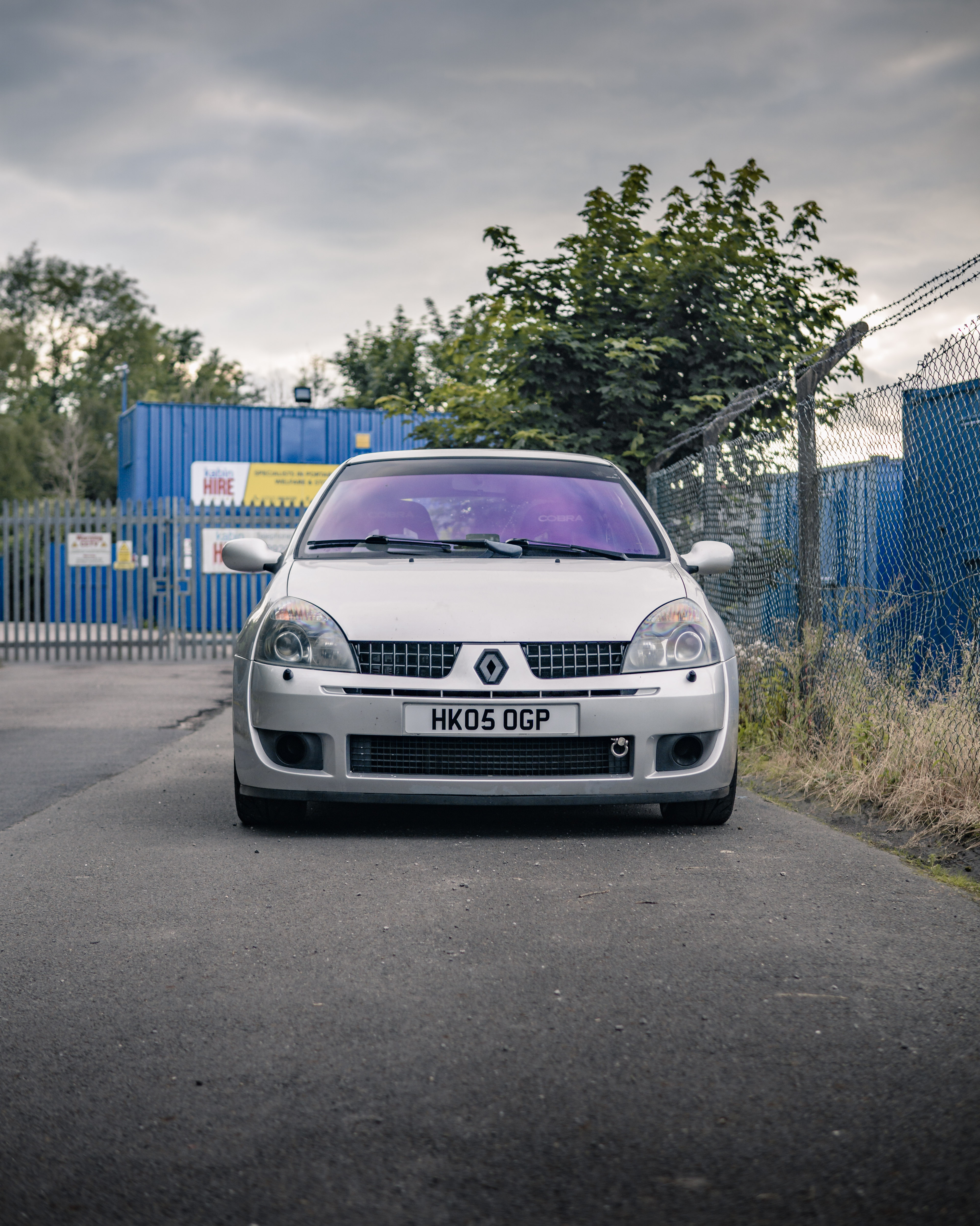

I also do a bit of automotive photography in my spare time. So took the opportunity to take some proper photos.

Now the tracking was sorted I started using the Clio a little bit more to see if/what more niggles it had. Apart from the decat bodge, rattling heat shield and the really rattley PMS it went and stopped really well.
A few more pics
Then back home to start more tinkering....

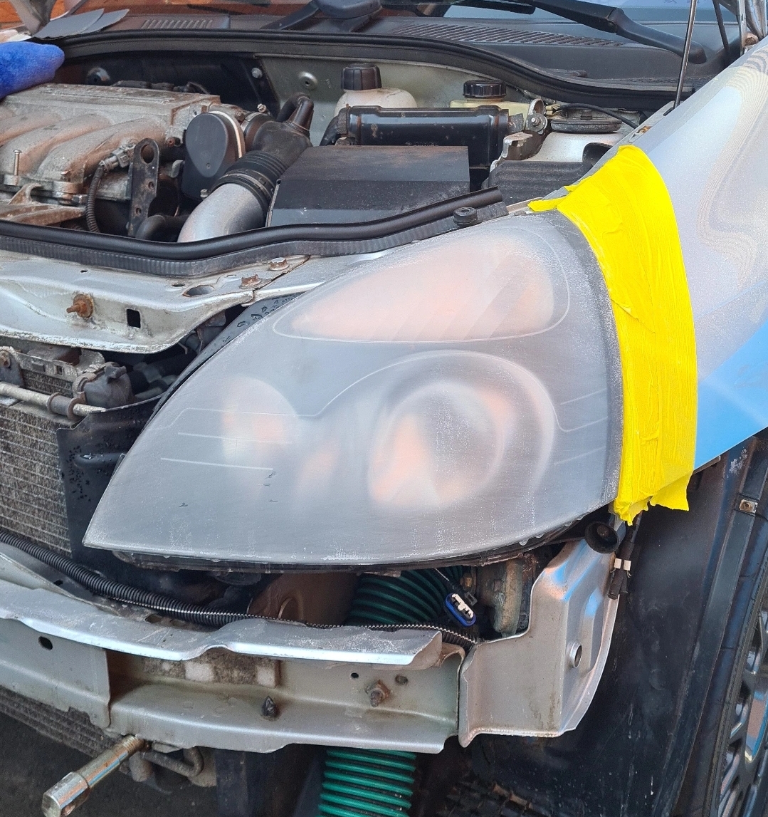

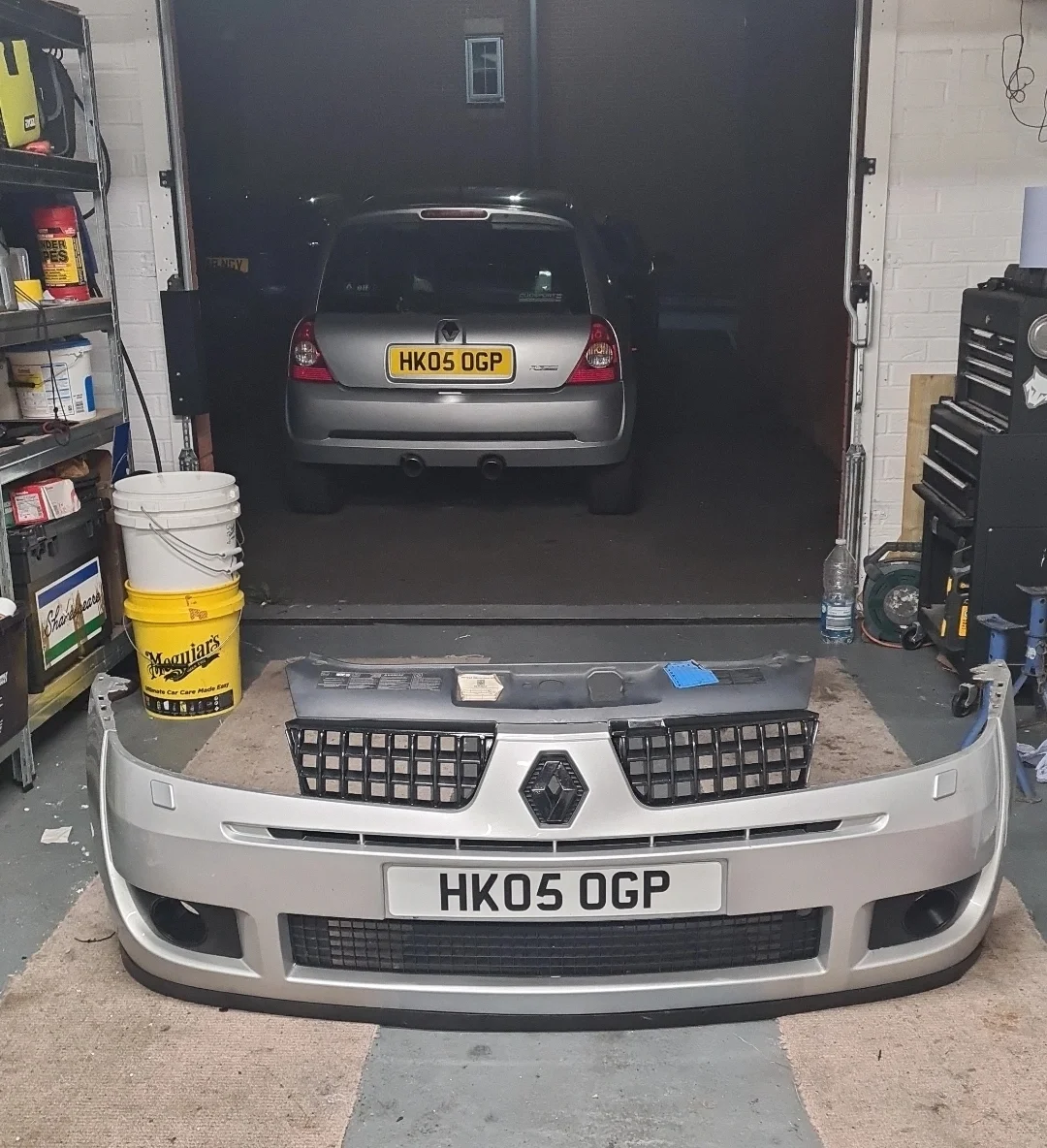

Headlight polish. They look OK here but I wasn't happy so did them again.
Better. Extra points if you can spot the other subtle change....
Yep, headlight washer blanks.

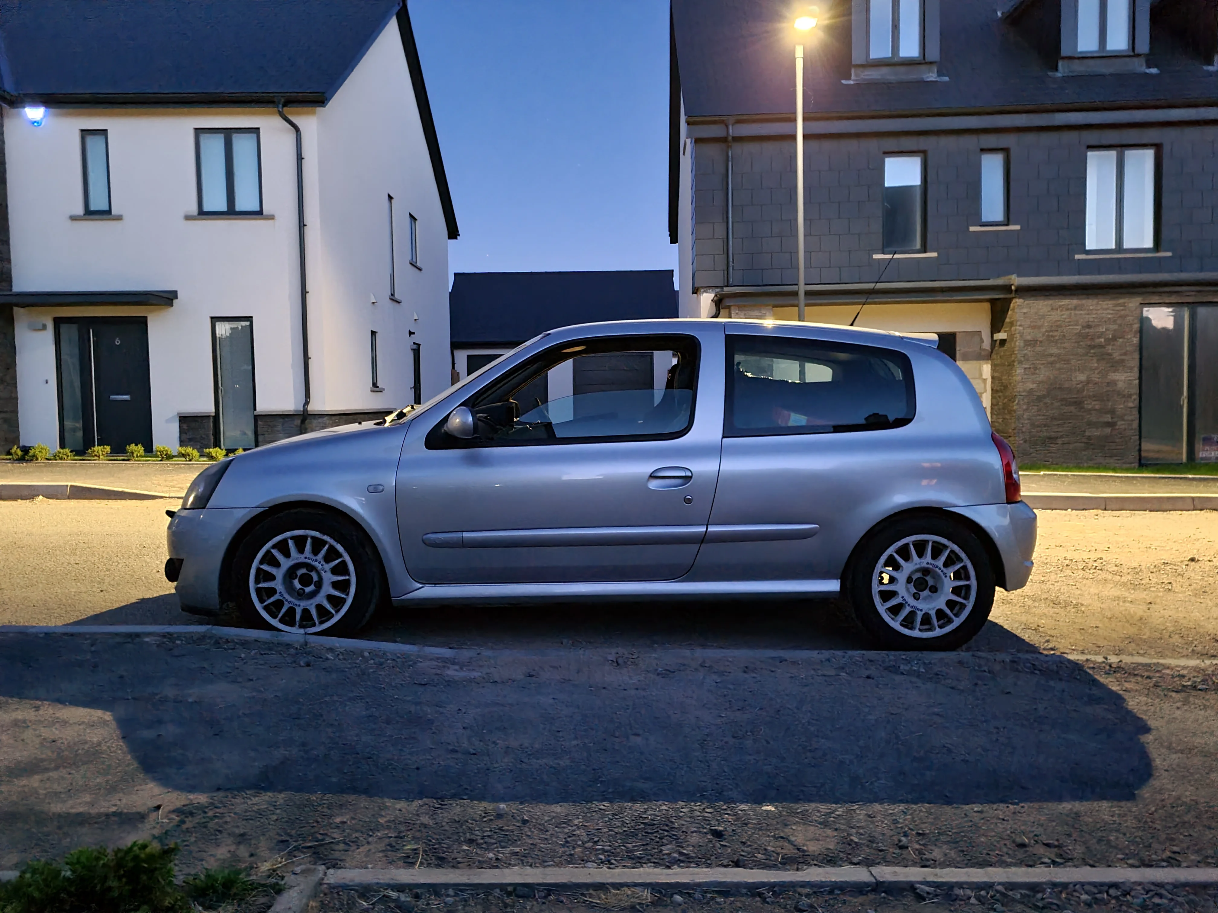

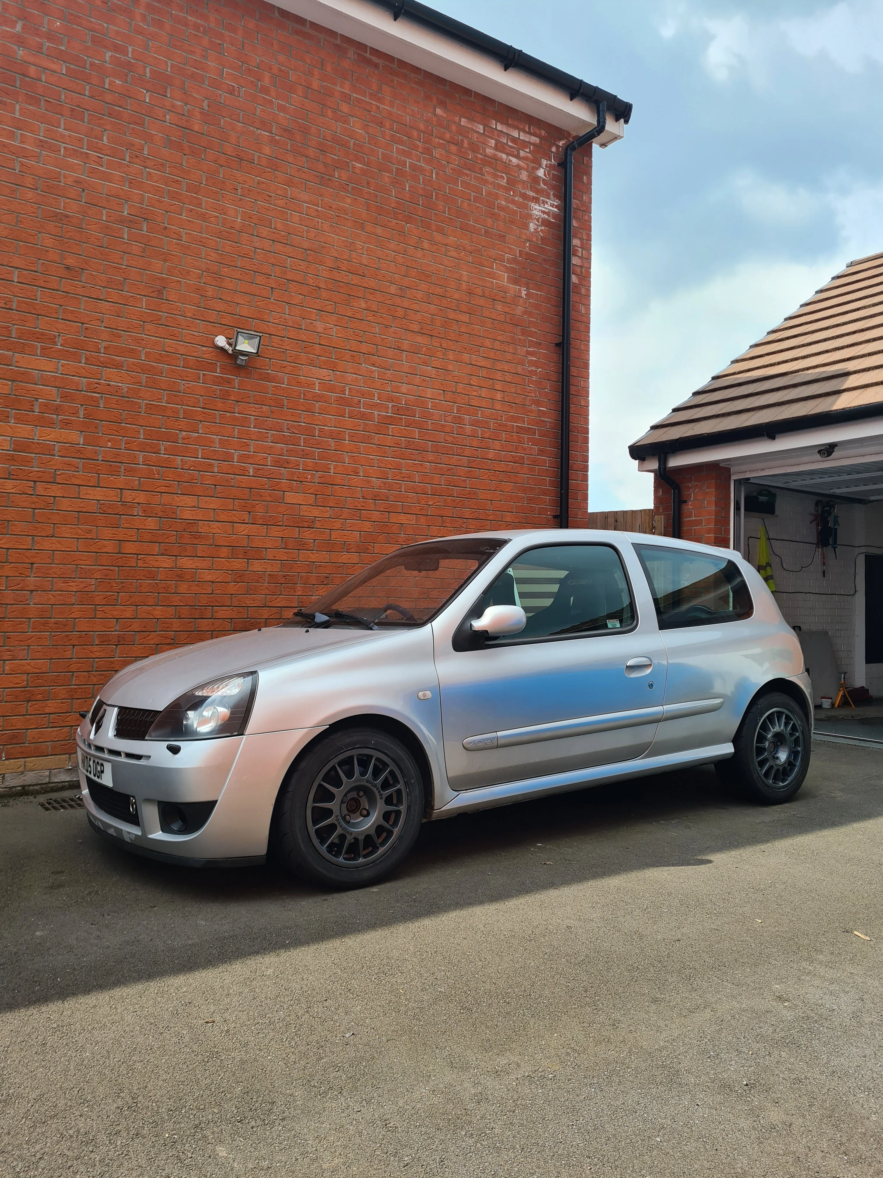

One thing I noticed about the Clio was how high the rear sat. After seeing the squat on @MrBlonde 's Clio, I knew something had to be done. So I've just ordered some BC DS Coilovers from @Kev@KAM

It's amazing how different yours looked to mine because of how it sat! Loved it.
Thanks for the kind words mate & once you get the coilovers on,it will transform the car.I was actually thinking about cages today also but maybe needs seats first,top work mate.

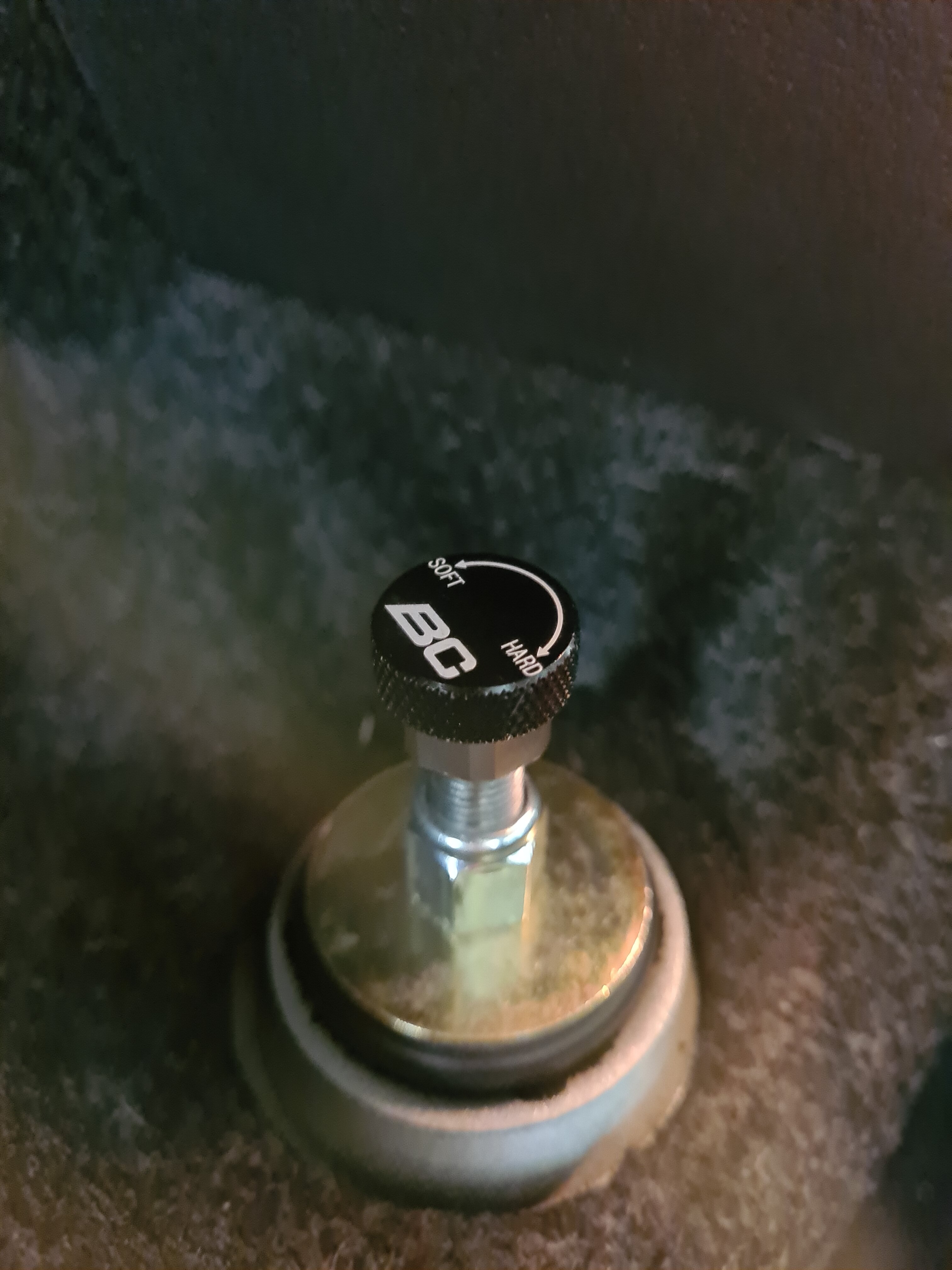

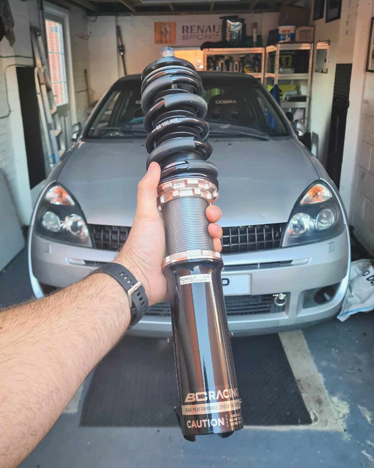

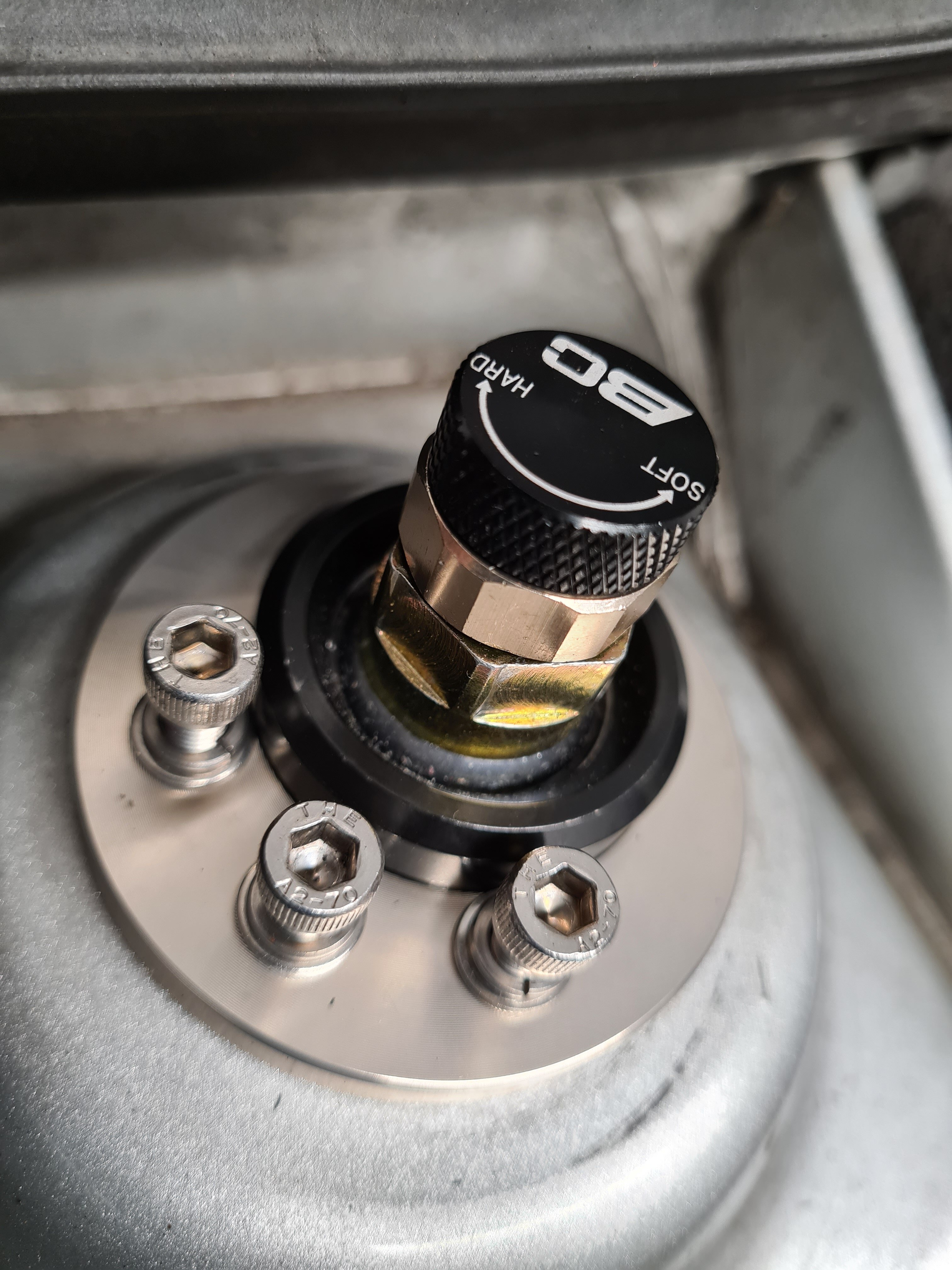

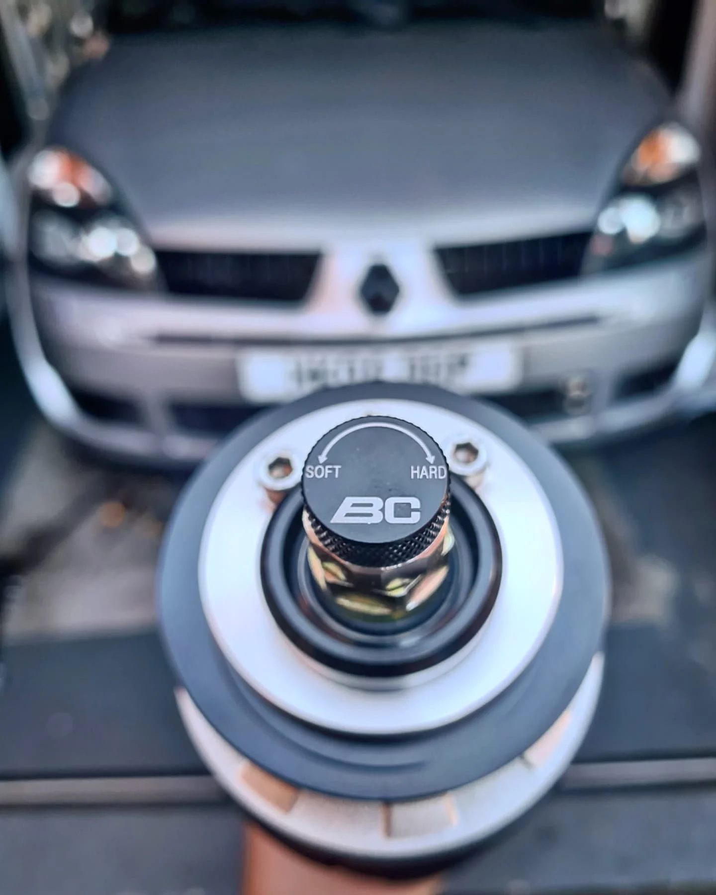

BC DS coilovers arrived next day delivery from @Kamracing cannot fault the service at all.
Coilovers look the business. Hopefully fitting this weekend.
I choose 8kg/8kg as that seems to be the middle group between a b road blast and a track day. Time will tell.

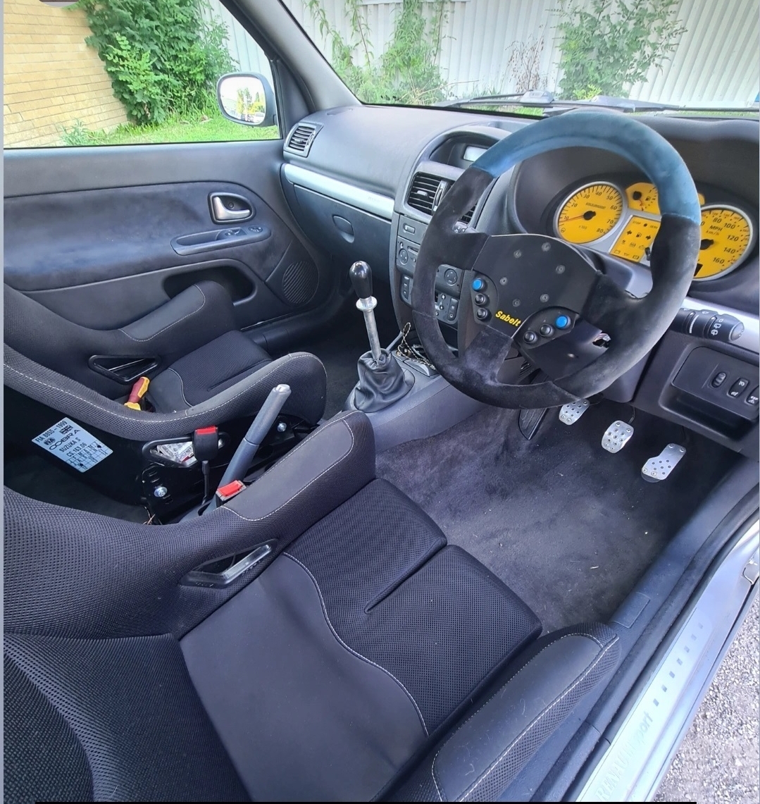

As previously mentioned I was (still am) on a mission to stop or at least reduce the PMS rattle. I was missing the rubber gear linkage boot which people recommend filling with heavy grease.
Rubber boot sourced, on to fitting.....On taking the PMS linkage out I snapped the white nylon bush thing. So ordered one of them. Anyway, the linkage is all back together but I am yet to test it out.

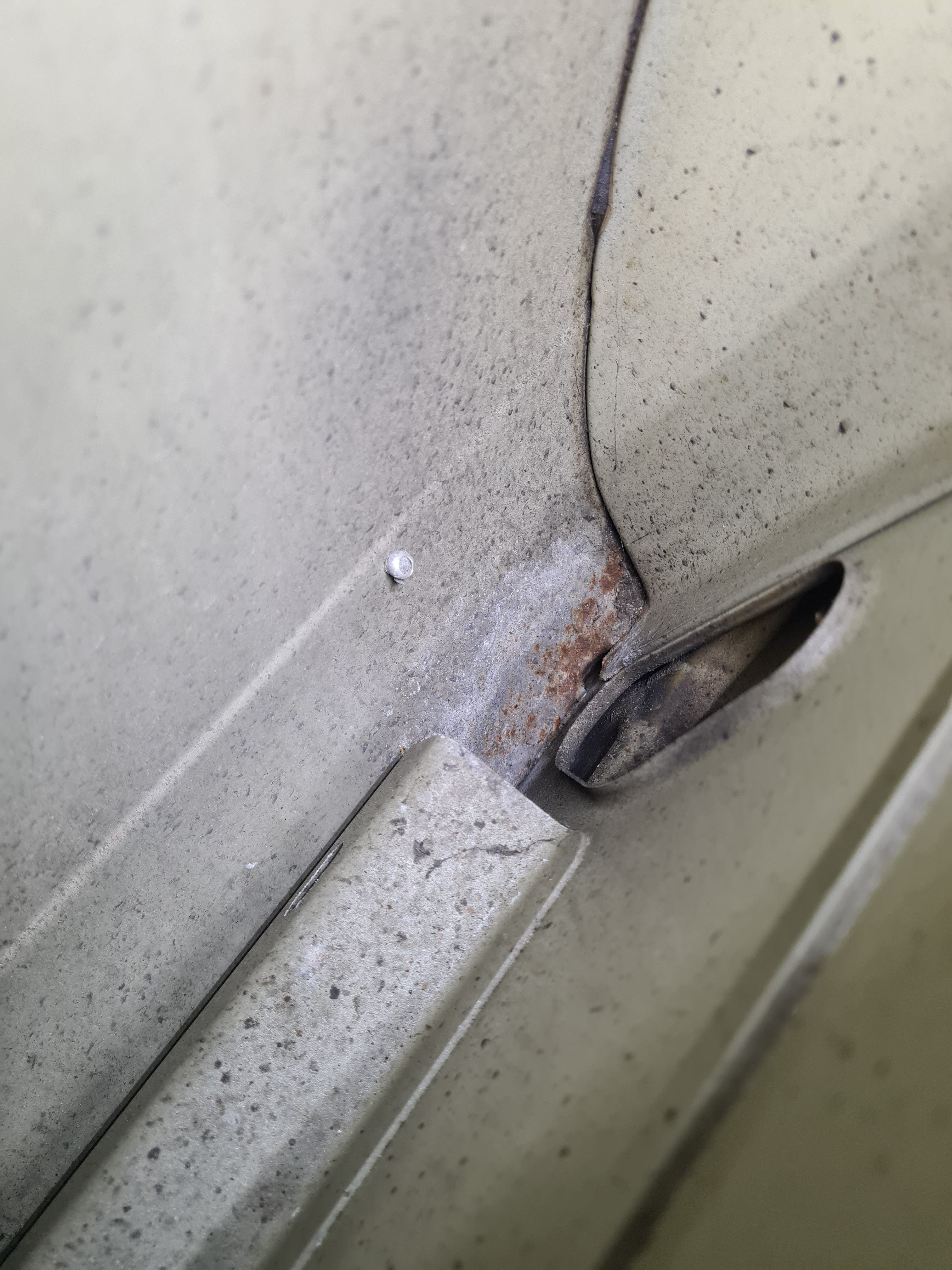

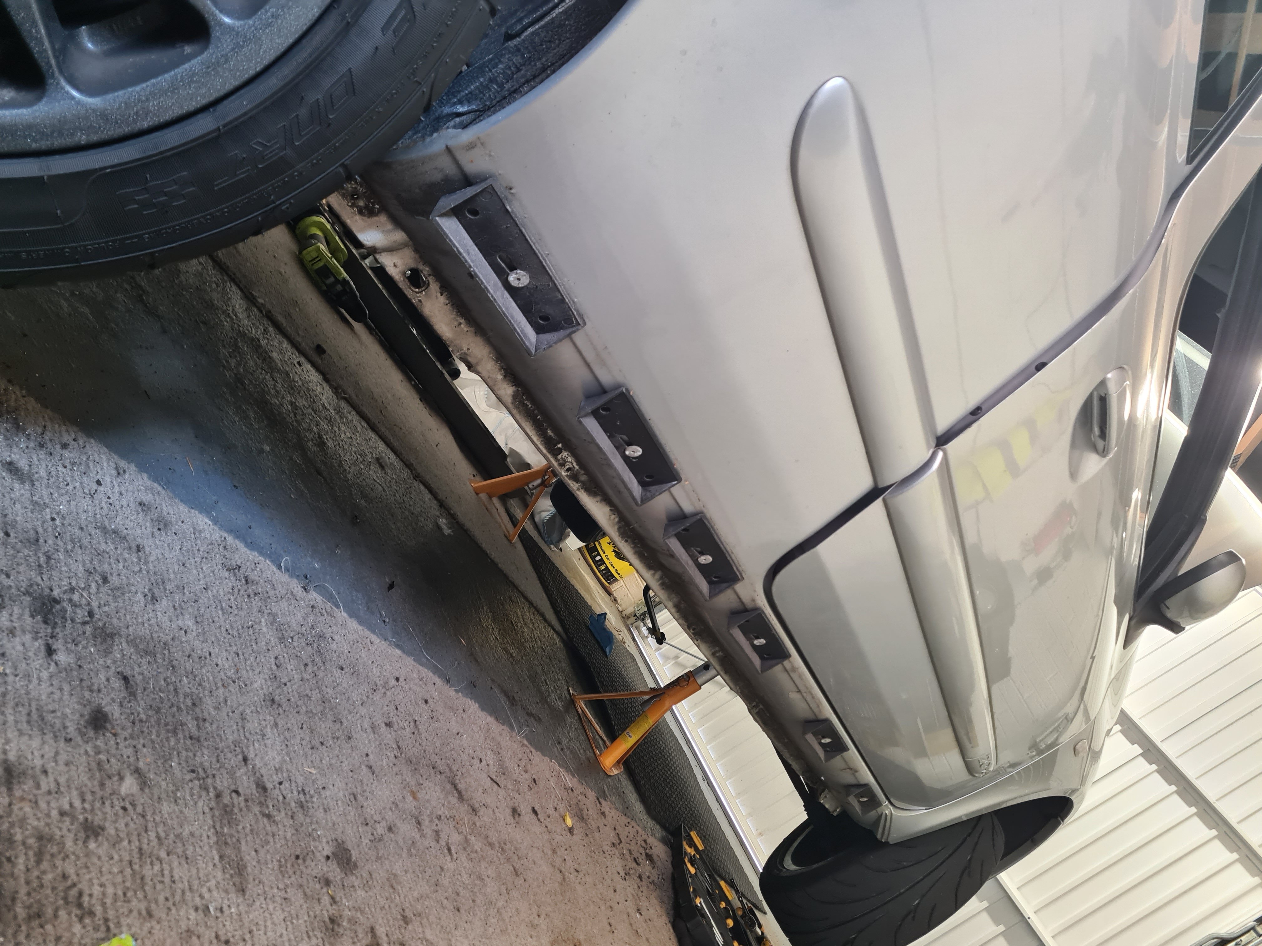

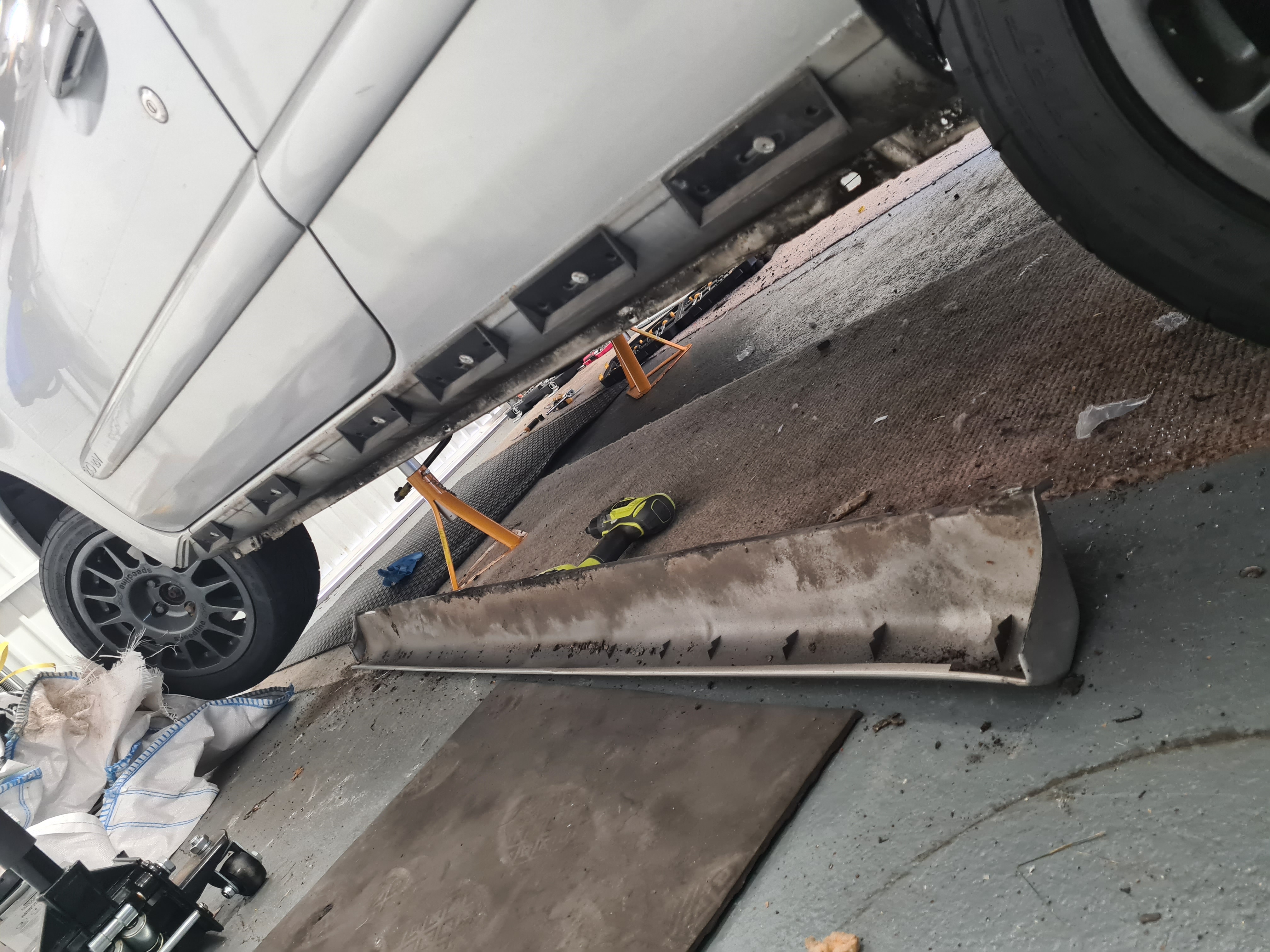

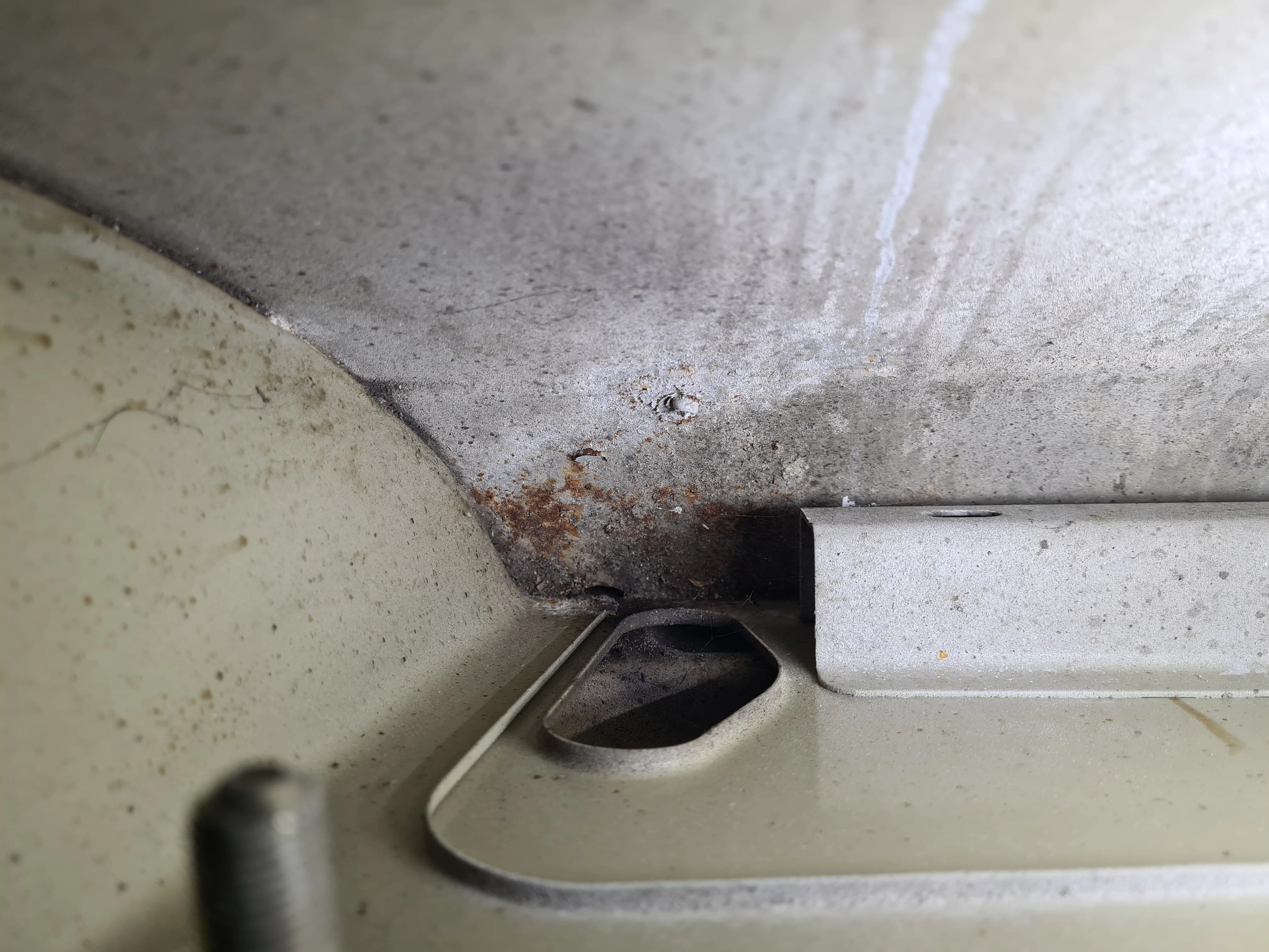

Whilst waiting for the nylon Bush replacement I removed the sills and rear inner door cards to check for the "R word". Thankfully, none present.
Inner sills look pretty good I think?

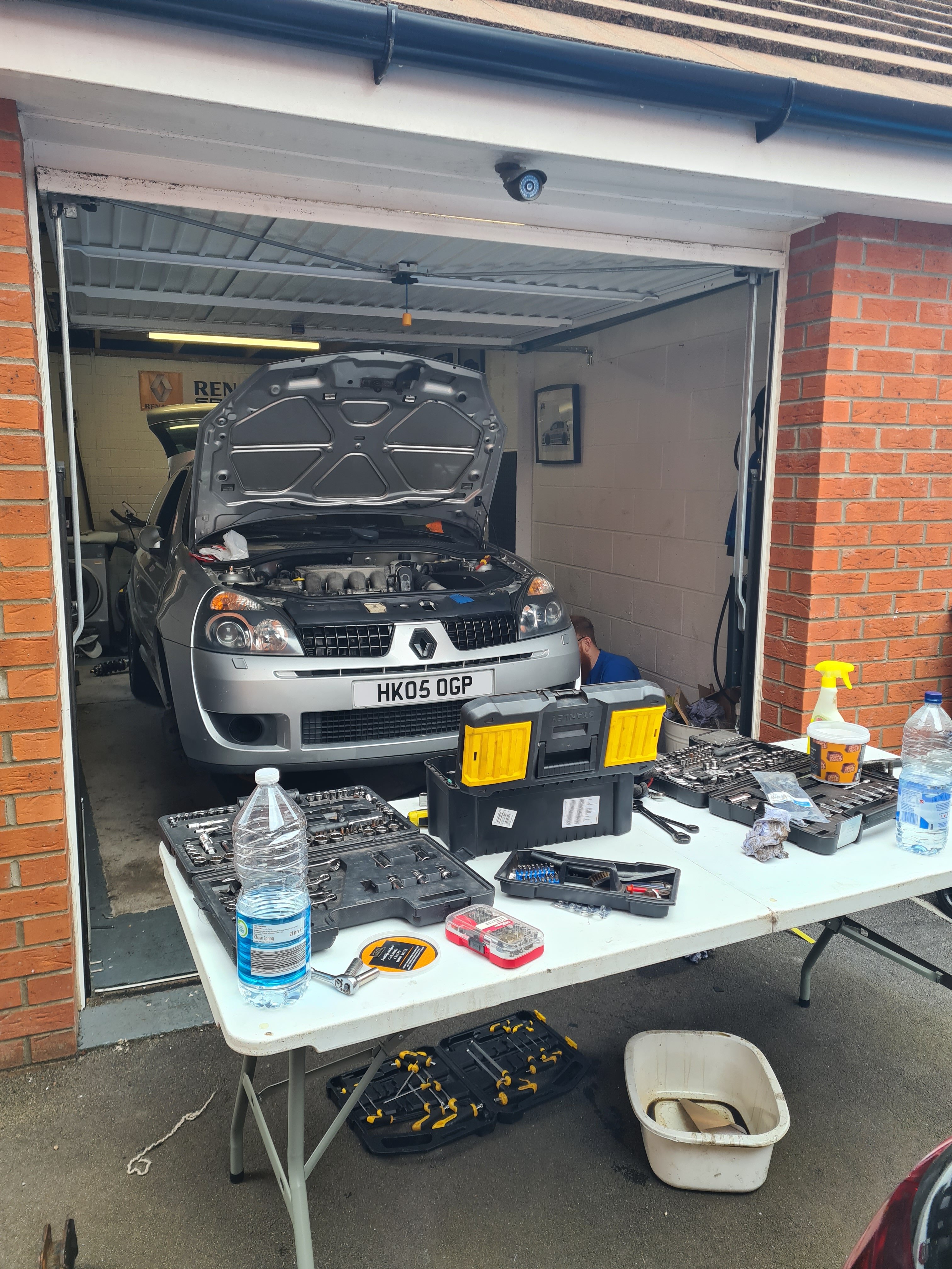

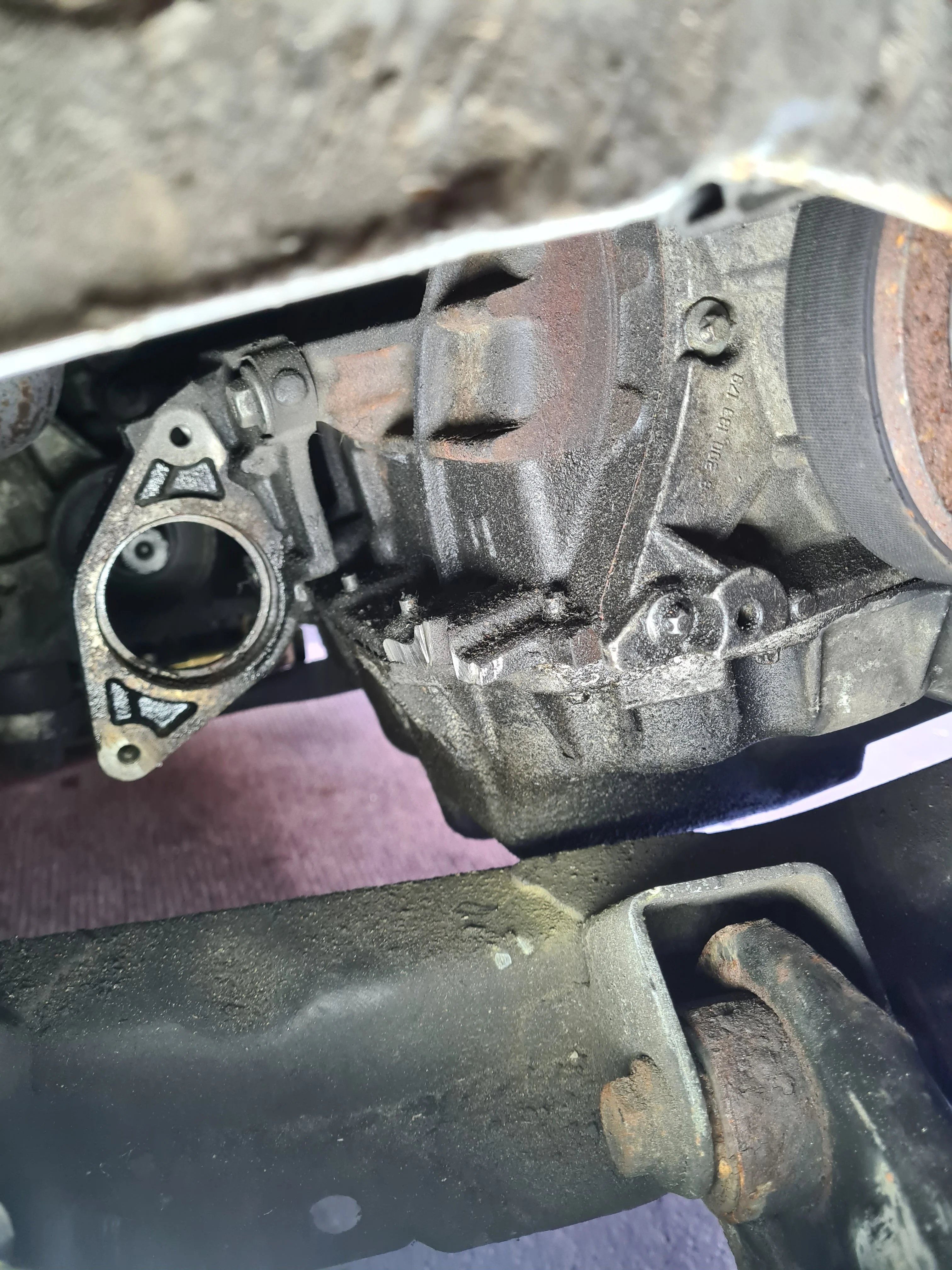

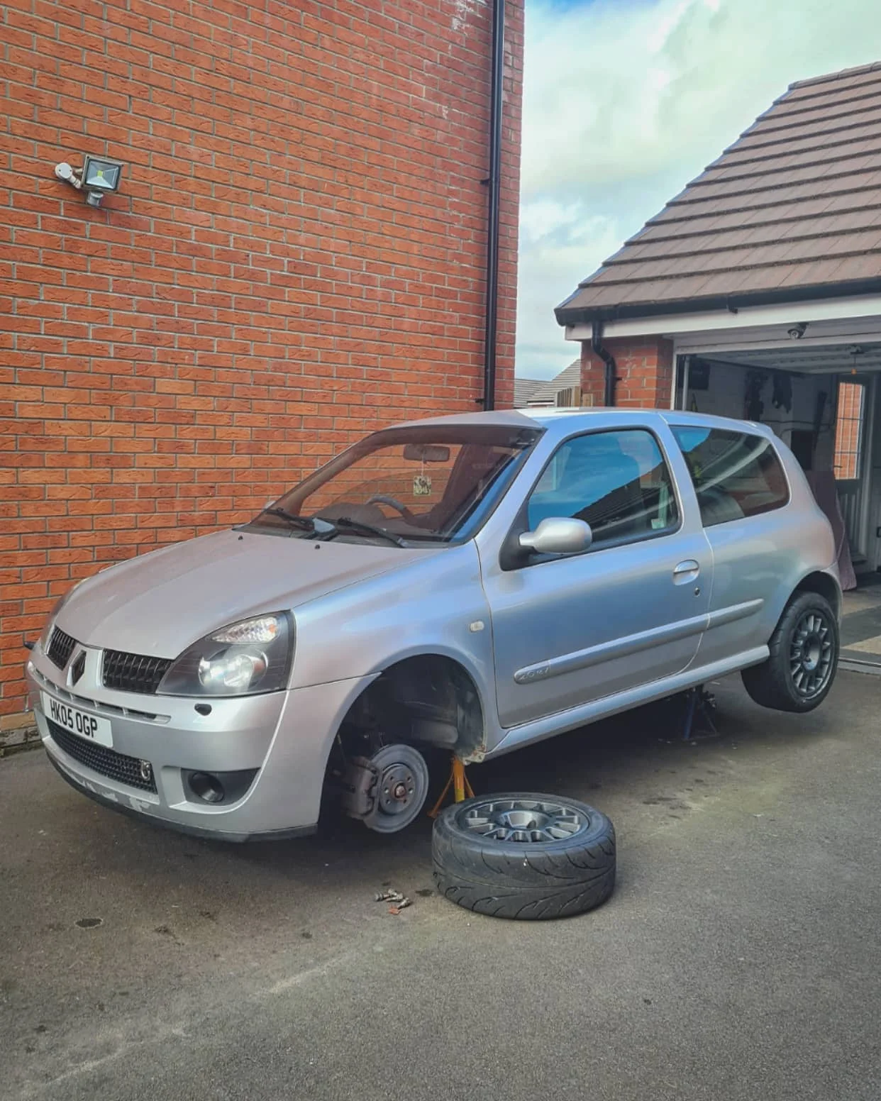

Yesterday a mate and I set about fitting the Coilovers. It was one of those jobs on a car that you think will take 2/3hrs....but ended up taking 6hrs.
Front driver side came off nice. I went to make a brew and my mate (Liam) came running in with a sheepish look.
"you need to come look at this"
Fearing the worst 'it's fallen of the axle stand/it's crash damaged etc'
I walk in to the garage to that obvious pungent smell of gearbox oil and its all over the garage floor. Liam had pulled the driveshaft out. Oh dear. He was gutted but mistakes happen. This meant taking the whole side off and driveshaft off to reseat the boot. Luckily I hadn't changed the gearbox oil but now I had no excuse.
We carried on with the smell of gearbox oil all around and got the fronts done.
Rears took 45mins.

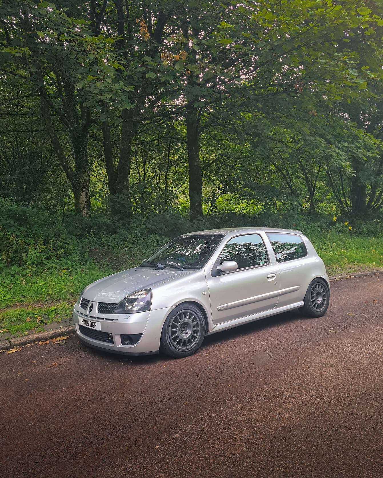

The set up, pre shaft removal.
Drivers side in and down.

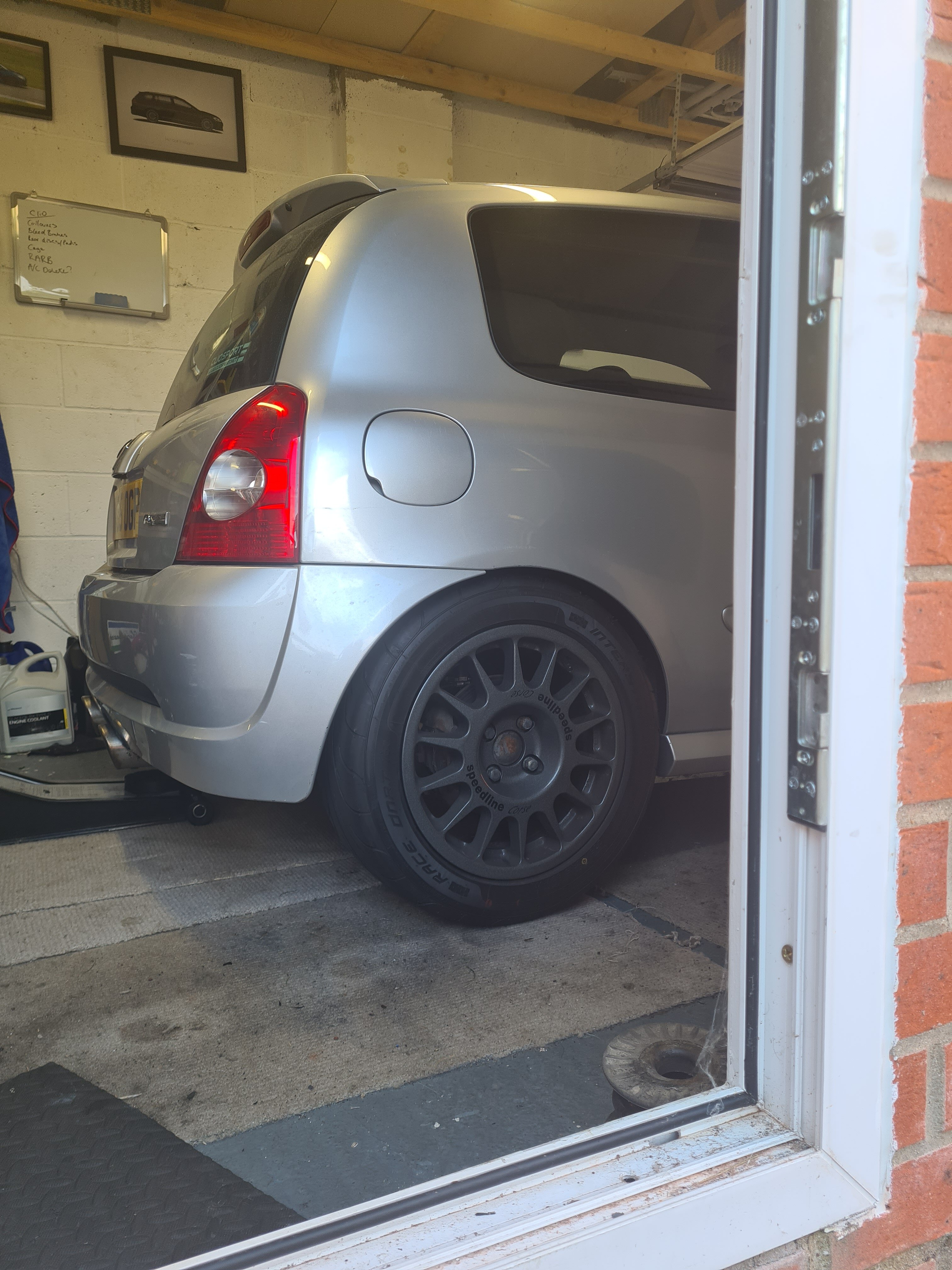

Rear looking squat...
I couldn't get the car out (no gearbox oil) so this was the finished product...
And a shot of the rears.

How do I adjust the camber and caster on the BC's? I know I have to move the all bolt top mounts in/out wards but the strut top isn't a circle its oval, so it won't move around?
Thanks to a few people on here and through Instagram I managed to adjust the camber/castor. I've done it myself for now until I've found somewhere that can do a proper geo setup close to home.

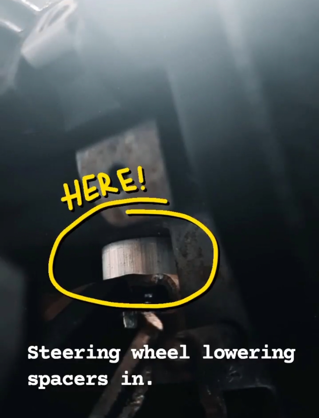

One of these modifications was a Steering Wheel lowering kit. I never really thought it needed lowering but the kit was there so why not.
Fitting wasn't difficult but there's not guide with the kit and even CSOC didnt prove that helpful. Any way they were in.
Not the best pic to be honest.
Anyway, they are coming straight back off. I can't see the clocks and my knee hits the steering wheel when changing gear. For those interested, I'm 6ft 1", seats are mounted to Jon Foz low bases and the seats are at their lowest.
I've sold the kit incase anyone was going to ask.

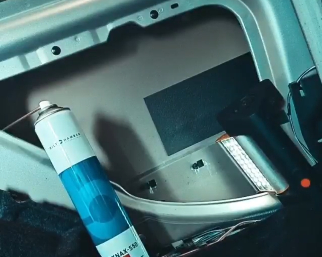

I carried out some preventative maintenance by coating the inner rear sills with Dynax.

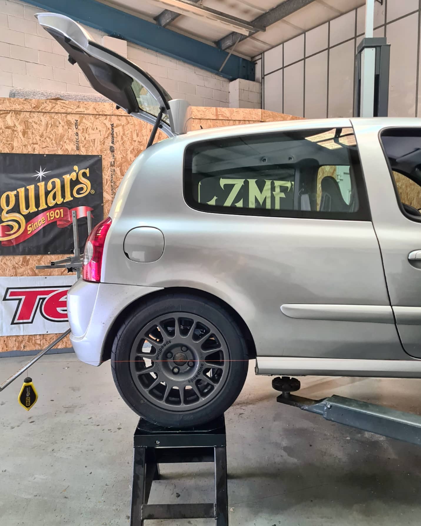

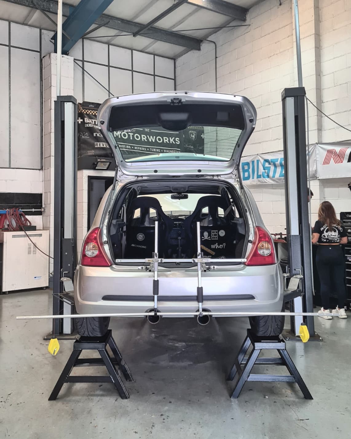

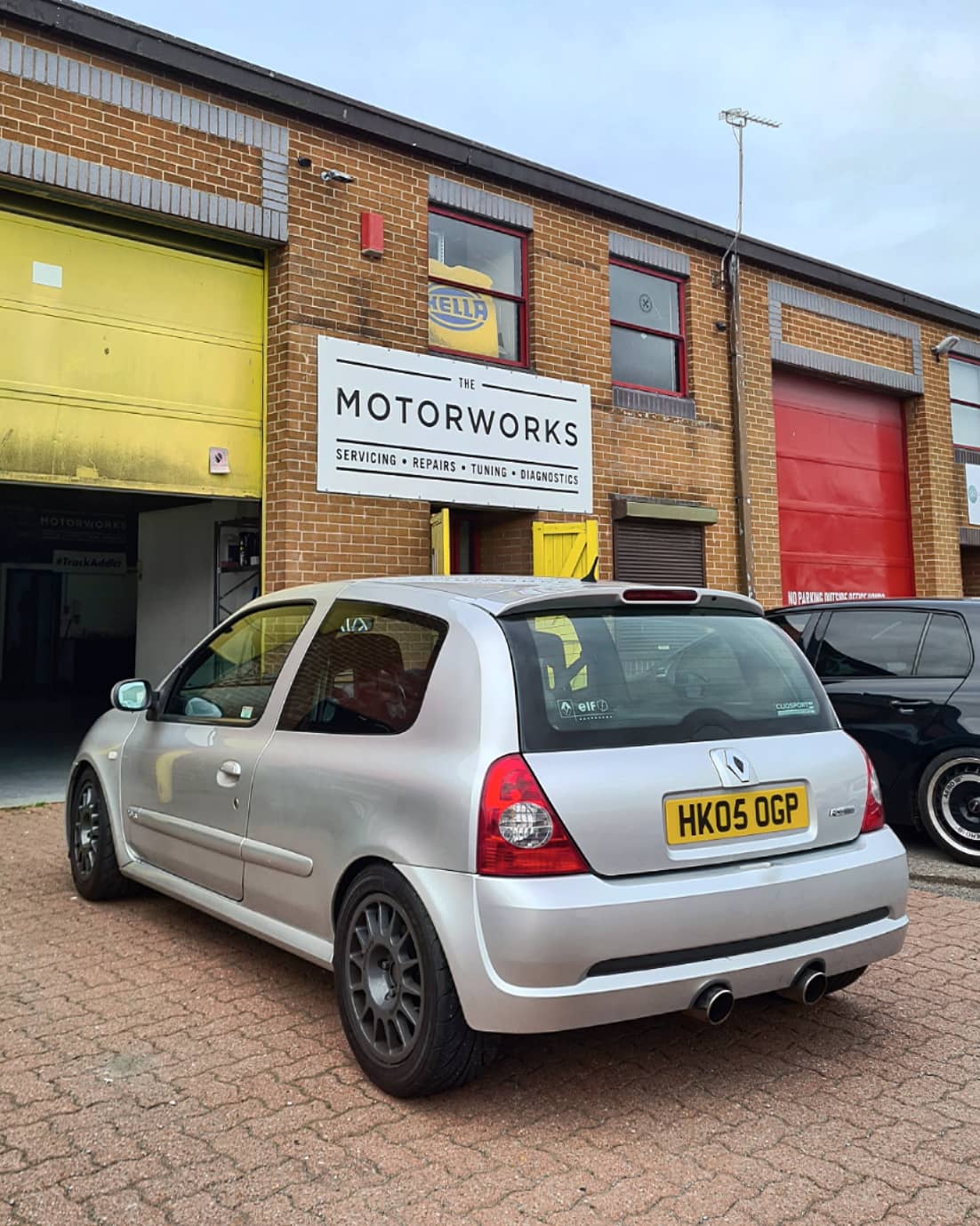

I've booked the Clio in to the Motorworks for a proper geo and corner weighting. Then finally I can book some track time.
Went to see Tom at the motorworks who is a genius when it comes to corner weighting and geo etc.
The drive there was uneventful the steering was out but it drive straight enough.
Met Tom discussed what I wanted from the setup and what the car will be used for and took my hefty frame in to consideration for the corner weighting.
No sooner had I walked to a nearby Mcdonalds for a coffee, Tom sends me a video... I won't put it here but imagine what a wheel would do if it had a very loose camber bolt. He asked who fitted them, I said a local mechanic, it was me.
Whilst Tom was fixing my mistake and making it point straight the wife and I popped in to Gloucester centre and spent a small fortune.
Had the call and the car was ready. Raised ever so slightly, corner weighted and pointing straight. I asked Tom for a fast road/track geo (leaning towards track as its not a daily).
The drive home was AWESOME. The Clio is now so "darty", "direct" and "nimble" all the other verbs.
Can recommend the motorworks to anyone who needs a proper geo.
Nice work mate,whats involved with corner weighing set up?
In layman's terms (or how I understand it) each wheel has a scale placed under it and using the height/pre load of the Coilovers the weight is the distributed to achieve a 50/50 split. Bit much for a road car but as this is a toy and it was included in the Geo anyway I thought why not.
