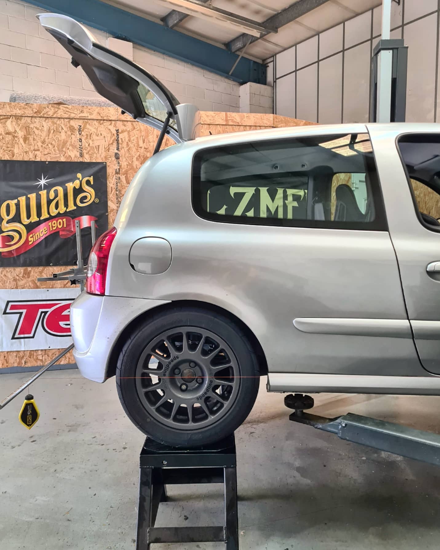

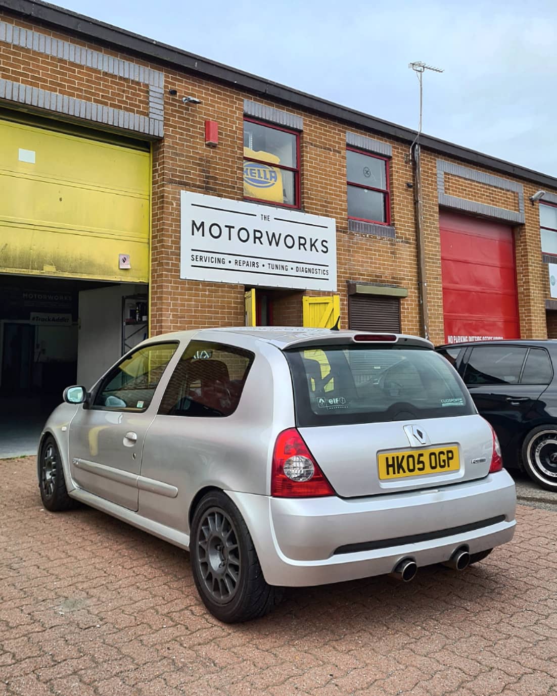

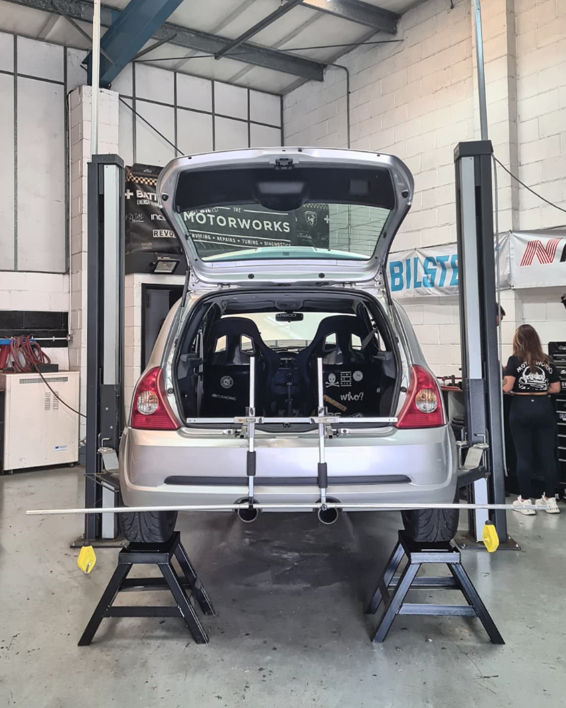

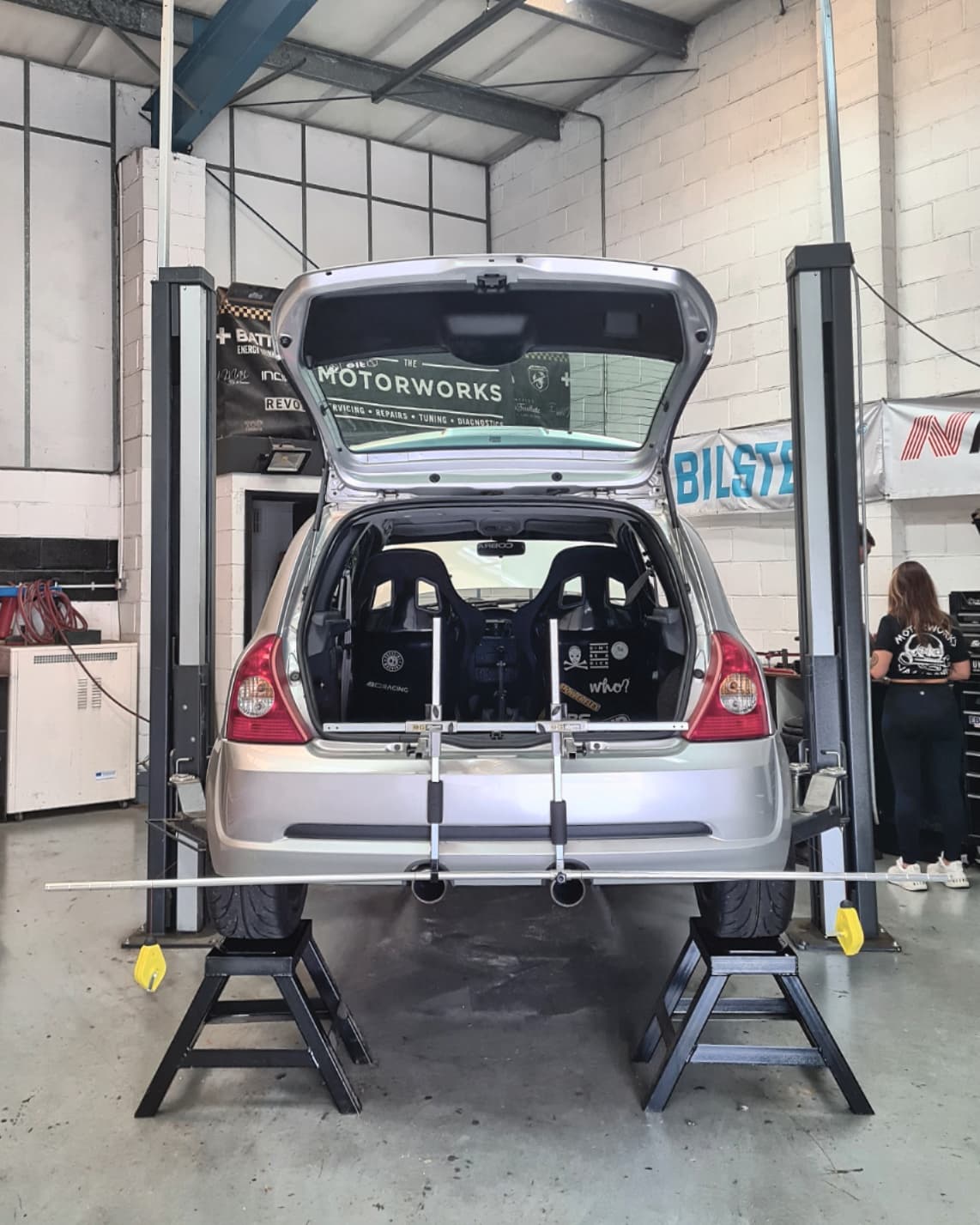

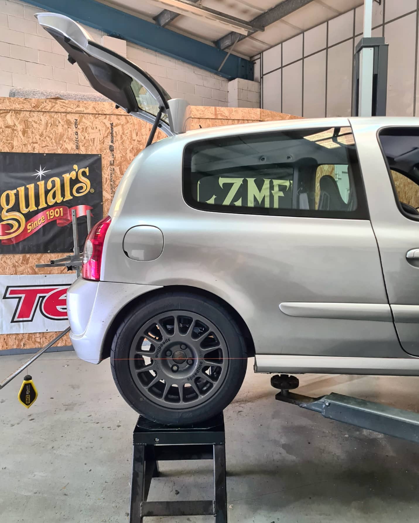

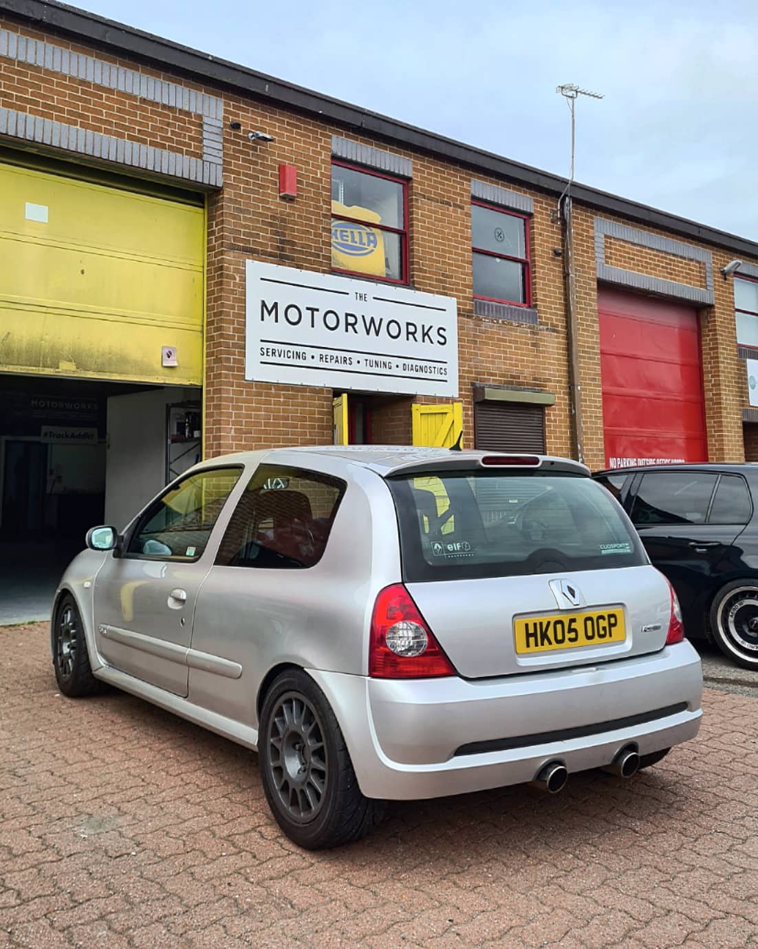

Went to see Tom at the motorworks who is a genius when it comes to corner weighting and geo etc.
The drive there was uneventful the steering was out but it drive straight enough.
Met Tom discussed what I wanted from the setup and what the car will be used for and took my hefty frame in to consideration for the corner weighting.
No sooner had I walked to a nearby Mcdonalds for a coffee, Tom sends me a video... I won't put it here but imagine what a wheel would do if it had a very loose camber bolt. He asked who fitted them, I said a local mechanic, it was me.
Whilst Tom was fixing my mistake and making it point straight the wife and I popped in to Gloucester centre and spent a small fortune.
Had the call and the car was ready. Raised ever so slightly, corner weighted and pointing straight. I asked Tom for a fast road/track geo (leaning towards track as its not a daily).
The drive home was AWESOME. The Clio is now so "darty", "direct" and "nimble" all the other verbs.
Can recommend the motorworks to anyone who needs a proper geo.

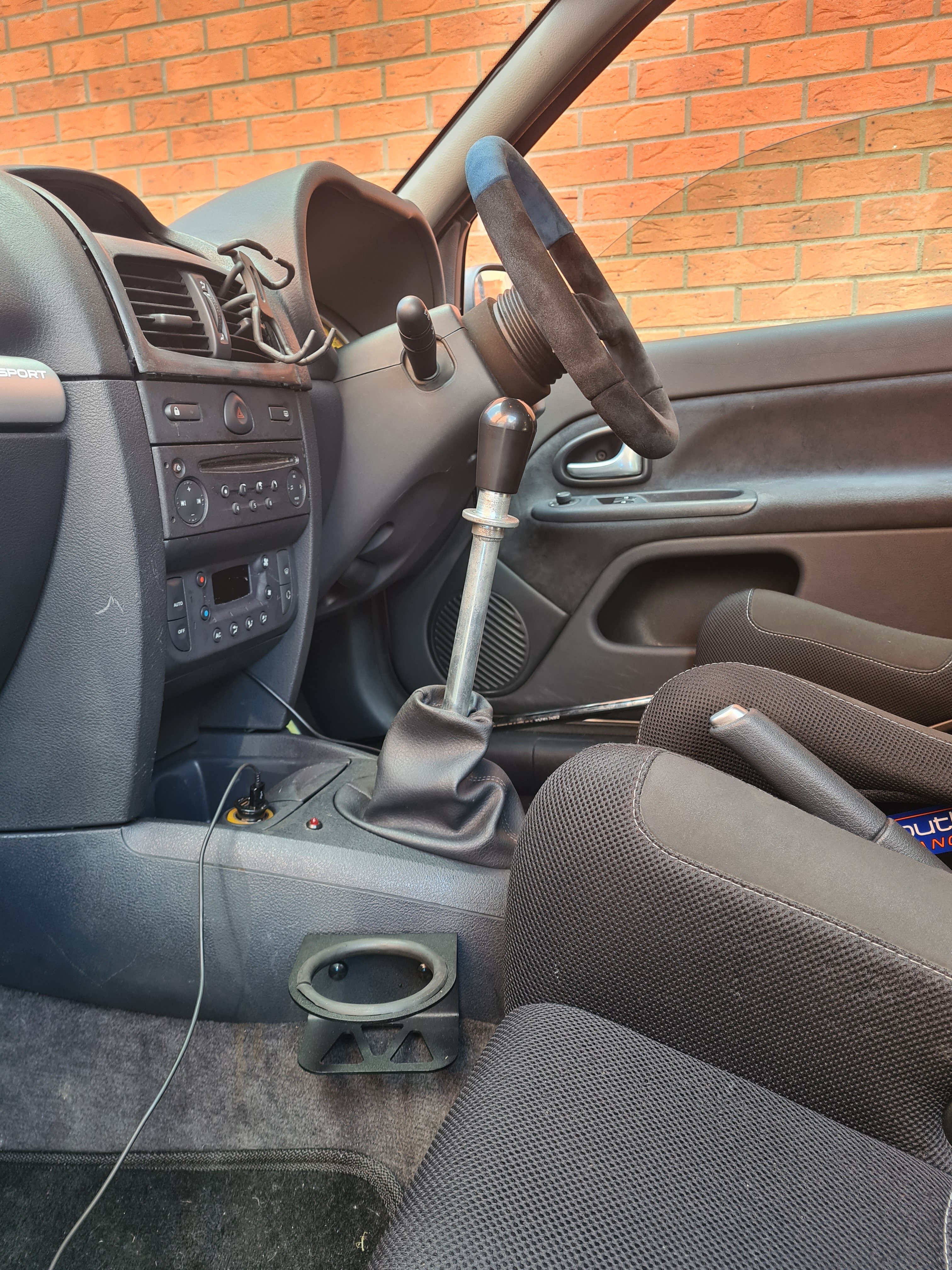

I've arranged a drive out this bank holiday weekend of some of the best roads in Wales. There's a group of 15 of us. The aim is to have fun, take photos, drink coffee, talk shite and raise money for charity.
The route is about 4hrs long. That's when it hit me...

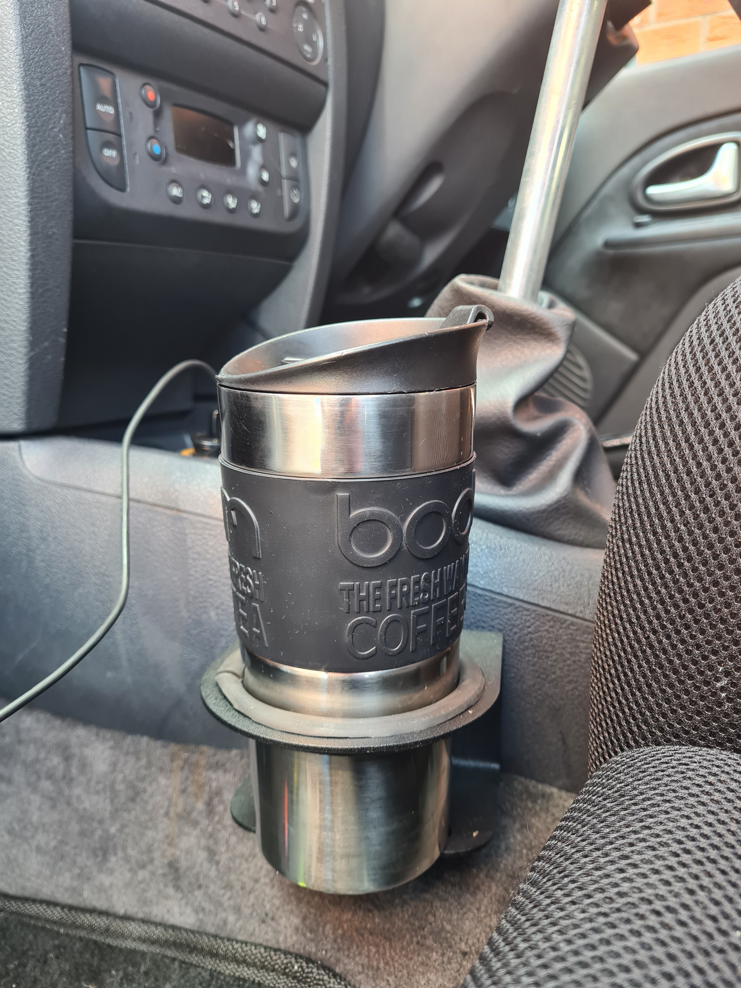

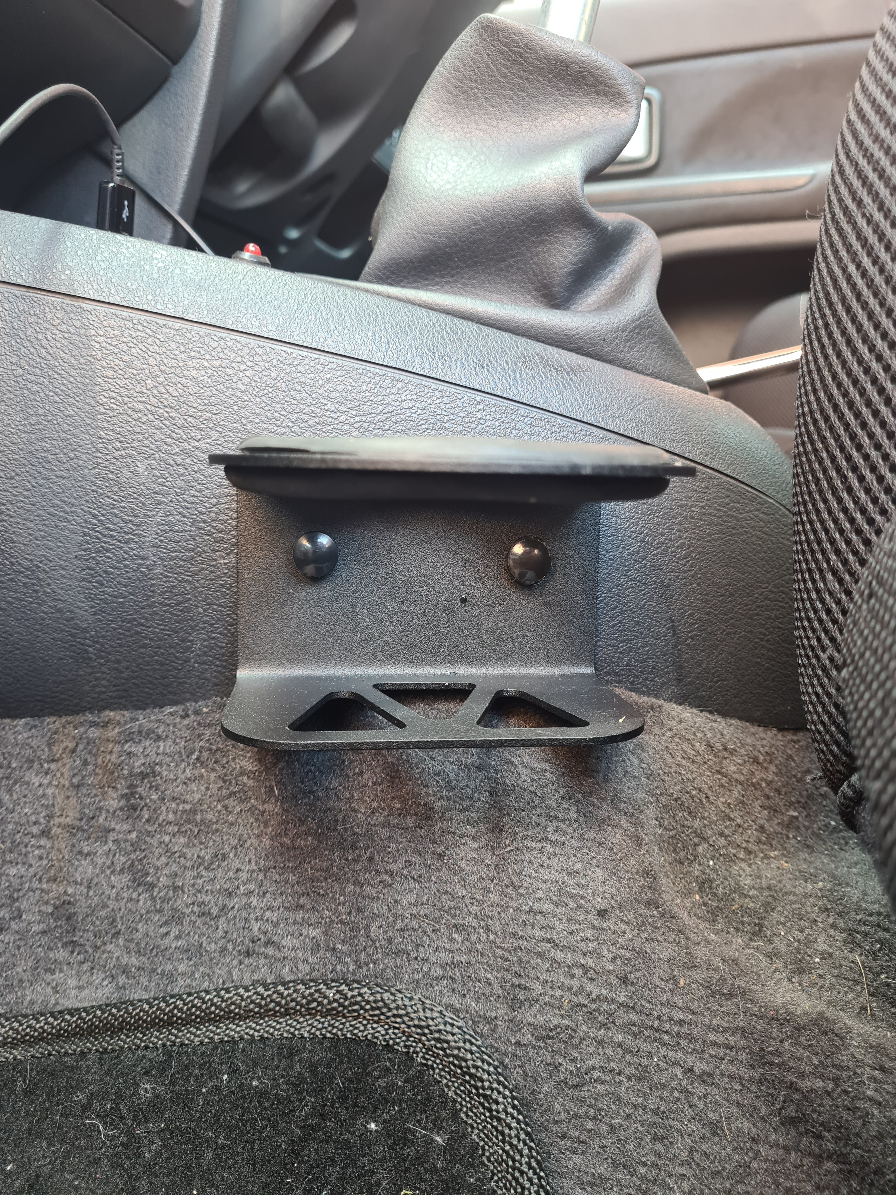

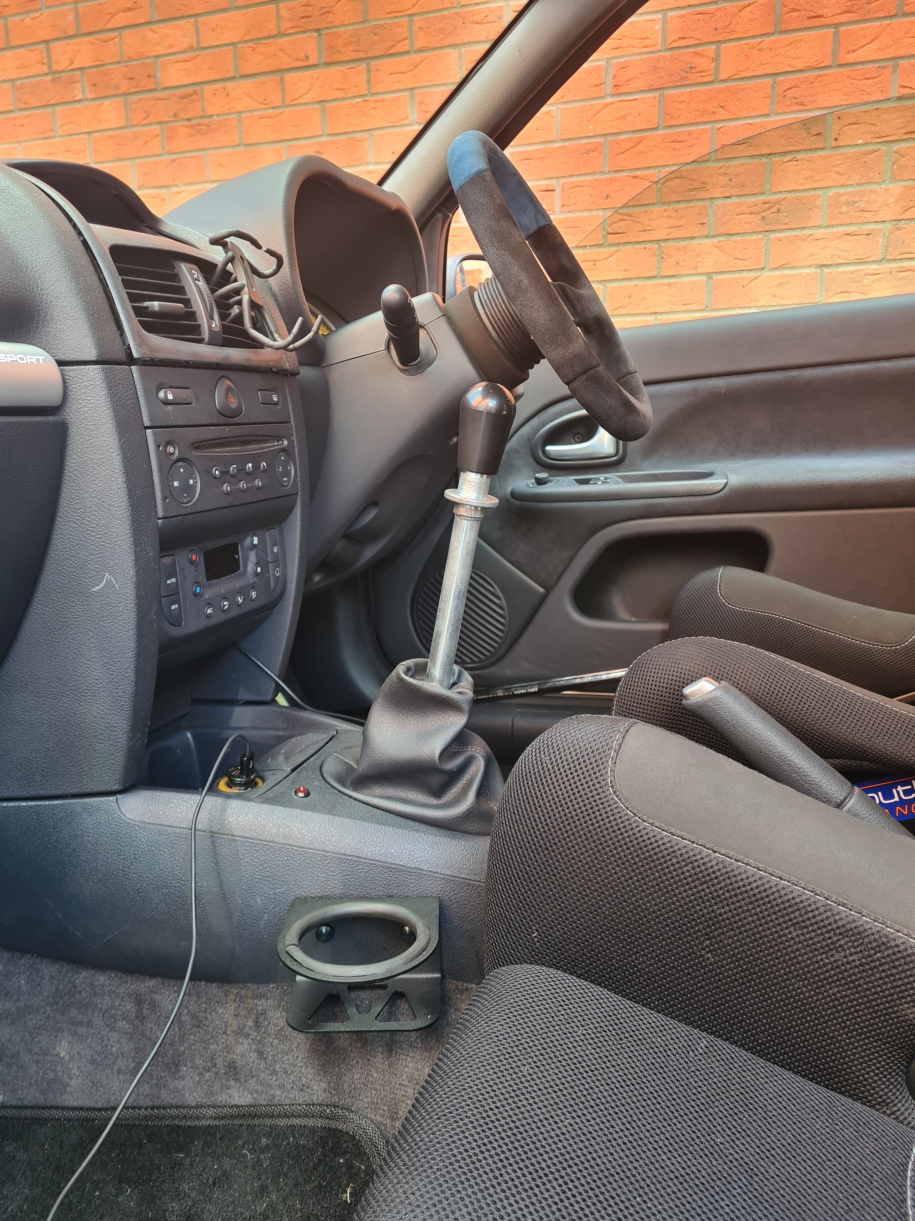

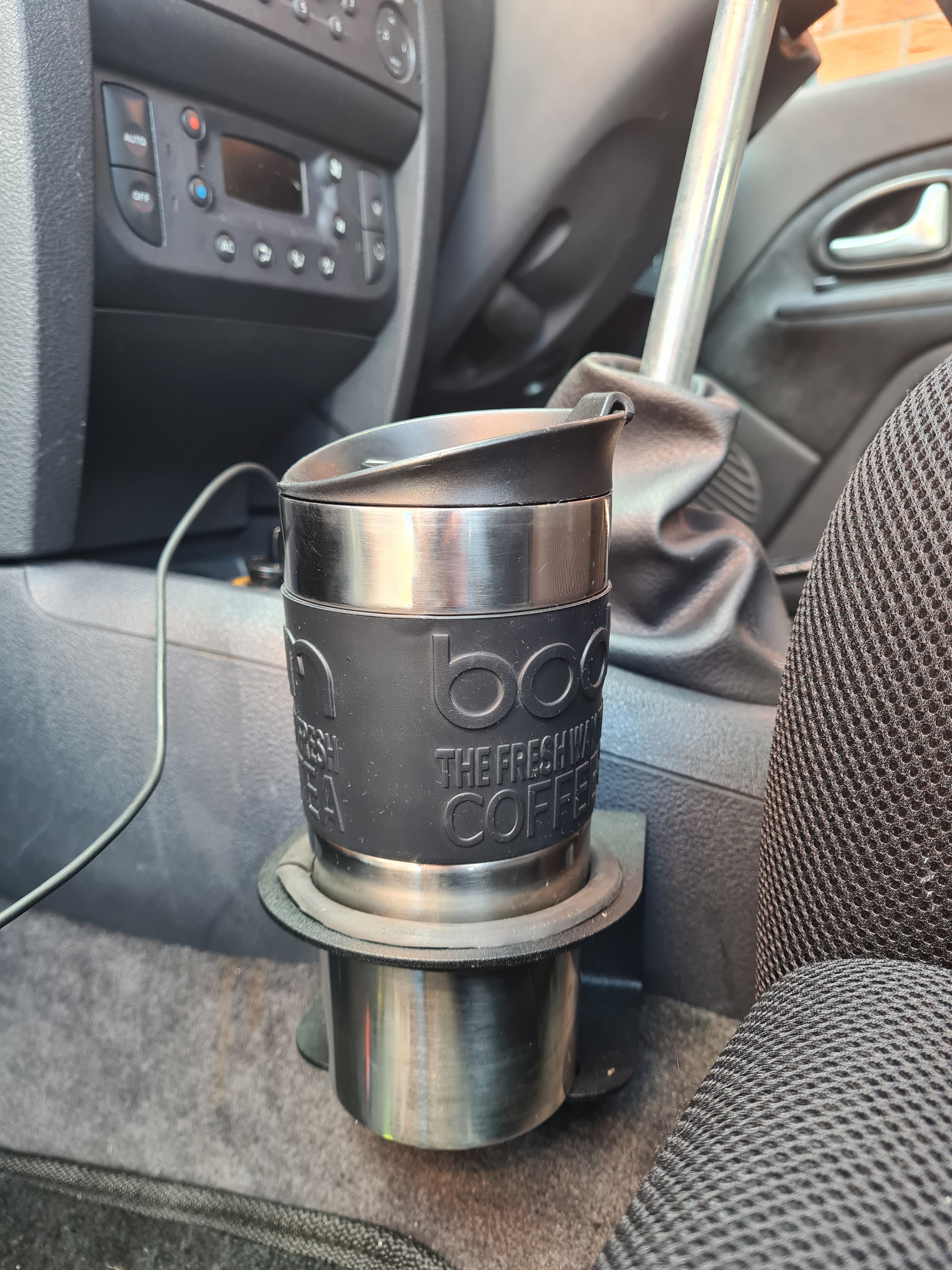

CUP HOLDER for my coffee.

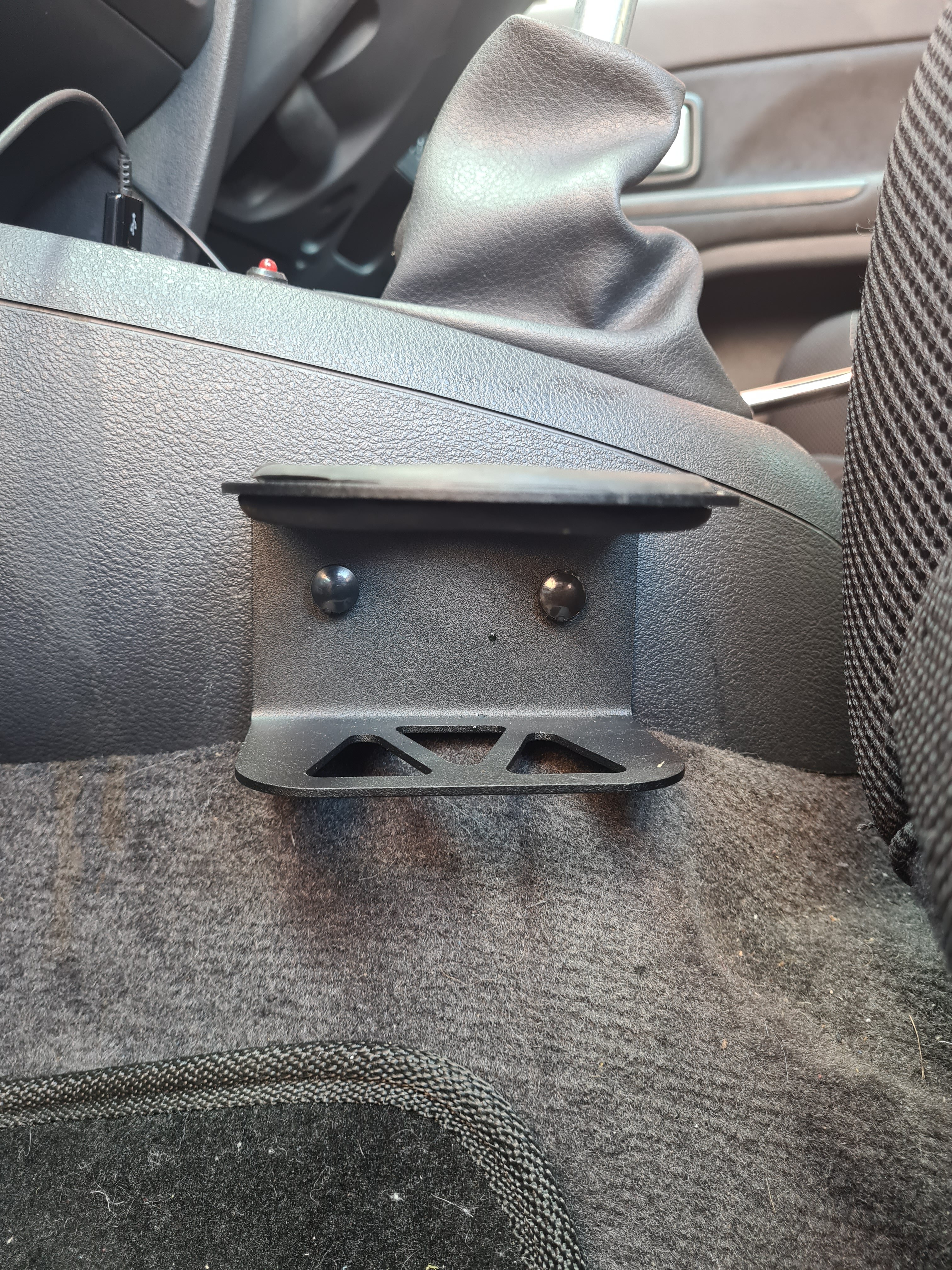

Did a bit of googling and no real answer. I wanted something robust and not flimsy hanging off an airvent.
In steps this bad boy.
As it comes from the ebay seller, its not the best. No screws and the edge where the drink sits is a sharp metal edge.
I used number plate screws with the black caps to give it a better finish and a cut open vac line to coat the edge, giving it a more robust hold. Pleased to say it hold my drink snuggly.
Best mod yet.

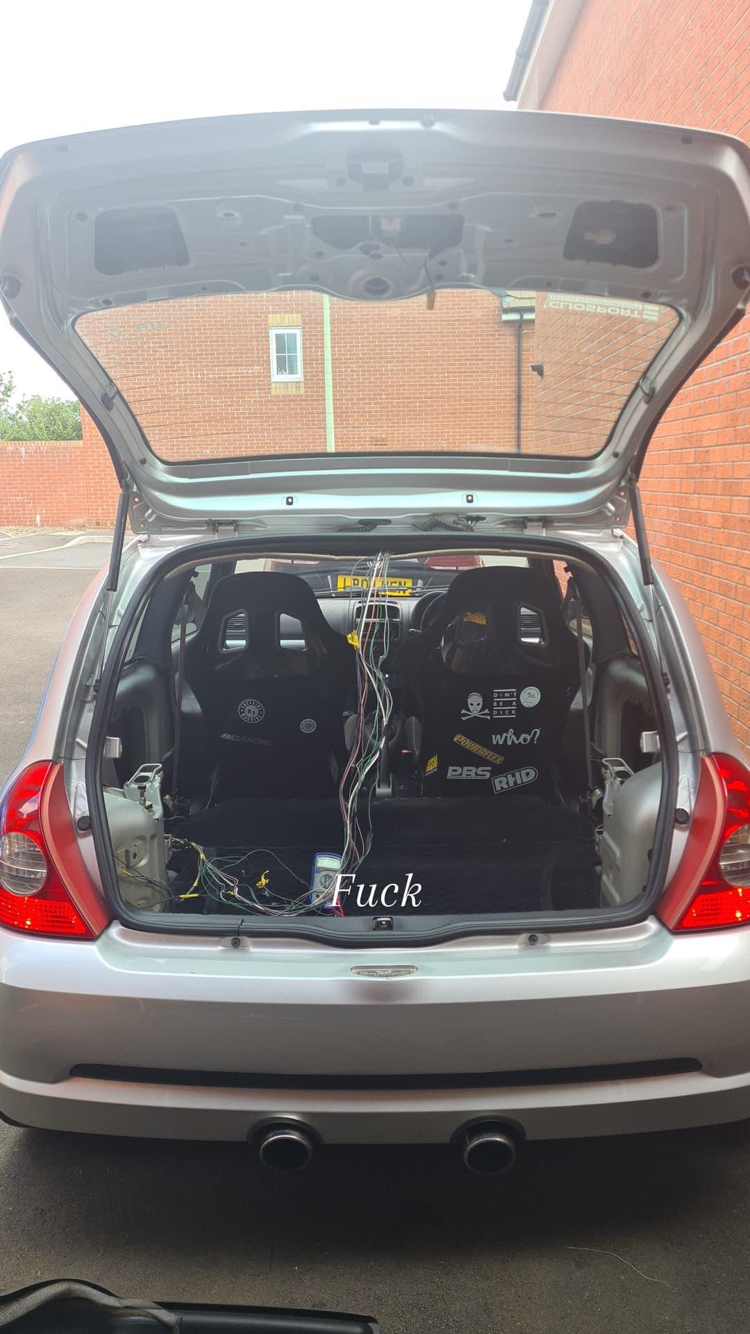

I removed the rear door cards and intend on putting some "track door cards" in place of the originals. This left the wires hanging out looking crap. I'll tidy them up I thought.
Big mistake. In my effort to tidy things up I've lost power to the 3rd brake light? I've put a multimeter on it and nadda
Separately the boot light had power but doesn't light up? It's getting 11volts and nothing. Tried a new bulb nope.
Yeah, help? Any wiring diagrams out there?
In steps this bad boy. View attachment 1554804
View attachment 1554805View attachment 1554806
Best mod yet.
Best update to date.

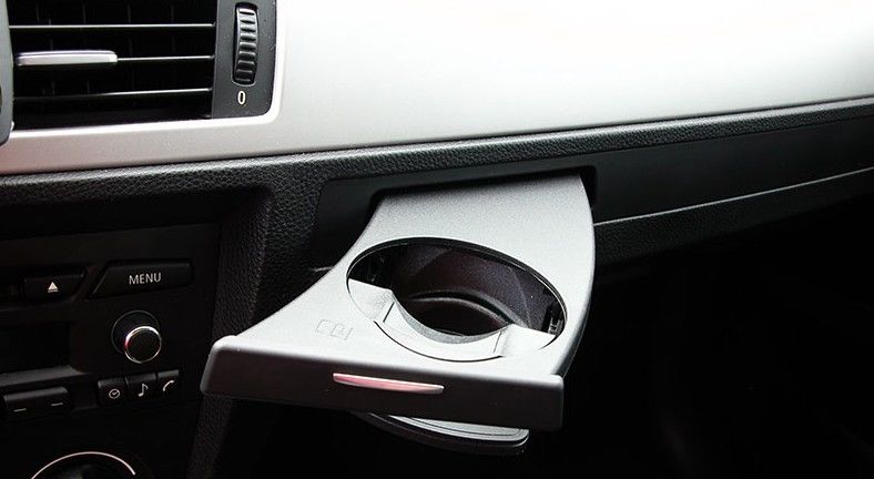

Although I'm with @frayz I'm looking for options for my Clio but would prefer something more OEM. I saw some chap makes a 3d printed one on here which sits behind the handbrake which looked ok.
CFAB
ClioSport Trader
  Cliosport 182 ff
It’s in the pipeline guys, once my Twingo parts are on the shelf il get sorting this out for you lot. 👌🏼
Yarp
  Clio 182, E46 M3
I’d thought about trying to incorporate an e91 cup holder into mine either under the drivers heater vent or in place of the hazard switch panel. The poppy outyness would work well. I bought one then realised I lacked the skill or effort to make it work but it would be a fantastic oem ish solution

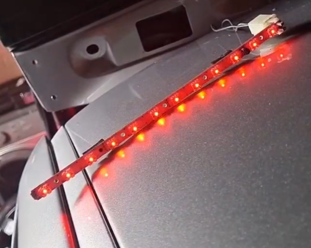

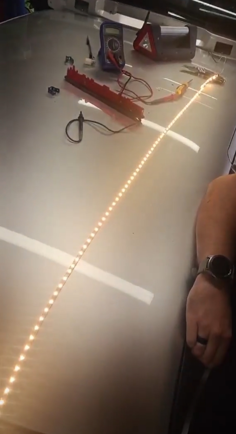

Update.

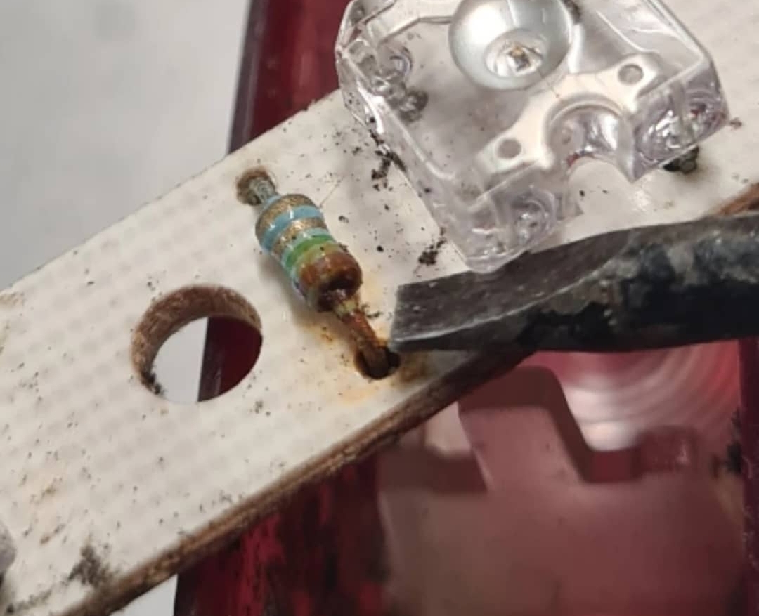

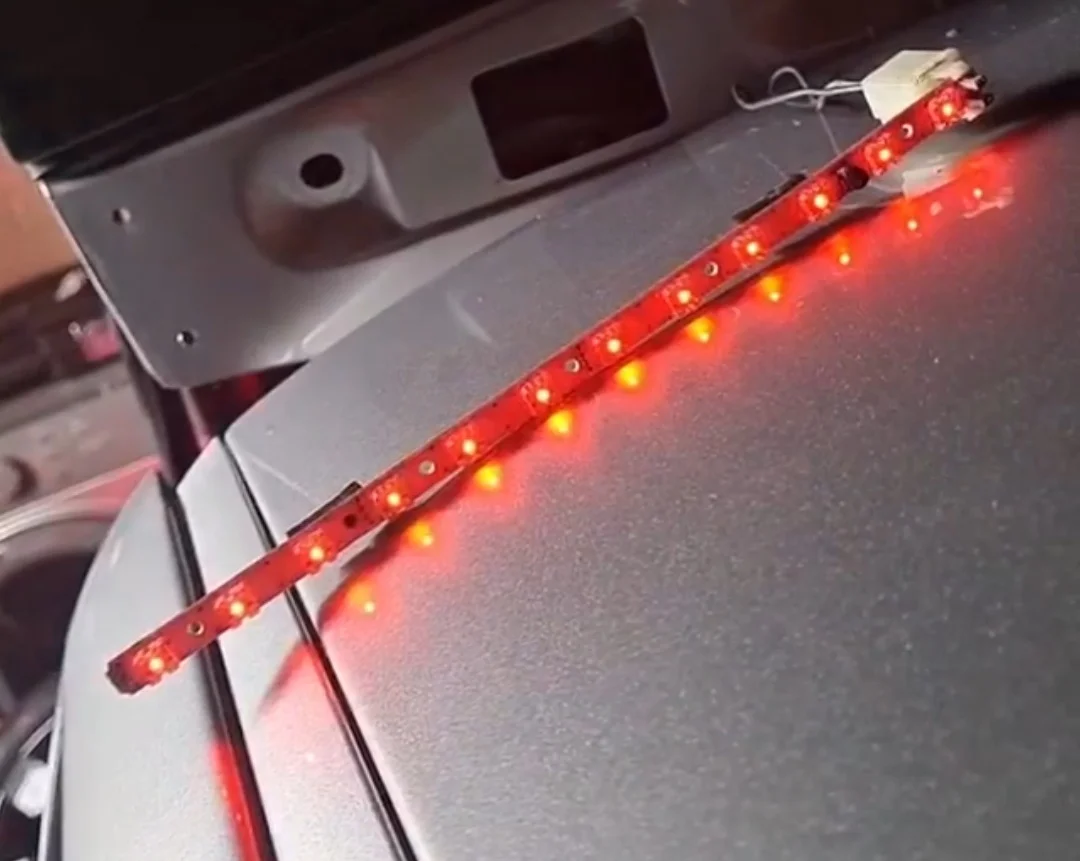

A little while back I lost the third brake light, I've no idea how. We'll, I have an idea and it involves my own stupidity.
Anyway. I did some deep investigation, taking the spoiler off, brake light out and the circuit board off the back.
Just to test if I had an actual feed to the brake light wiring I plumbed in some Christmas LEDS.
Which to my delight worked. So I knew the issue was with the light and not the wiring. I did contemplate cutting the LEDS down and putting them in the brake light housing, I mean of it works right?
I took my attention back to the renault brake light.
This little crispy bugger was barely connected so I ripped that off. Doesn't work so what do I have to lose?
I don't know what that Resistor did but it isn't needed it seems.
All back together and I have a working 3rd brake light.

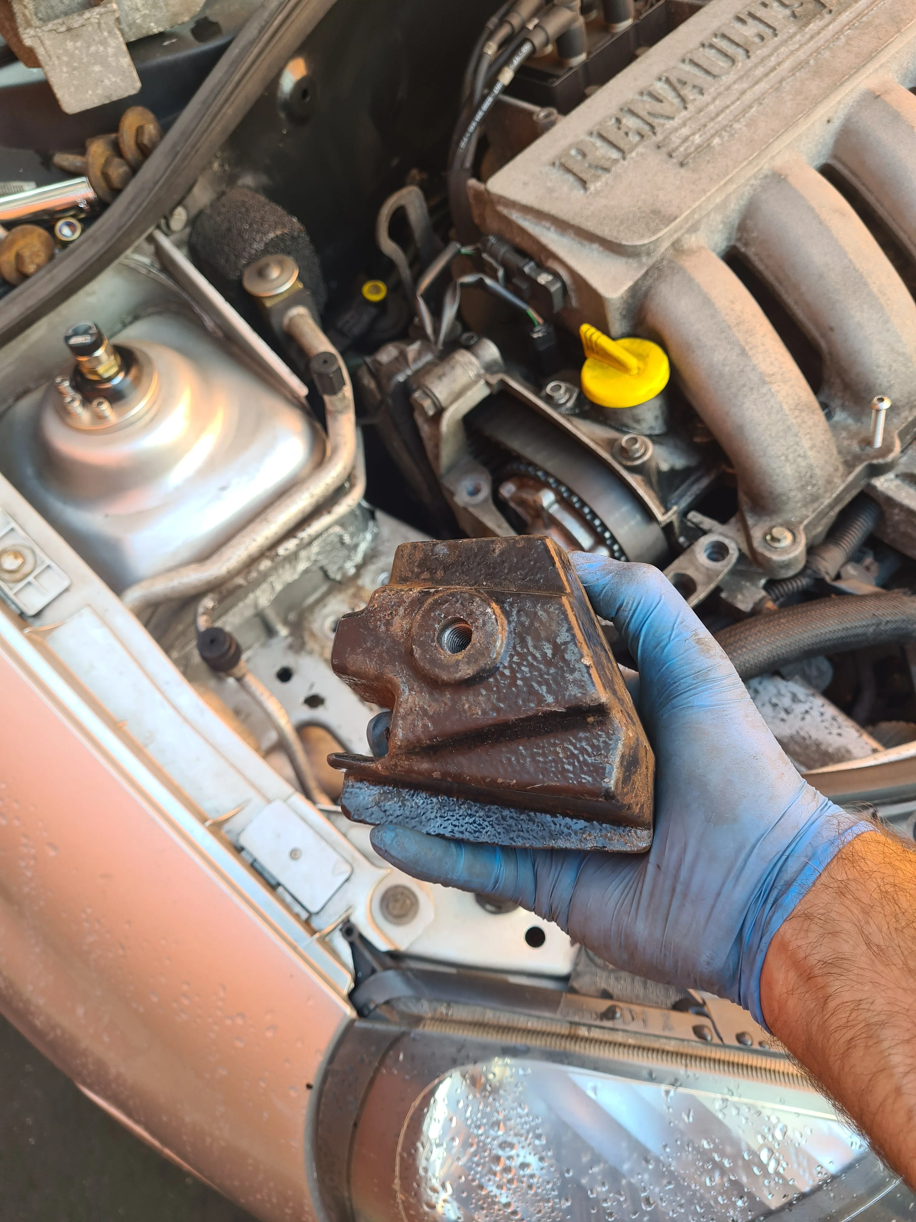

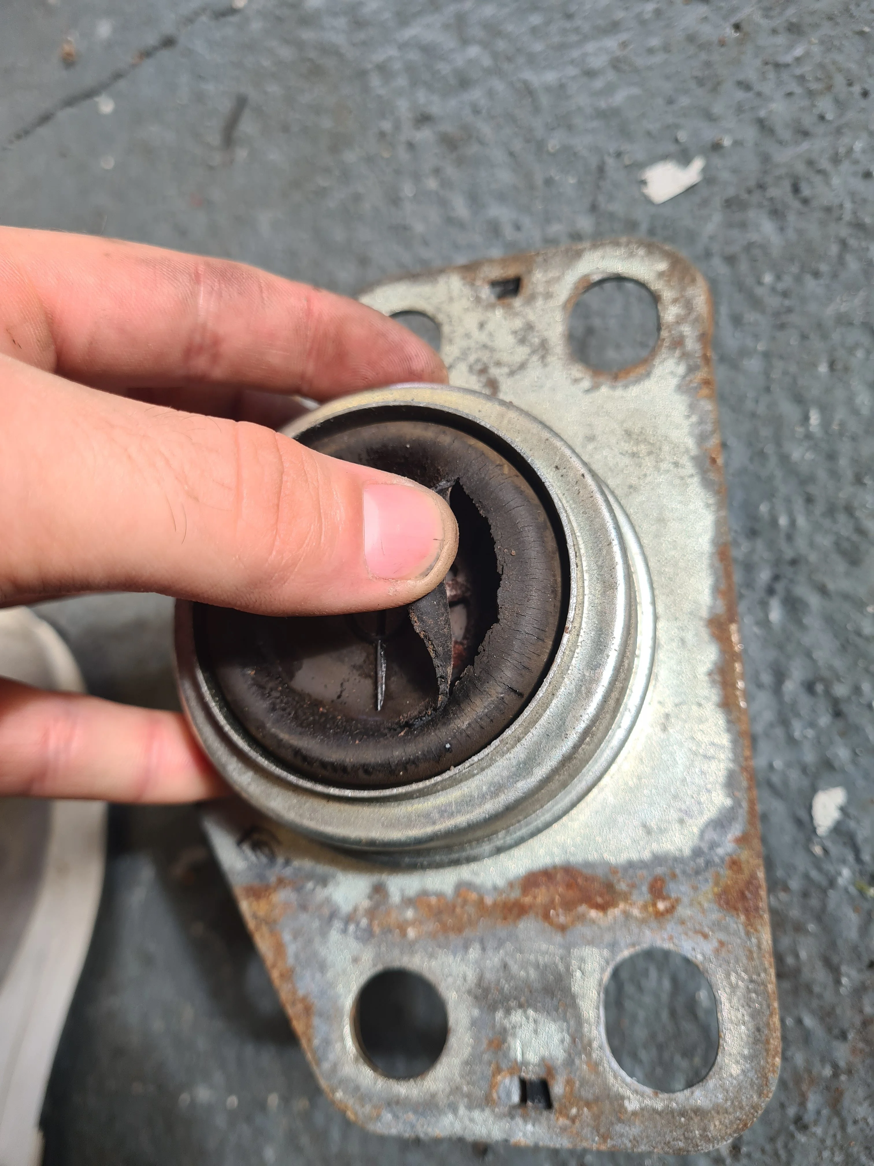

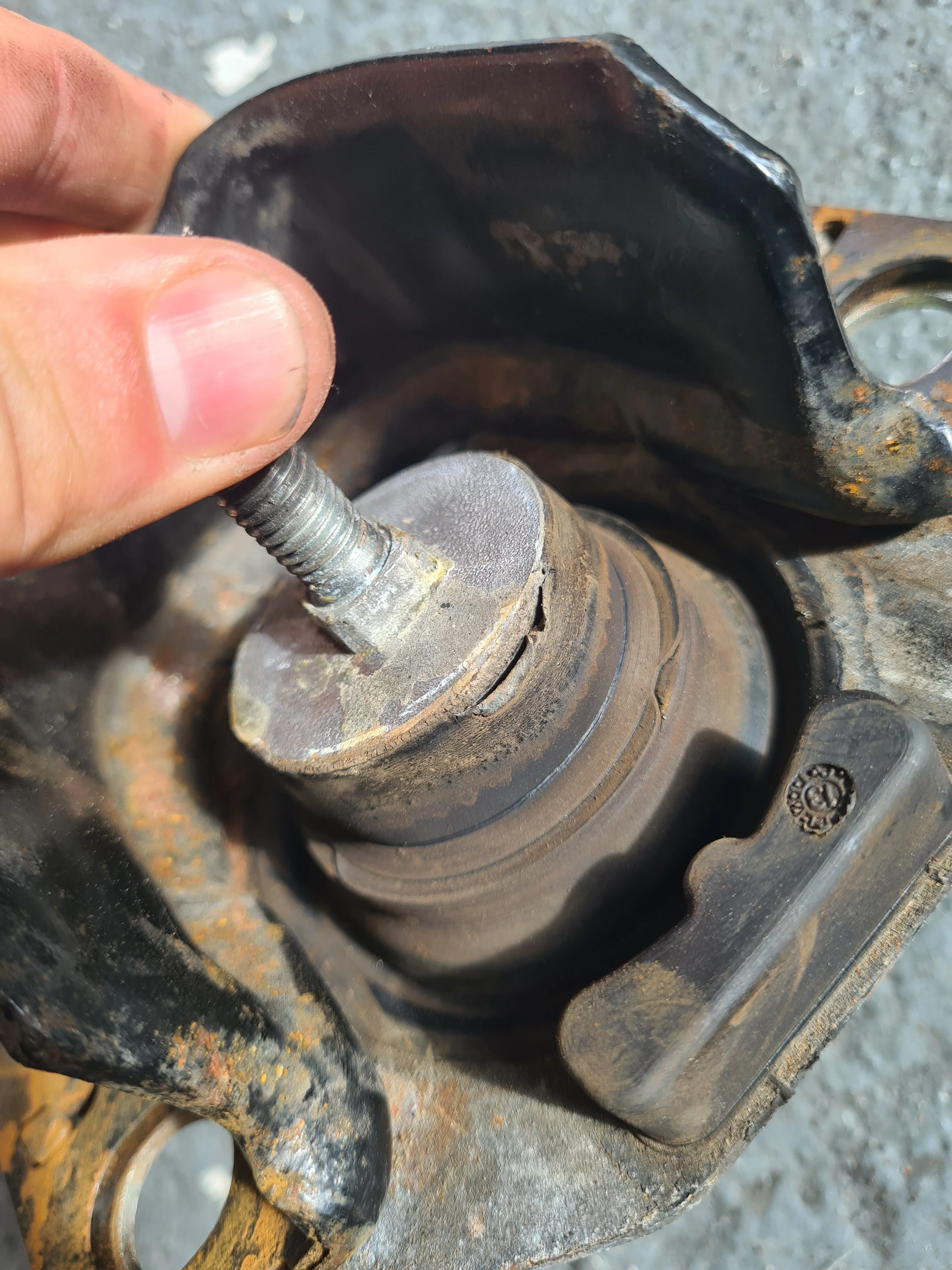

I replaced the Orange indicators with silver tech ones, don't worry that's not the update. While I was doing this, one thing lead to another and I ended up removing the chunk of metal that sits below the engine mount.

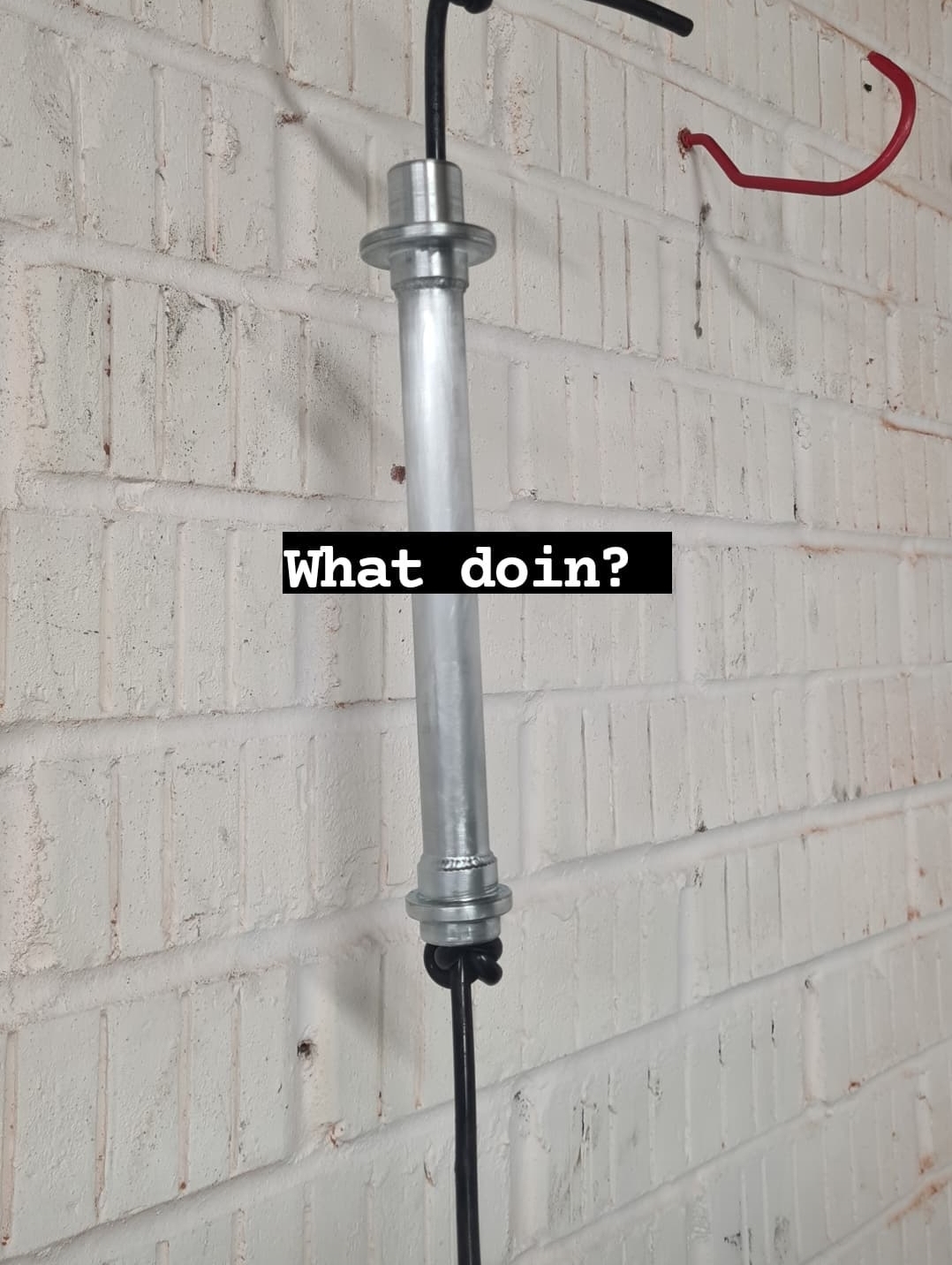

Fair bit of weight to this.
Which then lead me to notice this.
So I've ordered a new mount and currently looking for some fresh bolts and washers.

Any noticeable increase in vibrations? Are these fitted to cups, If they are why didn't they rip them out in their weight saving frenzy I wonder?
MrBlonde
I still have that metal lump on mine also that i want to remove,im not sure on what its for tho maybe something to do with headlight adjustment or to reduce vibrations🤷🏼‍♂️
Was it easy to remove? @bowen86
DomP182
  ph1 172, Arctic182
I believe its to harmonise vibrations, like the huge amounts of weight they attach to some Range/Land Rovers
bowen86
I've not actually driven it since removing it. I did however remove it from my previous 182 and noticed that absolutely nothing changed. So take from that what you will.
Mine is a Cup and is/was present. Previous 182 wasn't a cup and again it was there.
I'm lead to believe its a counter weight to reduce NVH from the car but given that it's a 16 year old French tin on coilovers I highly doubt it did anything in my car.
It's probably like the air noise thing under the passenger headlight, probably did something when the clio was being developed, now, not so much. Times and tech, changes.
Very easy to remove.
Support the engine.
Undo the engine mount 5 16mm bolts.
Remove engine mount.
You'll see the bolt that holds the metal chunk to the car.
Undo that, give it to the scrap men.
Put it all back together.
Took me 10mins. If that.

The weight 2.7 kg I weighed mine this morning after removing it.

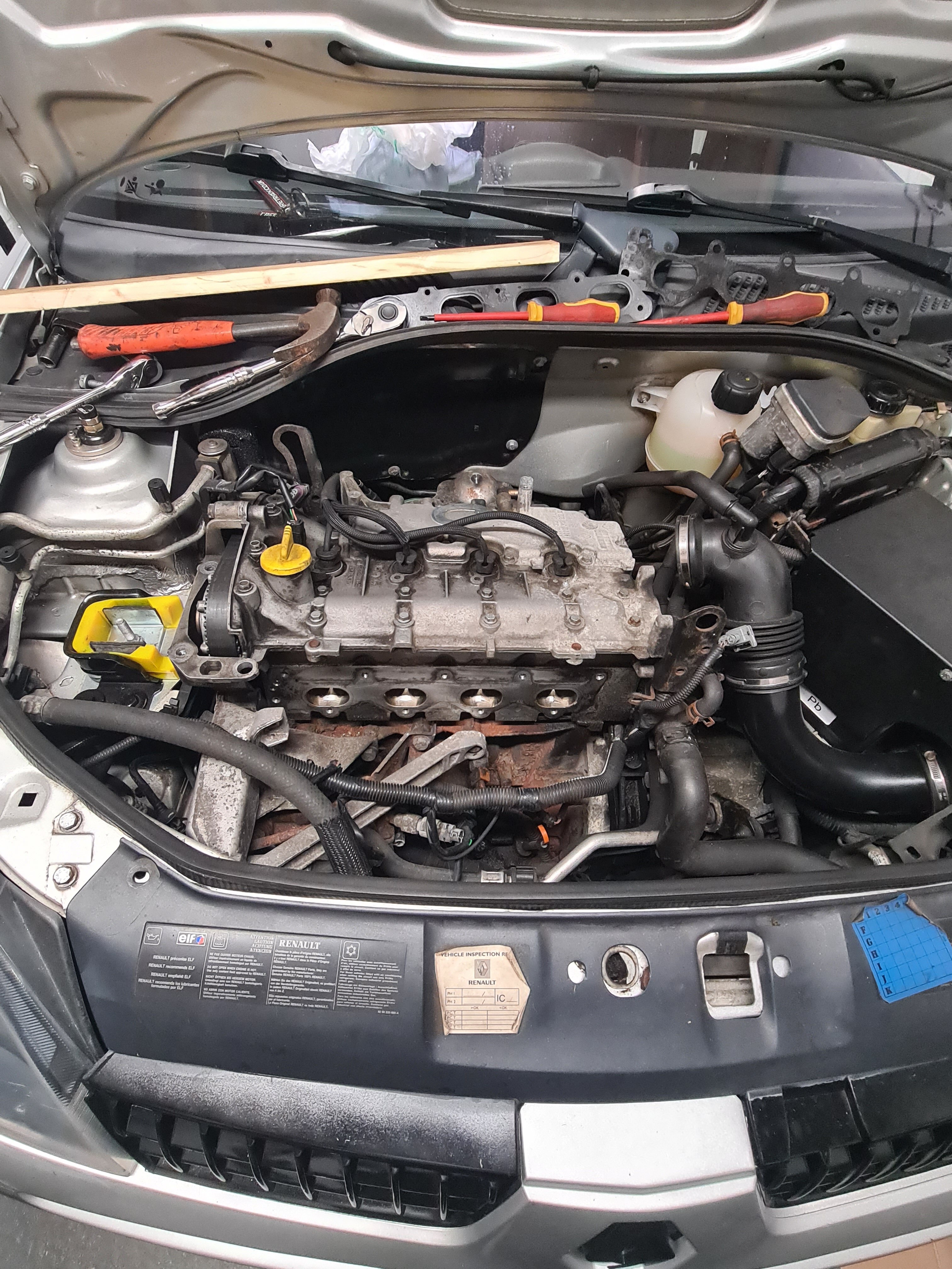

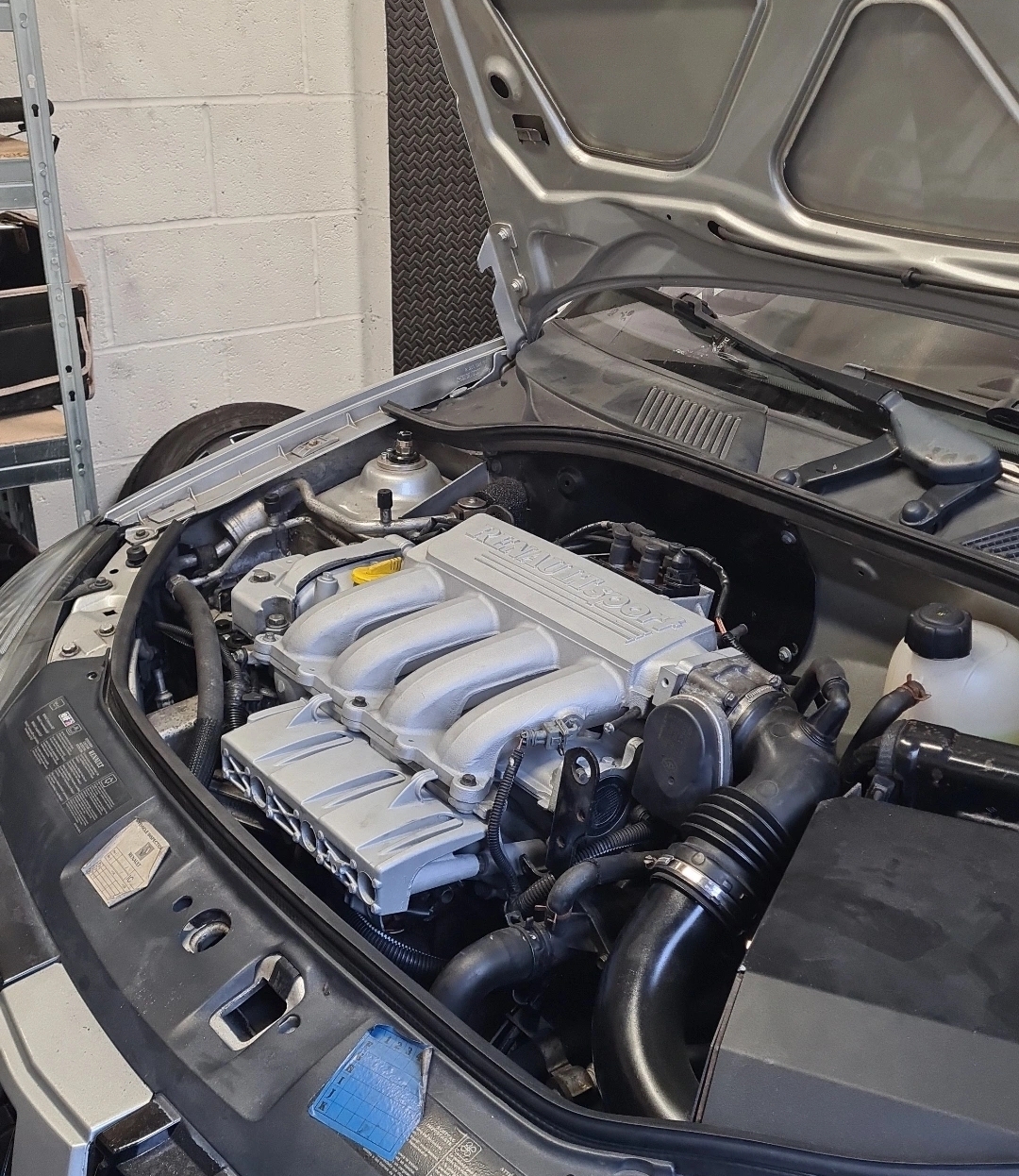

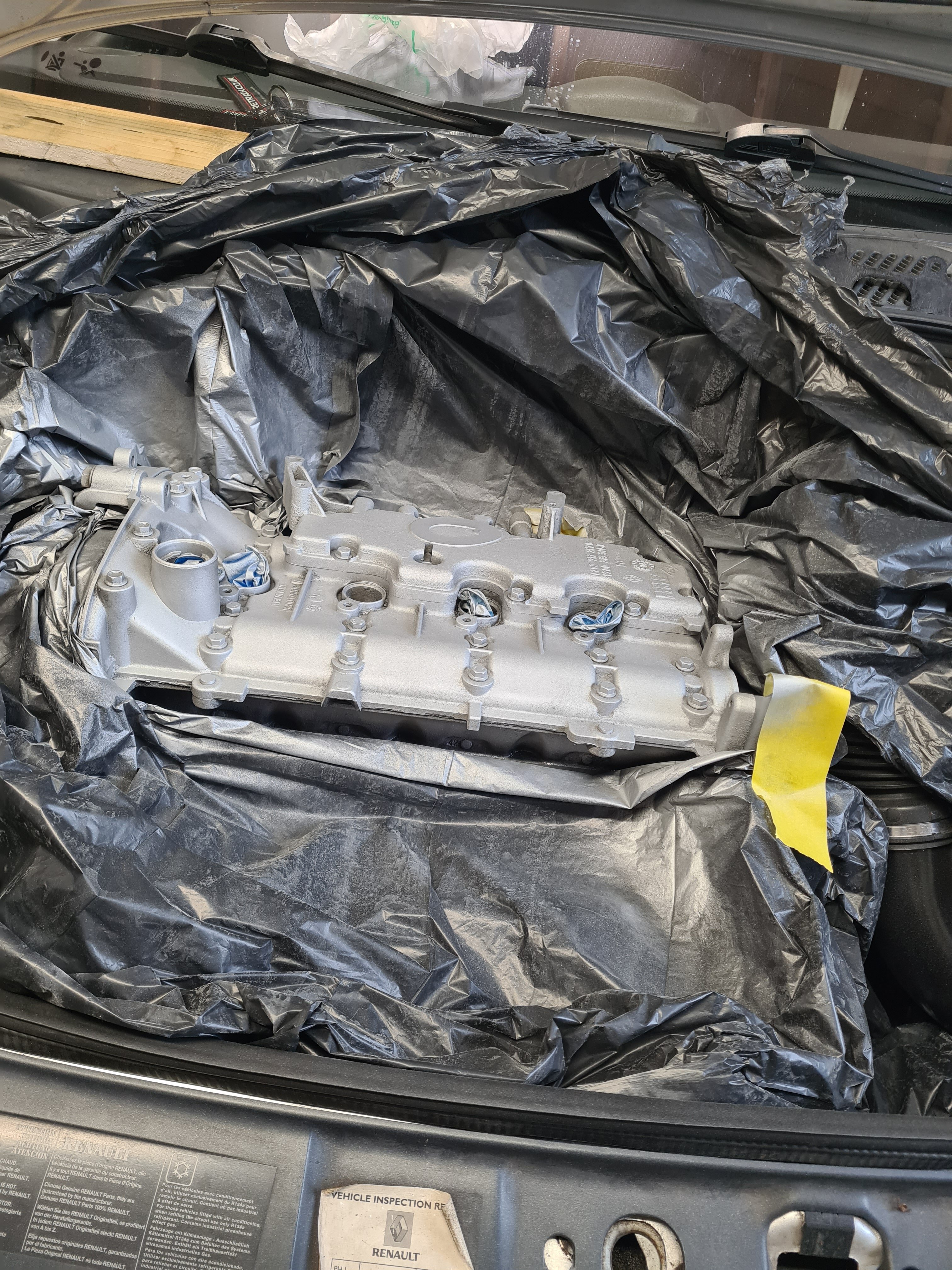

I'm in between jobs, well using up all my annual leave before starting my new job, so trying to keep myself busy.

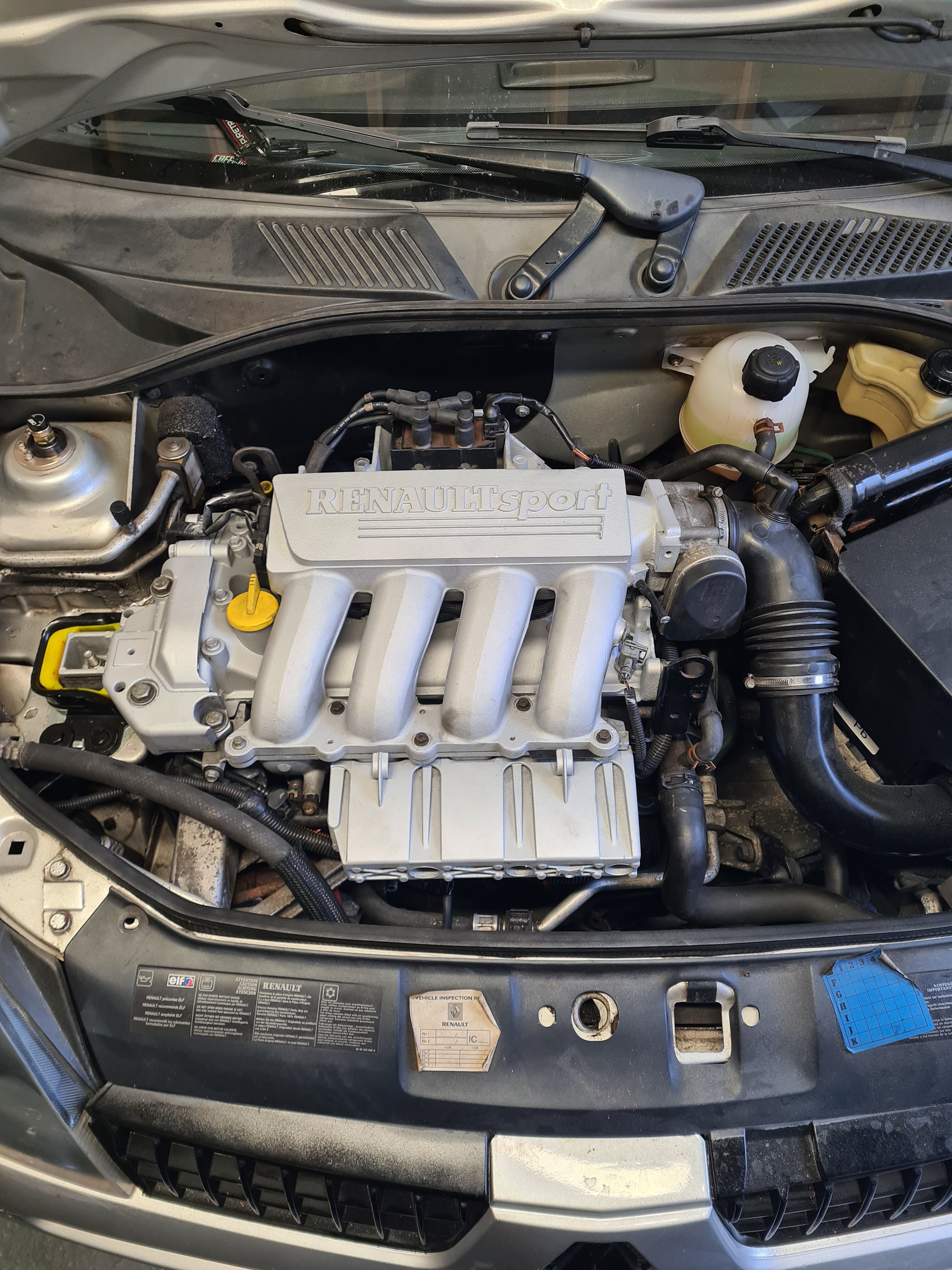

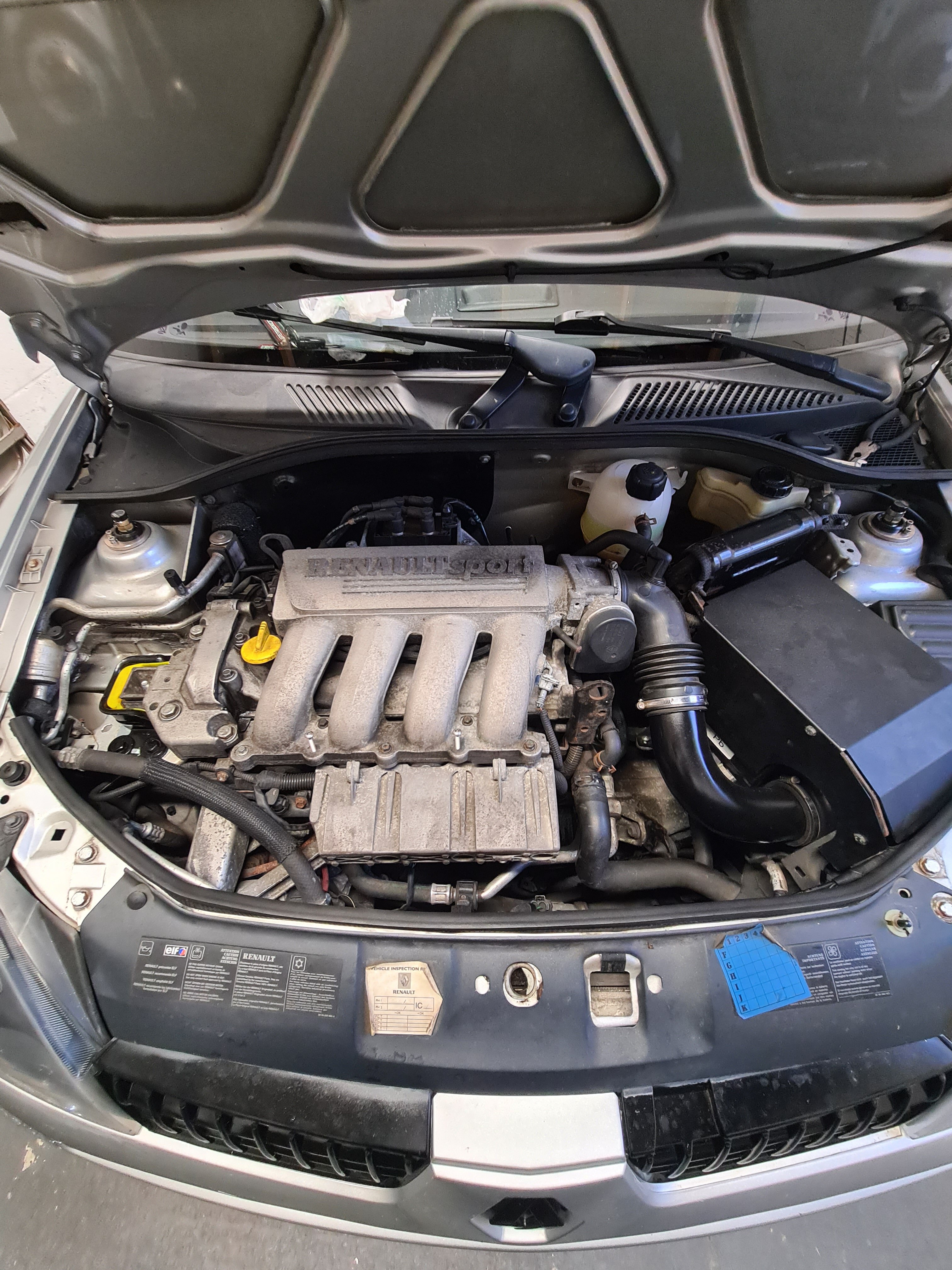

Thought I'd give the Clio's engine bay a spruce.
Before
Apologies the images are huge...
bowen86
I've been meaning to do this for a while but I couldn't bring myself to pay so much for a tiny piece of plastic and the postage be half the price of the item.....
I cannot tell you the satisfaction seeing that piece of plastic fitted and the ugly whole gone brings me. Sad but true.

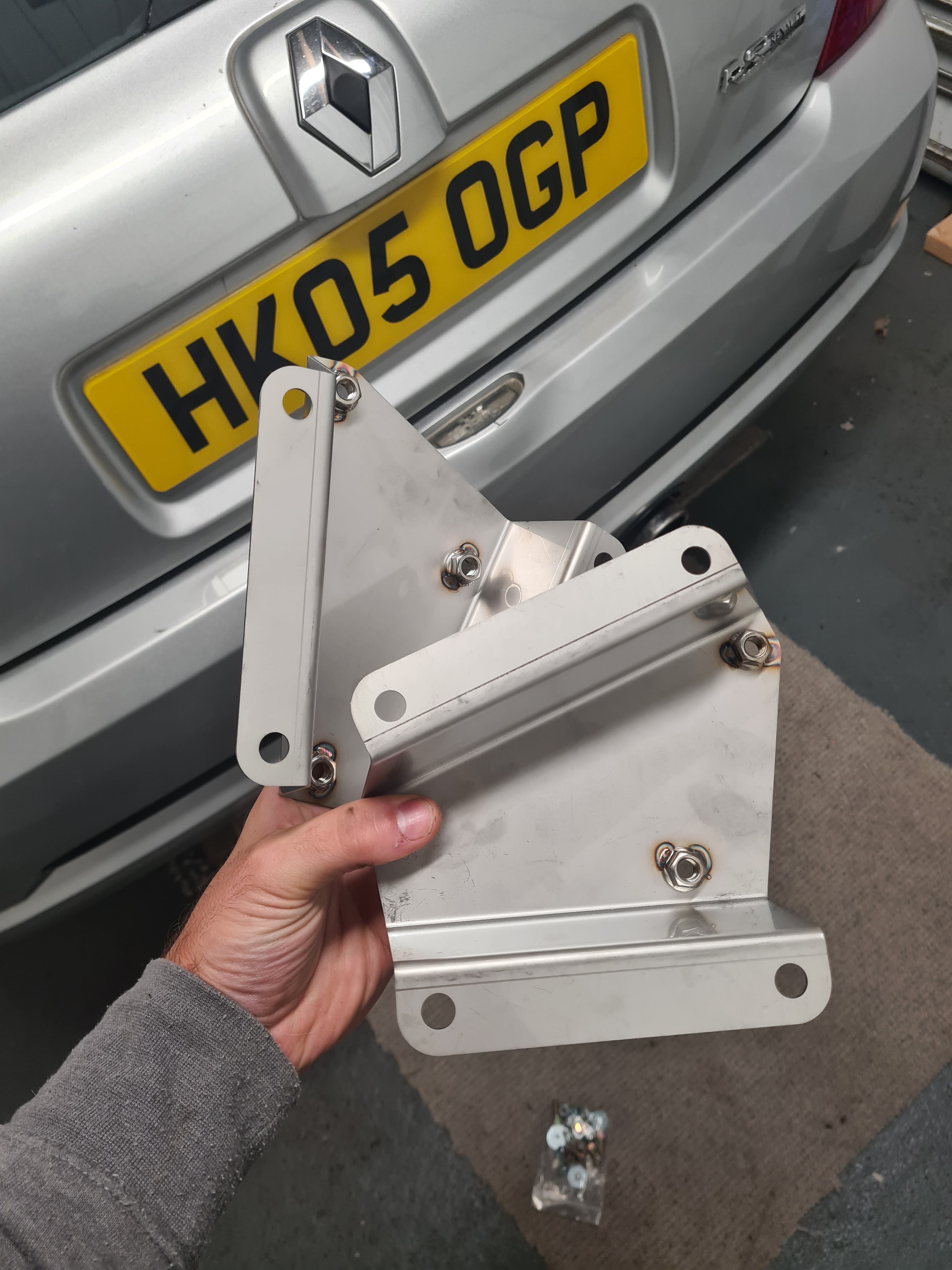

New exhaust hanger supports arrived today from Pro-am.
Great quality product and very reasonably priced too.

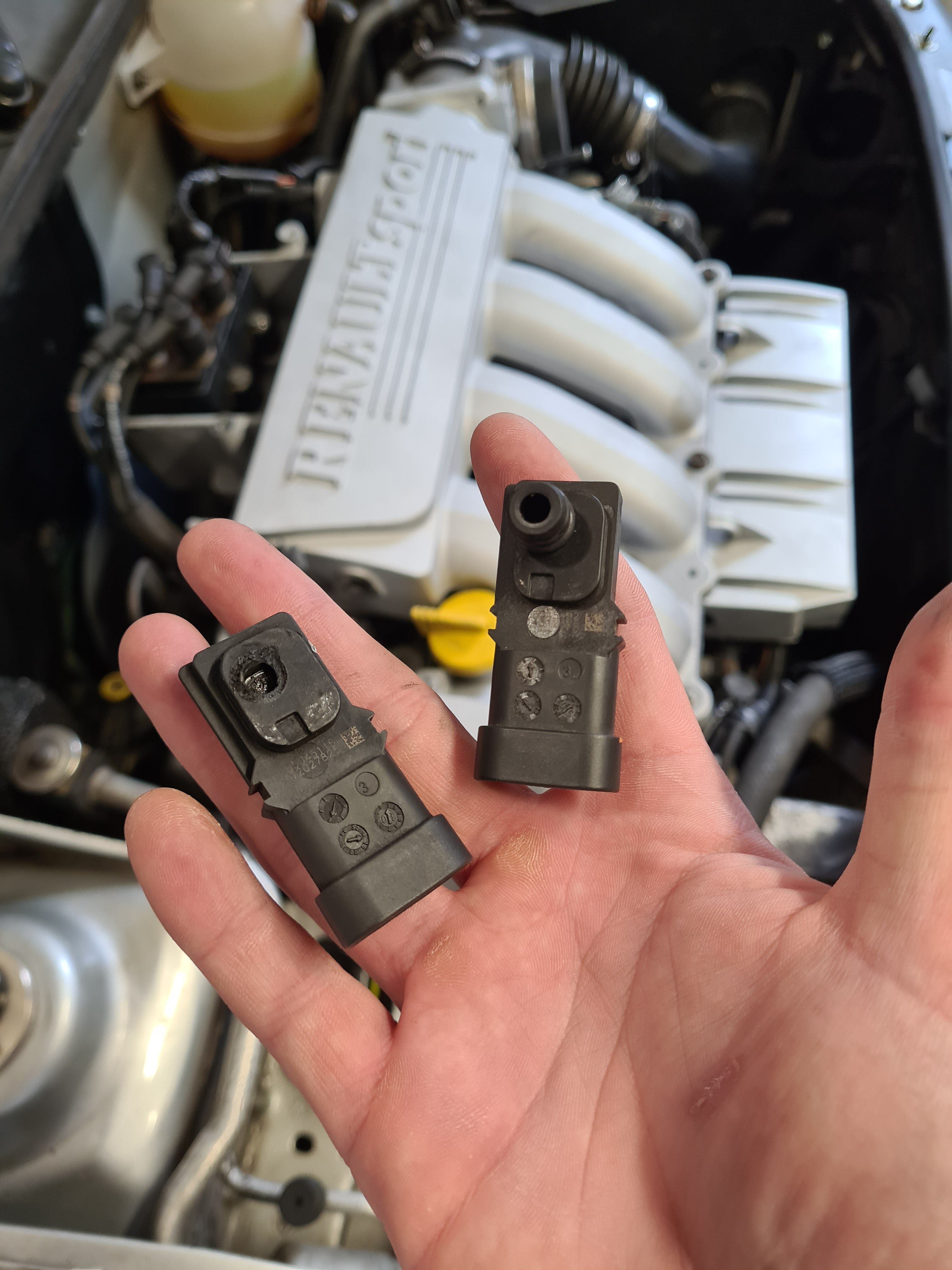

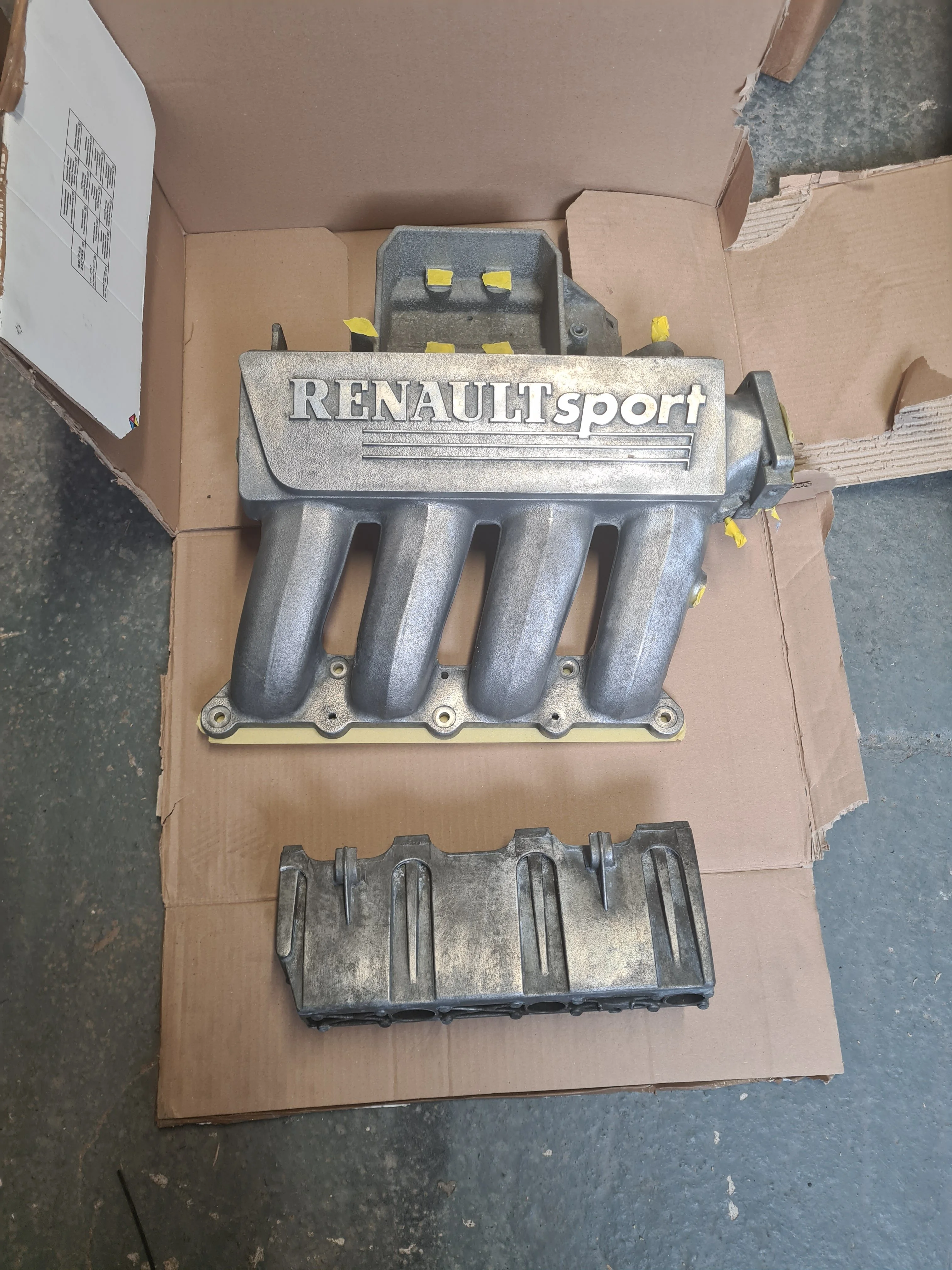

During the refresh of the engine bay I snapped the MAP sensor. A call out on here and @Louis came to my rescue and offered me a MAP sensor, I just had to cover postage. I gave him some beer tokens too and it was on its way to me.
Damaged sensor vs the one Louis provided.
In and the engine fired in to life and after a little while the idle settled nicely.
Thanks again to @Louis for sorting me out.
Glad you're sorted. They're new orings on there too which should hopefully mean they seal well!!
