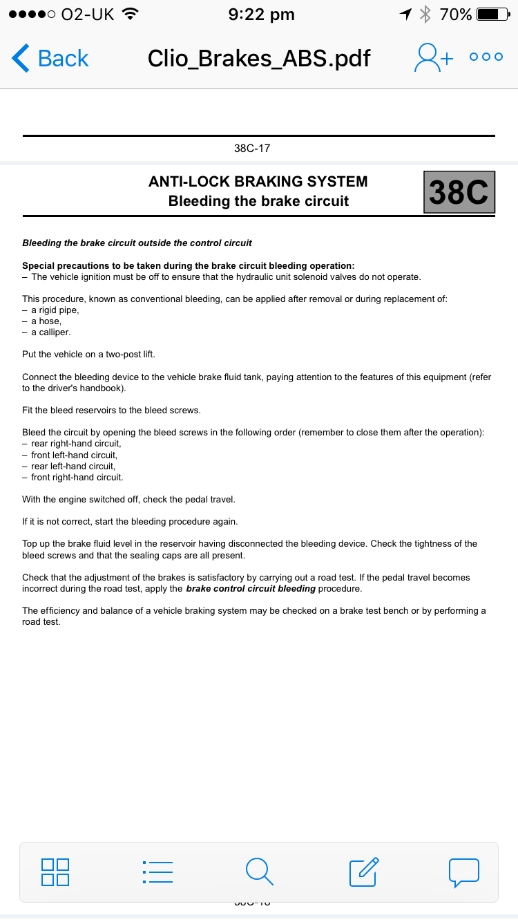

I have read pretty much every relevant thread out there to figure out which order to bleed the brakes on my 172, and frankly, being rude, most of them are a joke 😂. Everyone seems to have an opinion (is an opinion OK for bleeding brakes :tonguewink:🙈), and everyone's opinion is different :grimacing:.
Anyway, this is what I found in an online Clio manual:
Now I've translated that to:
1. o/s rear - because longest run/circuit.
2. n/s front - because same circuit as 1.
3. n/s rear - because 2nd longest run/circuit.
4. o/s front - because same circuit as 3. and the only one left :wink:.
I've also read that it doesn't really matter what order , but let's assume I'm going to do the OCD method, can someone who knows concur with the above? I know I got it from a manual, but it's still nice to have reassurance from the knowledgeable and experienced :blush:.
Many thanks :up:.
