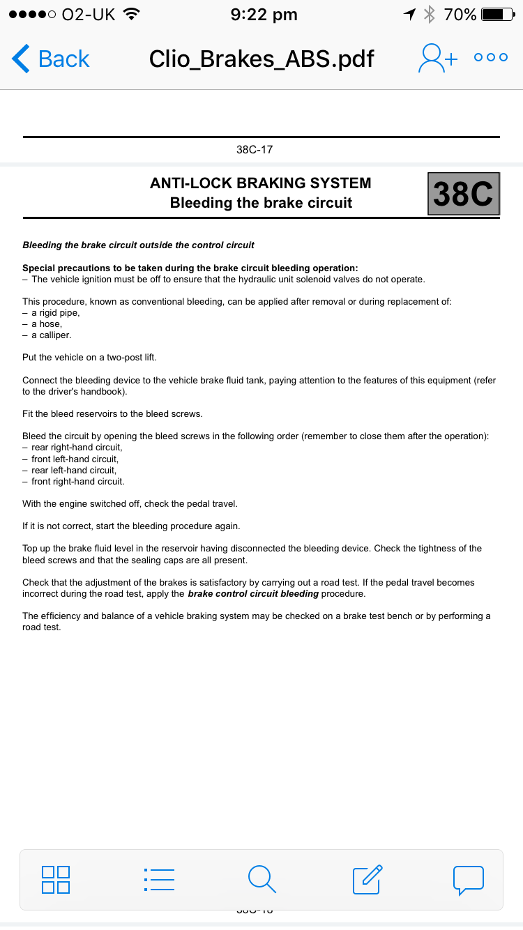

I have read pretty much every relevant thread out there to figure out which order to bleed the brakes on my 172, and frankly, being rude, most of them are a joke 😂. Everyone seems to have an opinion (is an opinion OK for bleeding brakes :tonguewink:🙈), and everyone's opinion is different :grimacing:.
Anyway, this is what I found in an online Clio manual:
Now I've translated that to:
1. o/s rear - because longest run/circuit.
2. n/s front - because same circuit as 1.
3. n/s rear - because 2nd longest run/circuit.
4. o/s front - because same circuit as 3. and the only one left :wink:.
I've also read that it doesn't really matter what order :confused:, but let's assume I'm going to do the OCD method, can someone who knows concur with the above? I know I got it from a manual, but it's still nice to have reassurance from the knowledgeable and experienced :blush:.
Many thanks :up:.

The manual is the correct James may way of doing it.
I followed a megane haynes manual for cars with abs. Brakes were spot on after getting all the air out of the abs pump :D

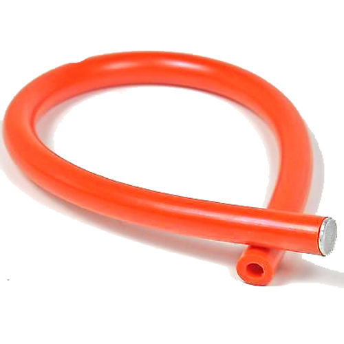

Like @JB21 said . Bleed in any order , it doesn't matter . Just make sure you keep the reservoir topped up . I use one of these tubes , cut in half with some tubing in the middle joing each part together . One end onto the cracked open bleed nipple , the end with the rivet into an old jam jar/ container . Half a dozen pumps on the peddle , top up the reservoir , another half a dozen pumps , top up again , maybe another half a dozen pumps and top up the reservoir if there's alot of air in the system then tighten up the bleed nipple and move onto the next caliper. Job done.
You don't need a flare spanner , just a ring spanner . I've changed all my bleed nipples for stainless ones because the original ones can be tight and shear off easily .

I use one of these tubes, cut in half with some tubing in the middle joing each part together. One end onto the cracked open bleed nipple, the end with the rivet into an old jam jar/ container .
Cut in half and tube in the middle - is that just to extend it so its long enough?
