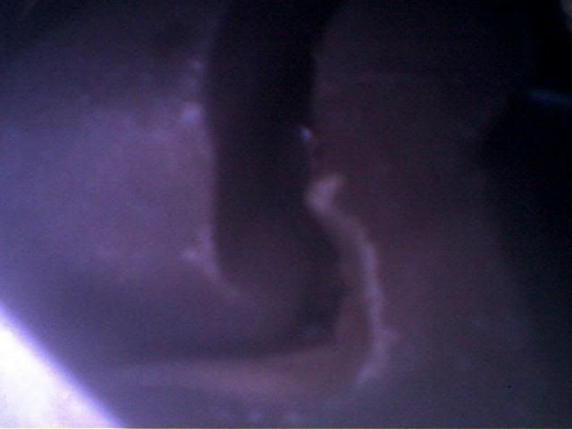

There is a gap between the two parts of my break caliper that wasn't there before the pads were changed. Is this normal?

http://i39.photobucket.com/albums/e172/discodave82/caliper.jpg
here is the pic I will try and get soem better ones if this doesnt explain. Basicaly these two parts used to meet with no gap.
Cheers Dave

LOL mate - it looks quite simply as this.
Thats the caliper wrapped around the pad carrier. As the pads have worn down the caliper has got closer and closer to the pad carrier - making it seem as though they were together.
Now you've fitted new pads the gap has re-emerged.
I might be wrong, i don't think I am - without further pics anyway, but it looks perfectly fine.
I'm guessing your brakes work? lol.
Yeah the breaks work. I kinda guessed it was that.
U know how it is though when u see a new gap that wasn't there before!! :)
I got new disks and pads so the gap is probably even further highlighted by the fact that everything is new!!
Cheers
Yup, I know what you mean matey :) Hehe. If you have any major concerns you could always ask a local garage to confirm its ok. Piece of mind and all that. :)
