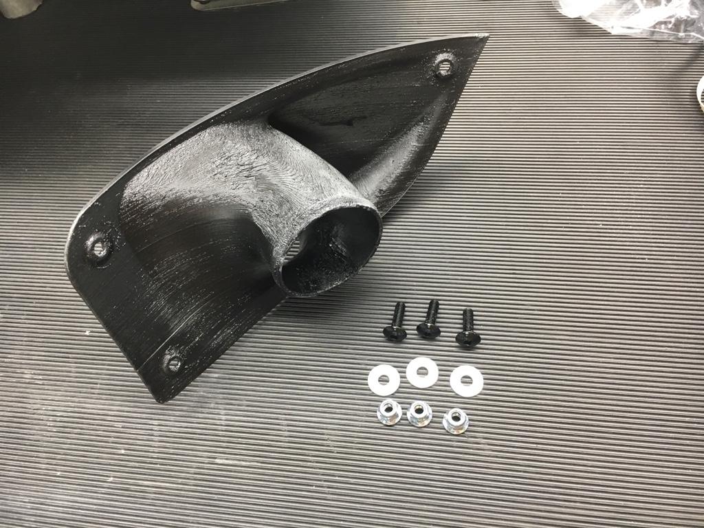

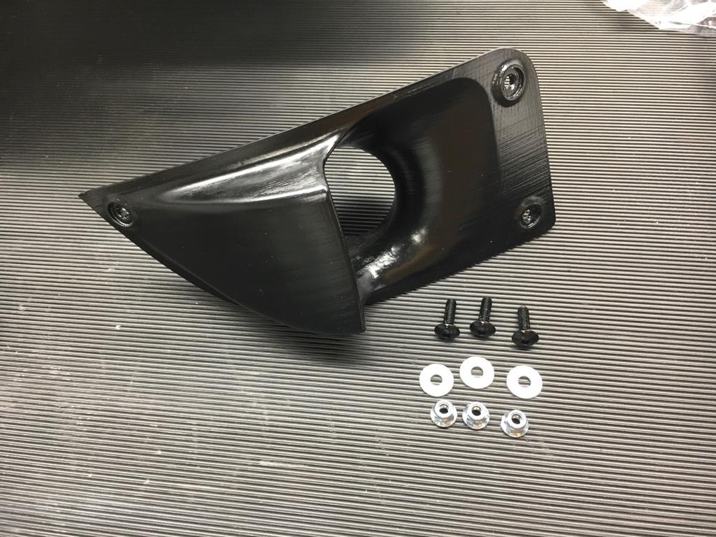

I have to agree with Kev.. the rears really don’t do anything, during hard braking, with the weight transfer you get you only have about 15% of the cars weight over the rear axle.. (doesn’t take much to lock the rears) I run std rear discs and OEM pads on our race car (still on the same discs and pads I fitted to the car about 2years ago, 10 track days and 8 race weekends in) .. Changing rear pad friction material will just change the brake balance really, making it easier to lock the rears (unless u have a bias valve and put more bias to front, but then negating extra friction)
It’s all about the heat dissipation of the front discs.. brake fade is just caused by a disc getting too hot and not being able to convert anymore kinetic energy into heat.. the harder you press nothing is going to happen.. what you need is better brake cooling or a larger surface area to dissipate the heat, I.e a larger disc or a better vented disc etc.. pad material really doesn’t affect brake fade at all.. all pad material really does is affect the friction coefficient which in turn affects how fast the rotors heat up (which is what you feel as bite) .. one thing to consider too is you can only ever decelerate as quickly as the grip of your tyre allows (something a lot of people overlook when upgrading their brakes)
I use:
- OE rear discs and Pads
- Brembo HC discs and CL RC8 pads in std calipers at the front
- new custom brake scoops and ducting to caliper being fitted to aid in our 45mins races.

I think you are disagreeing lol
I upgrade the back. If the suspension is not too soft you get a benefit. I find the chassis more stable and doesnt work the front brakes as much as bias is not pushed forward. I'm going more aggressive on the rear of the Clio with its race suspension set up to try to work all four corners as hard as possible.
Those ducts have just stopped me purchasing any other ducting kit! I want! Send a prototype for independant testing lol

Haha yeah i re-read your comment but by that time i couldn't edit mine...we'll have to disagree on that one then lol.. Its way to easy to lock the rears on ours.. If we could get a better weight distribution with more weight at the back then id look at upgrading the rears... There's just not enough vertical load on the rear tyres during hard braking to be able to resist the brake torque, even with std pads etc..
Do you have an internal bias adjustor.. my only thinking is I will have moved the bias back from std with our adjustor, and the rear OEM pads cope fine.... if no internal bias adjustment then you effectively do the same thing by changing to a higher friction aftermarket pad... 2 ways to get the same effect.
And thanks!.. we wanted to do a brake duct that fitted nicely into the exisiting fog surround with no drilling of the outer bumper surface or crazy amount of cutting required. Ours just need the fog light removing and two holes drilling behind the existing fog surround area. They can be removed and returned to std if desired that way.. Nice plug and play solution is what were after.
