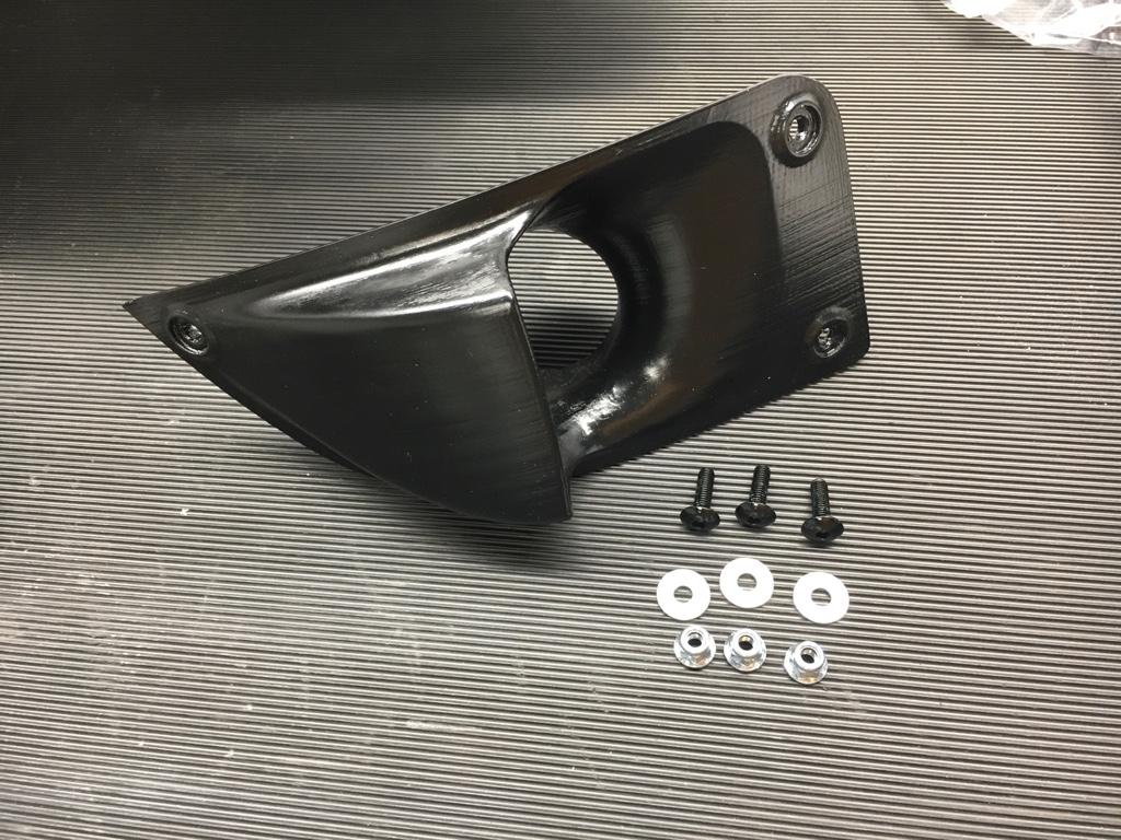

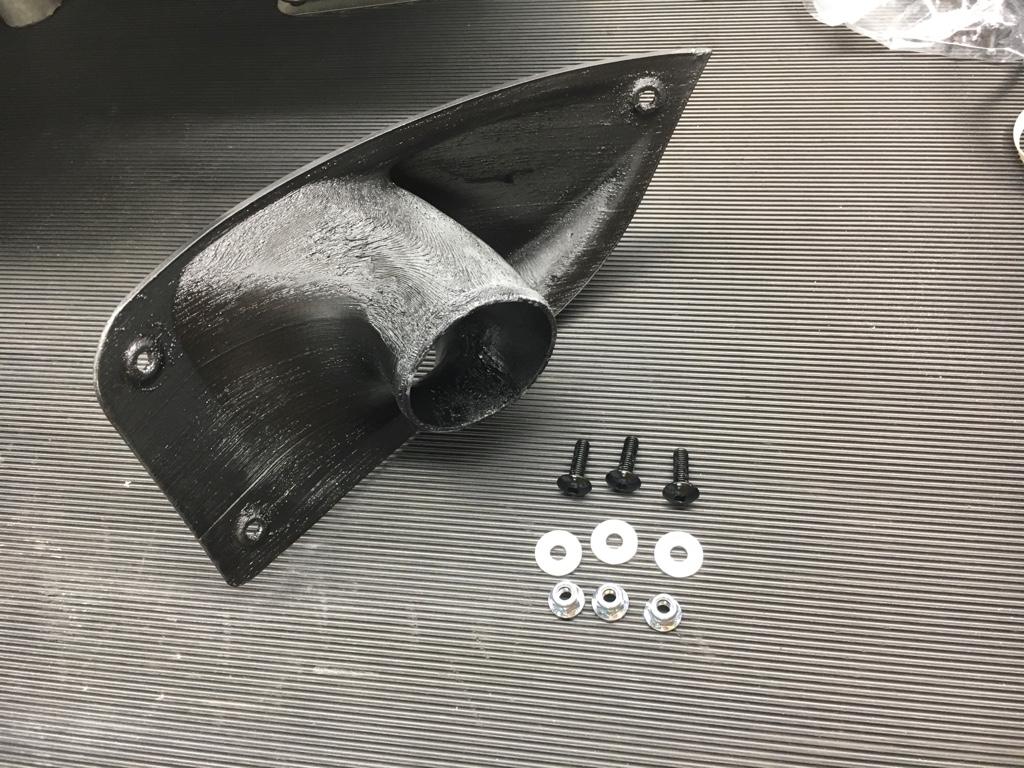

Im not sure yet.. still working through the caliper side of the kit as what I made for ours isnt really cost effective to batch produce... not likely this side of christmas though
How about the splitter/spoiler? Will they be available after the brake ducts? I don’t mind running a test set if you need to trial them on a silver car.........😉😂
