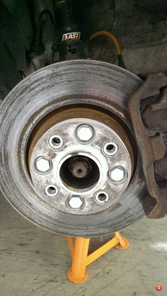

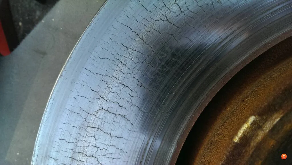

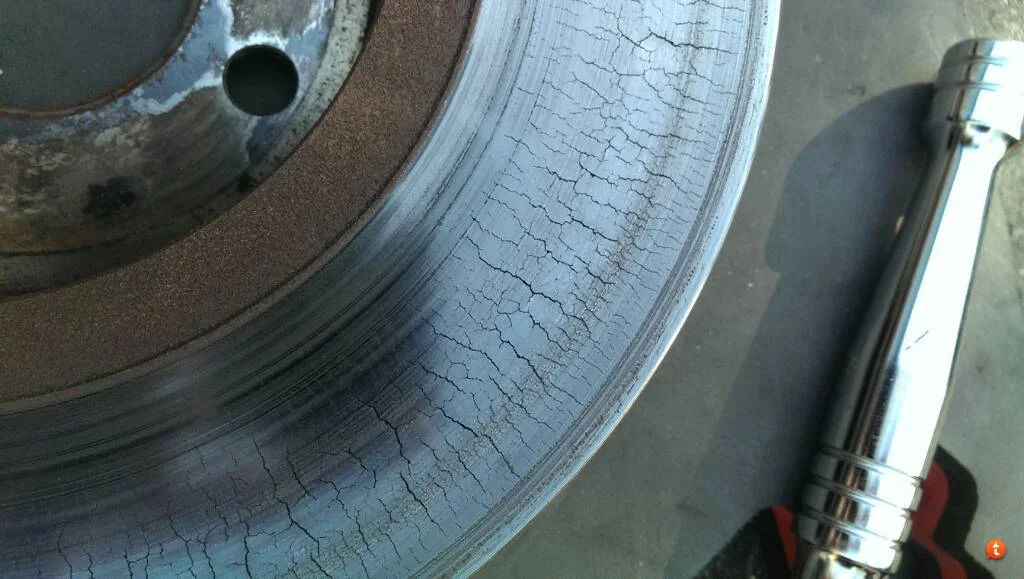

Changed the front discs today and notice some significant heat cracks. I realise it's normal to get these in the cyclic loading of the discs, thermally and mechanically.
Is this a normal level of cracking or do I need to work on some extra cooling? Currently just fog light surrounds and liners out. I've got an emergency duct design planned just on case, is this necessary?
Similar both sides.

Noticed mine are a bit like that too, had issues with brake fade at Oulton last November using yellowstuff pads and it's probably the reason.
About to fit some AP 4 pots, 300mm rotors with alloy bells. Should stop then!
  Mk4 Mondeo Estate
That's bad. Also believe it's an MOT failure (well it is on HGV anyway) because the cracks cover more than 50% of the width of the disc face. Just something that is worth checking with the car MOT manual.

The discs are brembo HC. It had run pf97 pads for a couple of days and before that a full set of rc6 pads that we managed to run to the backing plate (see picture). Didn't show any cracks though, just some scoring we took out and then bedded them back in. We realised this was properly gash but had been shipped incorrect discs and had a track day he following morning!
They've all looked quiet similar in the past, even when not raped by metal on metal contact. Just thought I'd flag it up. The car still braked fine and disc wear was maybe 1-2mm total thickness - less that 1mm each face.

It may just be a case of too much heat through yours on track bud. How 'heavy' a braker are you? They are bad, especially after such a short time and the fact you say you bedded the pads in ok.

Probably fairly heavy on the brakes! It's only going to get worse as the slicks start working in the summer so I might just get the ducts made up
  172 Track Car
You may need to look at 4 pots.....
Probably but I've had a think about it *engineering hat on* and I'll go for ducting, it has got to be a heat management issue and even with four pots the disc will probably still cook

Never seen any like that and I've used them myself and supplied a fair few to plenty of people who track and race their cars
Have you measured the total thickness of them mate?

Nope, less than 3mm thinner than news ones when looking set total width though

They come with 24mm new, the minimum thickness for them is 21.8mm
Be interested to know the thickness of those

Old discs were in the bin, in fairness I'd say they were on the minimum when they came off. 3mm was with a factor of safety

I was going to suggest if they haven't passed it , they were very near the limit of needing changing imo mate
