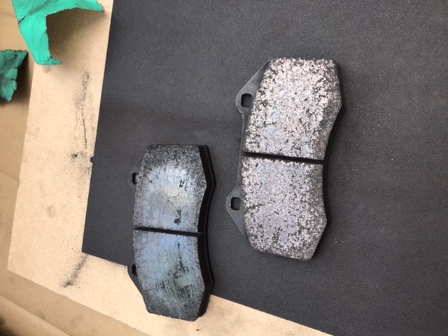

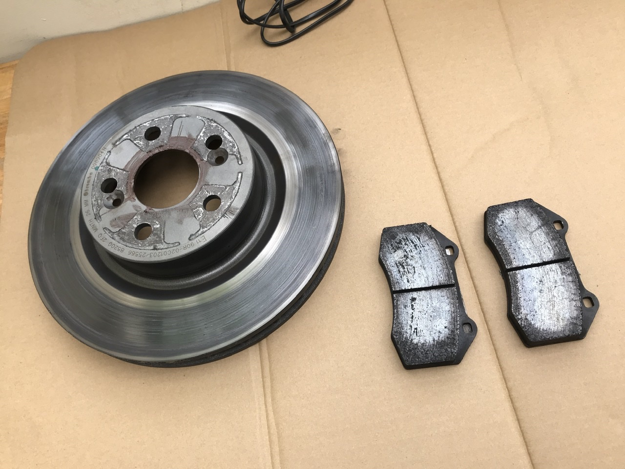

I had the same issue with the same setup but Clio 200, I thought I had bedded them in correctly but then had a track day with lots of juddering once warm it seems I underestimated how hot you need to get them during the bedding. I inspected the pads and they where glazed with lots of pad debris on the disc...
Quick rough sand on the pads and fine (1000 grit) on the disc to try and remove the worst of it.
I then went on a 6am bedding in session where I slowly brought the pads up to ‘race temperature’ starting with 70-40 before moving up to 70+-15. I found them to very slowly improve as they warmed and got no juddering. I have then left them to cure for 24hrs, the discs look a lot better and feel smoother hopefully a successful track day this Friday..

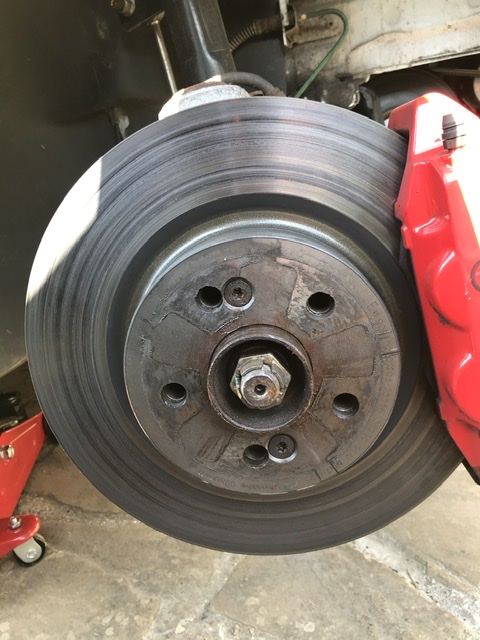

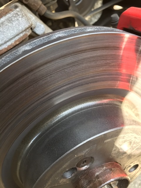

Update in my similar situation to the OP’s, overall a very successful track day on Friday with no juddering, I slowly brought the pads up to temperature (just in case). Used the first session to do this and found the pads start to get better and better as the day went on, to the point where I could push and dropped around 3s in time from before when I obviously over cooked them (1.39 down to 1.36.9 at Goodwood) which I was very happy with considering my PS4’s where too hot for the conditions (R888R next purchase I think..)
See below for a few shots of the disk now where you can near see the even deposits across the disk.

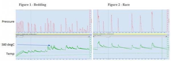

I agree with @youngarthur, getting on and off the pad is important (I am guilty of lingering due to still learning trail breaking) and the simple fact that these are race pads and designed to be raced. However it seems bedding in is extremely important, I followed the following page but paid more attention to the graph as it clearly shows how the pad is slowly brought up to temp which is what I did (the second time)
