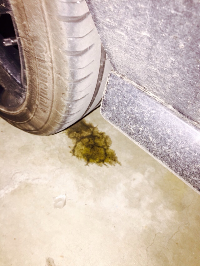

Thanks Mick - I think I might have found the culprit. I went to the car this morning and there was a small 3" pool of what looked like oil on the floor in front of one of the rear wheels. Clearly brake fluid - so I'm assuming the seal has perished on that corner.
I'll get it booked into a garage near work. I'm actually more concerned that the leaking fluid will have run over the alloy and screwed up the paint!

Down sarf at the minute - but got Shelley to take a picture of the little oil pool when she got back tonight. Thankfully it's not grown in size since this morning, so it's not pouring out of its own accord.
And yep, the car does need a wash! [emoji5]️

Yep - brake pipe. Slightly weird in that it appeared to be slightly out of line and had caught on the rear spring. Must have only just touched and maybe when the spring compressed - as I've had those Eibachs on for years.
I looked at the old section of pipe - and indeed it looked like it had been smoothly scrubbed over a long period of time - finally letting go when the pipe wall was too thin.
Sorted now though - and the other side of the car was totally fine.
