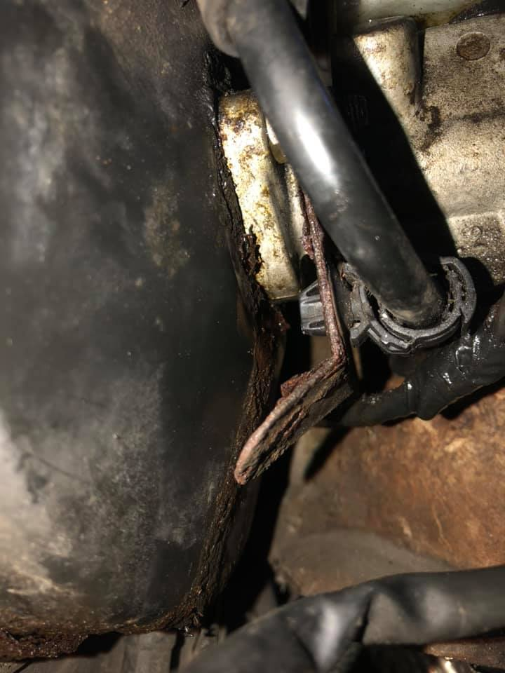

Was looking at my brake servo earlier, noticed there was quite a bit of rust underneath the master cylinder.
Is this normal?

I don't know if it's normal but most I've seen have rust down there.

Your MC seals will be shot and leaking. Its rusty because the brake fluid over the years will have ruined it
I had to replace the seals on my old dCi when it got too bad. Although if you can wiggle your MC then the metal will be completely rotten and it needs replacing

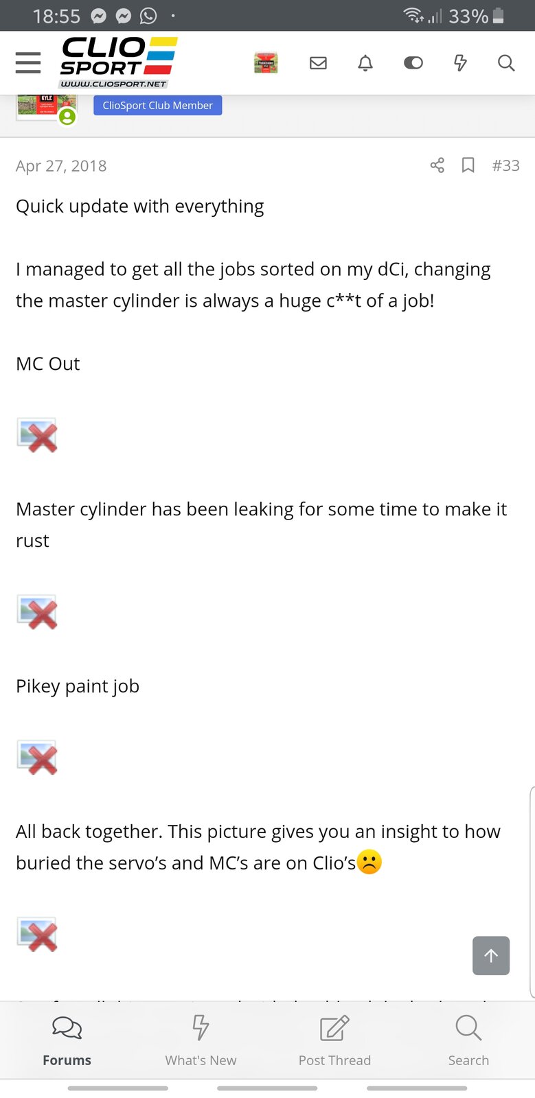

As long as the metal isn't too thin you should be able to just clean it, rust treat it, paint it and then fit new seals into your existing MC. I'll find my post from my thread where I did mine

I just pulled my lines off and then pulled the MC out of the top of the bay mate. That seemed the easiest way for me as the servo on the dCi 100 is connected to the pedal box and removing the pedal box means bleeding the clutch which I couldn't be bothered to do😂
I have RS Tuner so if you're local I can pop round to help you bleed em up if you need

No problem mate. I have no idea why my pics arent loading though, frustrating because the pics i took were actually helpful😂😂
