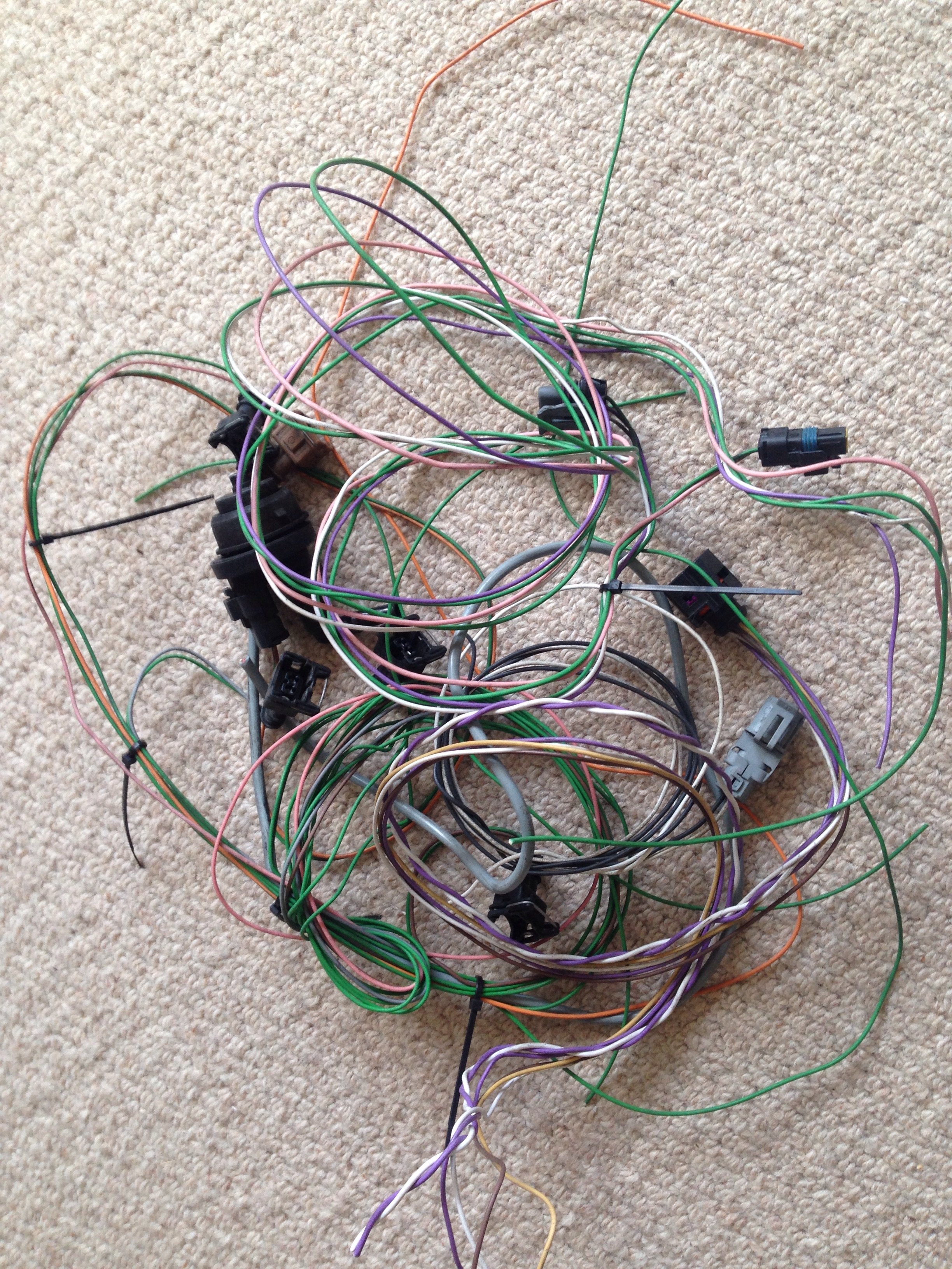

Wiring scrap pile continues to grow!
A big thank you has to go out to @MicKPM as well. With his help I now know which wire does what on the cam phase sensor. Without this it would've been guess work. Thanks again mate! I'll keep the original ecu plug the next time I do it! Flol

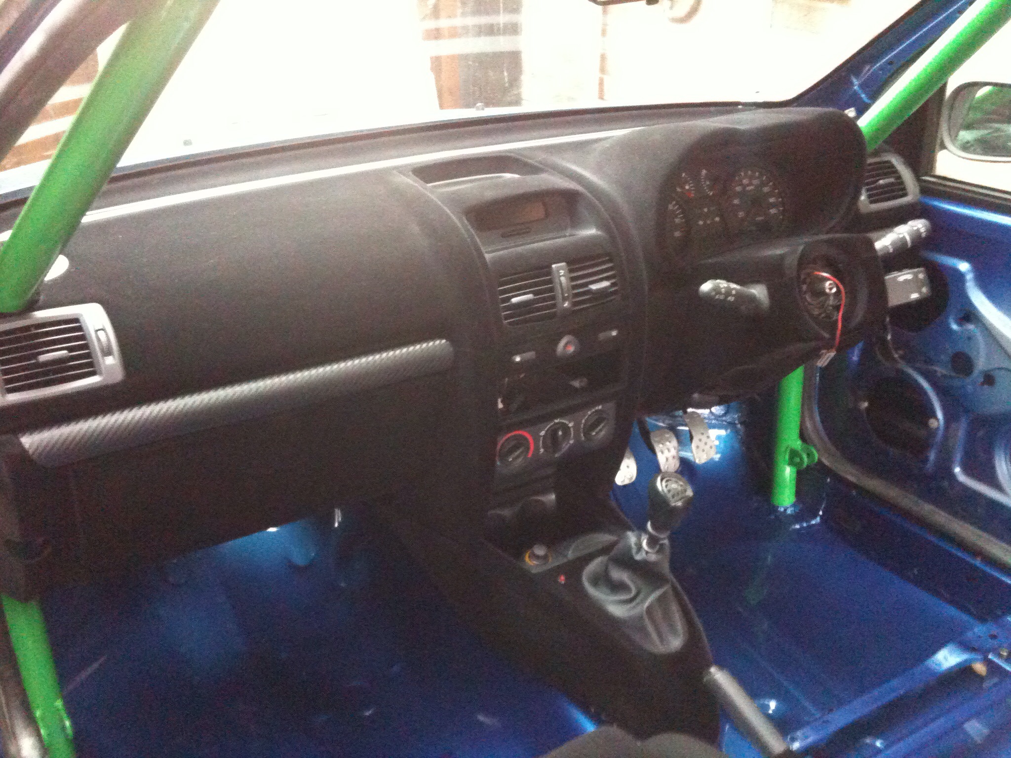

Interior:

Interior:View attachment 129352@not normal dan has seen my cup more than most, so he will be able to say from a different perspective what condition it's in. Or @Cub. as well.

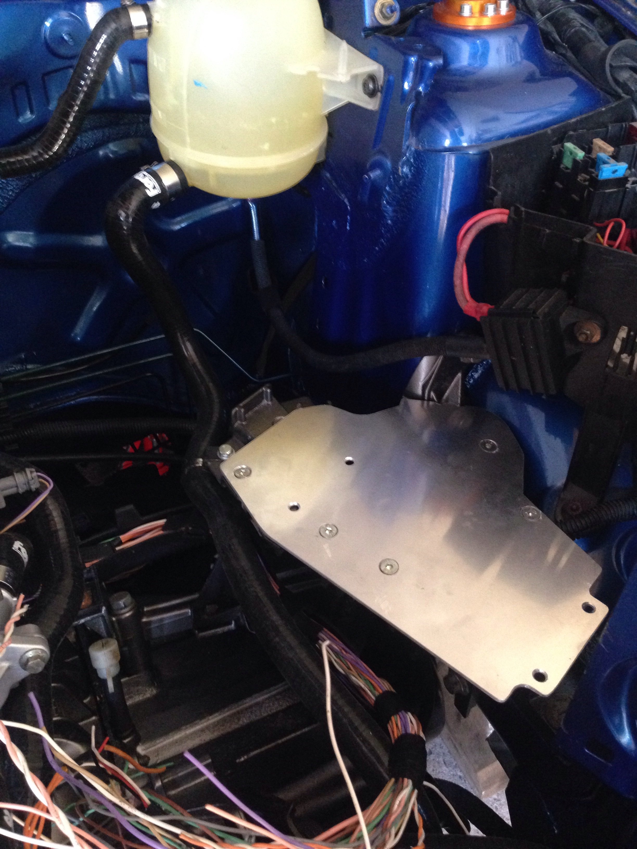

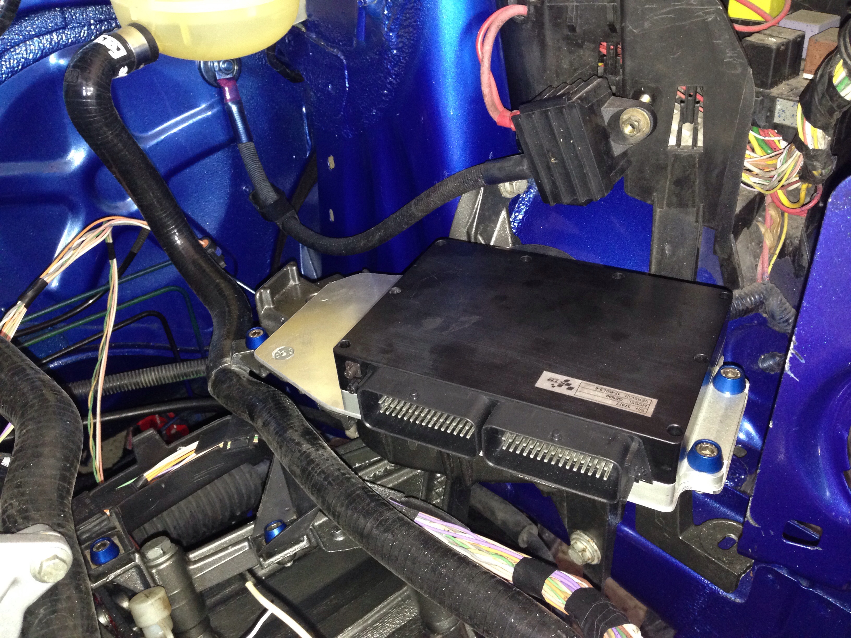

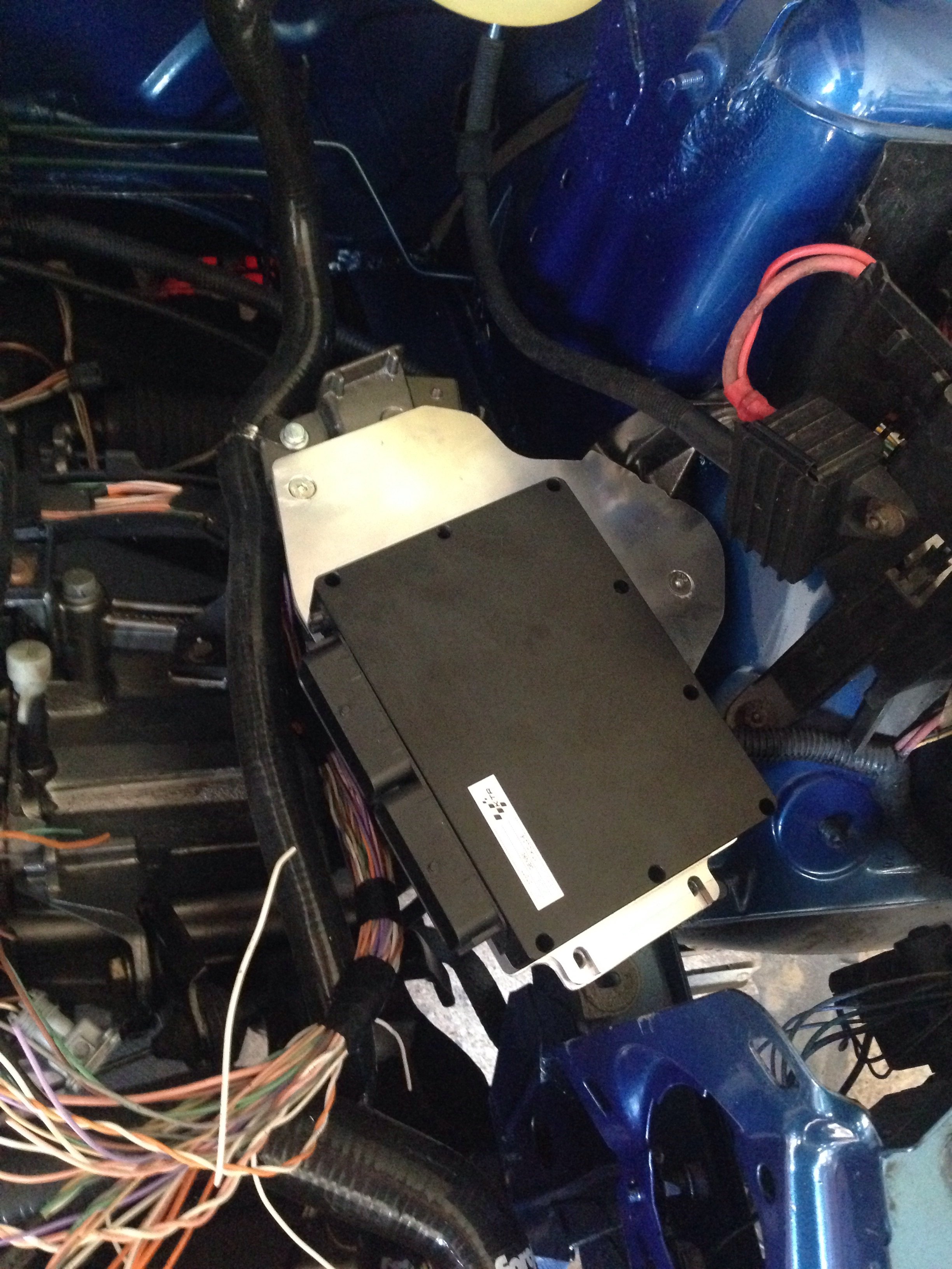

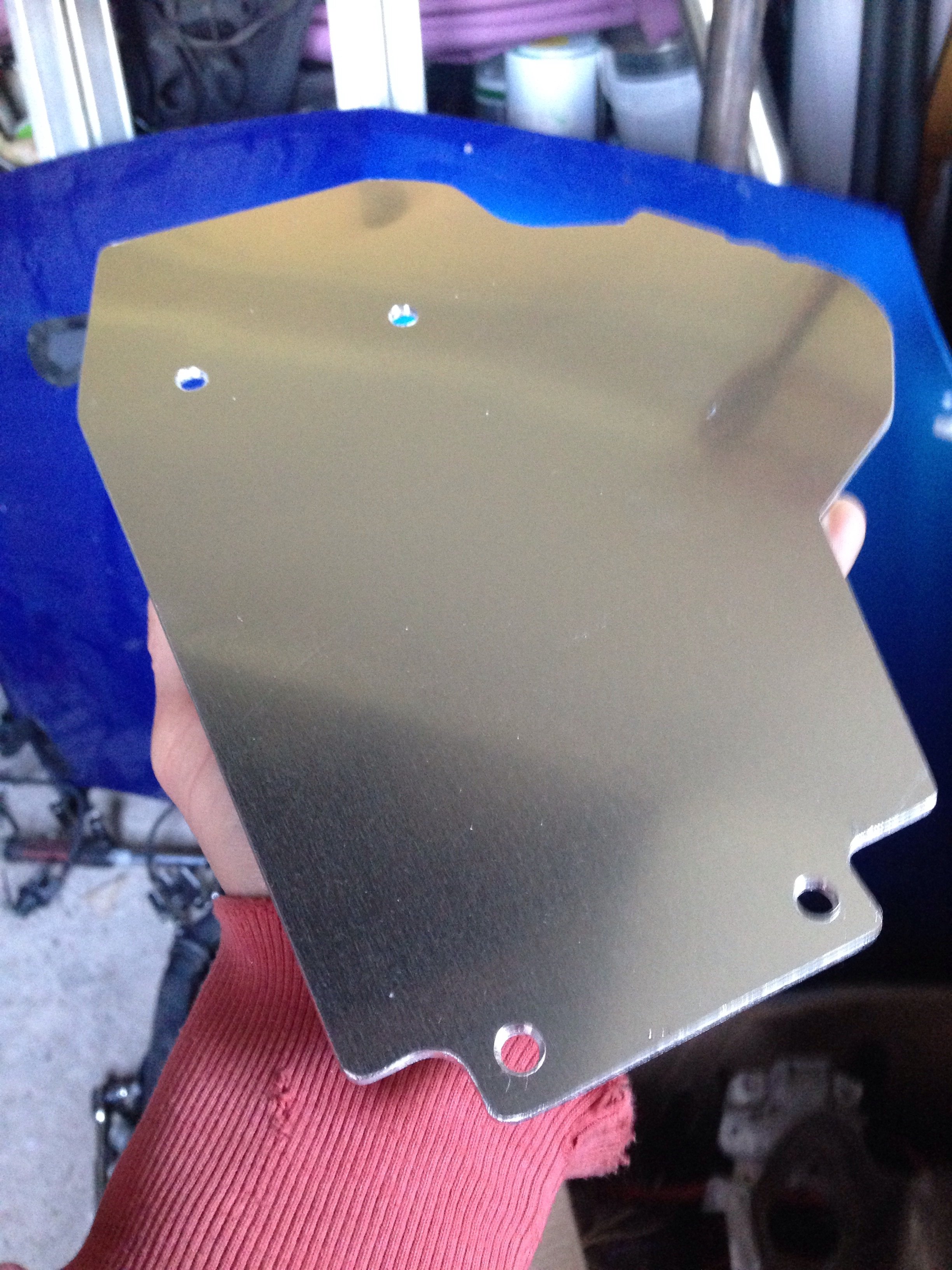

A little update. Blinged the ecu mounting up with some fancy anodised cups that I'd got lying around. The plate and ecu are now fixed down.

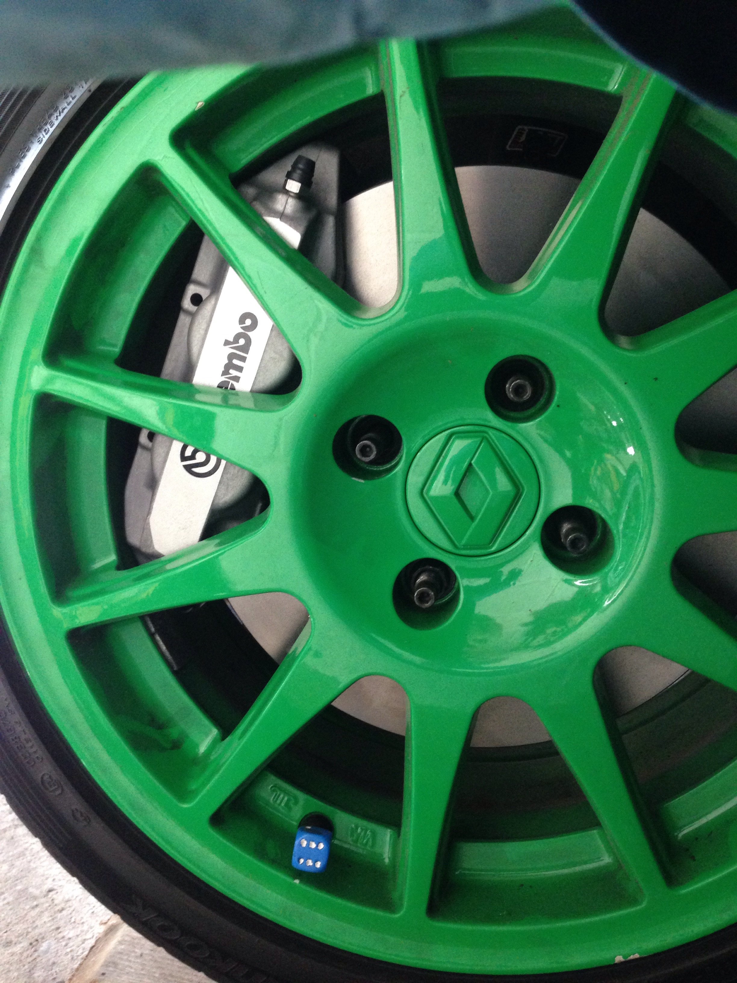

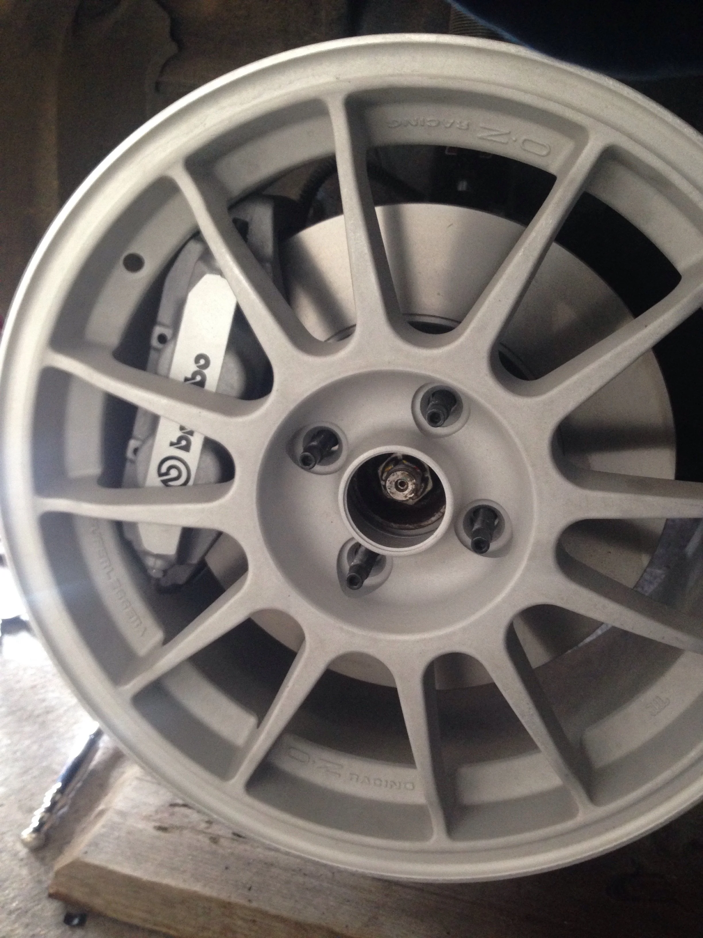

Had a little play with some stuff that I borrowed off @Panda today. This consisted of pms caliper brackets, brembos and 300mm discs. The findings are that I can run them on my cup turinis without the need for a spacer, which is happy days. Different story with the superleggera's though!! Here's some pics so you can see what I mean.
There's a good 2-3mm of spoke clearance and caliper to wheel clearance here.

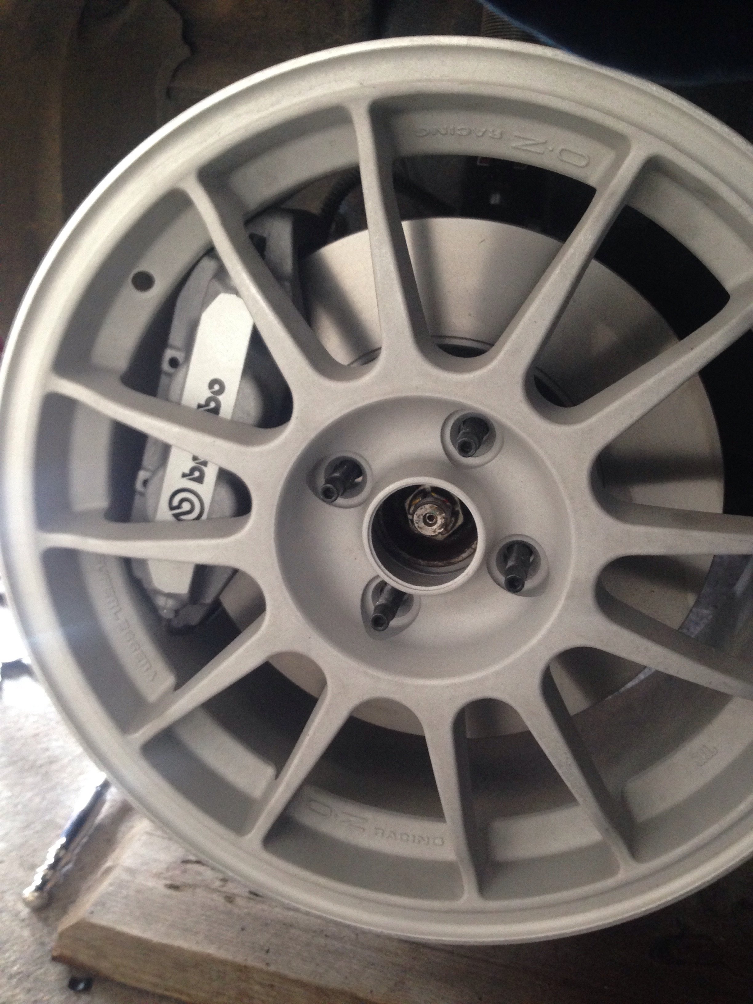

The same can't be said for this though!
It looks like I'd have 2 options here. Run a 5mm spacer and machine the calipers with more of a radius to gain clearance. Or have some custom ally bells made to run a 2 piece 295mm disc, machine the caliper to sit slightly lower, with a radius for clearance and run a 5mm spacer.
The scenic 300mm discs are heavy as fook as well.
Worth the hassle for an extra 20mm of brake disc size? I'm not convinced.

Bells would be the best but it would start to get expensive then.
Is there much of a difference in performance between the 280 and 300 discs?
If not just get some of the brackets for 280 discs.

Doubt the turinis would clear the wheel weights. I had to have the weights moved to the middle of the wheel and rebalanced.
The feel of the brembos is amazing though, so much better than standard. Non PMS mounts might be better for you as the PMS ones are offset so that the alipers sit slightly diagonally so the pad covers the whole face of the disc.

A little update. Blinged the ecu mounting up with some fancy anodised cups that I'd got lying around. The plate and ecu are now fixed down. View attachment 129636Had a little play with some stuff that I borrowed off @Panda today. This consisted of pms caliper brackets, brembos and 300mm discs. The findings are that I can run them on my cup turinis without the need for a spacer, which is happy days. Different story with the superleggera's though!! Here's some pics so you can see what I mean.
View attachment 129638 There's a good 2-3mm of spoke clearance and caliper to wheel clearance here.
The same can't be said for this though! View attachment 129637 It looks like I'd have 2 options here. Run a 5mm spacer and machine the calipers with more of a radius to gain clearance. Or have some custom ally bells made to run a 2 piece 295mm disc, machine the caliper to sit slightly lower, with a radius for clearance and run a 5mm spacer.

Depends how badly you want them on, but personally no.
I don't own a set of brembos mate so I don't want them that badly!
What will you be doing with the MC?
Nah costs are not so much of an issue as I can get bells and brackets made up for material costs + a drink. The biggest issue is that I'm not taken by the brembos. The overall design of them is big and bulky. A 300mm disc and 4 pot caliper should piss it for space under a 16" wheel, but not the brembos! Alcons or ap's may be the way forward. A standard mc will be fine with the correct piston specs.
Yeah you can't run wheel weights mate. I strongly doubt there's enough space for wheel weights on a set of Chris Powells brackets in 300mm either.
I'm not doubting the feel of the brembos mate at all, but imo they're overrated and overhyped from what I've seen today. There's better alternatives out there in terms of braking performance.
