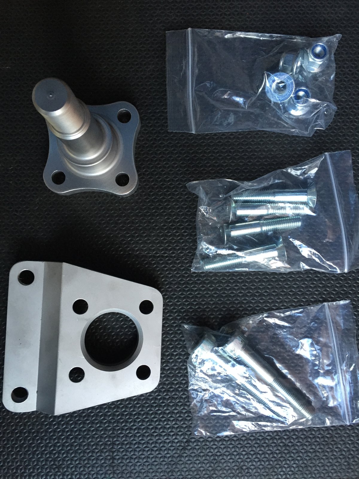

This uprated rear setup strengthens the wheel bearing/stub axle assembly utilising an EN24T stub axle and a strong but lightweight adapter bracket made from 7075-T651 aluminium. The intended results of this package is longer wheel bearing life with less likelihood of a bearing failure when you least want it and also reduces the likelihood of bent stub axles.Possibly missing something but reason for custom stub axle? Strength? Custom parts Yo?
Update time again!! The new rear stub axles and caliper brackets arrived today courtesy of @nath&alex.

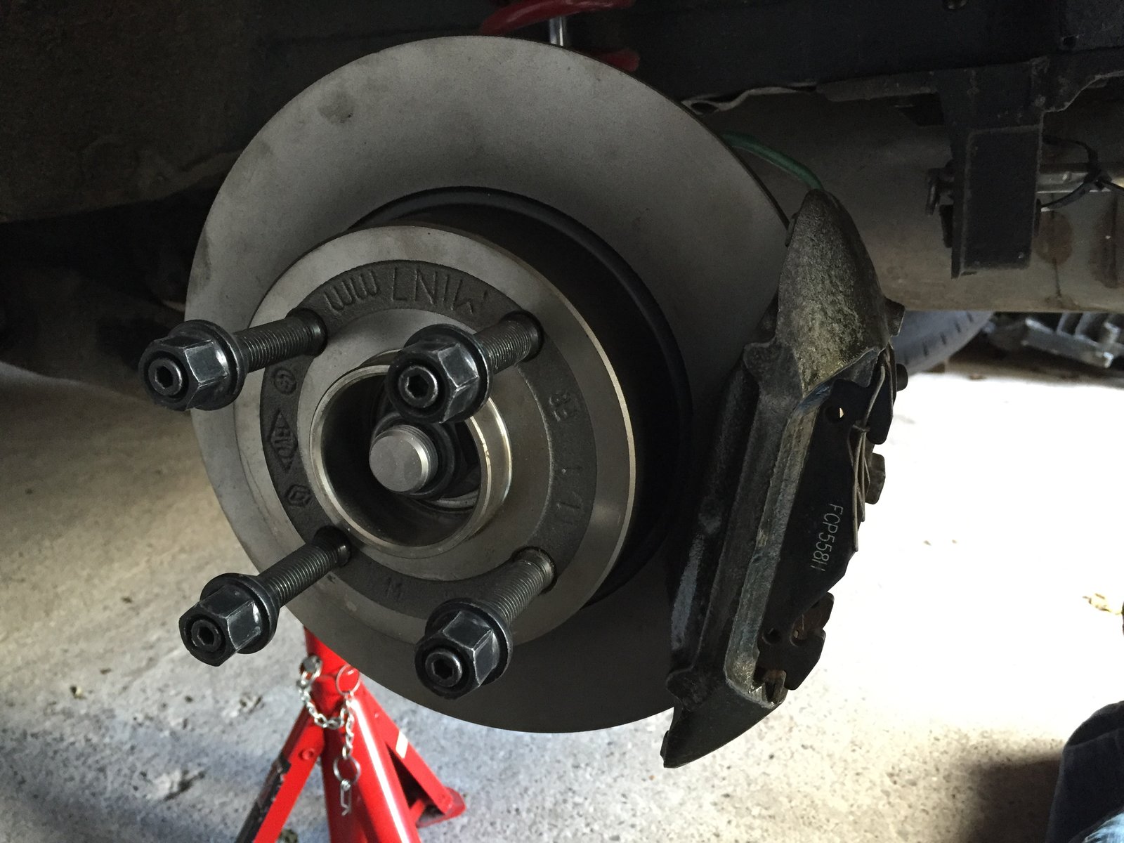

The car was already stripped down ready to accept them so fitting took next to no time at all.

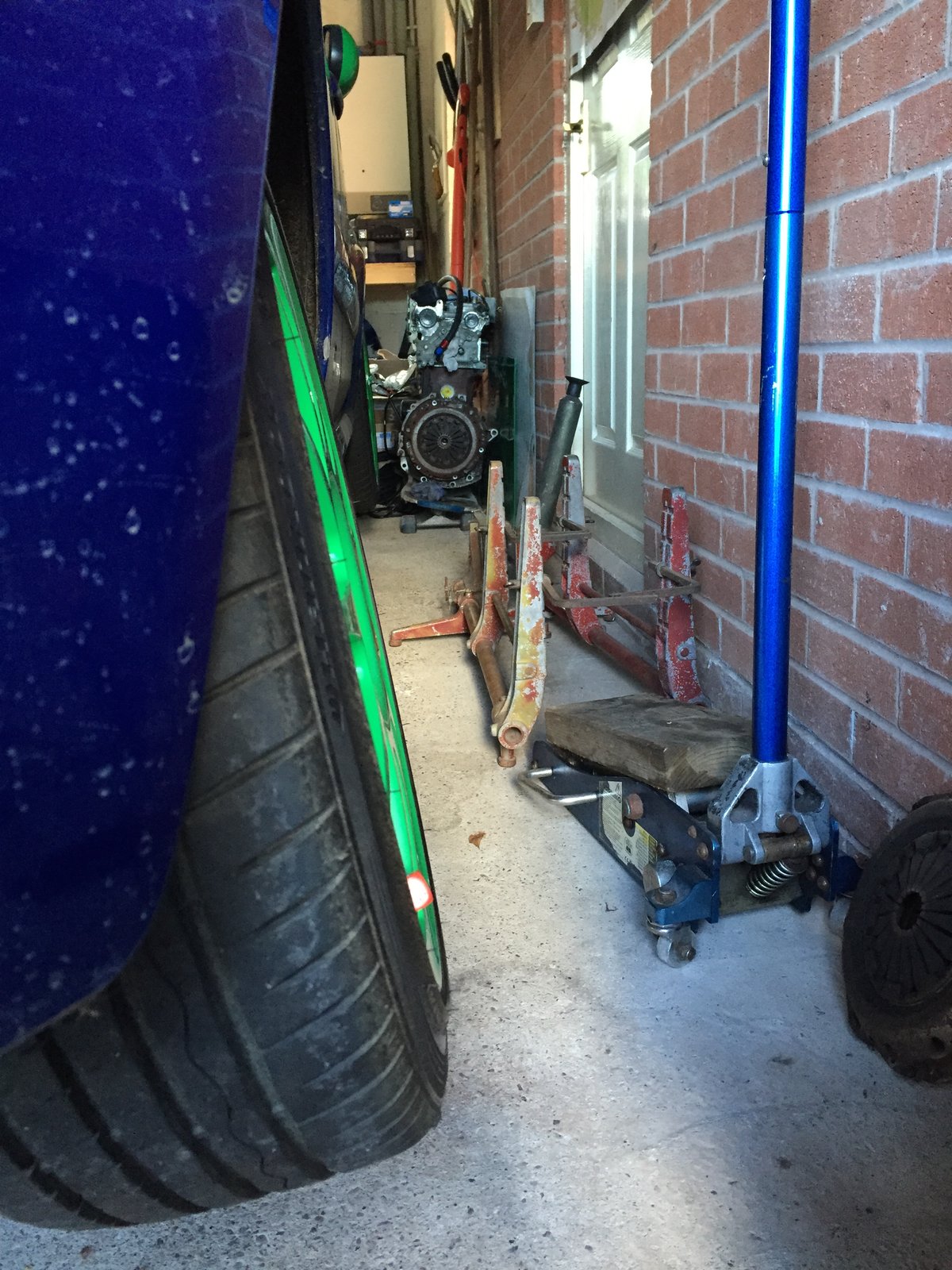

Stub and bracket on:View attachment 151901Disc and caliper carrier on:View attachment 151902And finally, lock wired the rear brake pad carrier:View attachment 151903Here's a pic of the kit for the o/s:View attachment 151904Got camber y0!View attachment 151905Don't worry! This is just the wheel resting on the studs!!
The cup is now on the floor for the first time in around 12 months. The new stub axles have also given a bit more track width on the rear end. View attachment 151906Tomorrow will see the cup seeing sunshine for the first time and getting a wash!

Also, forgive my ignorance, but what is the main benefit of this kit? Considering the rear brakes don't do much anyway? Is it primarily for a bigger/stronger bearing upgrade?
@ph-reebone beat me to it!! But just answer your other question they are Twingo discsLooks like a bloody lovely kit.
What discs are those?
check above your post chap

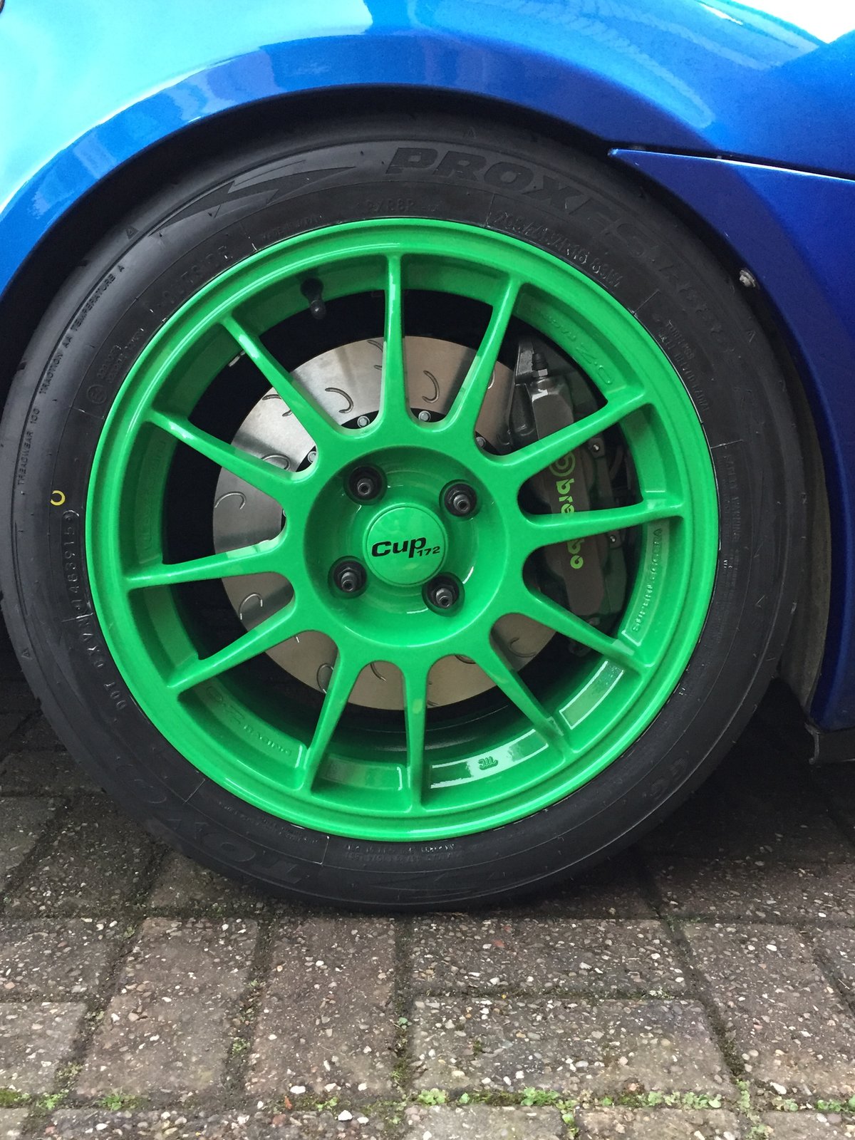

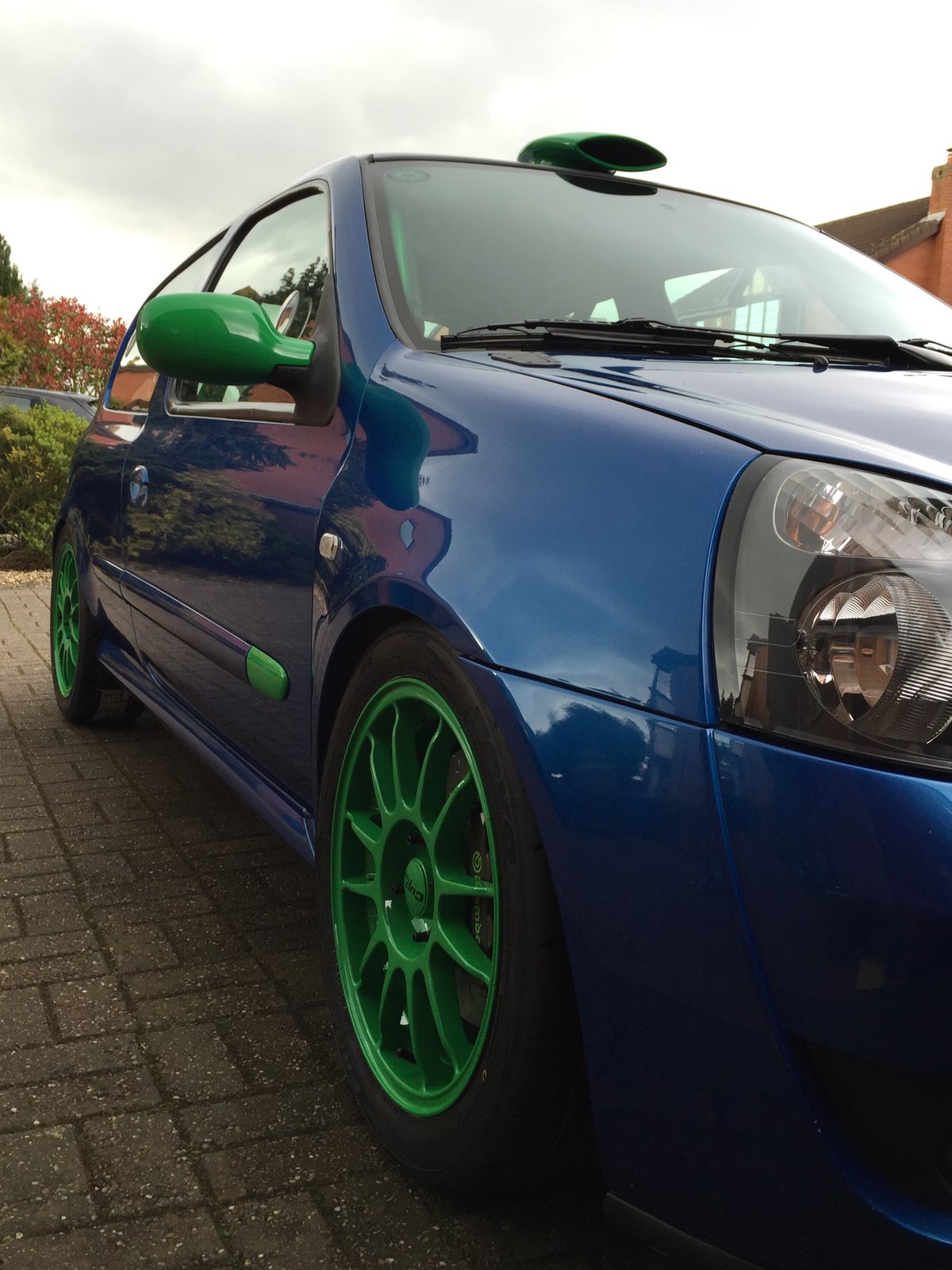

Yes mate. They're the new r888r as well.205/45/16?
Why 16s? didn't fancy running some different calipers?

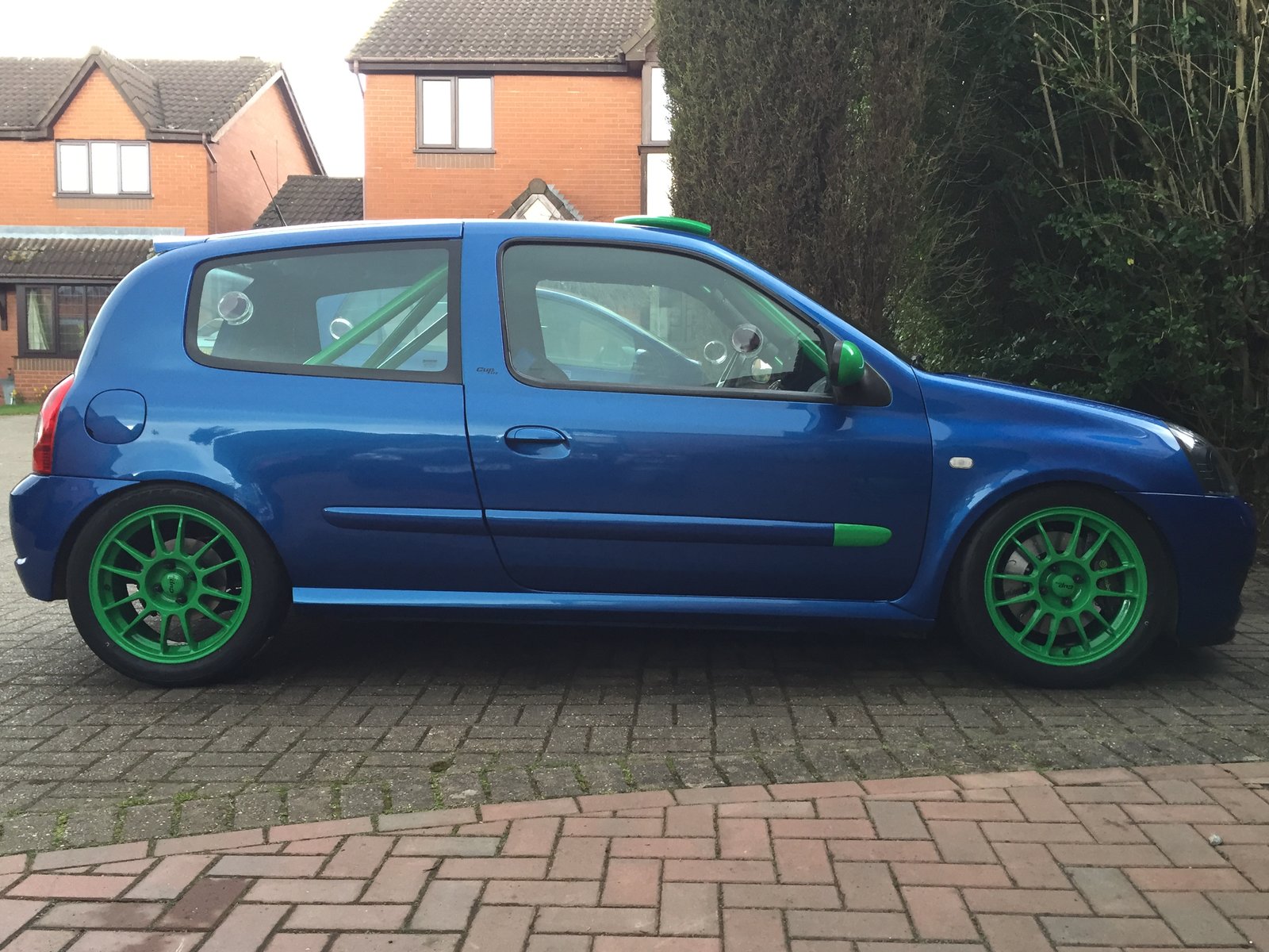

Thanks mate. :up:It looks stunning Mark. A real credit to you bud!
I'm a big fan of the colour combo, and those 'J Hook' brake discs look awesome!
Thanks mate, although I'll struggle to have some pics with the bonnet open - it's got no hinges and it's secured with 4 aerocatches! Lol!Looks absolutely brilliant Mark. You need to get some proper pictures, bonnet open, all that jazz.
