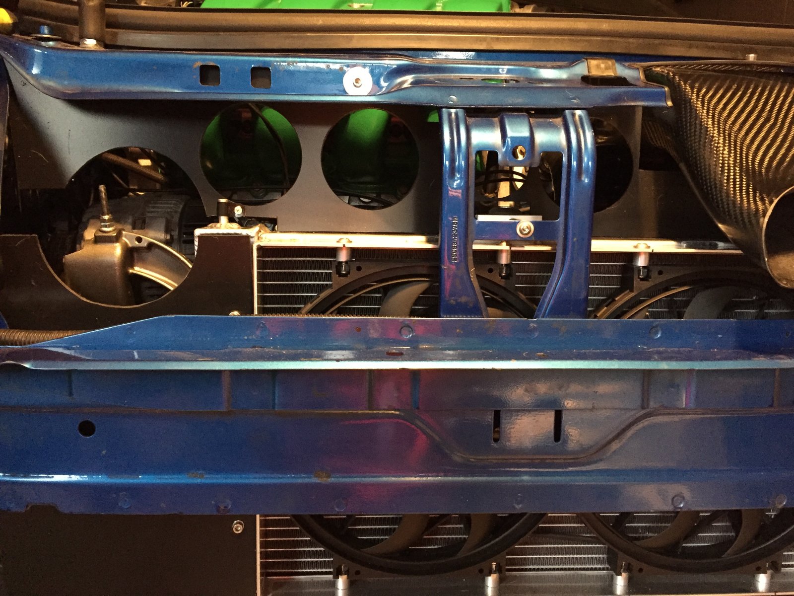

Little bit more progress made today. First off I made the blanking plates for around the grille/radiator assembly. This will also reduce the amount of s**t and snot that gets into the engine bay.
I've added a couple of cutouts to allow some cool air onto the inlet/into the bay, and also allow cool air to flow around the alternator.

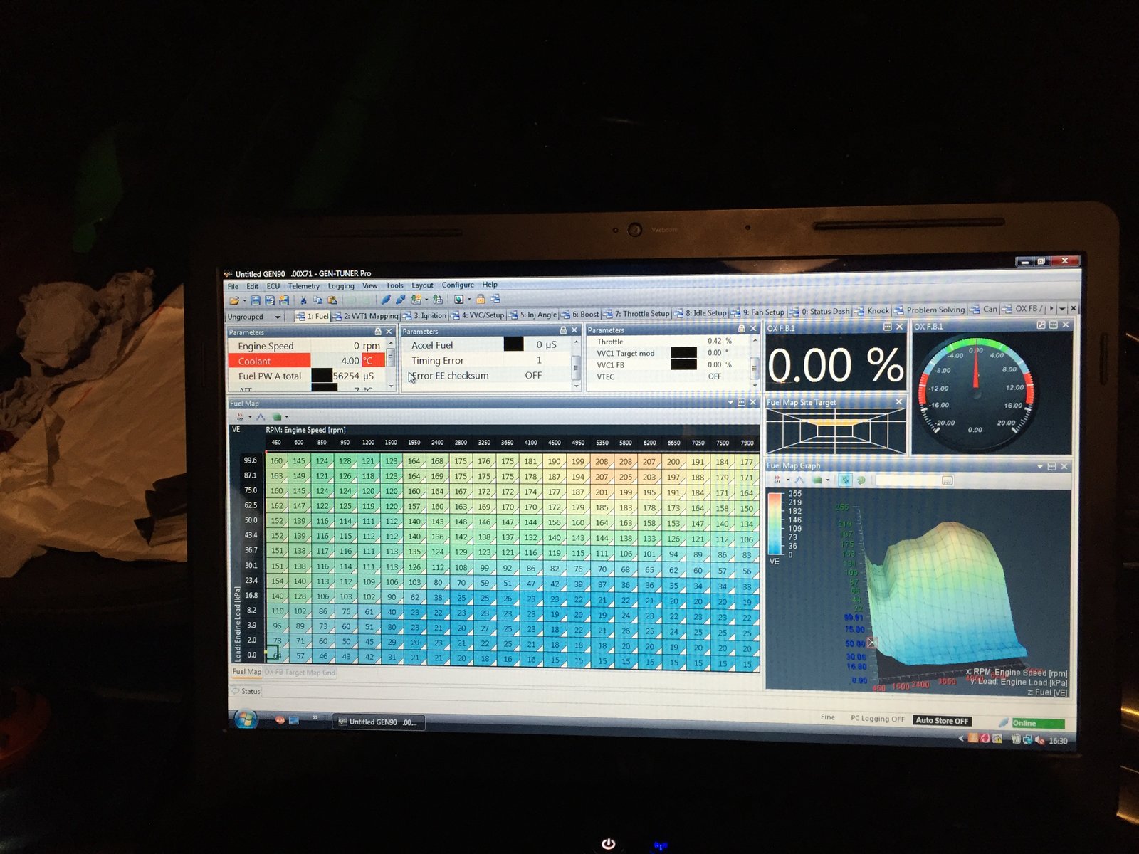

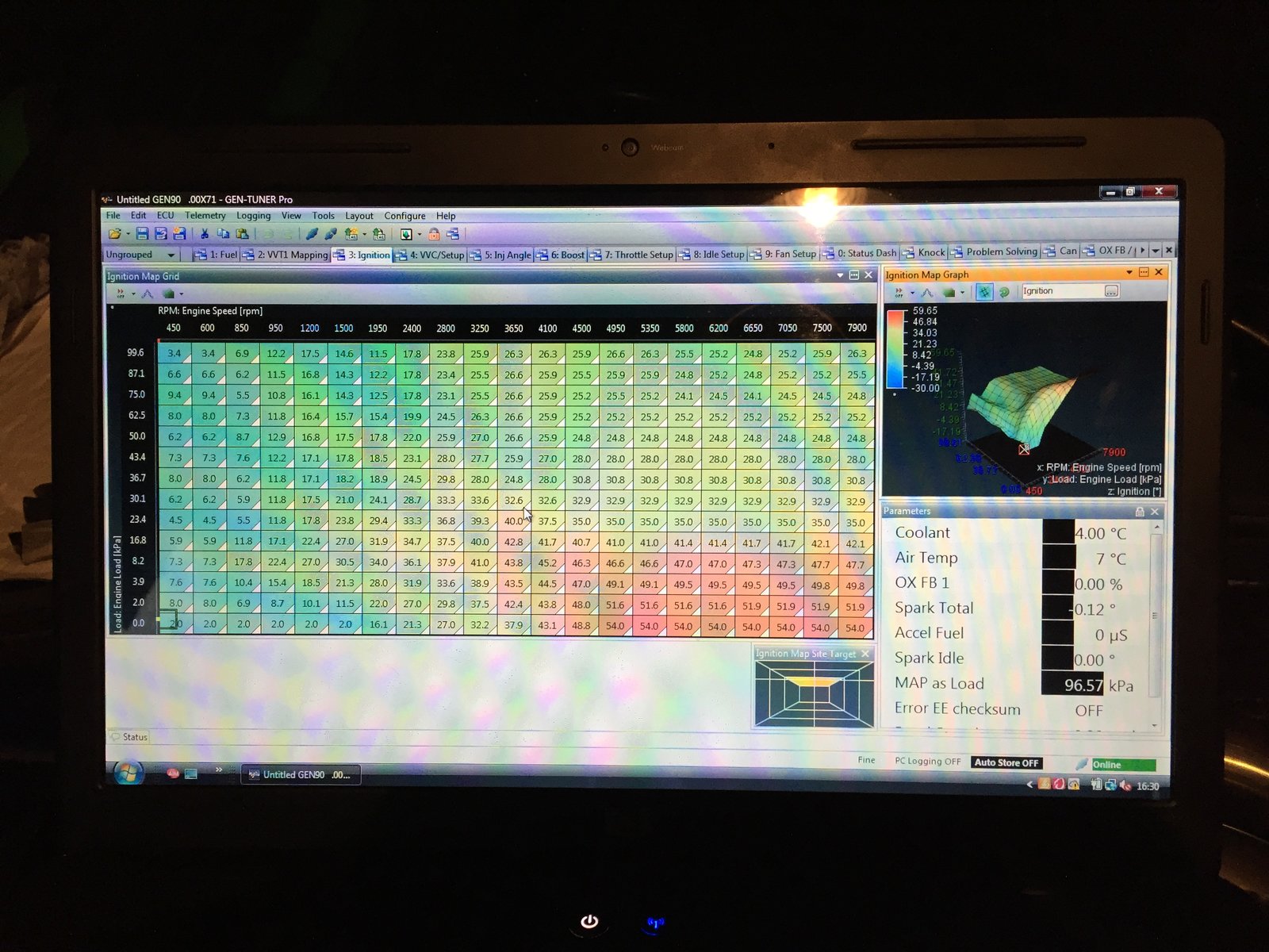

Next up was a quick play with the gen90 in the fuel and ignition maps. Not really sure why I'm bothering tbh as it'll be swapped over with a different one, but boys and their toys!
It still starts so I guess I got it right. Lol! Those screen shots are pre messing btw.
All the relevant sensor readings are good as well which was nice to see.

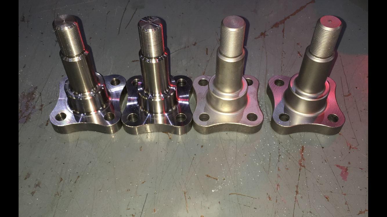

And finally I received some pics off @nath&alex of his missus naked, no sorry, she sent them. He sent me some pics of the stub axles that are fresh off the machine! I think you'll agree, they look awesome!! Can't wait to get them fitted. The 2 on the left are fresh out the machine finish, and the 2 on the right are after they've been aquablasted.

And finally I received some pics off @nath&alex of his missus naked, no sorry, she sent them. He sent me some pics of the stub axles that are fresh off the machine! I think you'll agree, they look awesome!! Can't wait to get them fitted. The 2 on the left are fresh out the machine finish, and the 2 on the right are after they've been aquablasted.View attachment 150676Happy days!
Still unsure whether I prefer freshly machined or aquablast finish??
I'm swaying towards aquablast finish

looks great, are you changing the ecu from the gen90 or is it just the map you meant with swap?
How do you rate the gen90 in terms of the software and overall features of the hardware?
Thanks! No mate keeping with the gen90 and just swapping the map over that's in the ecu.
I really do rate the gen90 mate. Properly packed full of features, but potentially a bit busy on on some of the screens. I've not done anything to do with mapping since I had my Astra and that was on pectel t2. Just feeling my way around it really and having a dabble.
The biggest plus point for me was no need to run a piggyback ecu and patch loom.

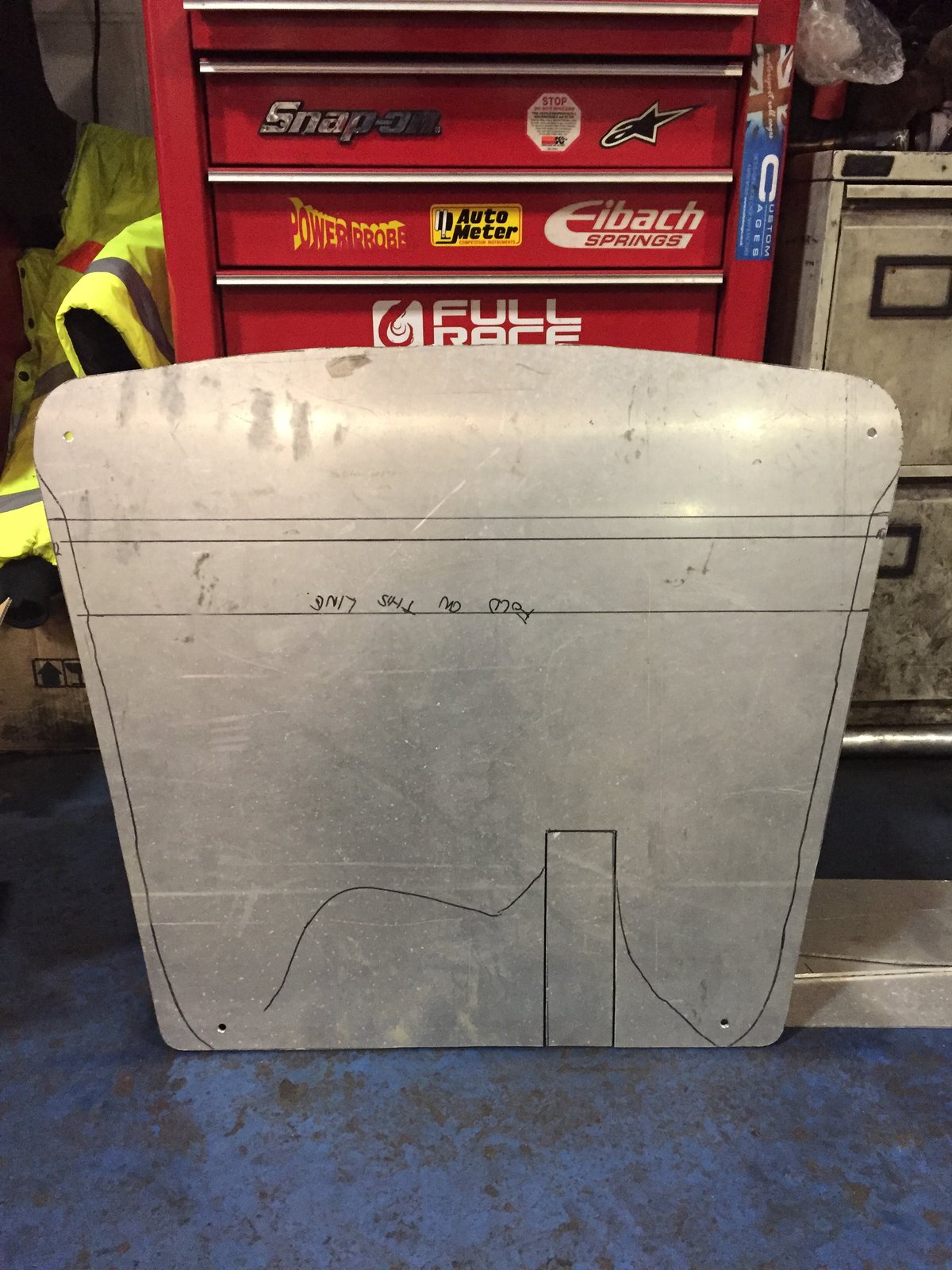

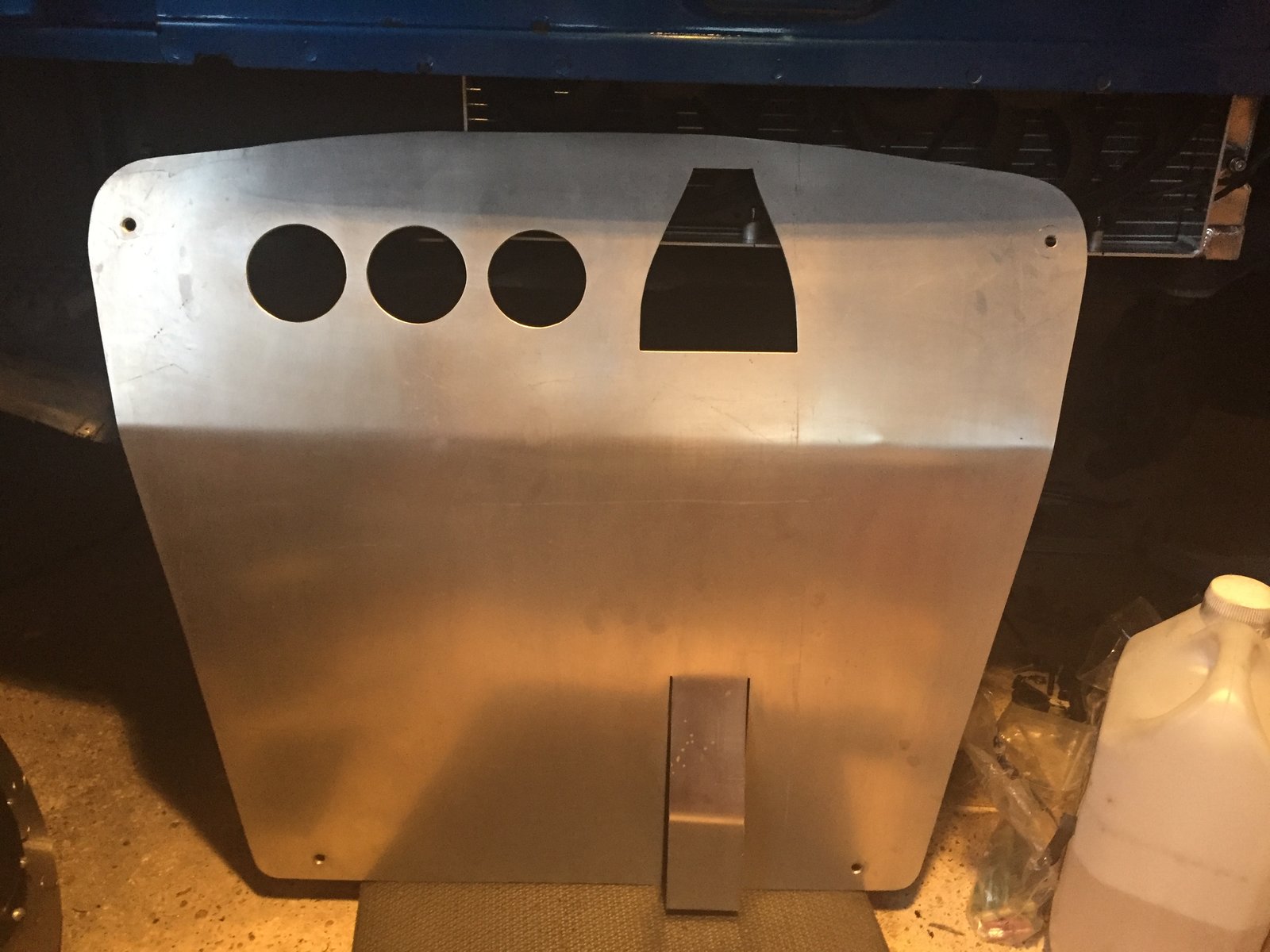

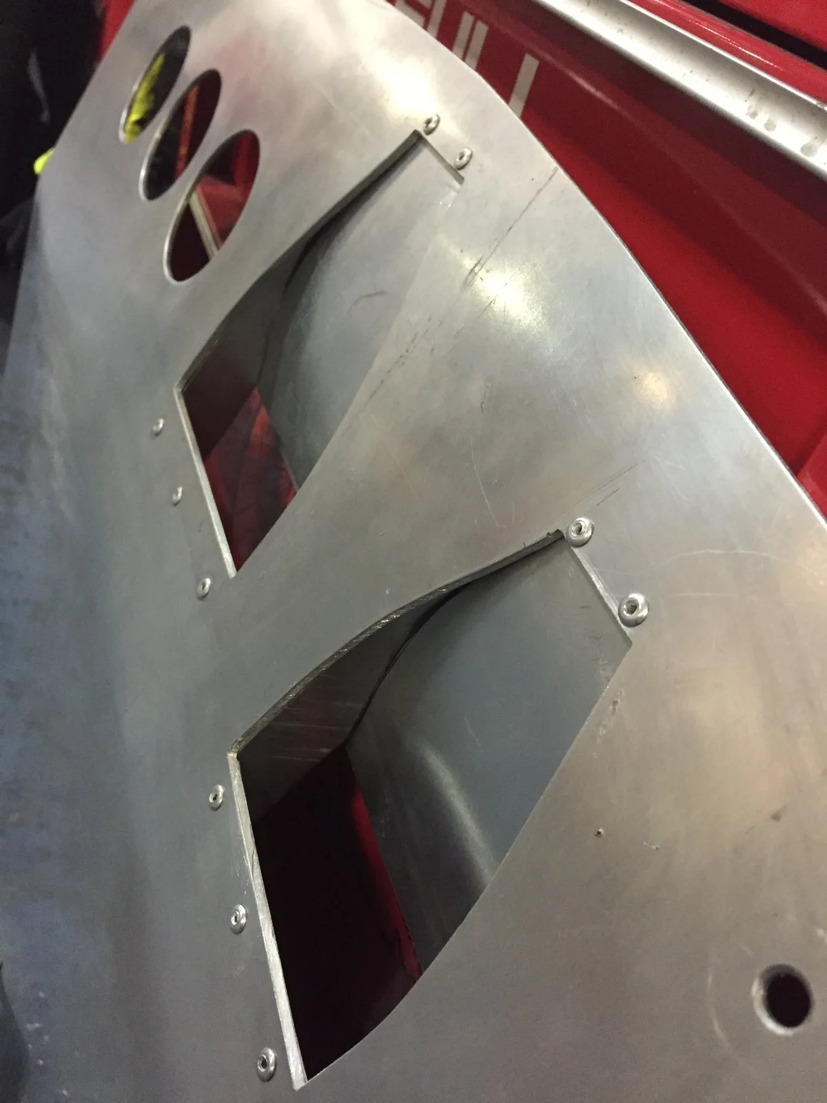

Had a couple of hours spare the past few days so I made a start on the sump guard/gearbox cooler type thing. I started off with a piece of 3-4mm aluminium sheet and traced around the original plastic cover. Cut it out to shape and made sure it would offer up alright.
With this done and it all fitting up ok it was time for the rather unenviable task of putting a kink on it to follow the outline of the subframe. This is aircraft grade aluminium and bending it is not easy!! Made a little tool up at work to clamp it to the bench, then 2 of us stood on it to put the desired kink on it. That was a combined effort of 25 stone, and it still took some effort!! Lol!

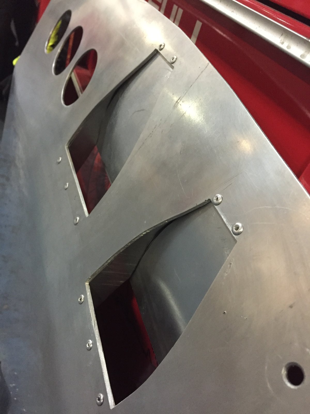

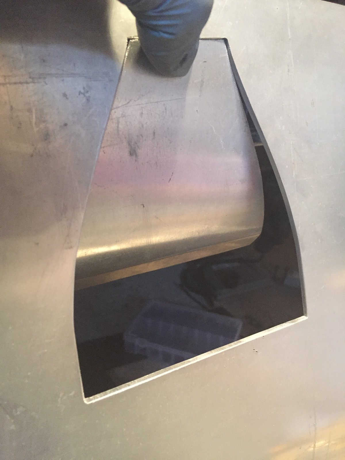

Here it is complete with kink and cut outs. The one at the back is for the gear lever, the 3 holes are to allow airflow to the sump as a bit of additional oil cooling, and the one that's shaped funny is something to cool the gearbox casing.

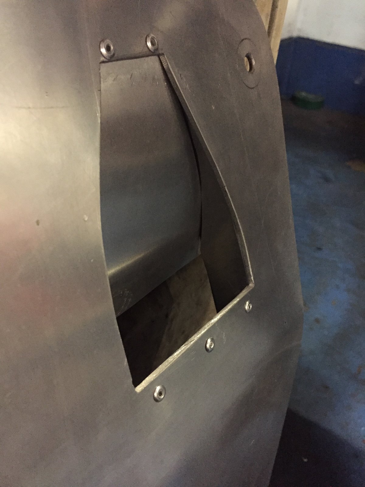

Heard of a naca duct? Well that's what will be fitted here. There's no space for an off the shelf item, so it's custom made only.
This will be welded in and the sides filled in to funnel the airflow up to the casing. There's also a piece that's riveted in place on the inside now to act as a funnel as well.

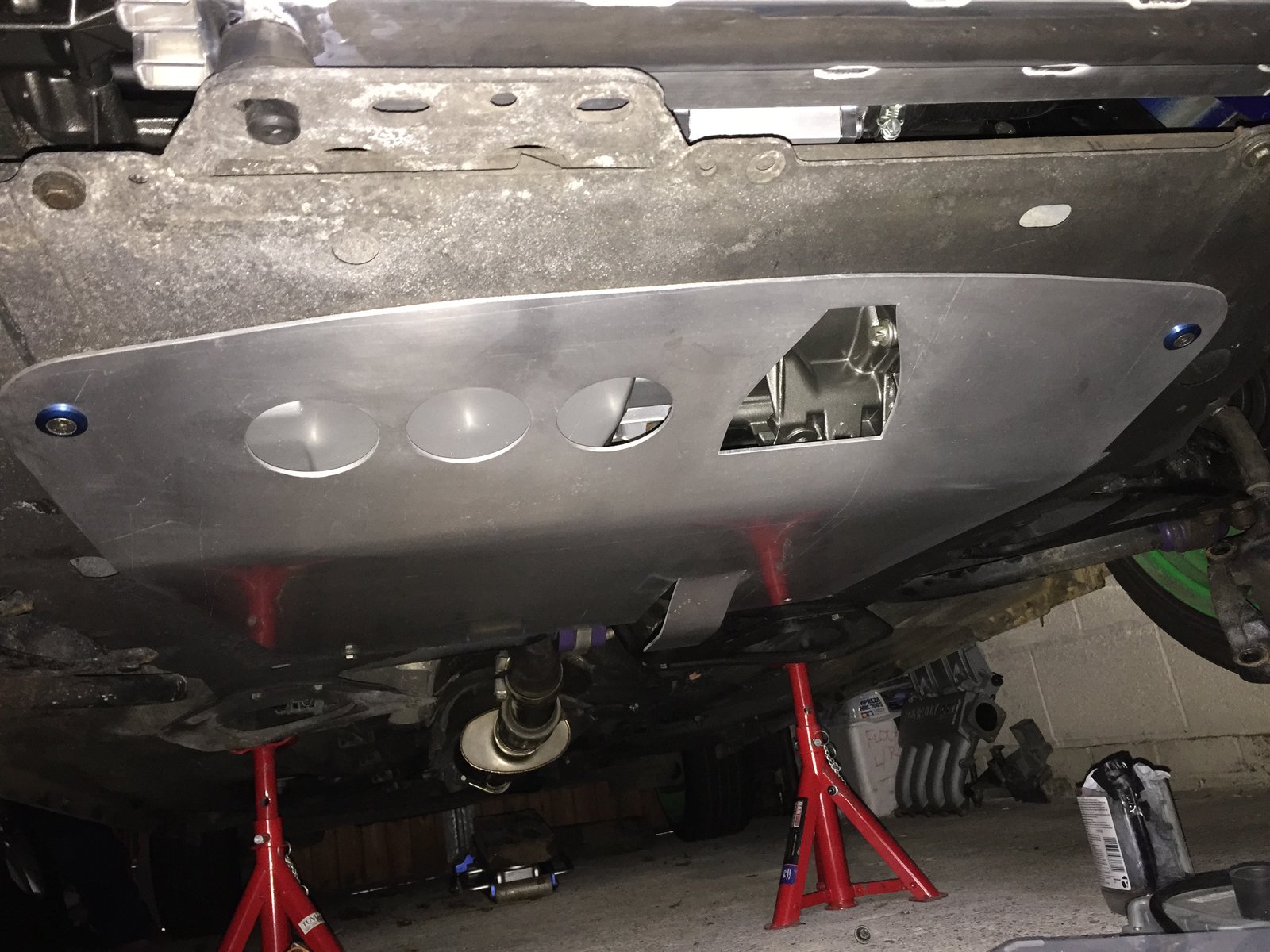

Here's a shot of it in place and showing the placement of the holes for the sump along with the oil cooler cutout.
Once it's all welded up I'm going to take it to be anodised black I think, but I'll see how I feel.

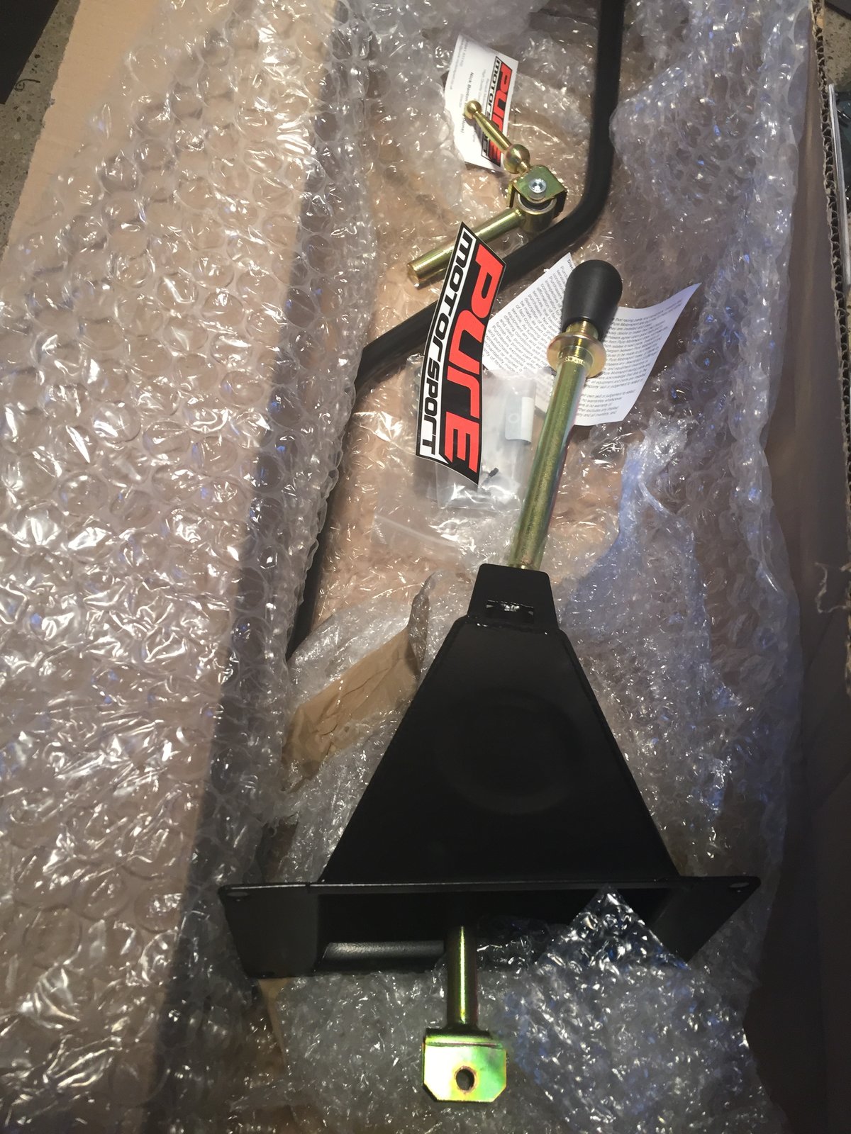

Had this arrive in the post today as well!
This will be fitted after the car has been mapped.

I think the worst thing for me is that I don't even know if it'll work! Lol! Fingers crossed it does as I cba to fit a gearbox oil cooler. I've already got the pump though.
This little job has probably got around 10-12hrs in it already with all the fitting up and checking, cutting, adjusting etc. It will need some slight adjustment as well when it's on the car as the guiding ribs are touching the gearbox casing. Nothing a die grinder can't fix, just adds time really.
