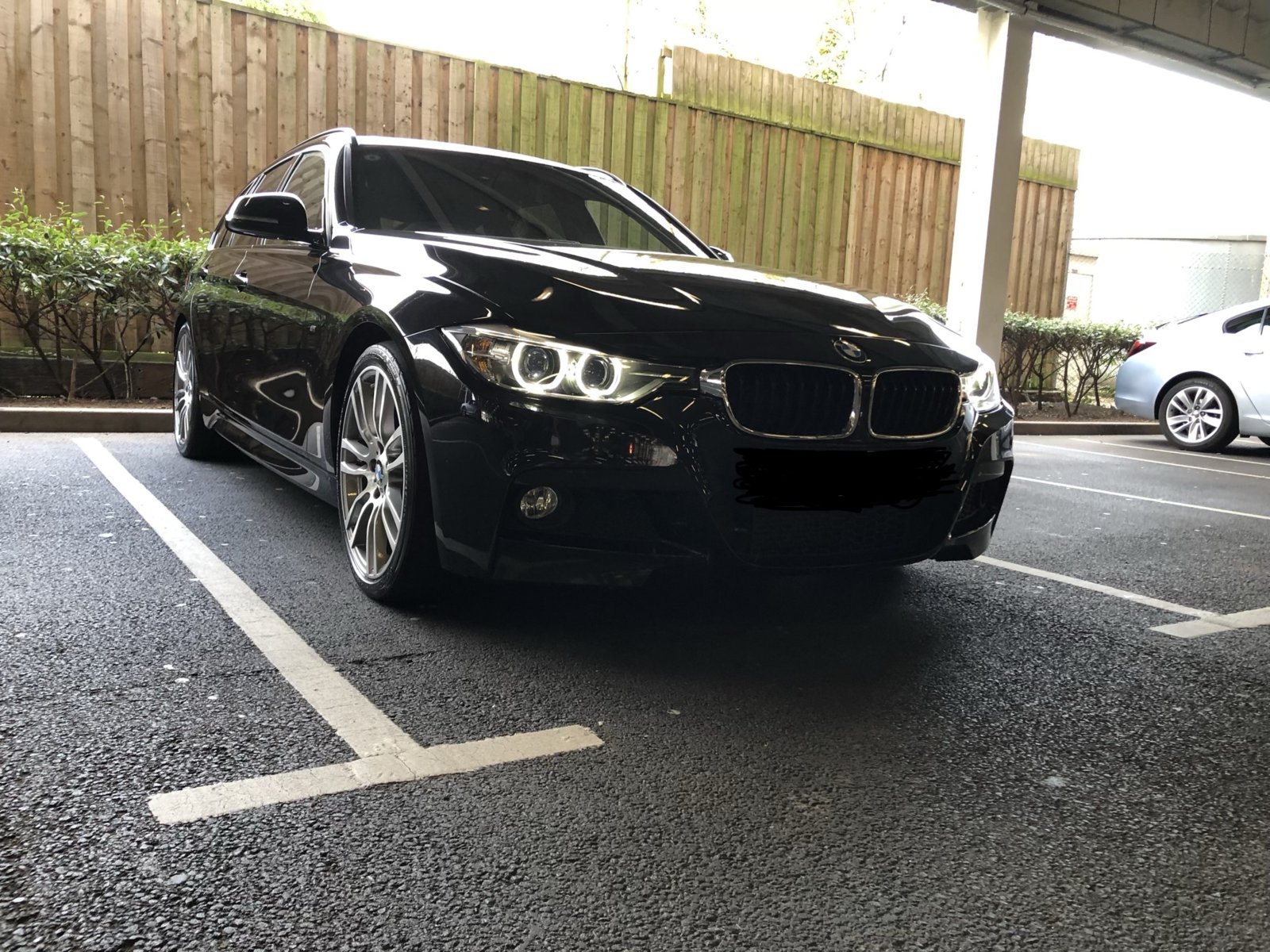

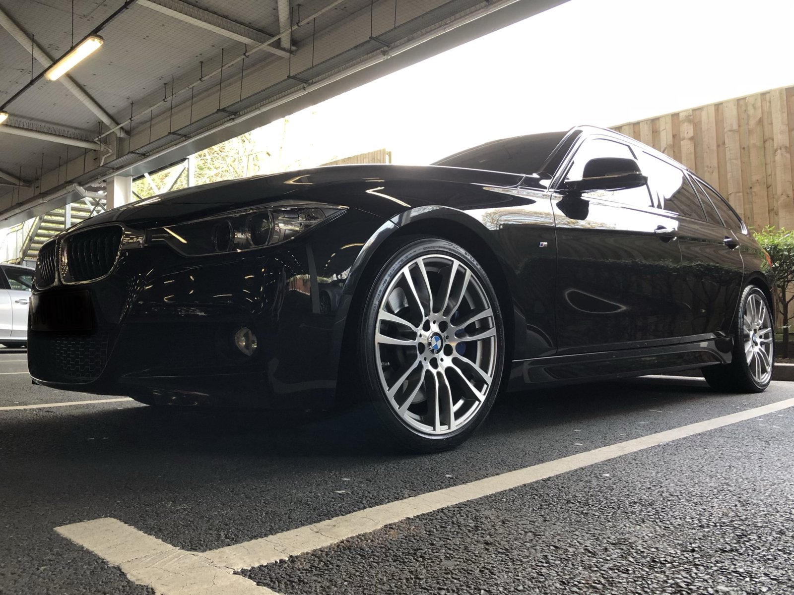

Had a day to myself yesterday, so I managed to give the 30D some attention. Started off with a snow foam, followed by a bath and a going over with the clay bar. Obviously being black you can’t see just how much s**t there is in the paint, but my clay bar told me otherwise! After that it was time to go over it with the DA, orange hex pad and some chemical guys v36. The paint didn’t really need any correction, but no point going half arsed right?
After this I gave it a coat of AF spirit wax.
Results speak for themselves.

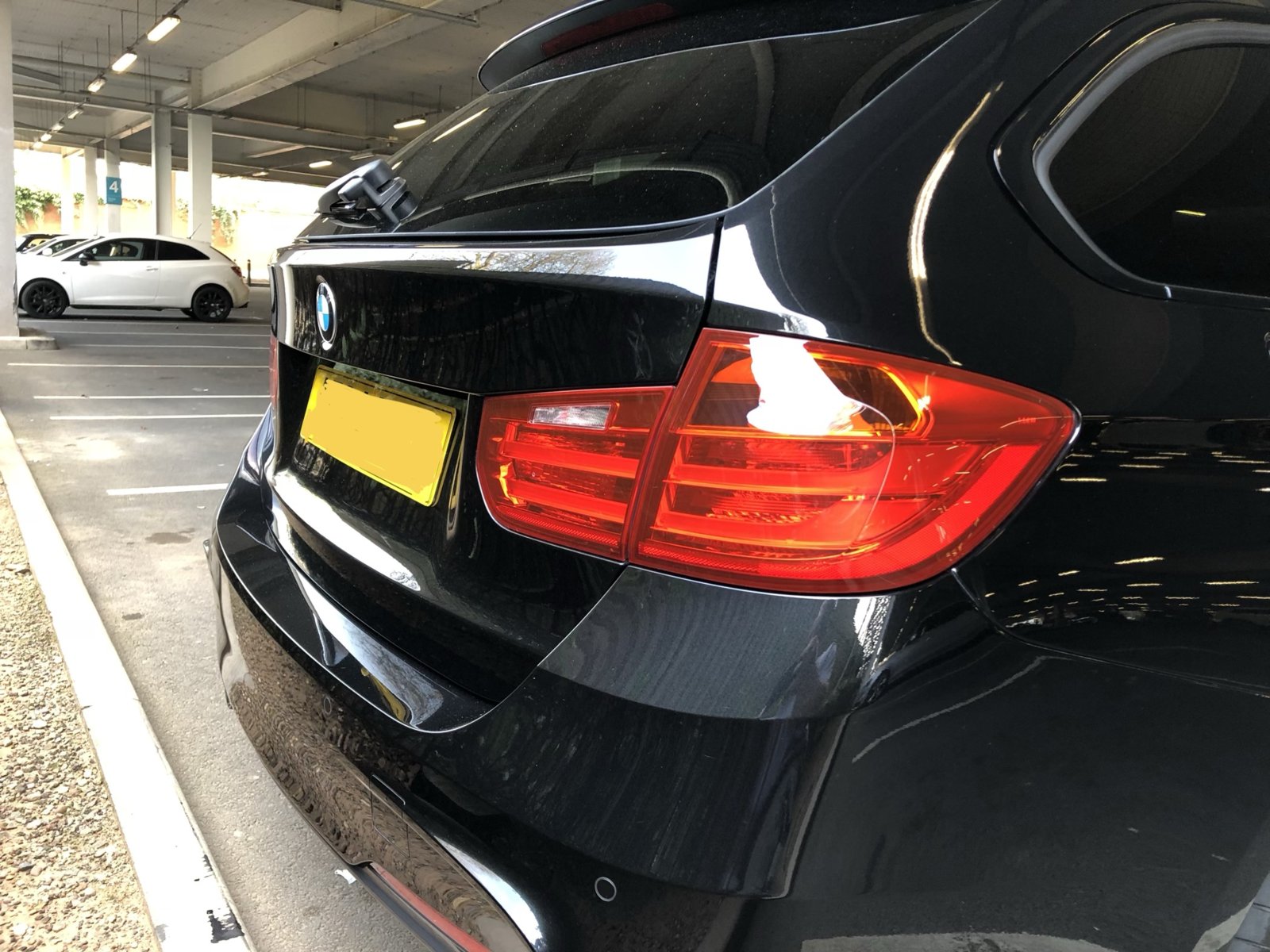

I also removed the 330D badge off the boot. Never been a fan of badges anyway, so off with its head! It also means that to the untrained eye, it could just be a 320D......now that would be embarrassing in your civic type r ?

Much prefer the wheels on yours

Lovely wheels aren’t they

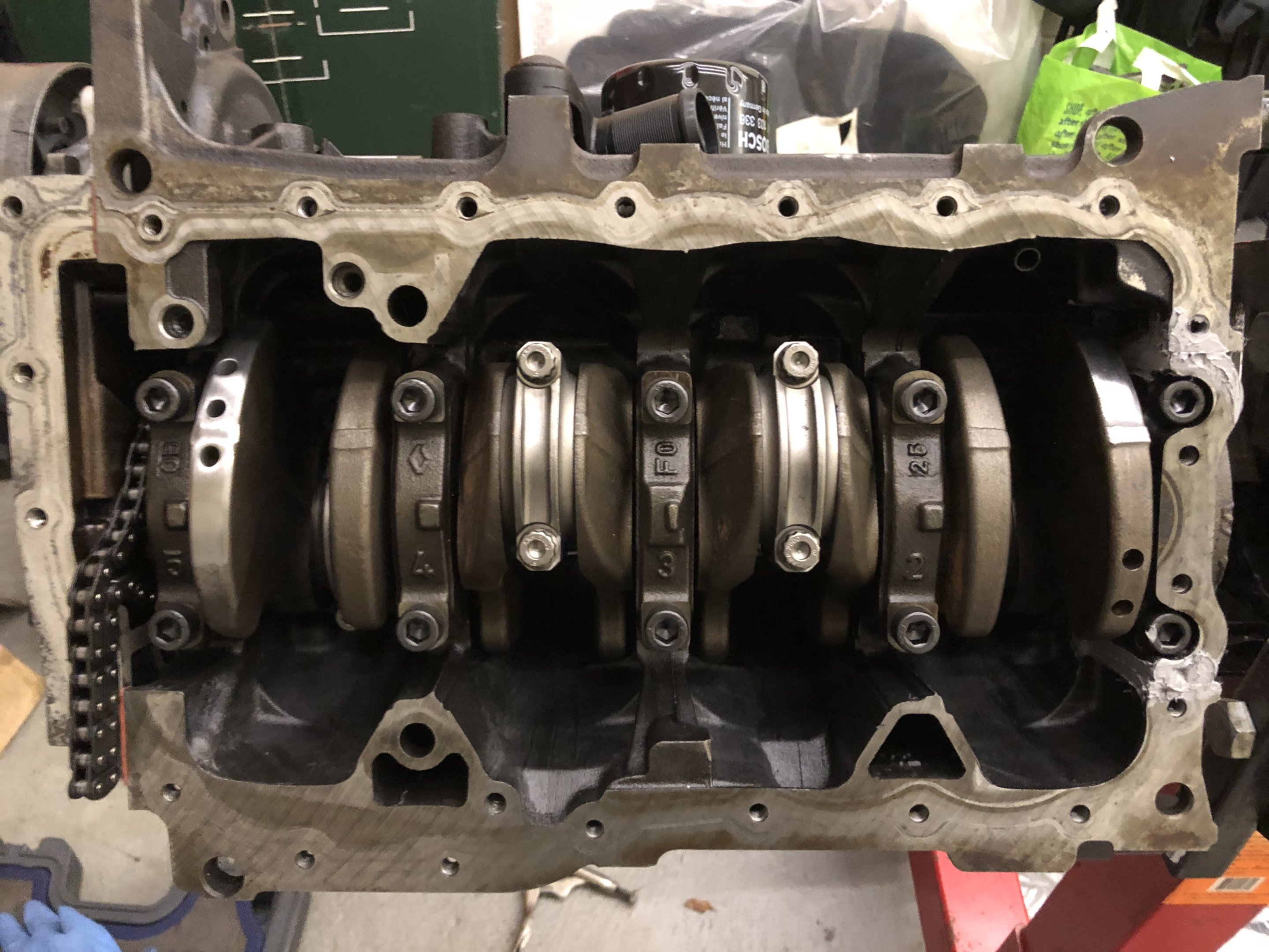

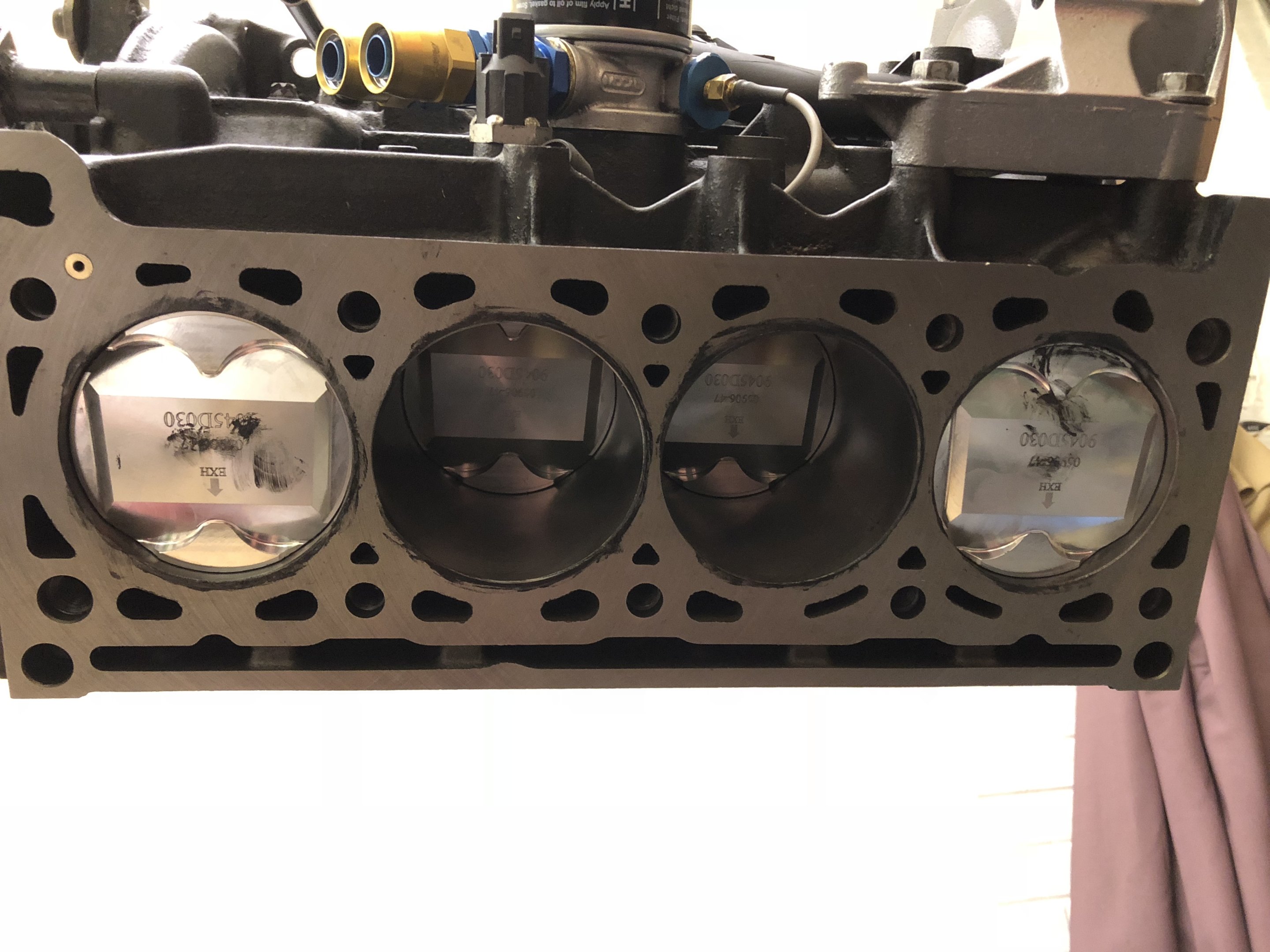

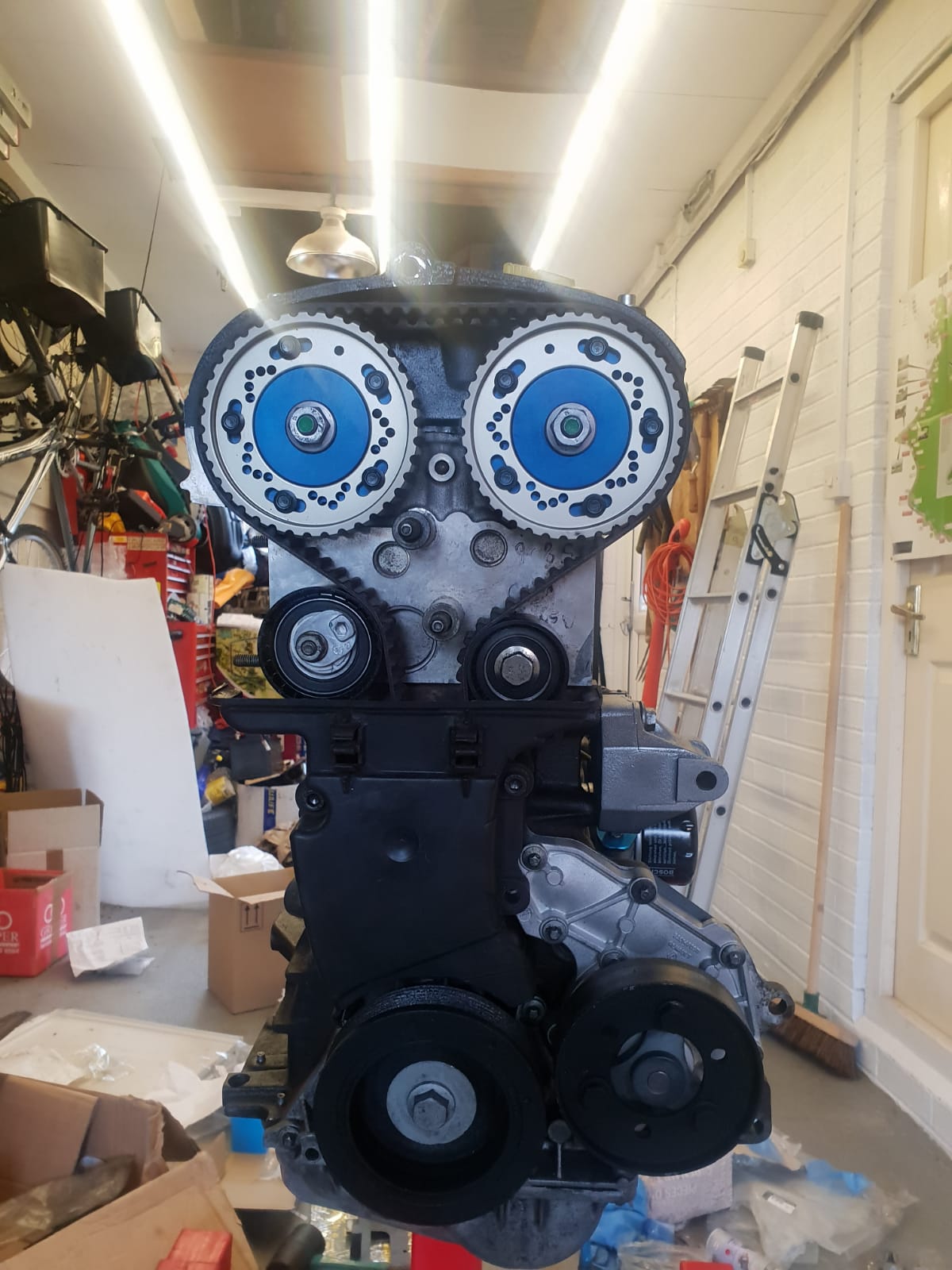

What’s a rough cost on an engine like that and how often would it need a refresh Mark?
Well it’s over £6k realistically mate. It would need a refresh or check over at the end of a season too. Checking cylinder compression throughout the season is key as it may need re ringing half way through to maintain performance. There’s over £1400’s worth of block work.
