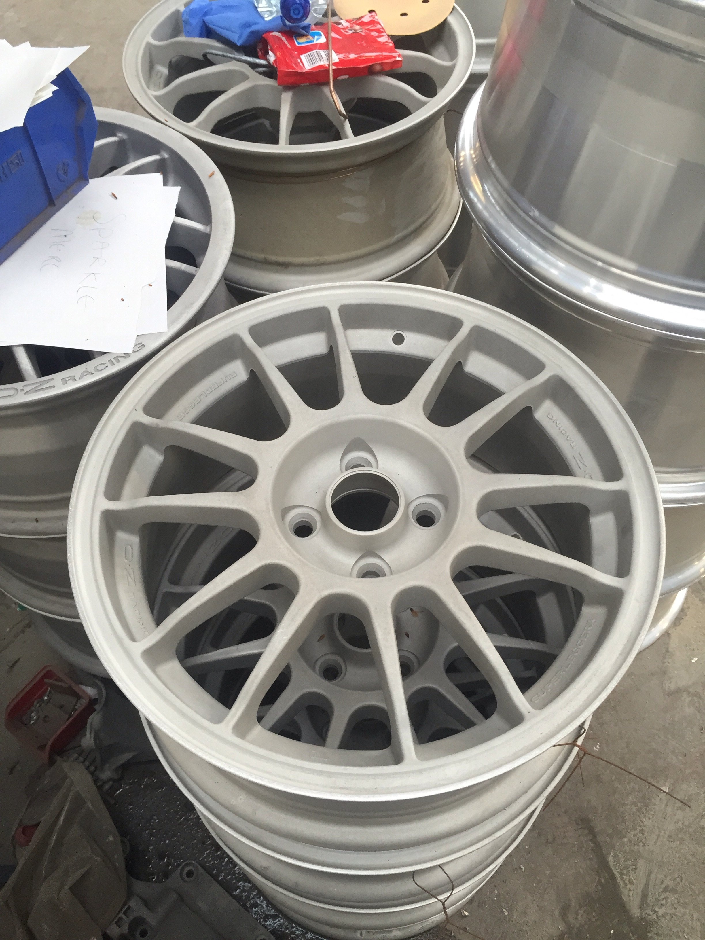

Nothing to update on the dairy milk progress, I couldn't be arsed today. Thought I'd show off my latest delivery and I fully expect it to divide opinion.
My track wheels are 15" turinis and tbh I think the car looks better on 16's. I know it's not about looks, but as with the engine, I like to go against to general consensus!!
I've bought a set of 16" superleggeras that will be painted in the green that adorns the inlet manifold and other items on the car. The wheels will be wrapped in a tasty set of 205/45 kuhmo V70a's in medium compound.
Time to try something different!!View attachment 127708
More to come!

I like the wheels. Interesting that your're going against the norm and getting 16s. Will these be just road wheels or track wheels too?
Are you planning a sexy caliper upgrade too at some point by any chance :tongueout: ?
These are going to be my track wheels mate. 16" turinis for the road and 16" superlegs for track.
No plans for caliper upgrades either. Means you have to run spacers, of which I'm not a fan.

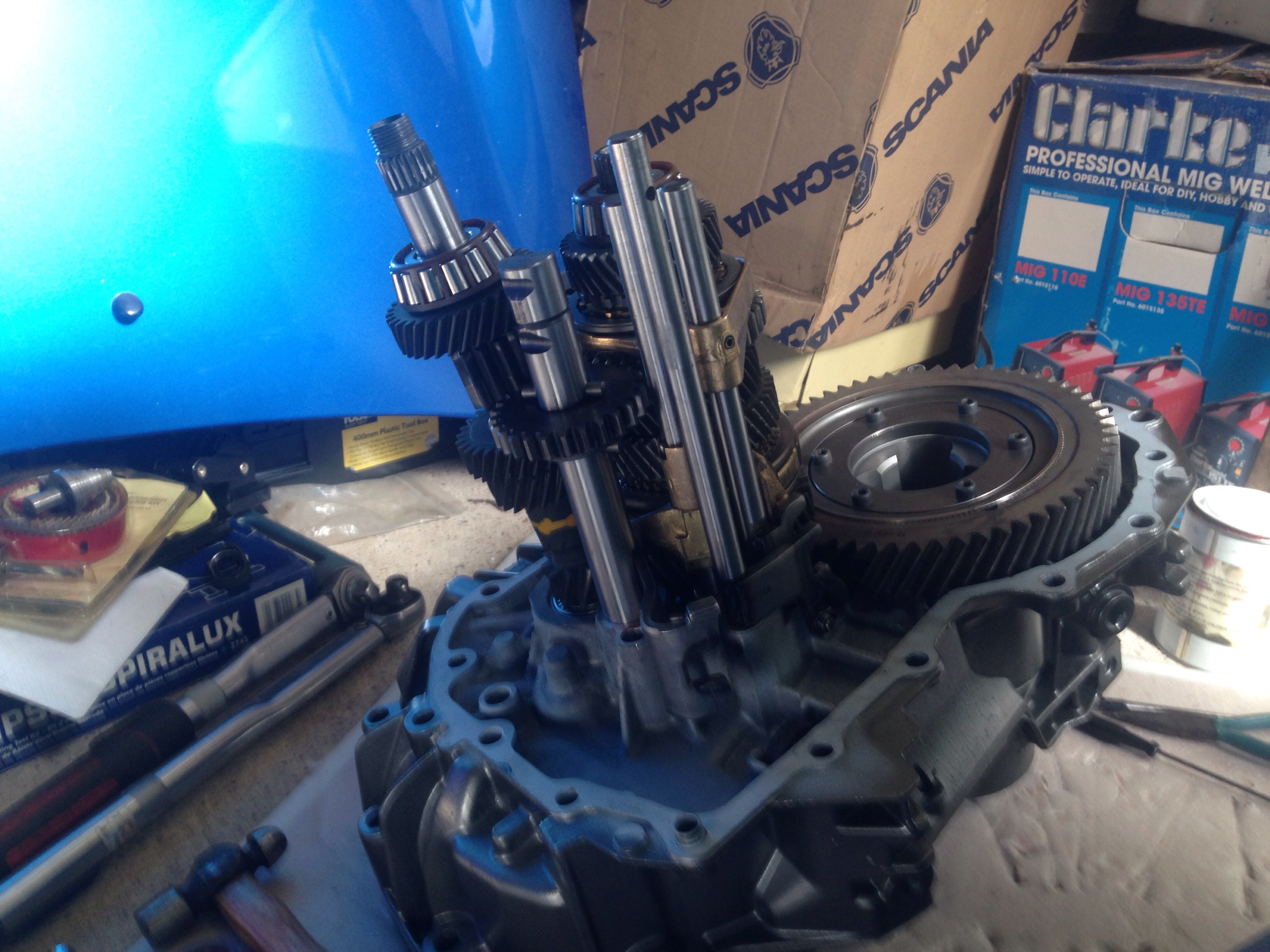

Finally had some free time today so I've managed to get the gearbox built up and ready to throw in the hole. Few pics for anyone that's looking in on the thread:
All shafts in along with selector shafts:

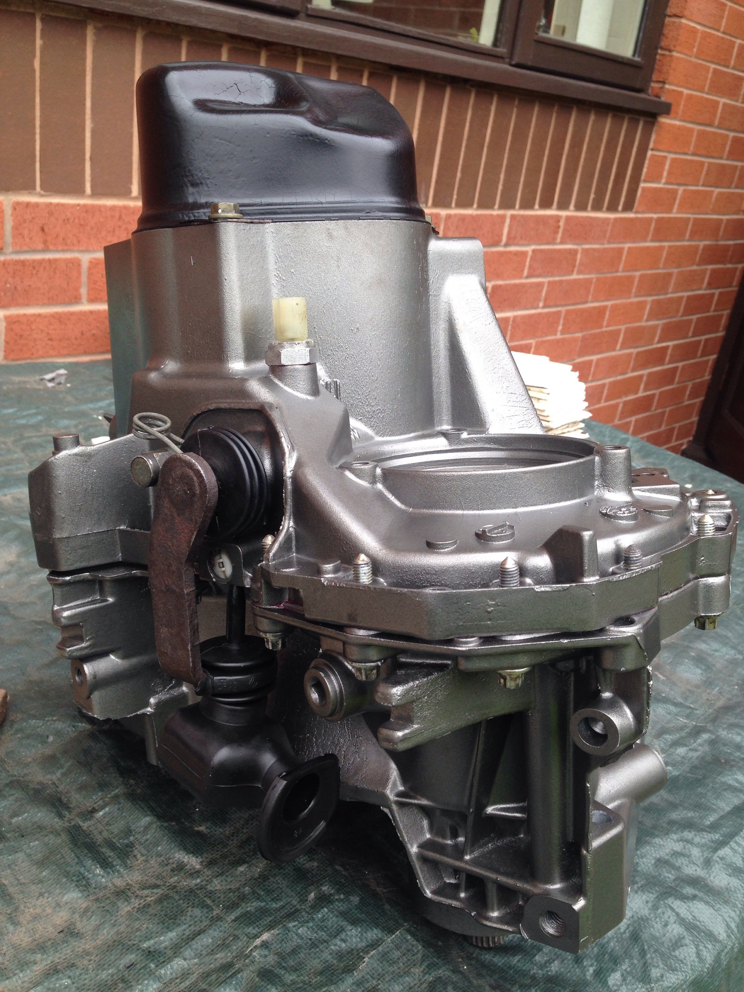

Then on with the outer casing:

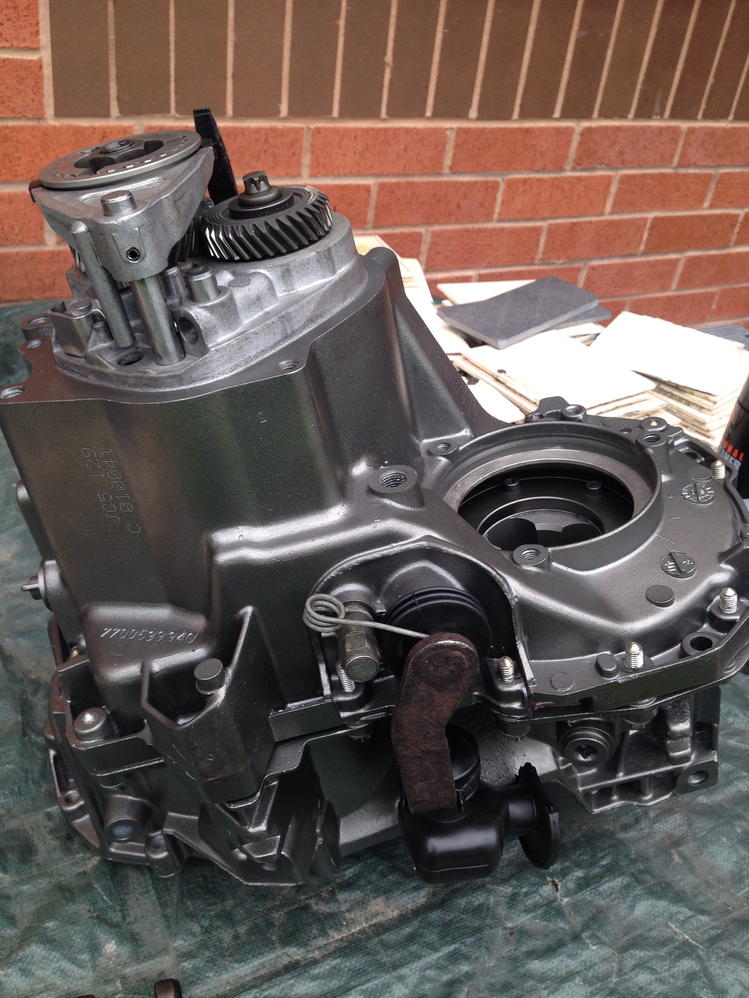

On with the shorter megane 5th gear:

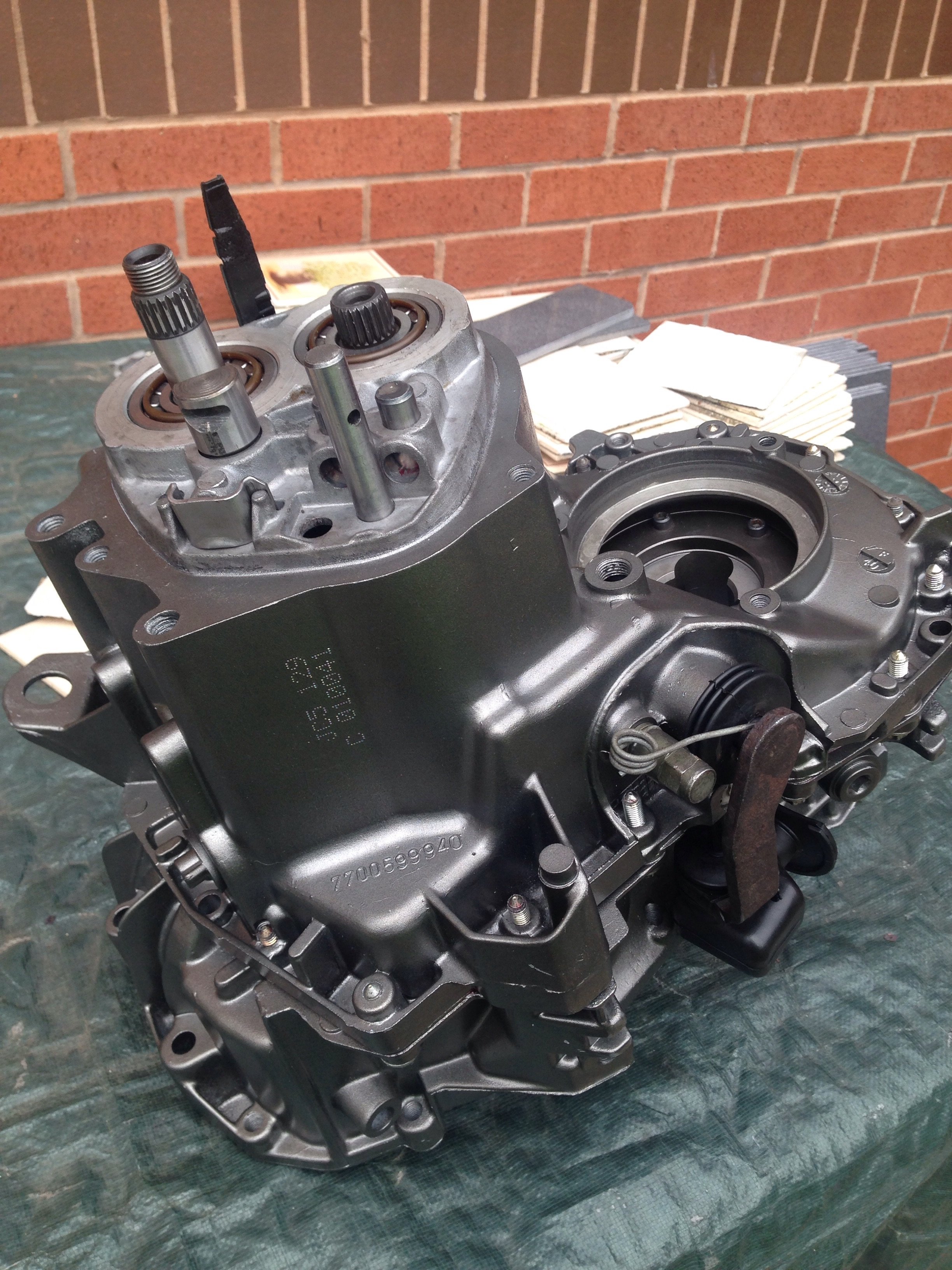

And finally, on with the end cap:
So there we have it, one fully rebuilt quaife diffed jc5! If I get time this weekend I'll throw it in the hole, but it all depends on what the fun police has pencilled in.
More to come and still plenty left to do!
