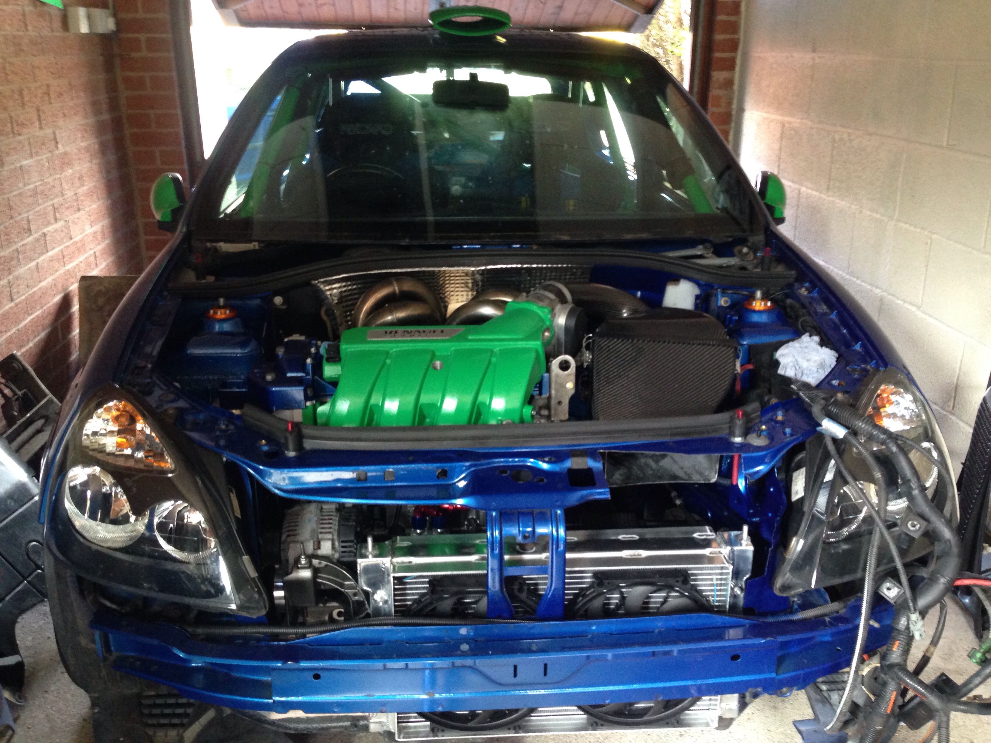

Done a bit more today. I'll just leave these here.
Now don't go getting excited! There's still no gearbox in there, so the majority of that lot is coming back out. I just wanted to see what it looked like. Lol!

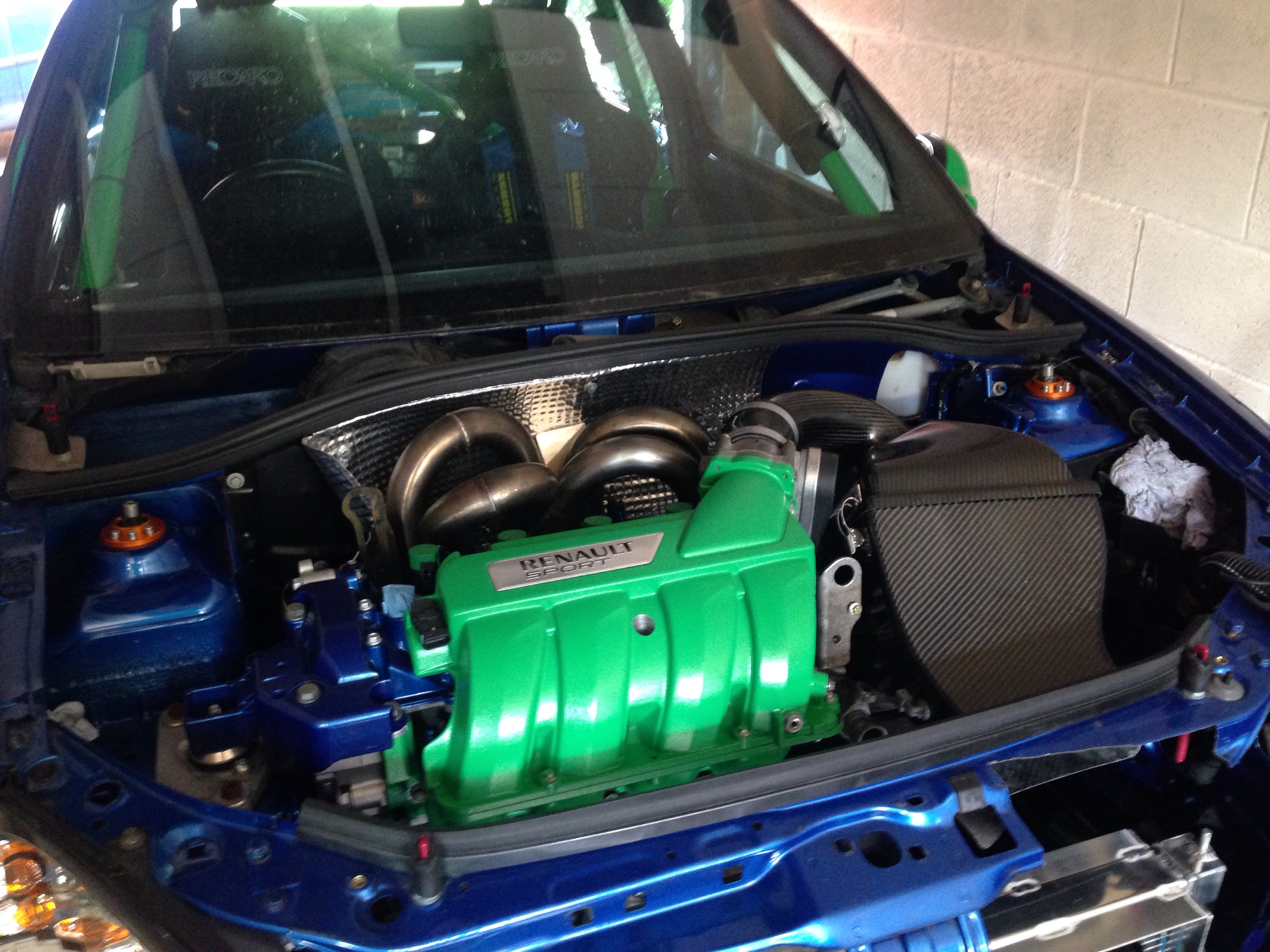

I've done the bulkhead heat shield today so the engine was removed to get better access. Pleased with the results.

Now that does look epic! Sort of makes me wish I'd got an R3 airbox, didn't want to move the battery though.
Any trouble fitting the PMS manifold to the mk3 head? or do the flanges match?
I rest my case! Battery relocation is simple as well tbf. There's probably enough space in the scuttle panel for a battery to fit in?
No mate no problems at all. The flanges are all the same across the range. Interestingly though, the 197 head is wider than the 1*2 one. Only slightly, but it's wider.
Ah right thats lucky then, shame the inlets arn't.

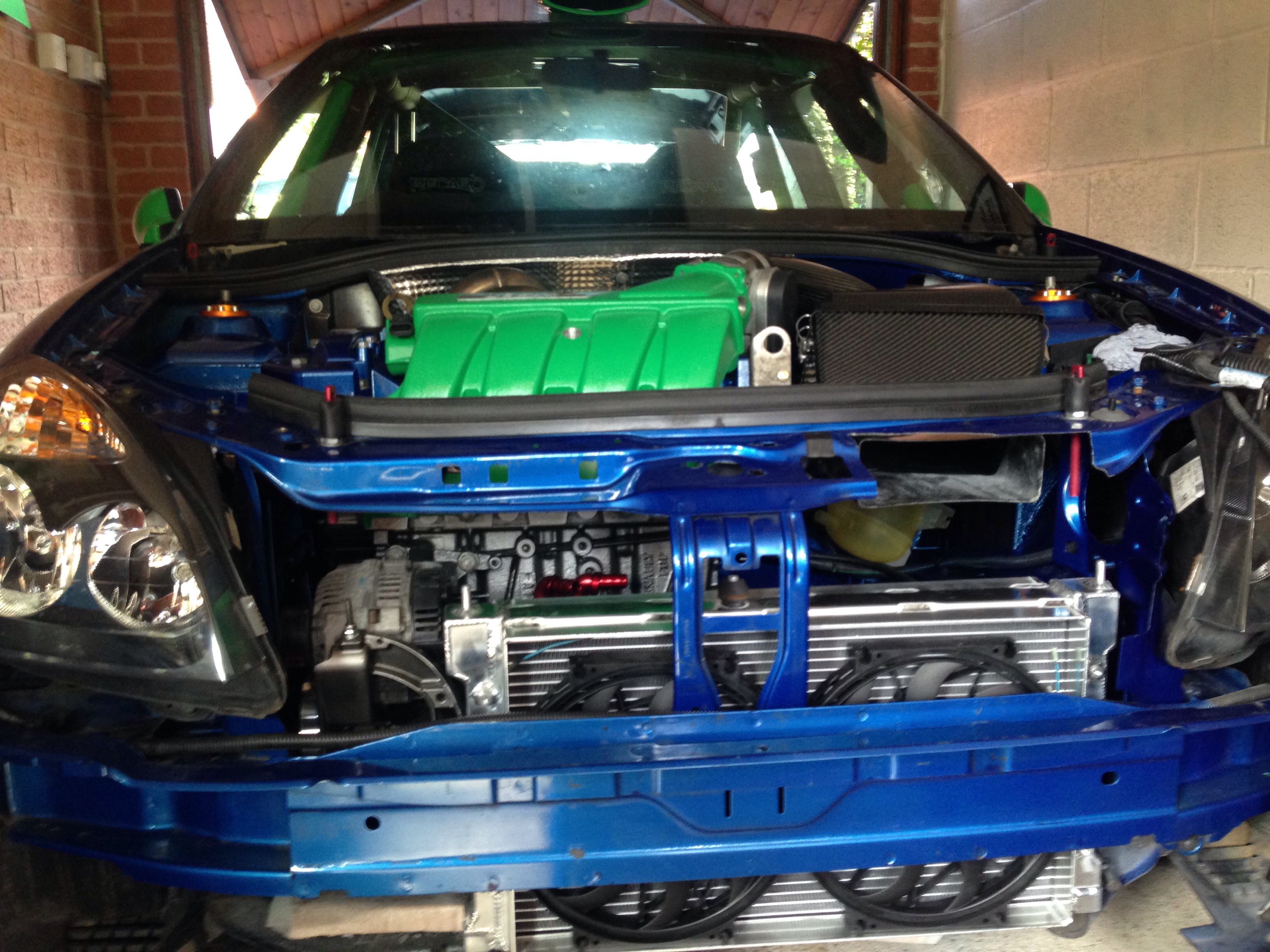

Forgot to ask is that a custom rad ?
No mate eBay special that I've adapted for my car.
Splendid stuff Mark
Cheers Sonny!
how bigs ur oil cooler, will it mount on top of the rad and run from the cooler side ?
Oil cooler is tiny mate, but it's a laminova cooler so it doesn't need to be in the airflow. It's cooling comes from coolant passing through it and it transfers the heat out of the oil.

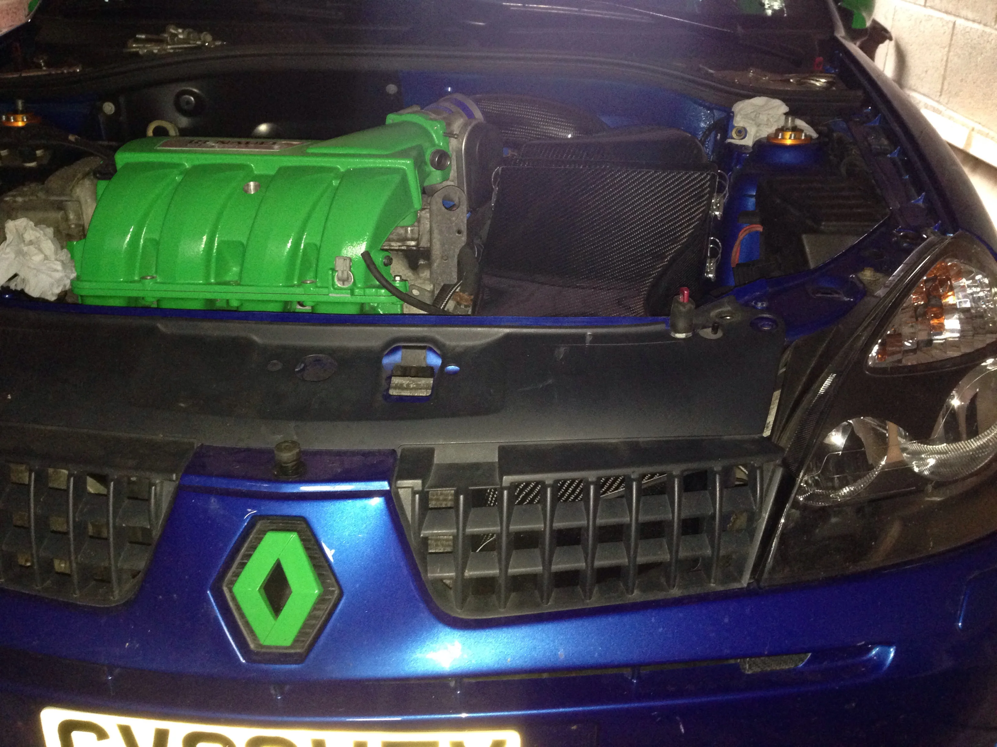

Looking at the air feed on the air box is your grille is going to cover the opening?
Exactly mate.
No it's already been modified to suit mate. This inlet has been fitted to my original engine so I could get the majority of the fettling done. It all fits nice and subtle. :wink:
