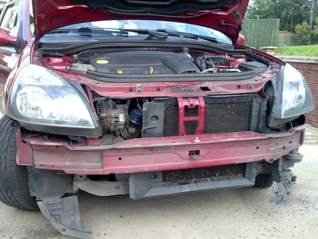

underneath the car, there are about 4 10-12mm bolts holding the bumper on. undo these and take the bumper off. lights are self explanitary to get out once the bumper is off. only 3 nolts golding them in iirc. if you get stuck let me know as i recently took my bumper off to fit xenons
if you have fog lights you will have to disconnect the wiring on the passengers side. there are natural creases in the underside plastic, like a door, to let you get in at them.
heres a pic of what it'll look like when removed.
