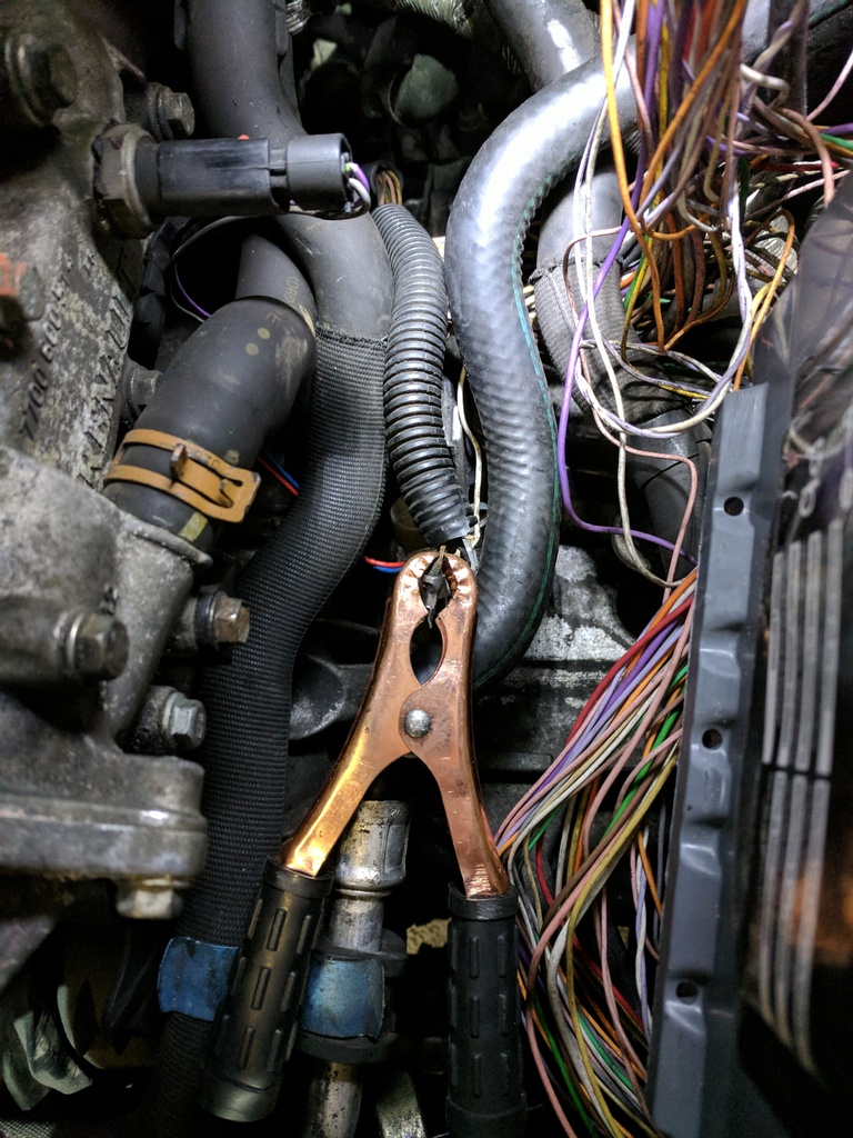

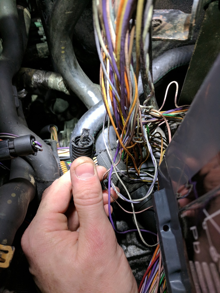

right, I've made some progress- it looks like an earthing issue to a wire in the loom.
If I earth this, the car runs:
Does anyone know where this is meant to plug in(it comes out of the loom near the starter motor, just above the gearbox)?
