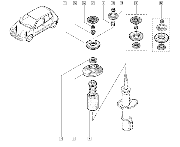

I got the top mount and nut, the bottom mount and baring. So all of number 8 in the pic below. I also got new strut to hub bolts and nuts. it came to a total of £106 and a few pence, so not the cheapest of things to do but that was for both sides
