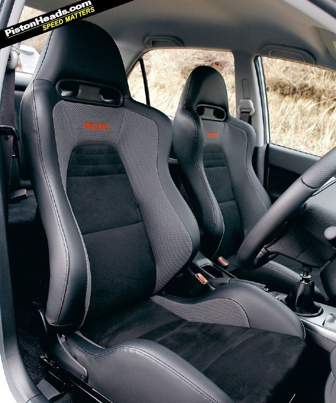

Recaro's that are the same as the Renault ones (from an Evo 5/6). Also cheap, ie £350. So many fools on here that pay a grand for Trendlines :eek:
These are from an Evo 9, they cost about £350 + subframes at £150.
