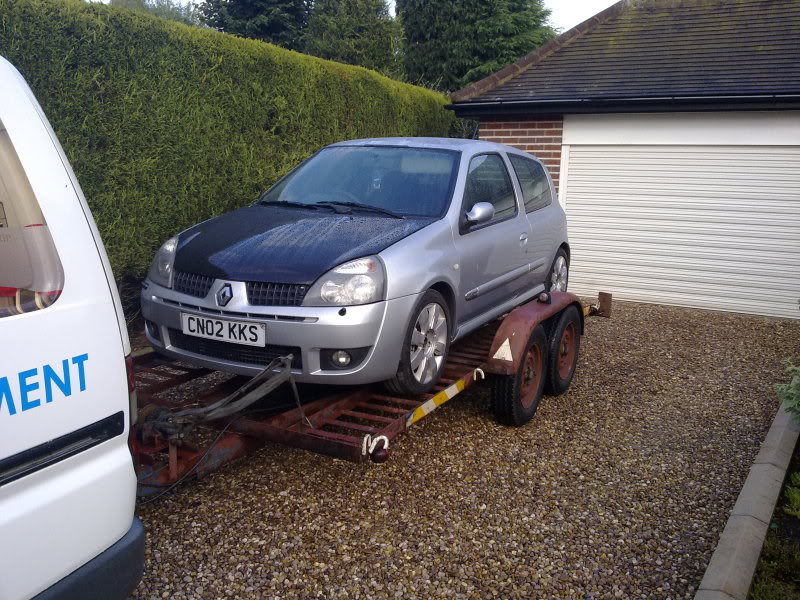

Earpl
172 cup

is it guna b ready for trax?
That strut isn't doin much. With the omp ones your supposed to take the rubber mounts off then slid the circle bits on the end of the brace over that then holds the top of the wheel arche and the shocks in place. Your one will only be holding shocks which will move anyway as the body will still flex.
ahhh interesting, ill have to make some cups then!
Glad someone noticed, i owe u a beer!
