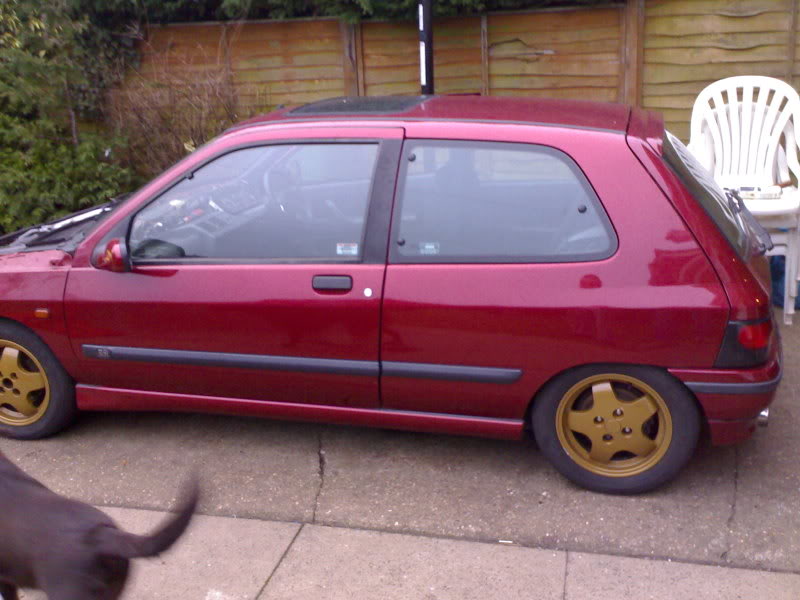

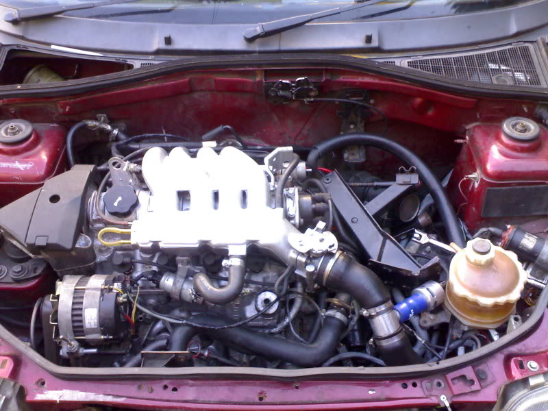

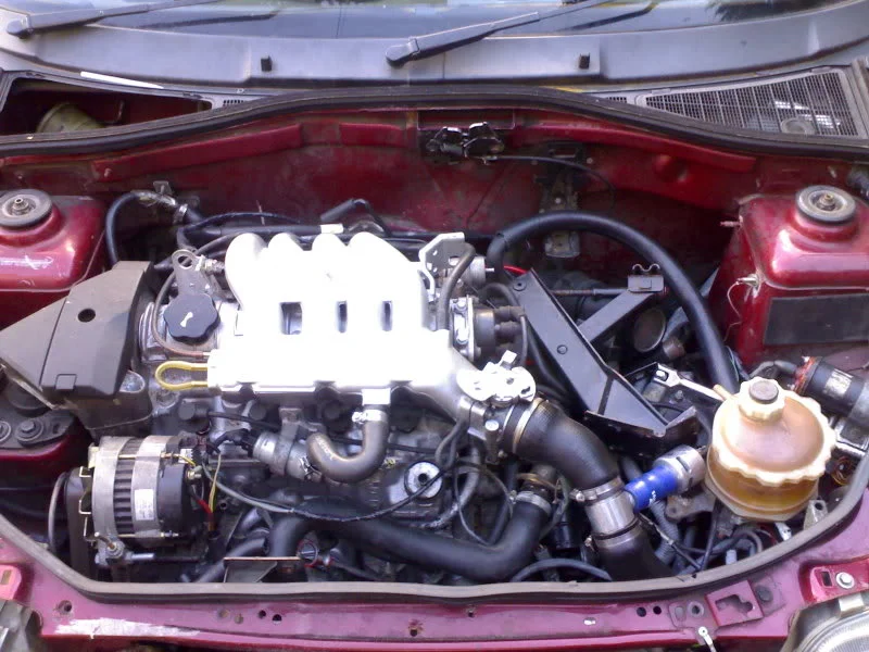

it does fit into a clio shell mate,fairly easy with no custom mounts etc.im currently bulding one that is very nearly completed.so far it has cost me under £600 including a clio rsi and a full volvo donor car.pictures below.....
The horrible gold wheels have been sprayed anphracite.im looking to spend around £200 in a scrapyard on a new turbo,injectors etc.. and then an ecu remap to give me approx 210bhp.should be fun. in my opinion for the money ive spend its an absolutly bargain an should perform well.
^^ thats more like it cheap fun good on you keep me informed how it goes i'm really interested
