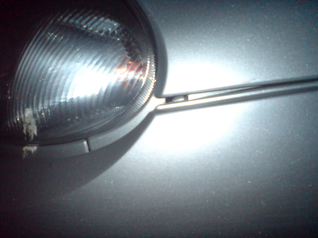

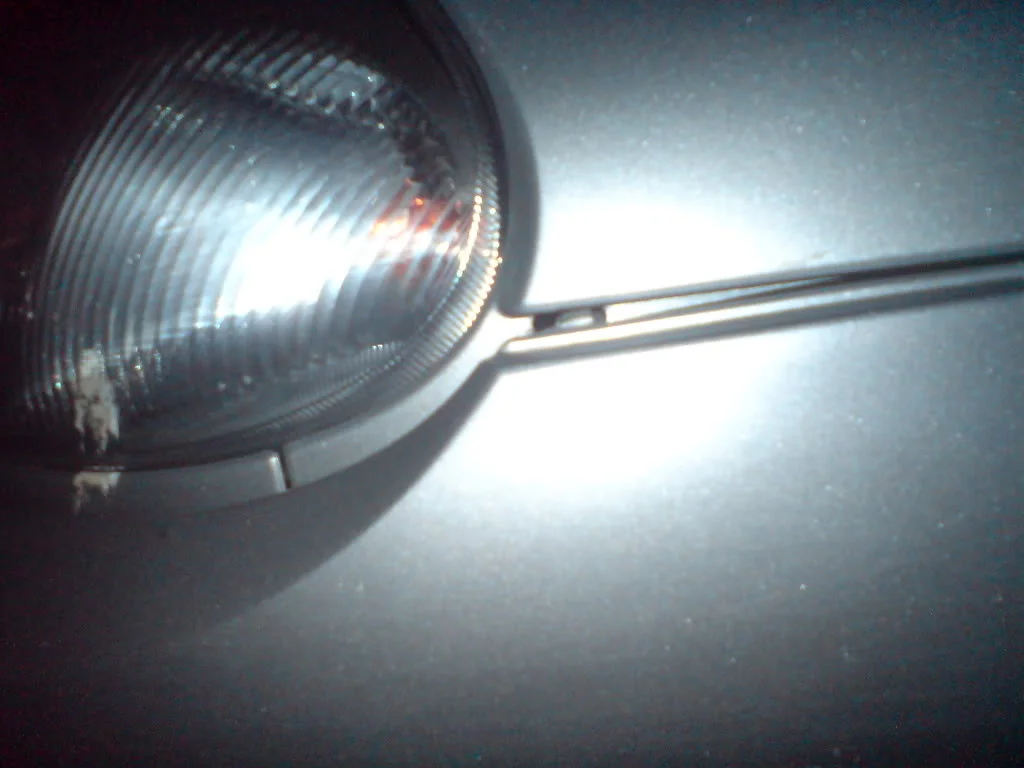

the bumper on my ph1 172 isnt sitting right. i didnt realise when i bought it but the bumper is sitting proud. i think it may hav hit a high kirb or something. the top clip isnt popping into place any more, its like the top is being pushed out. will i need a new bumper do u reckin guys?
i dunno how they are fixed on the mk2's but generally there is 2 bolts or nuts or torx screws inside the wing and shitguard, if you undo those, push the bumper up and retighten them, that should work
Easy fix :) you just need to loosen the torx screws in the middle below the grille and the bolt just behind the arch liner, then refit it so its straight and a bit higher.
Its a common problem, you can also take the bumper off and bend the bumper mount up a tad on that side as they are quite bendable.
