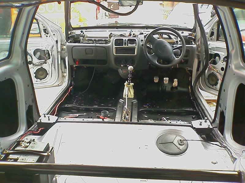

Used 'Gun wash' to remove all the sticky stuff left over from the tar. Then used red scotch brite pads to key the surfaces. After a good sweep & vacuum out we cleaned the surfaces using 'slow de-greaser'. About four 600ml cans of grey primer, two 600ml cans of satin black for the footwells & five 500ml cans of silver for the rest. Also used a little laquer for the rear strut bar. Left the rest un-laquered. Got a shed load of degreaser & gun wash left. I Bought 5 litre cans!

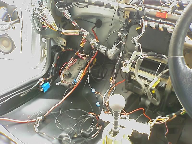

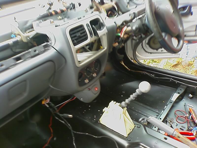

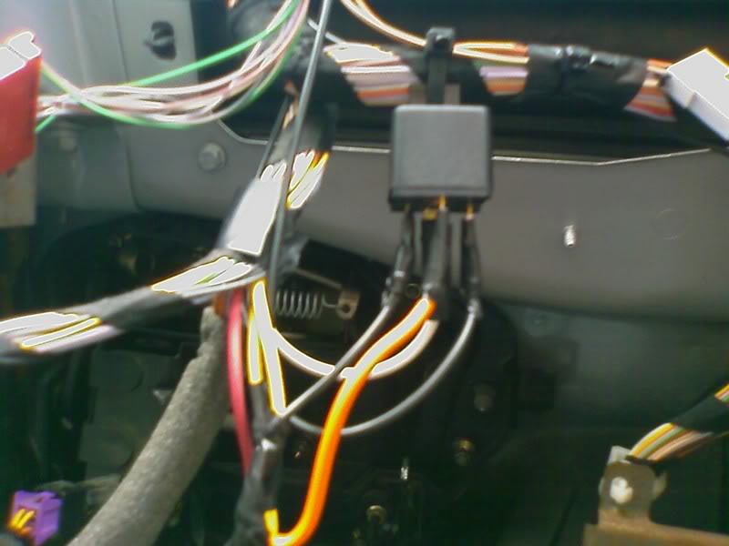

Got a fair bit done this morning. Fitted a relay to run push button start :approve: using one of the new heater panel switches for that.
Carried on with the dash/heater panel wiring, took much longer than expected but its turned out well. Everything is working as intended. Also added a power feed for my pda holder.

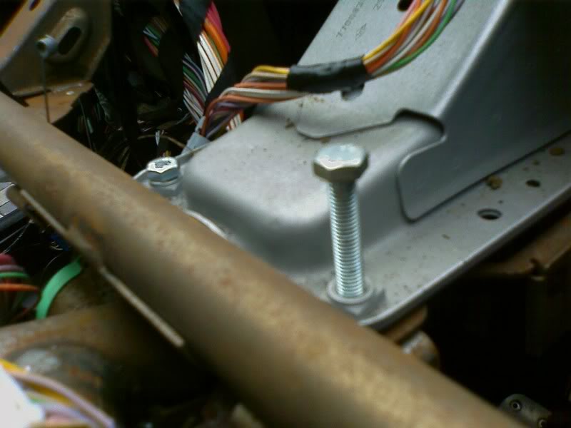

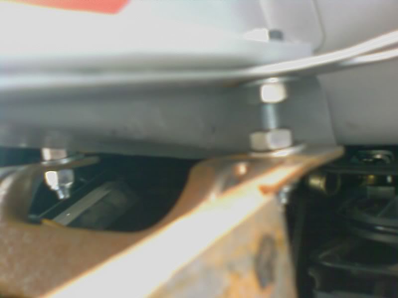

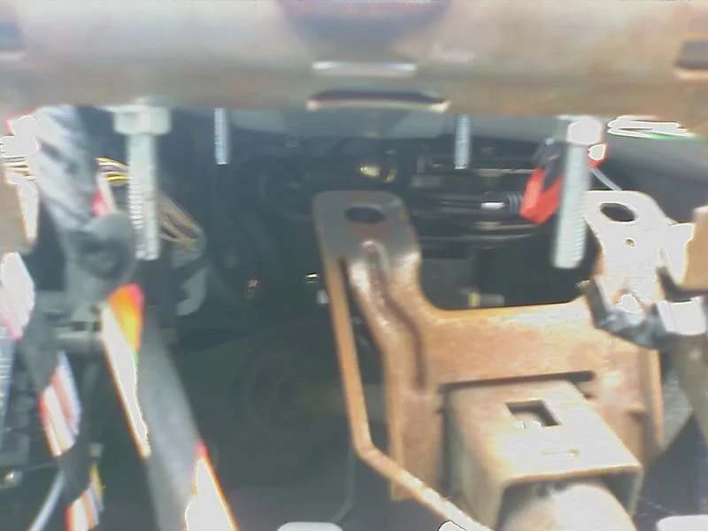

As the seating position is much lower than the standard seats, the steering wheel, even on its lowest setting, is quite high. I modified the column bracket so I could lower the whole thing down, then fitted some long bolts down through the captive nuts fitted to the bulkhead bracket.
Used some washers & nuts to make sure the studs won't move.
Using more washers, nuts & finally lock nuts, the end result is about a 40mm drop in column height.
If its too low its a simple job to adjust it up, plus the stock height adjustment still works as normal.

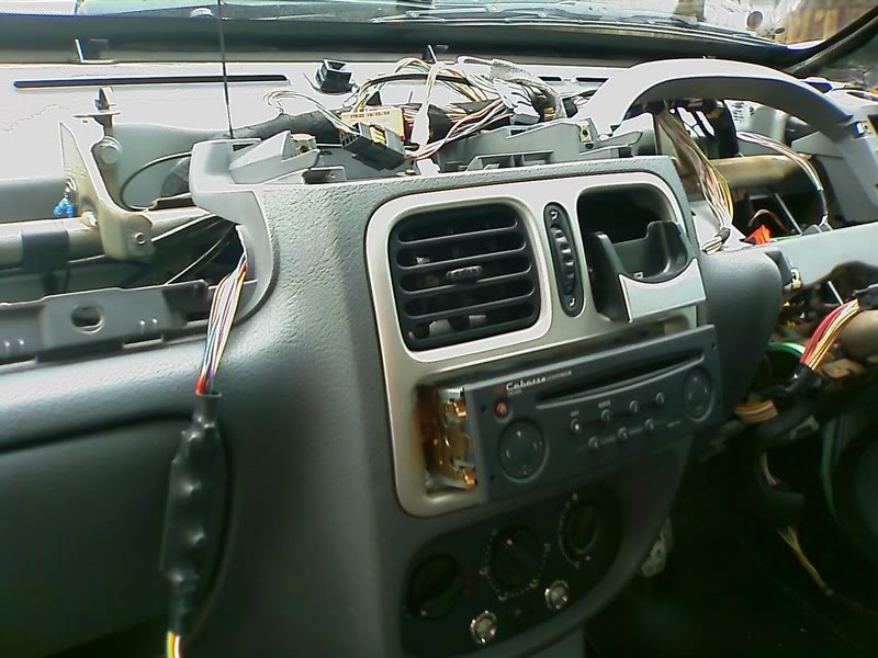

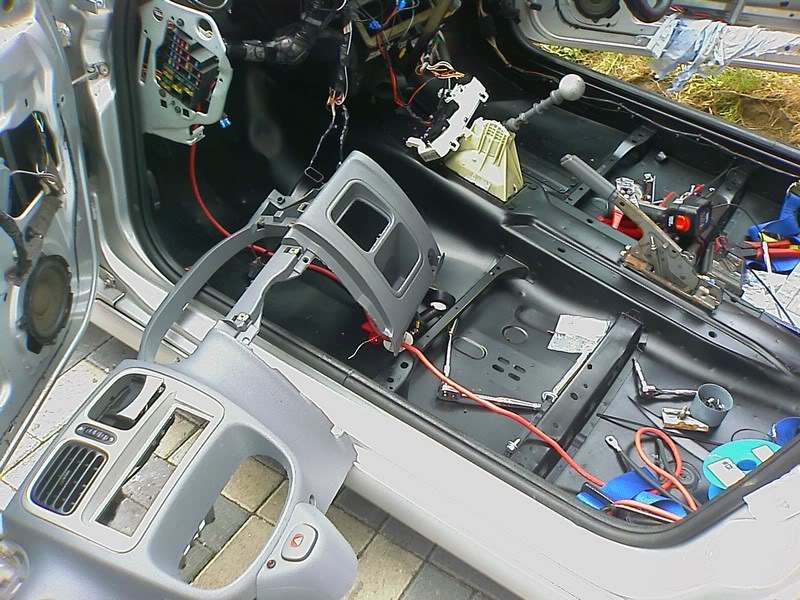

Fitted the lower dash back in...

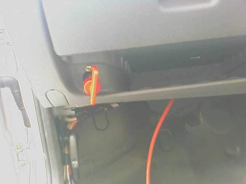

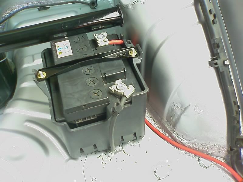

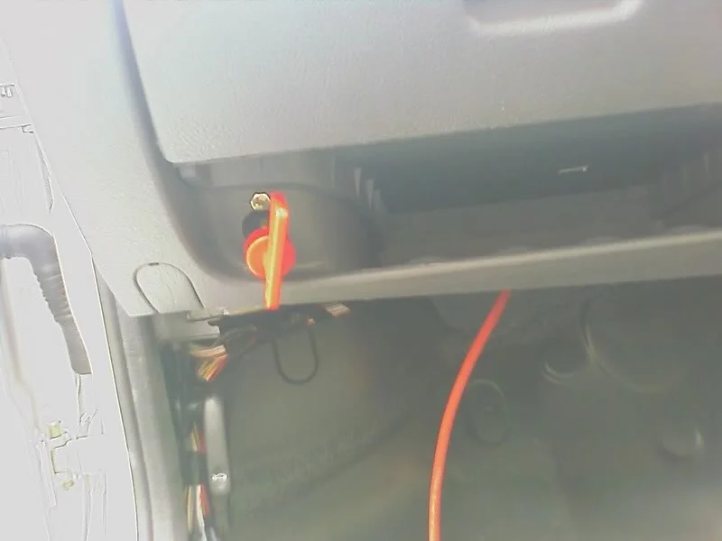

Looks alot better now. Also found a spot for the battery isolation swich....
Finally finished the battey cables off.

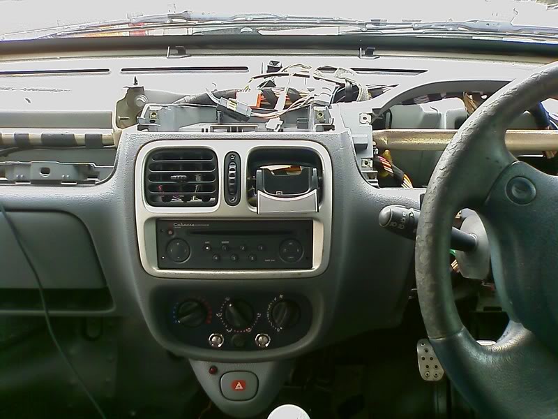

Fitted a 182 calbase headunit. Doesn't quite fit in the recess so had to file the sides a tiny bit.
How it looks now....

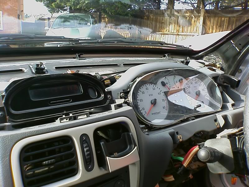

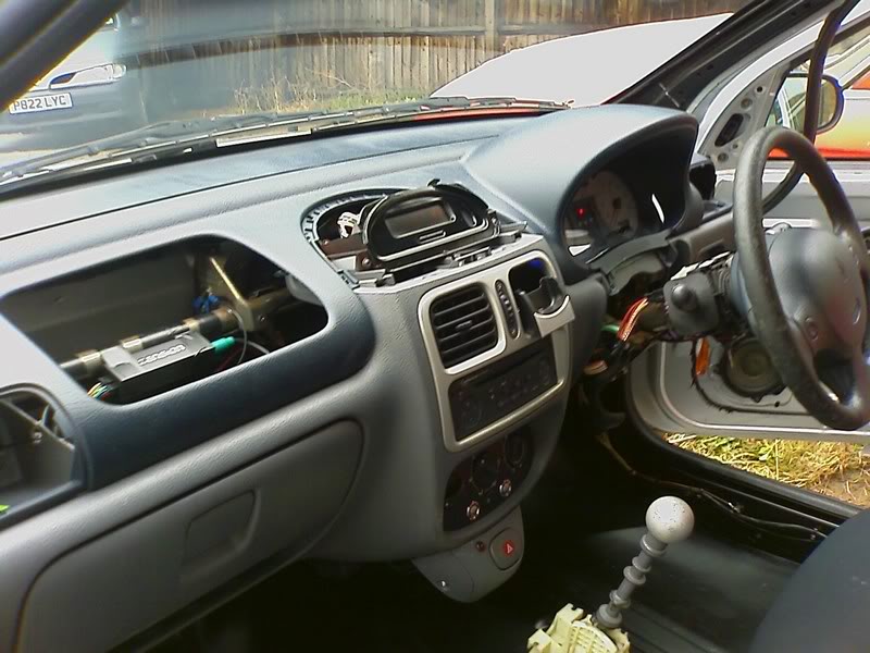

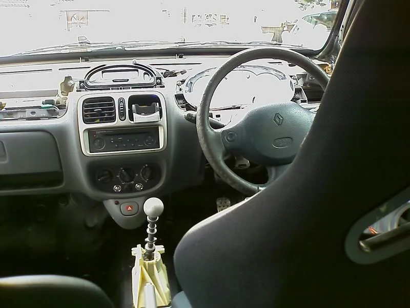

Got the clocks and radio display back in..

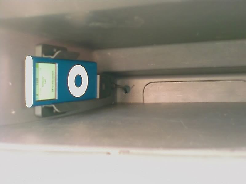

Trial fitted my 'Light weight music system' Lol.
Then it was the lying on the floor bit..... Burrrr......

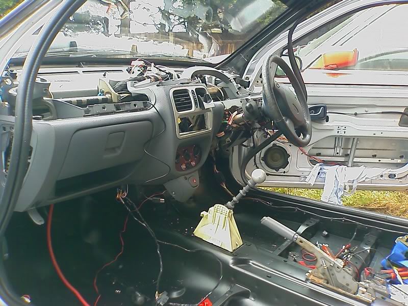

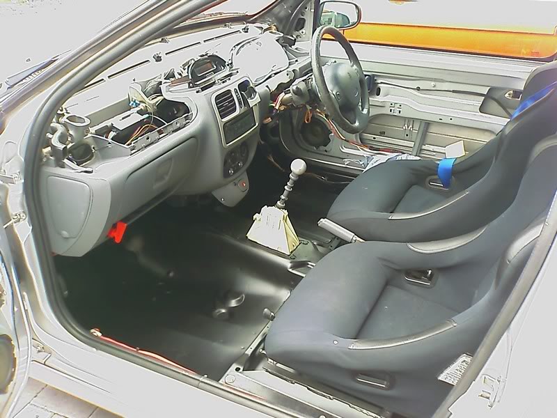

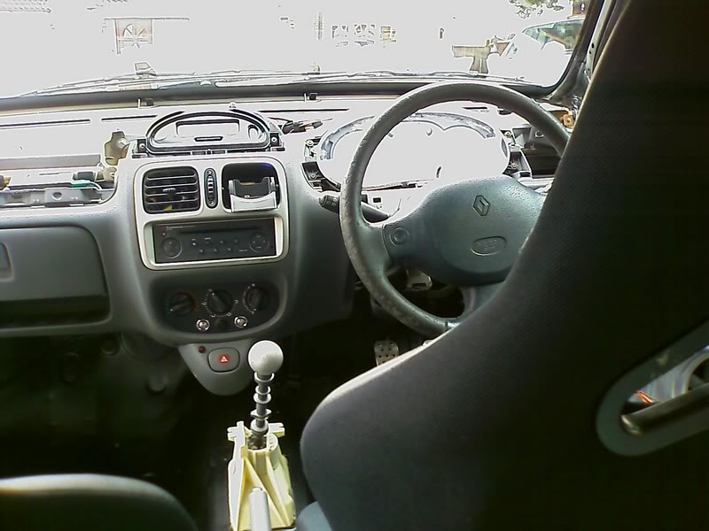

To fit the seats back in....
Fitted the god awfull blue dash top back in, whats left of it. Till the flocked one turns up.......

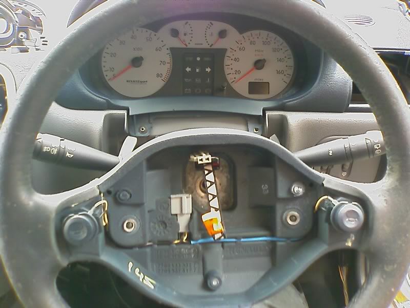

Time for the crap wheel to go
What does this bit do, let me see............ ooops.....

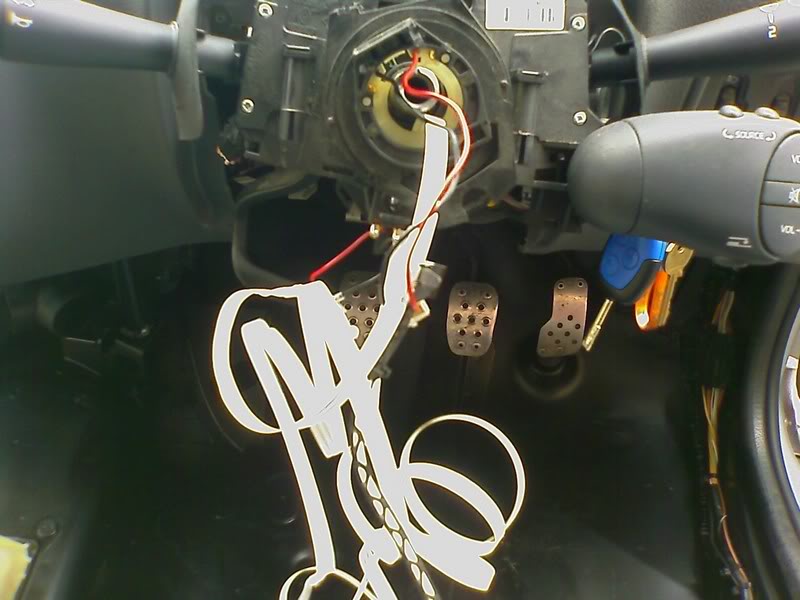

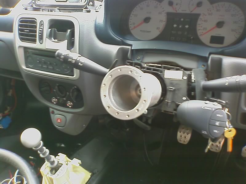

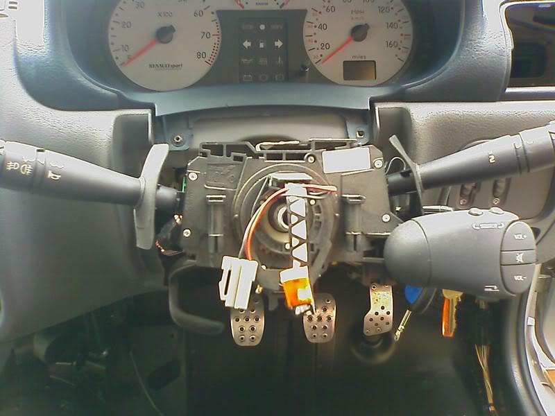

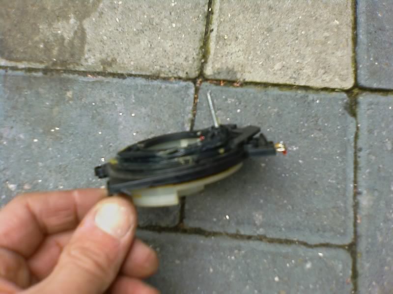

As the horn is also on the end of the indicator stalk, i ripped out all the airbag clock spring wiring.
Trial fitted the new wheel boss.

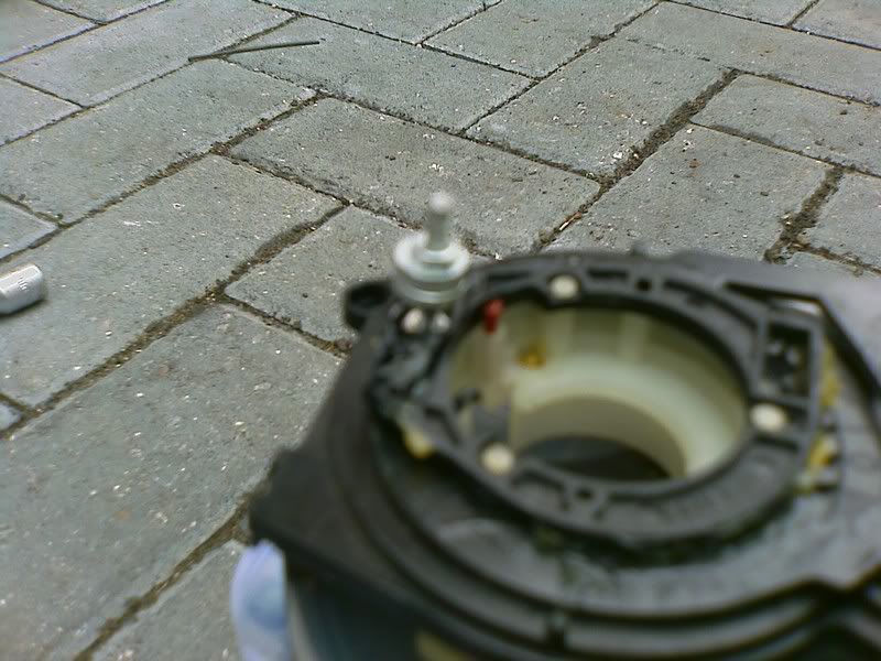

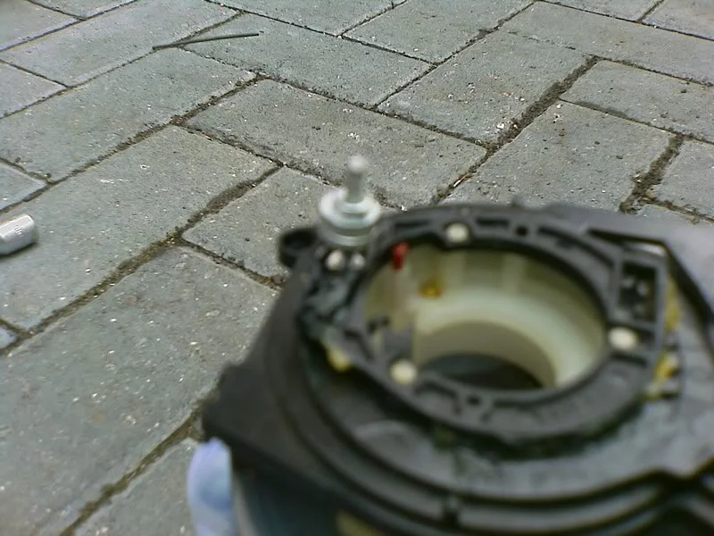

realising that the indicator self cancel function is part of the airbag clock spring unit i set about modifying this to fit the new steering boss..
The boss has a hole in the top so the bolt and washers ive added fits this nicely. Making the self cancel function work perfectly....
^ very difficult to photograph it but you get the idea..

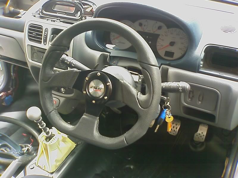

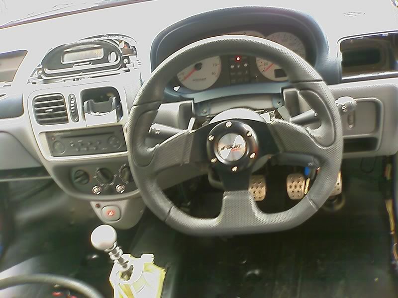

Finaly fitted the new wheel.
Now the seats and wheel are in i can see how the lowered steering coloumn feels. Its great, much better position, if anything it could do with being a little lower But its fine.

working fully with the 182 headunit, that was the point in getting rid of the kenwood that was in it when i bought it, and i already had the ipod kit for it.

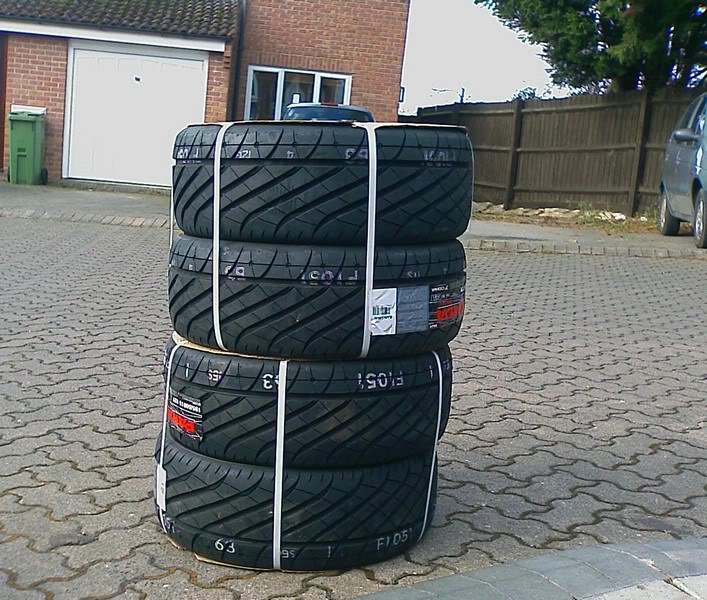

They are going on the white wheels that were on the car at the start of the thread. Painted satin black

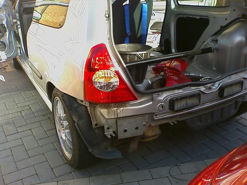

Checked all the lights and realised i had a bit of a 70's style disco going on on the near side rear light. Traced the fault to a bad earth in the loom but decided while i was there to swap to ph2 clusters.
Had them for ages along with a ph2 rear bumper, trying to decided to fit them or not. Lights on, bumper sold, decision made!

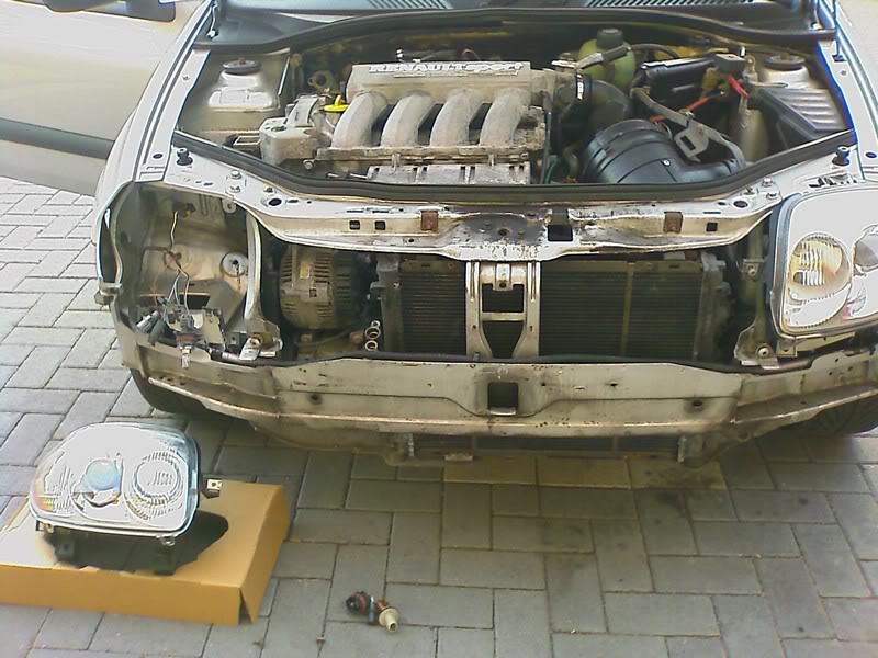

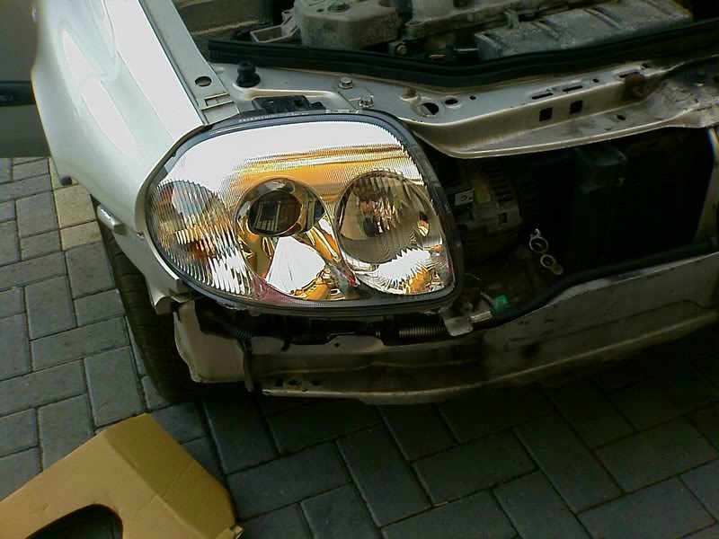

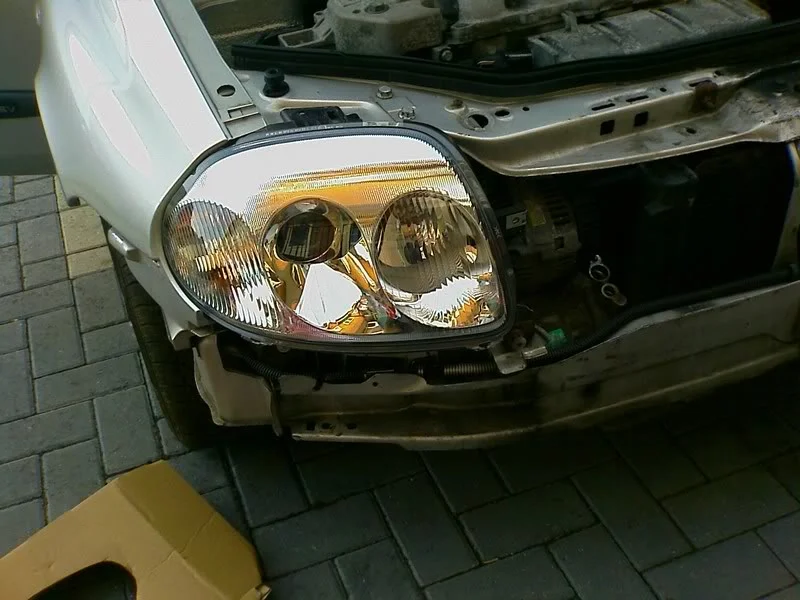

One of the headlamp bulbs didnt fit into the lamp properly so had a closer look only to find that the mount inside the lamp was broken and the lens was all loose. Absolute mission trying to find a headlamp and with time running out the only option was Renault. But as it turned out they had one on the self (3 in fact) and only took £57 of my hard earned in exchange! Baragin!
This ment that the front bumper had to come off, Again!
New eye fitted

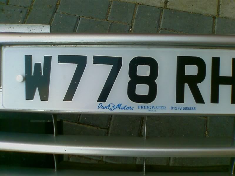

While it was off i notice the front plate.....
The guy must of been pissed when he made it!

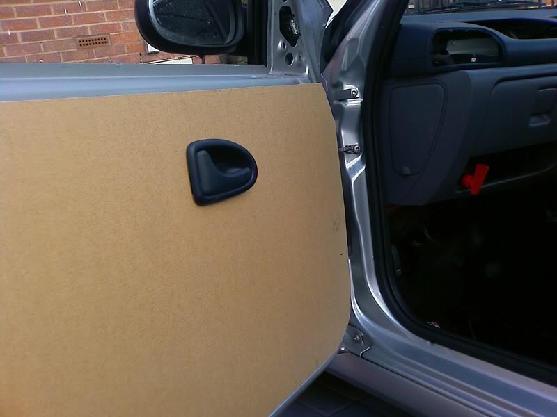

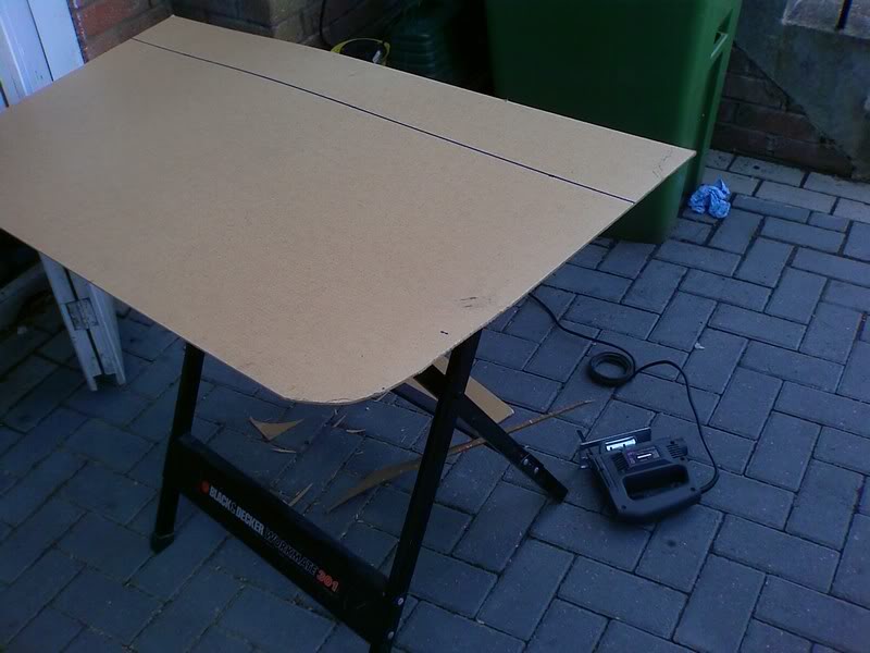

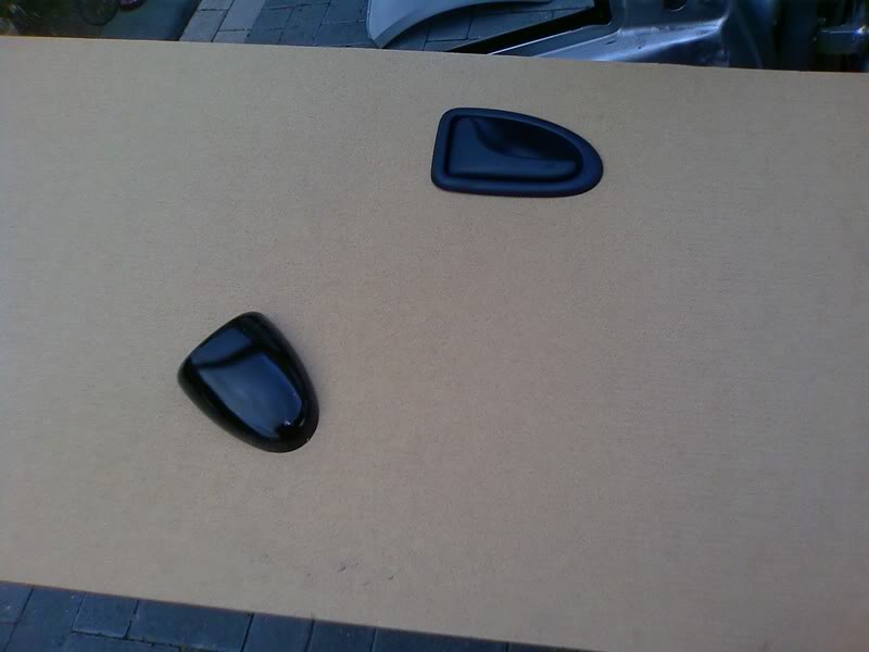

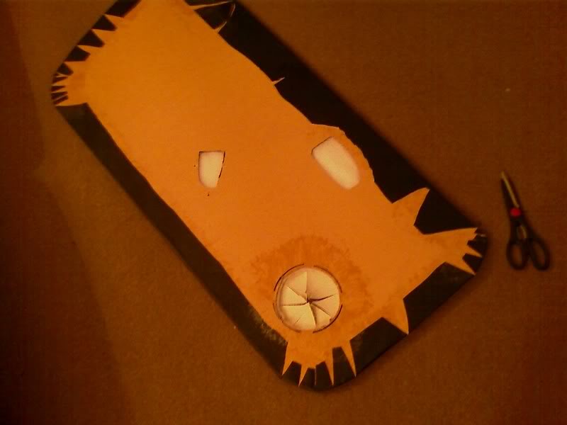

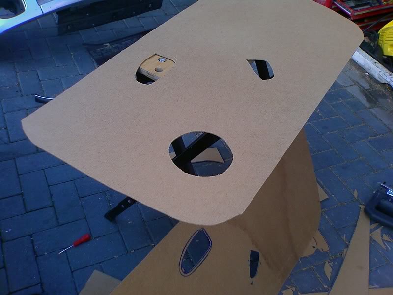

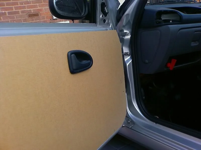

Made the door cards.
Measure twice, cut once! Copyed it to another board to make two.
Covered them with vynal. (bad pic as taken in house)
All compleated now and im please with them. They look good, cost peanuts and weigh very little. Not got time to fit them before the mot tomorrow but it will be ok without. Just had to try and get the door handles to stay in one piece as they are both very badly broken. Pics of them finished soon.

Door cards look good mate - how you going to attach them to the door?
Screws with back number plate covers
