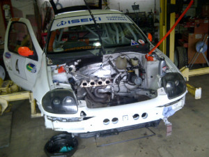

During the last 3 months Agency Transmissions have rebuilt the gearbox and 519 Automotive checked the engine over. It needed a top end rebuild but little else. We started at around 9am on the small jobs first.

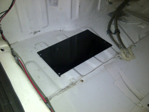

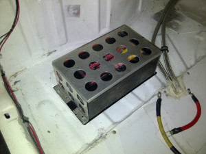

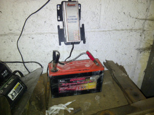

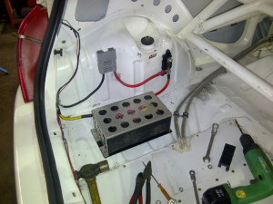

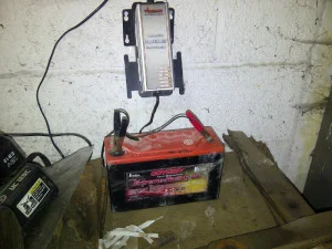

One change we decided to make to the car was to relocate the battery. We had always struggled to get the corner weights right as the rear left corner was very light. By moving the battery we will hopefully be able to balance the car a little better. As its a big old lump with plenty of cranking power we wont loose too much with the extra metre of cable. We rescued the battery from the optimiser it had been on all winter and made up a plate for it, the boot floor is not totaly flat there. Really pleased with how it came out, the jump socket is nice and easy to get too.

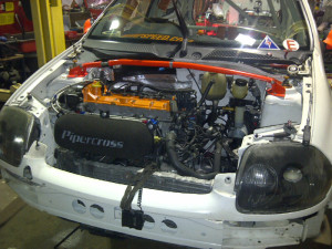

Dan from 519 dropped the engine off at lunch time and within a few hours it was in and running with no problems. A few small jobs to do but were pretty much ready now.
