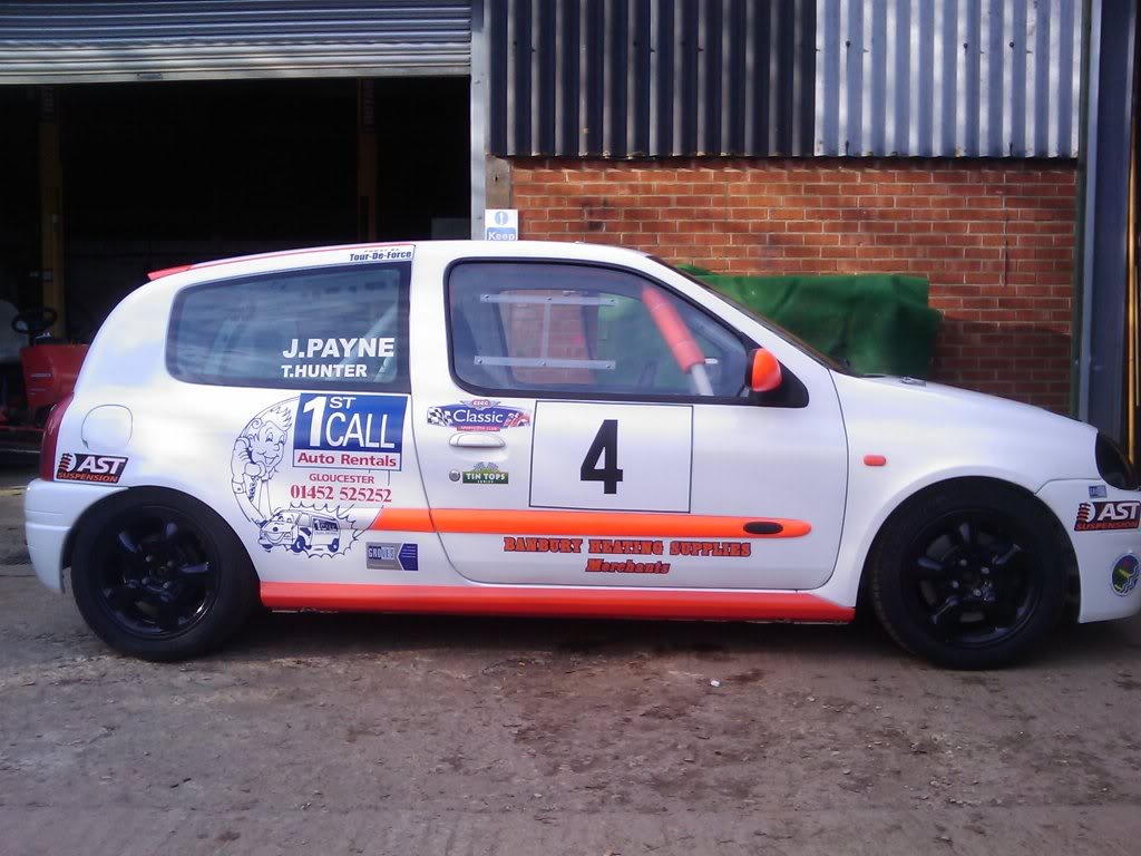

28th March 2010 - Alternator Fix And Decals
Not much to update as we have been taking a break from the car recently. Todays activities mainly centred around tidying up our spares and organising the stuff we need to take to races.
We did however manage to fix the alternator. A new regulator was needed. We also changed the pulley to a bigger one. The alternator originally came from a Volvo so probably isn't used to 7,500rpm engine speeds. A bigger pulley and a longer belt should see it turning at similar speeds to when its fitted to the Volvo. Some more livery applied too!

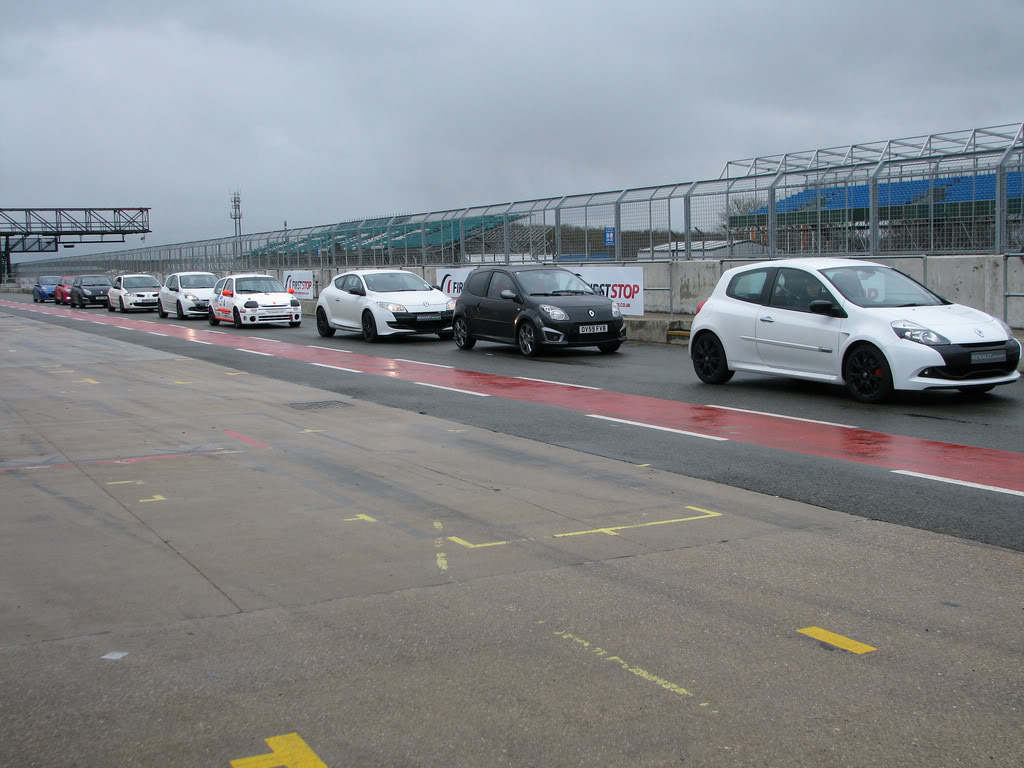

31st March 2010 - Unexpected Shakedown!
The snow at Bedford back in Febuary ment that the car still hadn't been driven on circuit.
Today we took the car up to Silverstone to get a noise test done on the exhaust. There was a Renaultsport trackday taking place. They didn't have a hand held sound meter, only the meter fixed to the pit wall. An instructor volunteered to drive it by to get a reading. In the end he did 7 laps before returing to the pits and saying 'its great'. No strange noises, it went straight, stopped stright and everything worked as it should. He was quite impressed with how well the engine picked up.
We were totaly unprepaired for it to hit the track, the suspension still hasn't been setup and we didn't even check the tyre pressures.
BUT, for the car to be driven by a professional for its first run out was very helpfull.
  172 Race Car
Valver wheels have got PE2's on for kocking about with and monsoon conditions. Main race wheels are Pro-Race 2's
Nafoff
ah yes, thought they may be....good set-up then really, guessing the added wait of the phase 2's suit wet and knocking about on
look forward to catching up at combe
  Qashcow
great news jay and tony. was surprised when you text me the other day about this, a bit out of the blue. i cant see who the 'first call' stickers are but i recognise the decals, which company is that?

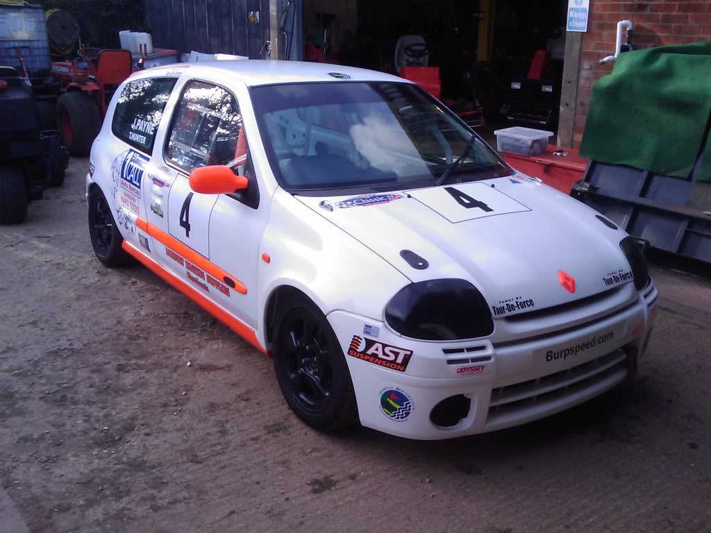

Friday 2nd April 2010 - Exhaust
After getting a baseline noise test at Silverstone this week (and a unexpected shakedown) we knew we had decibels to spare. The limit for racing is 105db. Our car only measured 94db.
During the problems we had on the dyno, we took the decision to remove the cat and lambda sensor, replacing it with a straight de-cat pipe and running the car with open loop fuelling.
But the regulations state we MUST run a cat.
On taking some advice from Matt at Tour-De-Force again, we chose not to refit the stock unit and ordered a 200cell aftermarket cat. This was fitted in place of the rear silencer box. With it located here it shouldn't affect power that much due to the gas speeds being lower after they have passed through the centre silencer.
The cat has an angled inlet so it matched up with the existing system quite well.
Size comparison to the old silencer and a fag packet. The cat is very small!
Very pleased with the fit and custom made bracket
We need to get it noise tested again now to make sure we are still under the limit..........
Monday 5th April 2010 - Brake Ducts
Lots more small jobs finished off today. Brake ducts being the main one. The car was back in the workshop at Burpspeed HQ and up on the ramp.
The front fog light holders have been fitted with air intake trumpets and ducting, these have been taken straight from the old track car. Deflectors were made from some heat shield off cuts to direct the airflow towards the brakes.
A few other small jobs, more roll cage padding added and an AMB timing transponder was fitted in the nearside front arch. For lap timing at the race track. A very expensive little red box. And finally a wash and coat of wax.
