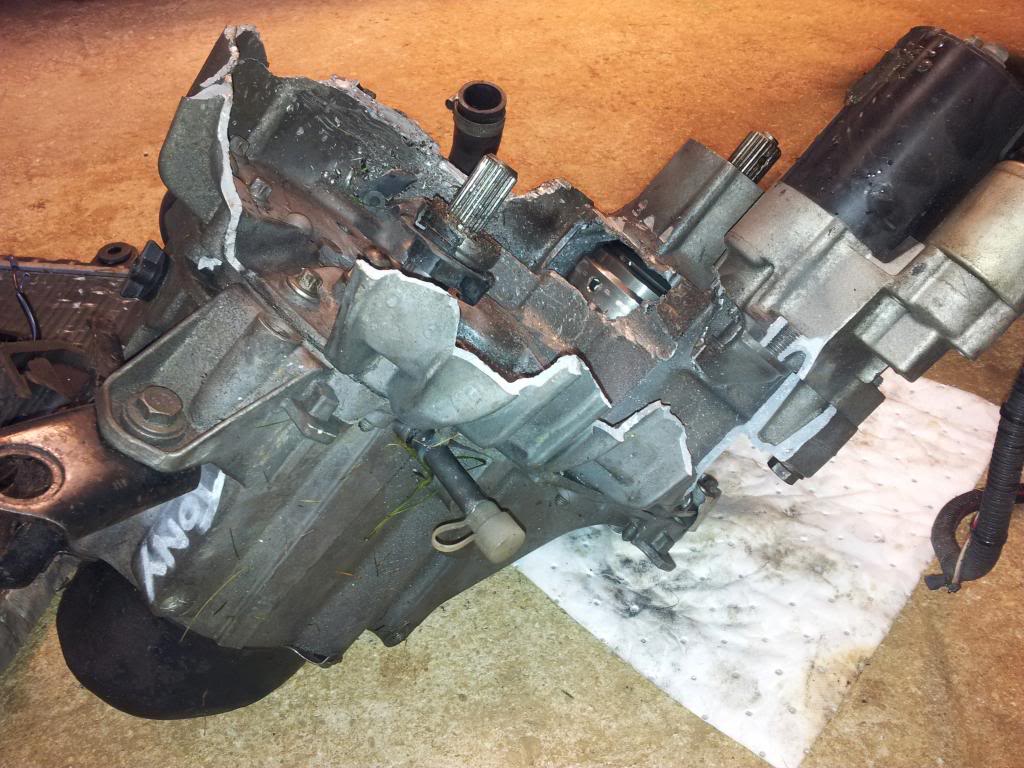

Gearbox pic tony sent to me!
  182
Flipping hell that is destroyed. Lol i can just see martins face when you give him that.

As far as I know, not everybody else seems to realise the urgency of the situation. Oh the loom was damaged as well.

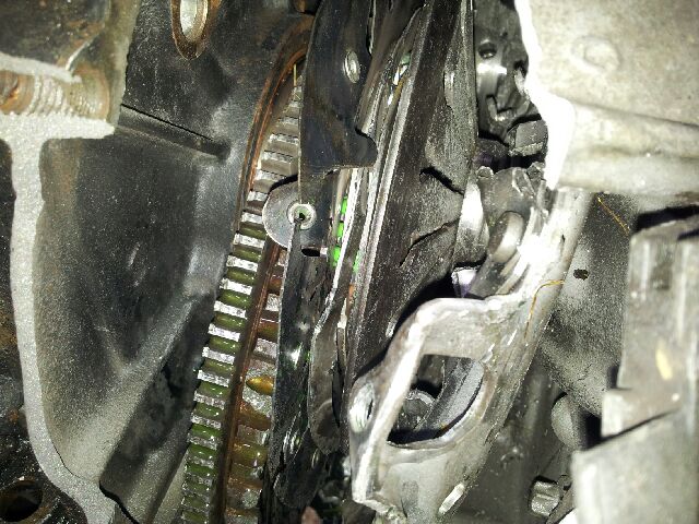

Looks like the bit the clutch bolts to has broken away from the flywheel. Clutch attached at one side still, massive unbalance created and its sheared all the flywheel bolts.
You can see the remaining half of the thread where the clutch was attached in this

not sure what you're saying there Danny, what's actually failed first, the clutch-flywheel bolts themselves or have the threaded holes in the flywheel been stripped etc. is the flywheel still in one piece?

I'm pretty sure bits of the flywheel were pulled out of the engine bay whilst at combe Russ..
My gut feeling is the flywheel bolts let go but just speculation tbh

Well yes that would be the sensible assumption mate but you know what they say about assumption!

What Dan is saying, I think, is that part of the flywheel where one of the clutch cover bolts goes in has come away, you can see this in the pic. This allowed the bolt to come loose. As the clutch cover moved once the bolt had gone the whole lot went out of balance and vibrated itself apart.
Bingo. Only a theory, as I only have the above pic to go on, but its logical to me, as the clutch looks still attached one side
