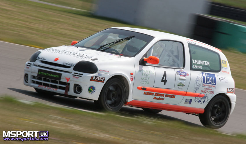

After speaking to Curtis at AST we made a few tiny adjustments prior to the first run. Our main task for the first session was to establish a stable tyre pressure where we wanted them. Due to lack of running at Brands we didn't learn much about how the tyres reacted over a run and ended the race with extremely high front tyre pressure, partly the problem with the car.
Tony's first run went well and we had good tyre pressures when I checked them after the session. A fastest lap of 1:26.7sec gave us a base to start from. Tony had reported that the car had improved now the tyres weren't balloons but that it still was nowhere near where we wanted it. Prior to the day we had fitted a rear anti roll bar but left its links detached on the first run. So for the next run we connected it on its soft setting.
Session 2 was much better, the car reacted well to the change and an improved lap time of 1:23.4 was very encouraging.
A small ride height change in session 3 didn't make much of a difference to the balance but Tony was able to get into the high 1:22sec bracket on a few clear laps.
We had 1 run left, the car had been getting better with every change and after another quick call to Curtis at AST, we stiffened the rear roll bar right up. Tony had a great run and was consistantly in the mid to low 1:22's. He managed a full 20 minute run and did 3 laps in the 21's. His best being a 1:21.8sec.
A very productive day, we still have work to do on setup but have made a giant leap forwards. Our first experience of test day was a positive one.

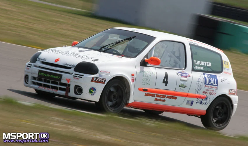

Tony's first run went well and we had good tyre pressures when I checked them after the session. A fastest lap of 1:26.7sec gave us a base to start from. Tony had reported that the car had improved now the tyre weren't balloons but that it still was nowhere near where we wanted it. Prior to the day we had fitted a rear anti roll bar but left its links detached on the first run. So for the next run we connected it on its soft setting.
Session 2 was much better, the car reacted well to the change and an improved lap time of 1:22.8 was encouraging.
We had 1 run left, the car had been getting better with every change and after another quick call to Curtis at AST, we stiffened the rear roll bar right up. Tony had a great run and was consistently in the mid to low 1:22's. He managed a full 20 minute run and did 3 laps in the 21's. His best being a 1:21.8sec.
A very productive day, we still have work to do on setup but have made a giant leap forwards. Our first experience of test day was a positive one. We packed up ready to go and went off to walk the circuit. Tony describing the lap to me.
