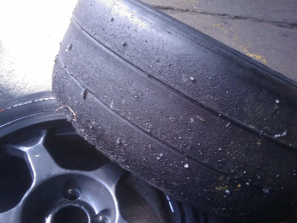

Canvas showing on the outer edges, need more camber. Notice the Hankook logo is half missing. Thats why we know the car will get better, we were running on the sidewalls at Anglesey
