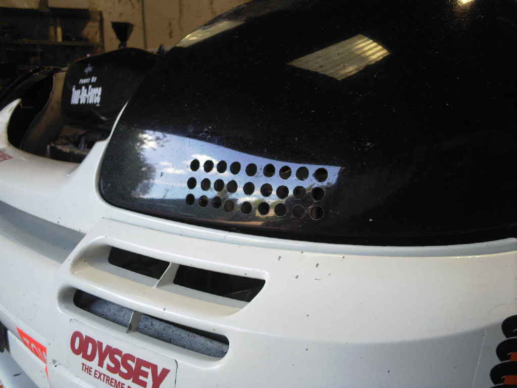

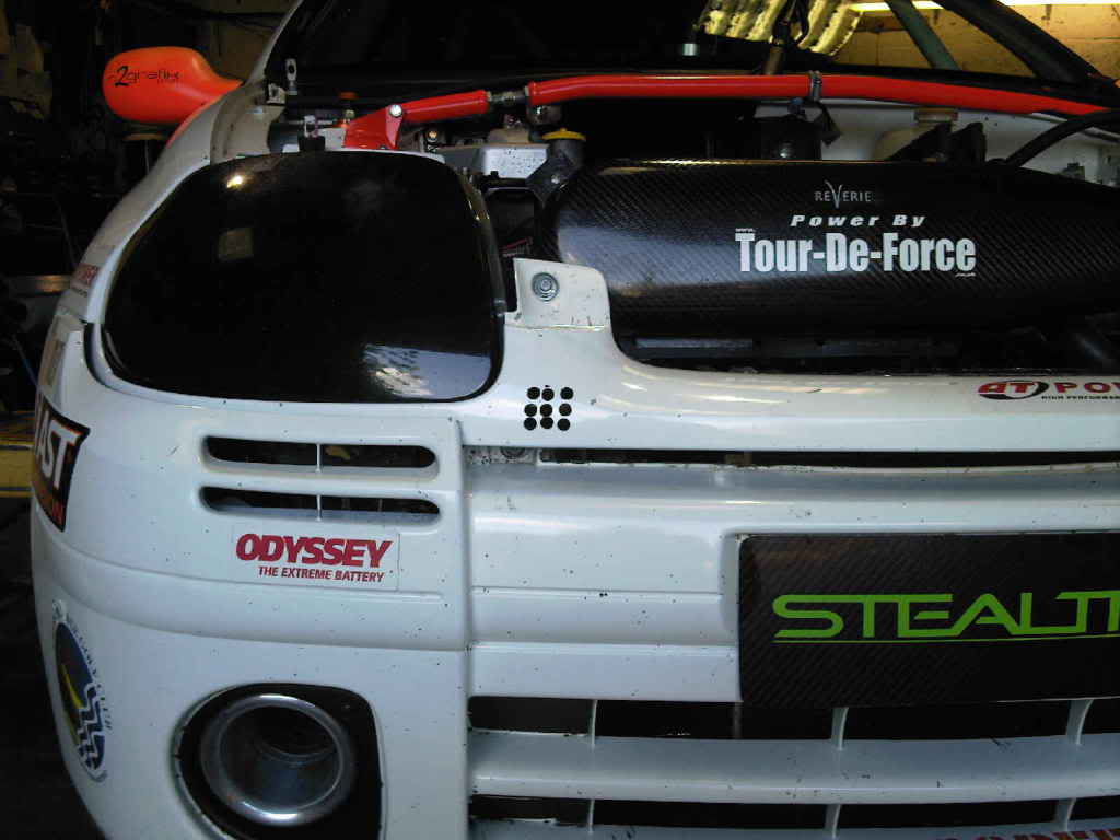

A few little improvements, drilled a few holes to get more air into the filter area and some more cooling for the alternator.

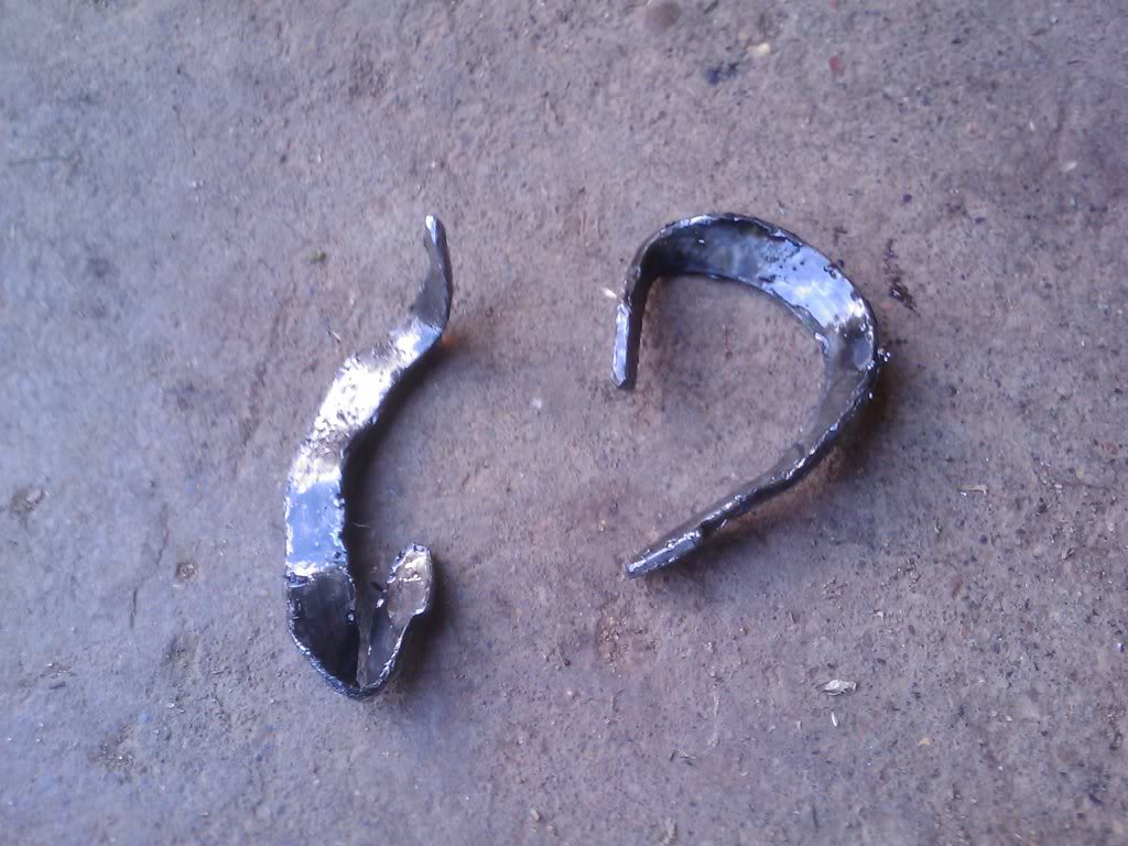

Oh and a little side note. we stripped down the old engine a few weeks ago (the one that had massive crank end float) and found these in the sump, Lol.
This would explain the bottom end noise at Anglesea.....Has it caused much damage to the crank?
  172 Race Car
:S eh? what bottom end noise at Anglesey?
The engine is fine, these are from the engine we originaly fitted to the car. Loads of pick up on the cams so the s**t has gone right through the engine. We scrapped it and bought another spare engine.
