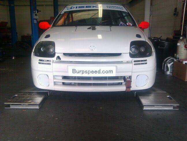

had a little play with it today (only a quickie as it needs attention in other places before i go to town on the complete setup) lets just say the weights were erm......................off
  Lionel Richie
in simple terms you adjust the ride heights at each corner to change the weight balance/distribution on each corner (it goes a lot more complex and mind bending than that, but i'll keep it simple)
ie
a standard clio typically would have a stock setup as follows
(with driver)
FL 320kg 380kg FR
RL 220kg 235kg RR
basically in a RHD car they're a bit of a mare to setup as all the weight is on the drivers side
we aim to get the figures a lot closer together by adjusting the ride heights, an example below
(with driver)
FL 350kg 350kg FR
RL 227kg 227kg RR

Dare we ask how far out?
I'd hate to know what mine is like, supercharger and brackets hanging off the front drivers side of the already unbalanced engine

I've spent hours setting up suspension on corner weights. Can take Sooooooo long if you have to keep taking wheels off! Nice when you eventually get it spot on tho :)
Cro
  Meg'd r27
Lol that must take forever! Do you have to roll the far back off and up again to make sure they have bedded back down? I'm sure it's worth it though
  Lotus Elise
Its complicated. It depends whether the damper is inverted (like the back, or normal like the front), also a more compressed spring is pushing the wheel down harder as the spring rate builds with the compression. The trick is not to think about it too much.
