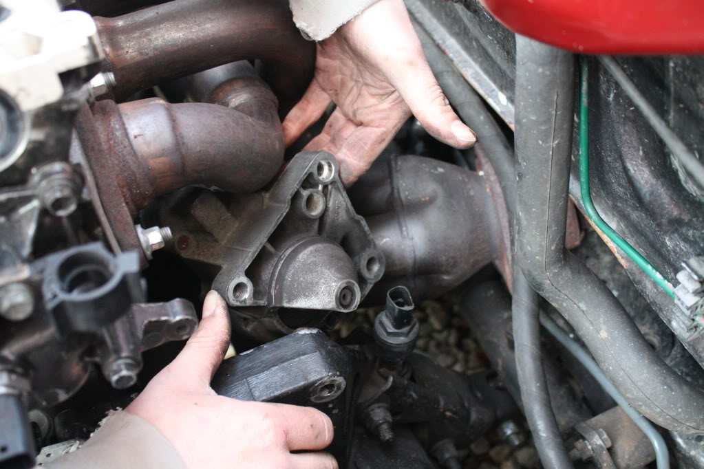

Fitted a replacement starter motor today, thanks to Whiteley (again) Bit of a fiddle, took the exhaust maifold off to make it easier but then had to drop the o/s steering arm to get the thing out. Must be a nightmare on a road car.

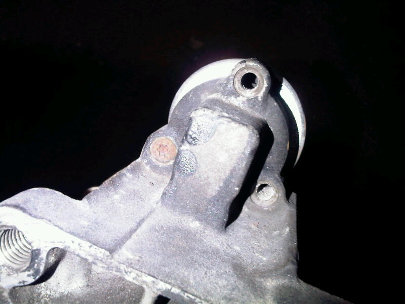

Found the problem with the old one. 2 bolts missing from the solenoid and the 3rd one loose. Was wobbling around. Also took the back cover off and the grease inside has got a little hot and started to set like glue (as predicted by Mr Sideways)
What manifold are you using? Will it not just come out like so?
Pas, brake fluid, heater hoses. plus the crank sensor wires are bolted to the block near there, didnt even entertain getting it out that way.
