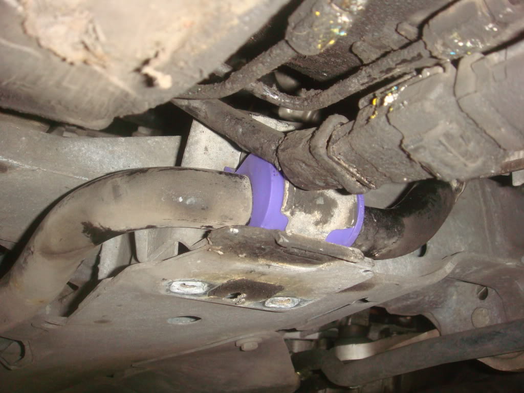

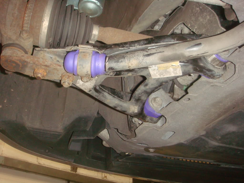

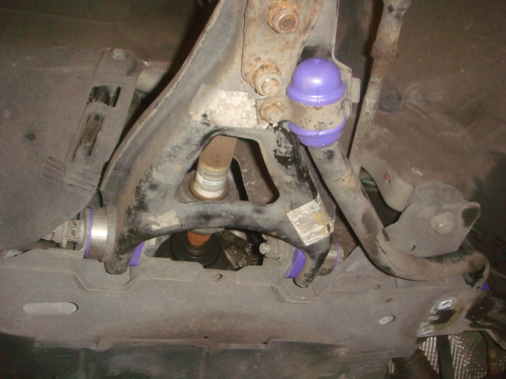

Ive done the wishbone bushes, outer anti roll bar bushes (inners will get done on friday) and the dog bone. combined with new engine mounts and a set of solid shock top mounts its transformed the car. its much more positive than before and feels more precise entering corners. i think if you just do the poly bushes alone youwont feel a huge difference unless the originals are shagged.

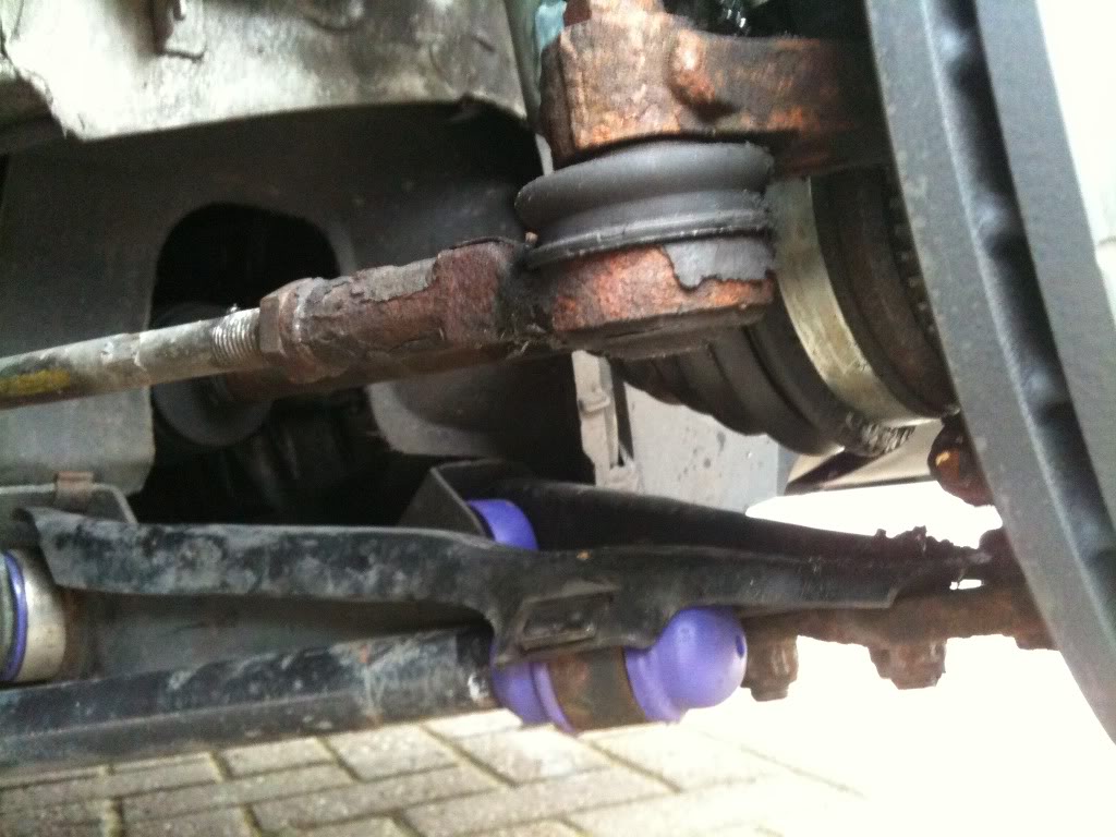

To be fair I had the top mounts replaced and a rear strut fitted at the same time so it is difficult to isolate the effects of the bushes. But overall the car felt more agile and responsive, more planted and there was less body roll (on KTR Coilovers). I'm guessing it would have improved braking too, but since I also fitted Brembo Max and Ferrodo DS2500s on the same day I can't say for sure! Made me think about getting the engine mounts done too.
Do it, definatley worth the effort!! Turn in is improved and less body roll, the arb is a t**t to get back on though, you need an extra pair of hands with a pair of pliers to fit the bracket back on. Remember to tack the sleeves with a welder on the wishbone though!!! I may be wrong but the picture above suggests they havent been done??
