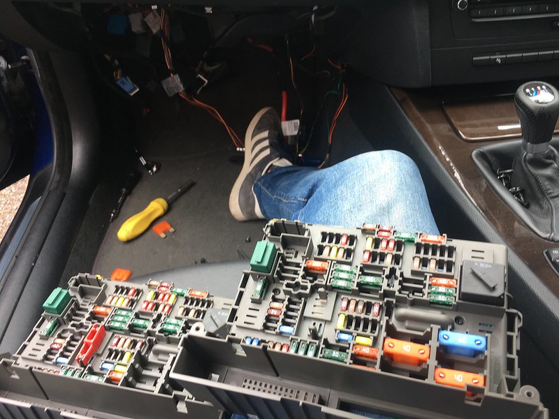

So for a variety of reasons, the 335i hasnt really moved much this month, mainly because i was using the 325i in the run up to Le Mans, but also because post "brokenwindowgate" i also noticed that the Bistable Relay (KL30g_f) in the Junction Box (the bit that the JBE/Junction Box Electronics plugs into) also had a fault on it. Now, being that this relay controls power into the JBE, CAS & DME, i thought it probably wise not to use the car, mainly as it could simply shut down and lose power at any point ...
Unfortunately, unlike the other external relays, the KL30g_f is built into the Junction Box internals, so the only easy way to replace it is to swop out the whole unit. I've now managed to track one down on ebay with the correct part number and it should be arriving with me immenently, along with some electric folding mirrors and a split front armrest. So once everything has arrived, ill be able to finish all my retrofits and start using it again.

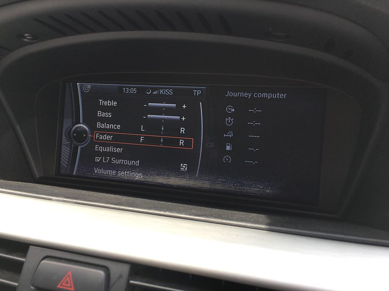

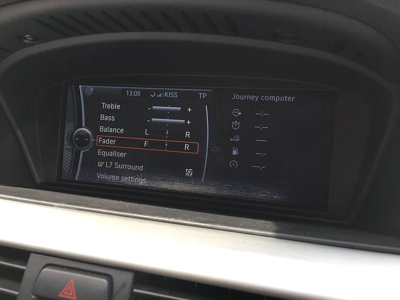

Not much of an update, but have now swopped out the JBE and finished off the CIC installation inc. re-coding the headunit from Base to L7 output using NCS Dummy. Just missed out on a combox earlier on for £100, sold in the time it got listed, i added it to myebay, then went and made a coffee before checking part numbers - which was most annoying!!

Great video on how to use it here if anyone is interested:

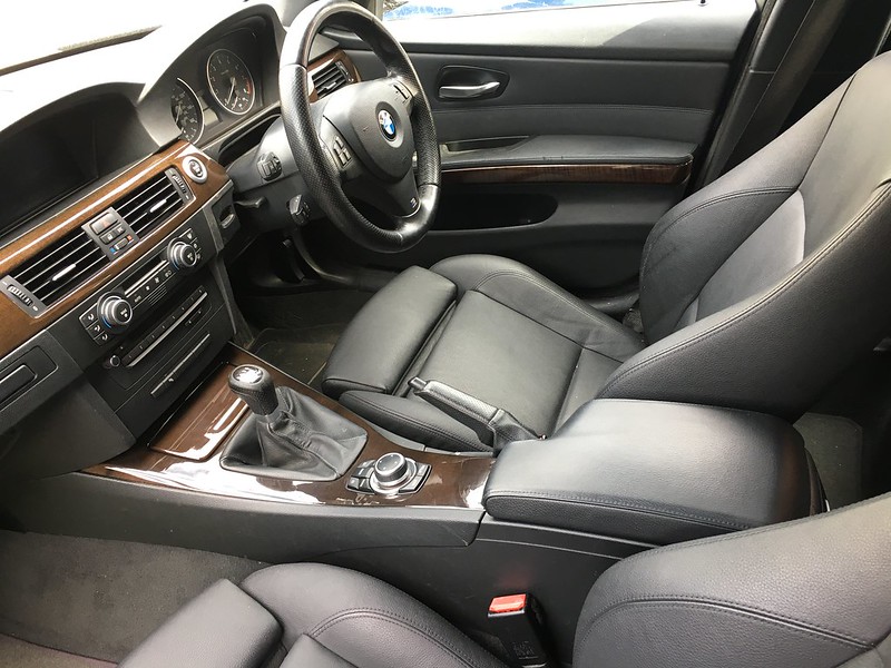

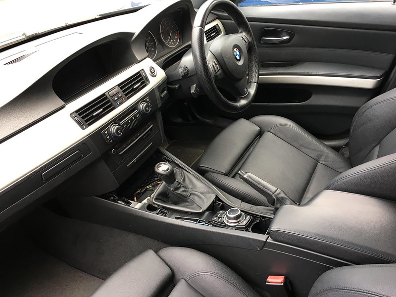

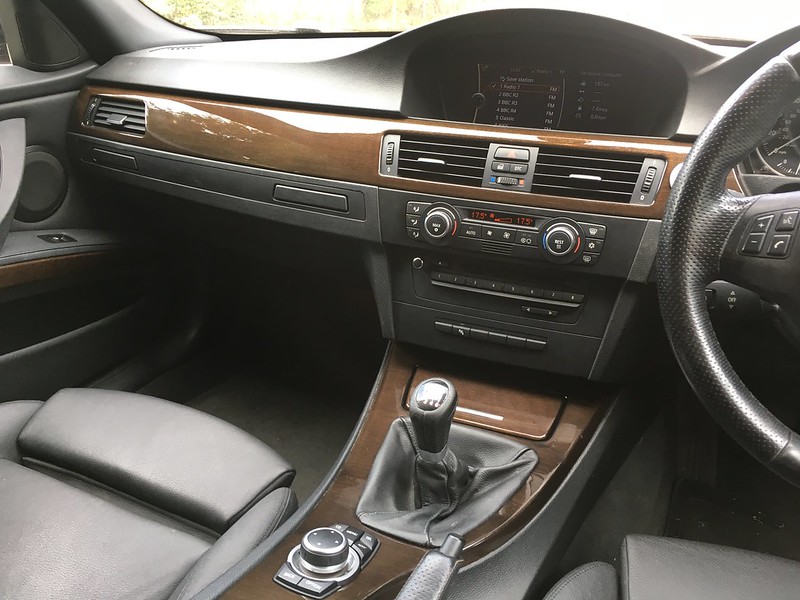

Interior parts arrived, not my first choice of wood (its Light Walnut), but Burr Walnut is nigh on impossble to find for the LCI CIC controller ...
Before:

After:

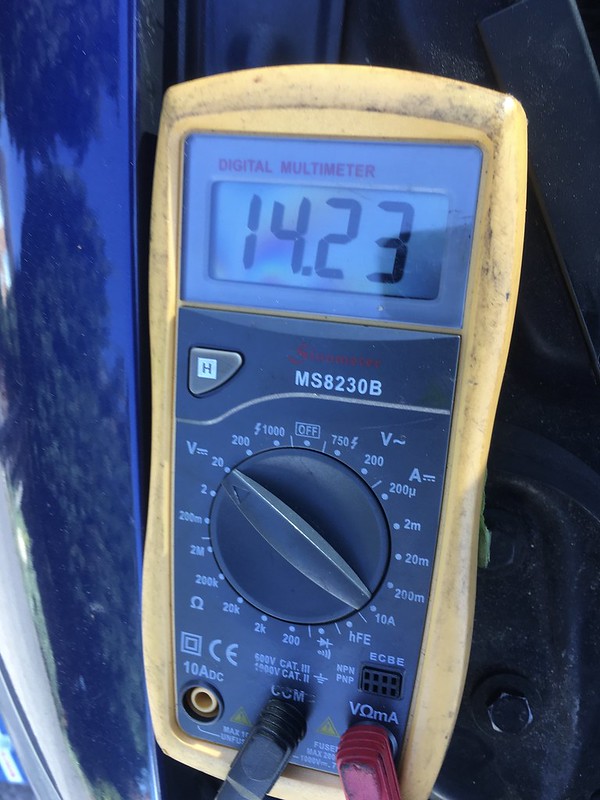

More tinkering lately, have the MOT booked for later on today, so needed to make sure everything was working ok ...

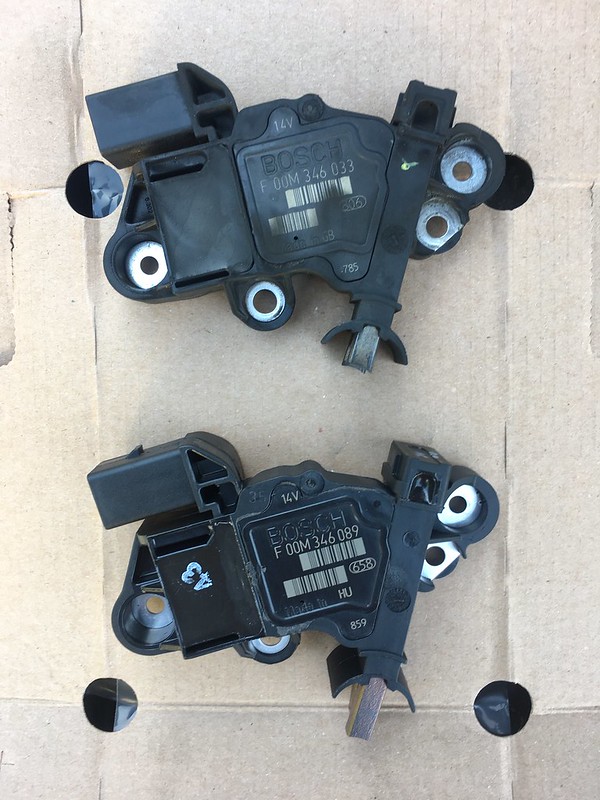

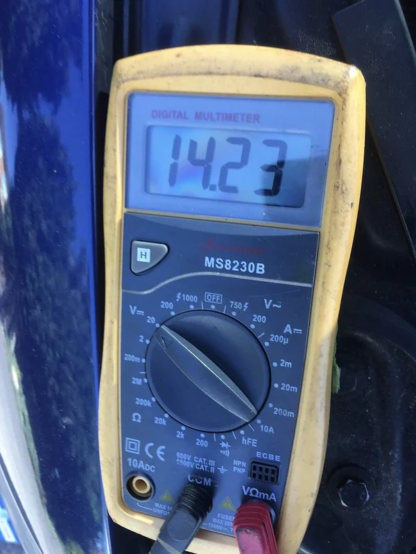

Coincidentally, the car hadnt really been charging the battery properly since it went to BMW for its B+ cable recall (it actually cut out on the motorway as well, which was primarily what the recall was designed to solve), so i pulled off the main junction/fuse box to inspect things. As i have come to expect, the B+ cable hadnt been fitted correctly, with the screw that tightens the clamp being rounded off. I've now re-seated it, but will order another recall part and do it myself - they are only £20 or so. This wouldnt have affected charging however, just caused the occasional power outage.
Untitled
by Sir_Dave, on Flickr
Whilst i was in there, i decided to swop out the whole unit for a new one (just to make sure the charging issue wasnt due to a failed internal relay etc):
Untitled
That didnt change anything so out came the multimeter and after a read of the rather complex e90 electricals manual (https://www.e92n55.com/wp-content/uploads/2016/08/pdf-bmw-e90-voltage-supply-bus-systems.pdf) i continuity tested all of the wiring/fuse/distribution blocks etc. The ecu was by now not recognising the alternator at all and giving a 2E98 code, ie "alternator missing", so no charge at all. It did however show movement in voltage in the "generator" menu in INPA upon startup, which suggested that the alternator was ok, but the regulator was probably knackered. Overnight parts from Germany (well 5 days) to the rescue with a new one of these:
Untitled
And we are back in business
Untitled
Funny thing is, most recommendations were to just change the alternator at £450+ fitting (which is a pig on the 335i). This was £42. The regulator isnt available to purchase seperately in the UK, so something to bear in mind for those with e90's and charging issues. My part number/supplier was: https://www.onlinecarparts.co.uk/bosch-777195.html

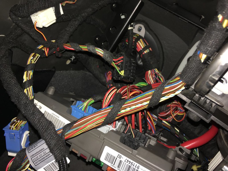

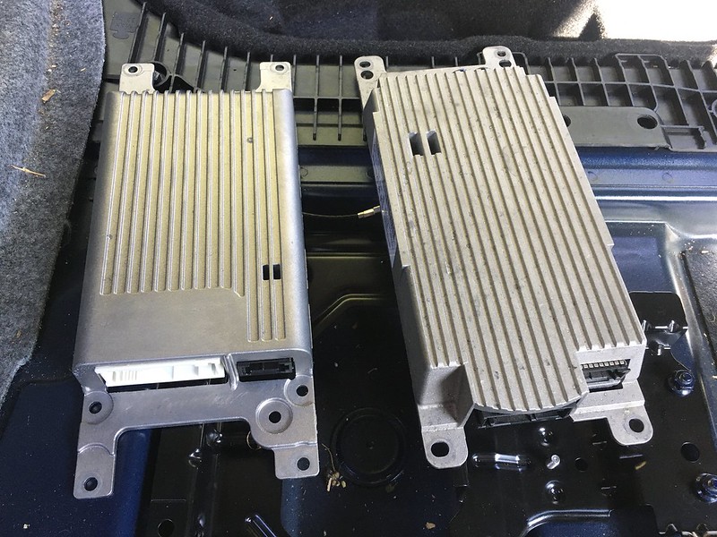

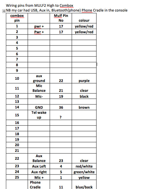

Next i moved onto the more fun stuff, fitting the combox i had purchased recently. Parts purchased ...
BN2000 Combox: https://www.ebay.co.uk/itm/BMW-1-3-5-6-SERIES-X5-X6-GENUINE-BLUETOOTH-MODULE-9257161/323882454538
Changeover Plug: https://www.ebay.co.uk/itm/Changeov...E84-X6-E71-X5-E70-Z4-E89-E90-E6X/322969679445
USB Switch: https://www.ebay.co.uk/itm/USB-Swit...or-BMW-E90-E91-E92-X5-3-5-Series/233205594552

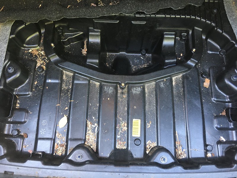

Boot was rank. I mean seriously. What had the previous owner been doing in here:
Untitled

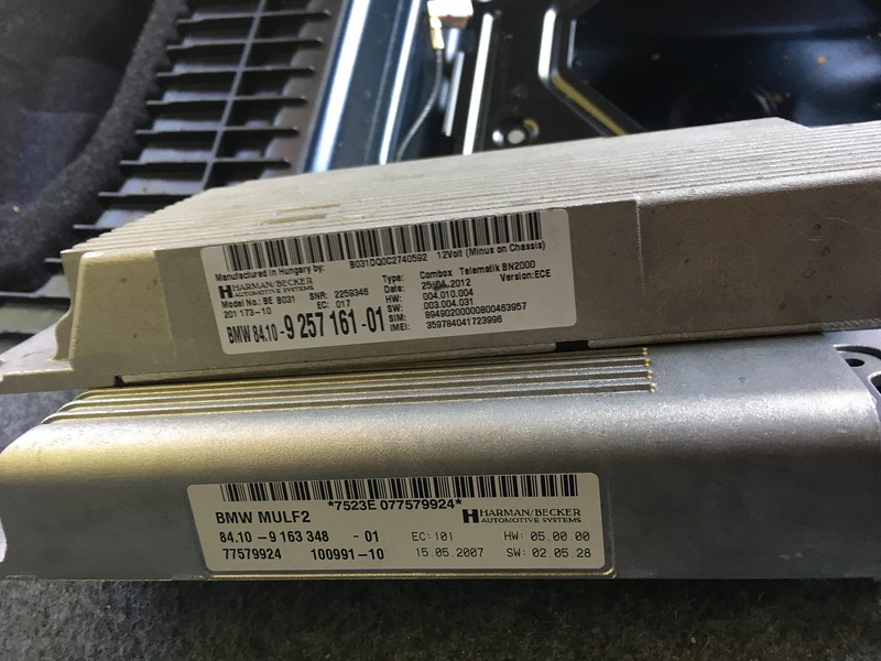

MULF2 vs Combox comparison:
Untitled
Untitled
Wiring changes:
Untitled

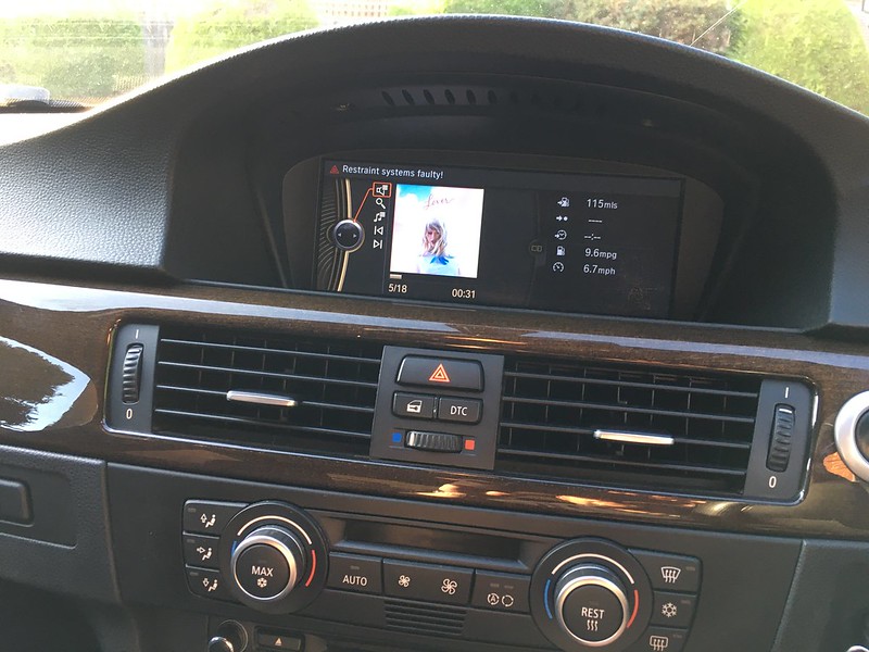

Bit of coding with NCSExpert, ie change production date to #0910, add $6VC, $6VA & $6FL to VO, FAwrite to CAS/NFRM, then SGcodieren CIC/CMEDIA modules. Et voila, bluetooth music streaming and album art when using wired:
Untitled

lol @ the restraint system :ROFLMAO:
I was in the midst of updating the software with Winkfp, hence the code, all sorted now!

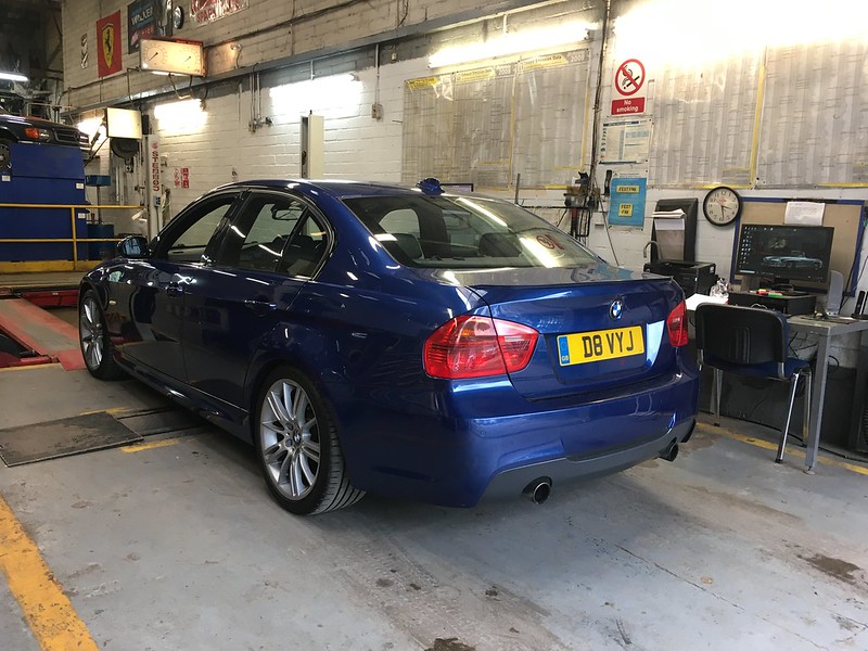

Passed the MOT last week with no advisories, happy days

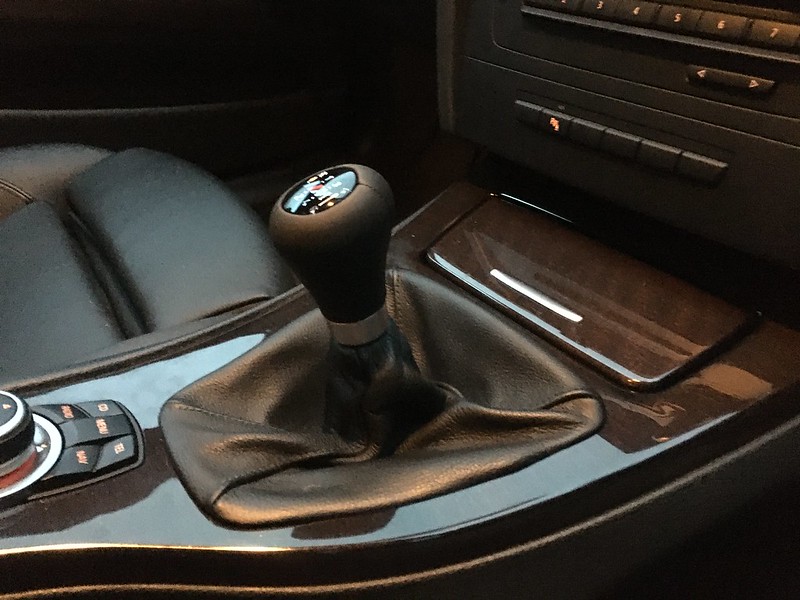

Also fitted this weighted ZHP gearknob - feels far nicer than the old one!
