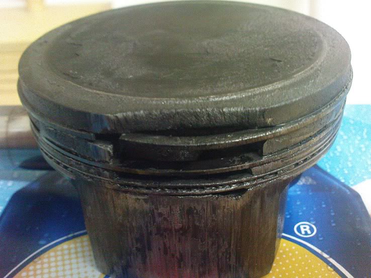

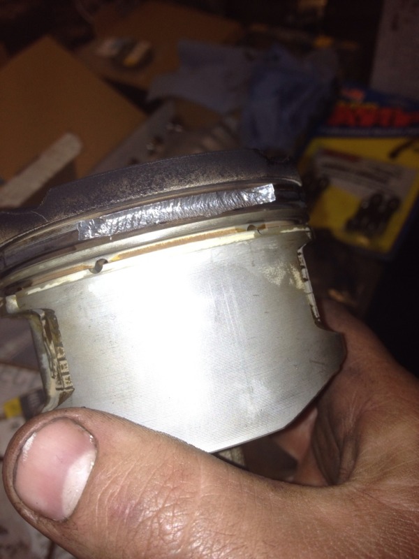

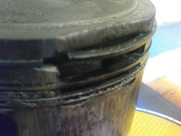

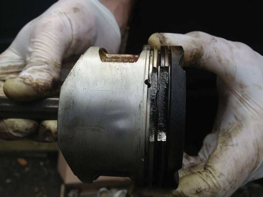

The amount of 182 Clios I've seen recently with cracked pistons is unbelievable.
Do a compression test before you hand over the cash to be sure.

Knackered injectors can kill pistons very easily. It's always the ringlands that go! From the top the piston will look mint!

No mate! In the engine with the piston with one bit missing, it idled very very slightly lumpy and drive spot on! No smoke nothing! It was just slightly down on power!

I've seen a number of pistons with cracked ringlands. Every one of them has also had evidence of detonation on the crown of the piston right above the broken piece. It's crap maps causing issues
  182/RS2/ Turbo/Mk1
It's a lottery with the pistons, they have imperfections and if you are unlucky and that imperfection is on the ring land (small air bubble) its much much more likely to fail.
Bad map seals the deal for sure but isn't always the reason, they do sometimes just go.
as mike says they still drive mint, just slightly down on power, that first piston he put a picture of was from porkies old engine. He tracked it a week before we pulled it apart and it drove mint but was down on power a little, made 185bhp on Surrey rolling road in the morning, then we pulled it apart in the afternoon to find that piston.
most likely cause for OP though is injector, I've seen loads with the same symptoms that have been injectors, but keep driving it like mentioned on this car and you really risk the ring lands as it will make it run lean, in the case of porkies engine it had done an injector on that cylinder only a couple of months before. No co incidence it was same one that failed!
