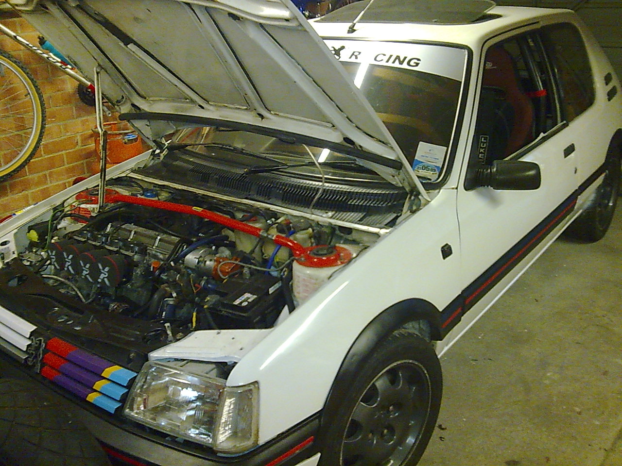

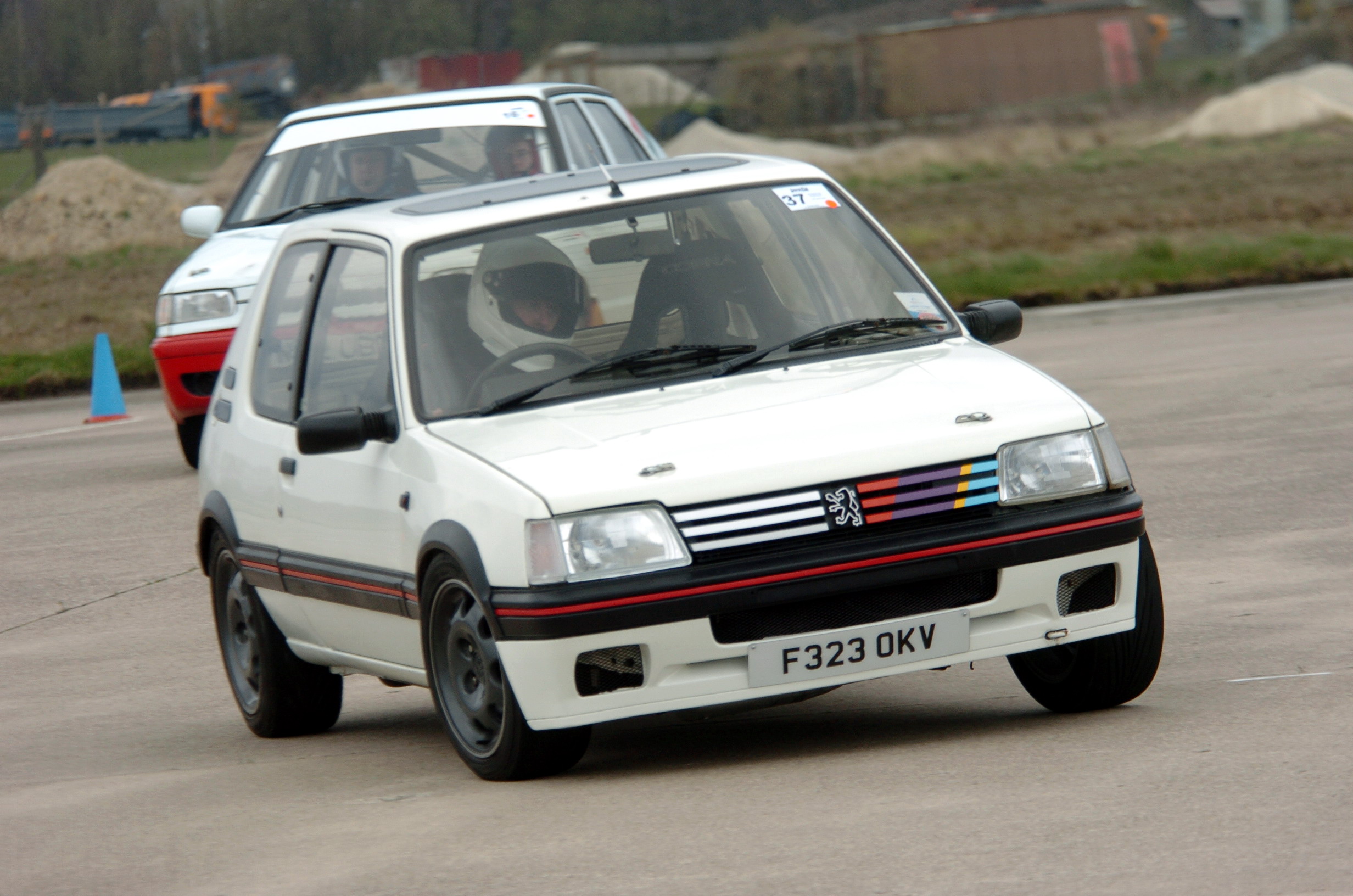

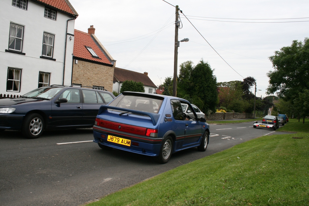

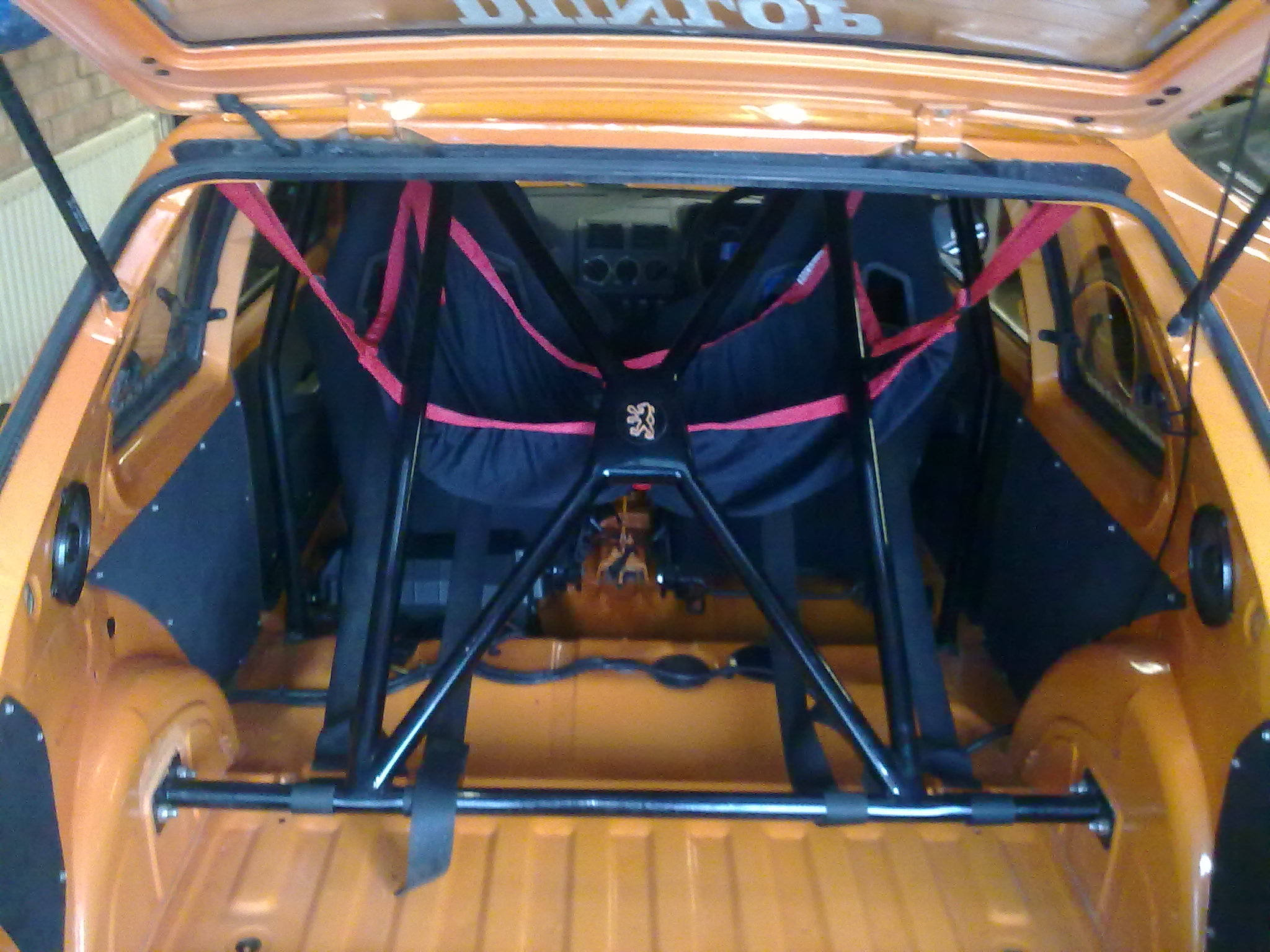

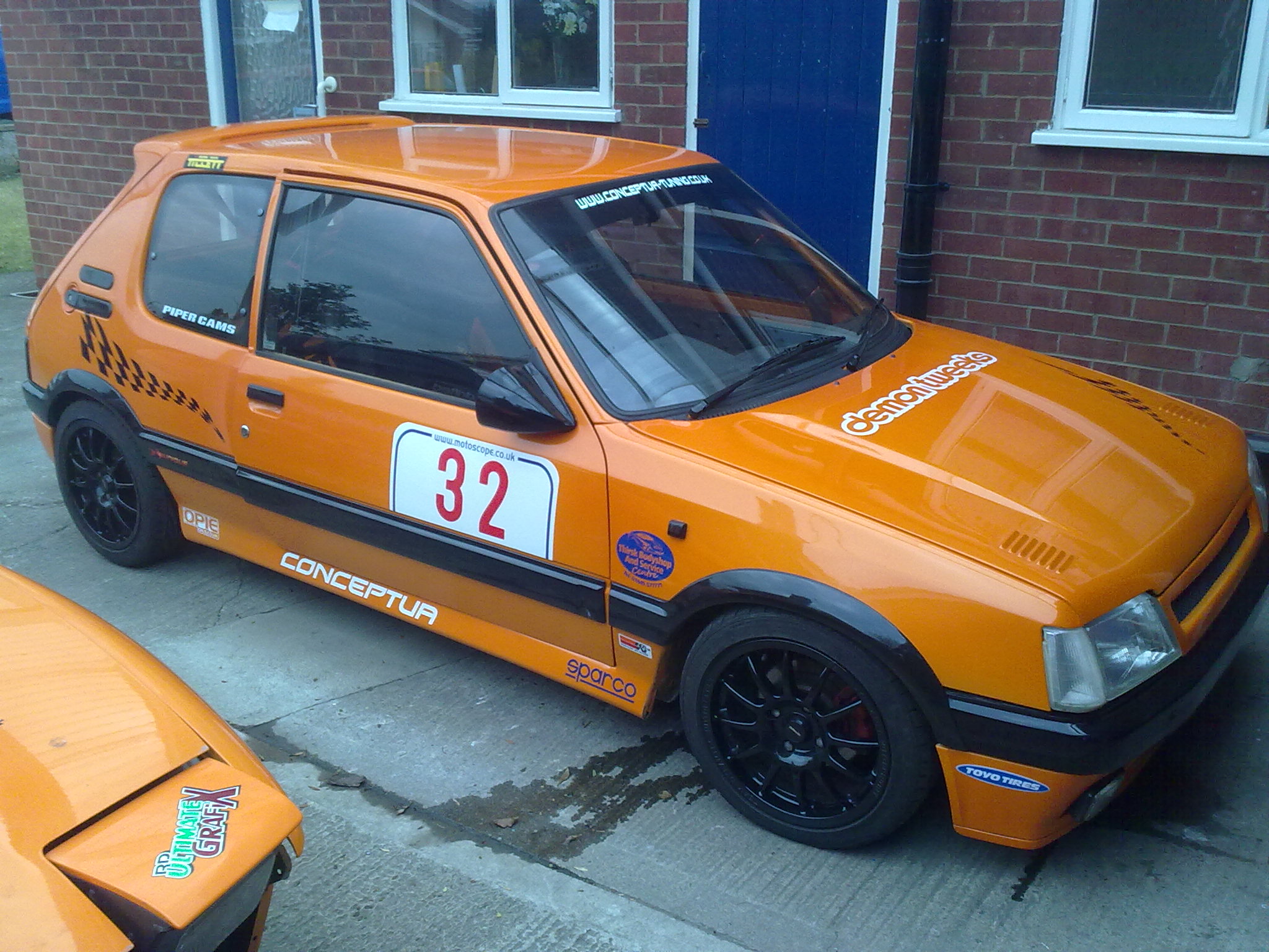

Welcome. Any pics of your previous 205's?
Here's a few , thanks for the interest.
I've been drifting for the last few years though so between me and the wife (who is a pro) we've had quite a few Jap cars..
