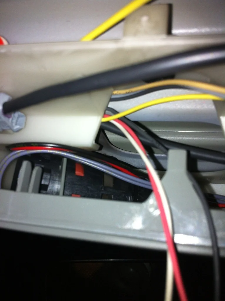

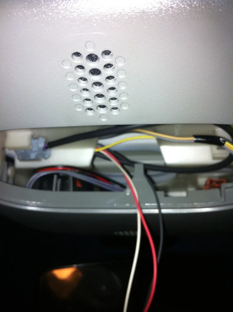

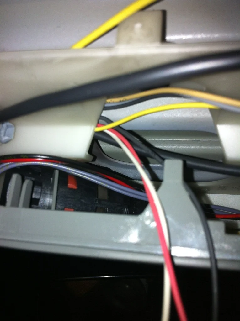

Jut sat in car had a buzzing sound for the past week annoying the hell out of me... Just found it coming from interior light when engine is off but ignition is in position 2
When I touch this the black barrel shaped part with red bits on in picture below it stops/quietens downs
Anyone know what it is?

I brought a new one lol it made no difference aha , think its just the fan in the unit that causes a vibration lol
Dr HMS Derv Destroyer
  MK1DCi/vivaro/REN’11
climate control sensor. makes that noise due to being a brushless fan. yet to find a fan suitable to fix it yet. maybe a ball-bearing fan will quiet it down a bit
