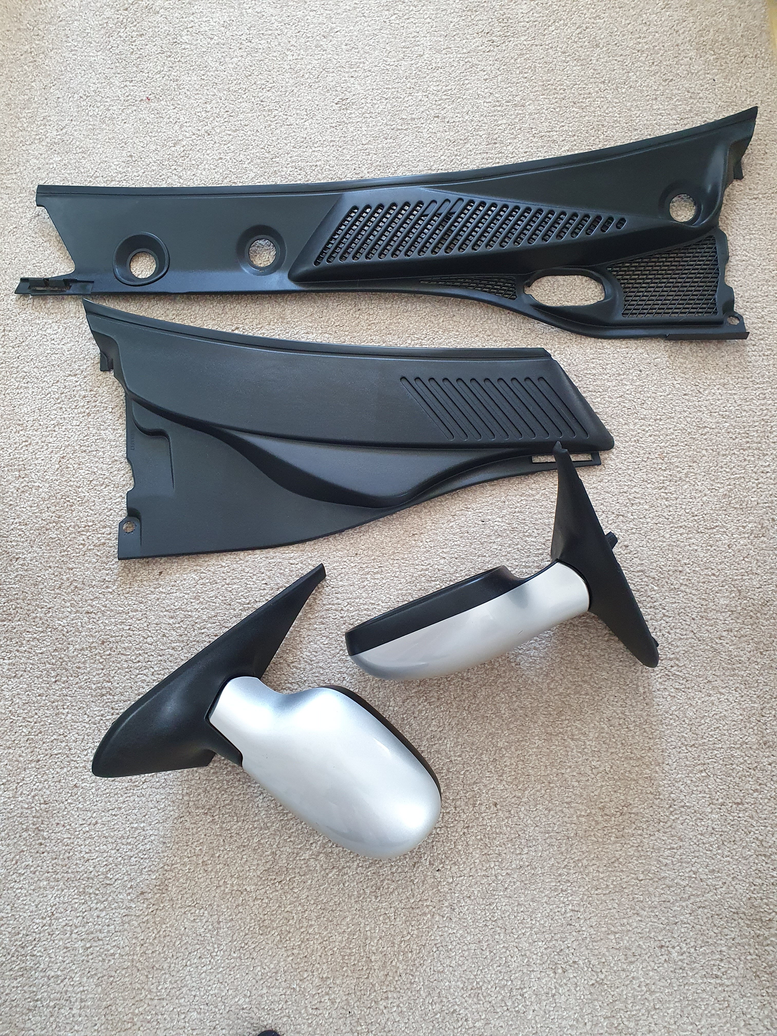

A few weeks back I began treating all back plastics on my 172 but after they have cured the more heavily textured plastics like wing mirror edges and mounts have almost white/grey colouration in the textured dimples. Can I simply scrub clean dry and retreat of is a more radical approach required?

How did you prepare the surfaces ? This would have been key.
Any pics of issues etc ? Someone like @gally might have some good ideas.
If it was the paintwork, you could probably machine polish it off but being plastic.........
  SI-STI 2.35 & RC-172
As above prep is key and all though you are dealing with plastics they have to be treated as if you was ceramic coating paint work, completely washed fully with shampoo then a final IPA wipe down so their is no other previous product left on the plastics dirt or oils.SJ.
Did you let the surfaces get wet/damp within the first 24 hours of applying the product?

😖 I did it thinking it wasn't going to rain which it didnt until that night. Is that reversible?

I've only got C4, shall I try a recoat or clean up and reapply?

I have just done all the grills and fog surrounds on the bumper.
I took them off the bumper and scrubbed them with washing liquid and warm water to take any other products off.
Dried them well and left them in the livingroom over night, applied the C4 next again day and then left them again for 24h to cure in the house.
Its best (Where possible) to take the plastic off and make sure its clean and dry.
Gally
The reapplication can actually help a lot. When leveling top coats you can go over the same area and them remove safely.

Mine has gone the same only after a few months & im pretty sure i did it all correctly.I took the wing mirrors & scuttle off,washed down with washing up liquid,let it dry then went over with ipa & applied the C4 then let to set over a couple of days.
The lower splitter & spot light surrounds seem ok,i thought it may of been when i snow foamed the car as noticed straight after.
Maybe the C4 may work better on newer plastics or smooth trim??
I now have bought some Solution finish,the same as @Sunglasses_Ron has.It looks like a decent & easier product to apply by reviews & youtube detailers

I'm not overly impressed with C4, my plastics look almost no different after one summer

Peculiar as it lasted 2+ years on my texture plastics when I first used it many moons ago, so that shouldn't be the issue.
To clarify, C4 won't darken your trim or return it to "as new", as it doesn't remove oxidation. Solution Finish does. So I believe the best option is SF then sealed with a product like C4 for longevity.
