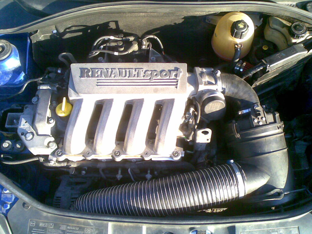

or.... do this :
MarkCup on here has the original thread as he did it first. Search mate, this is a genuine Cold Air Feed. (Got mine all dirty thought but he)
