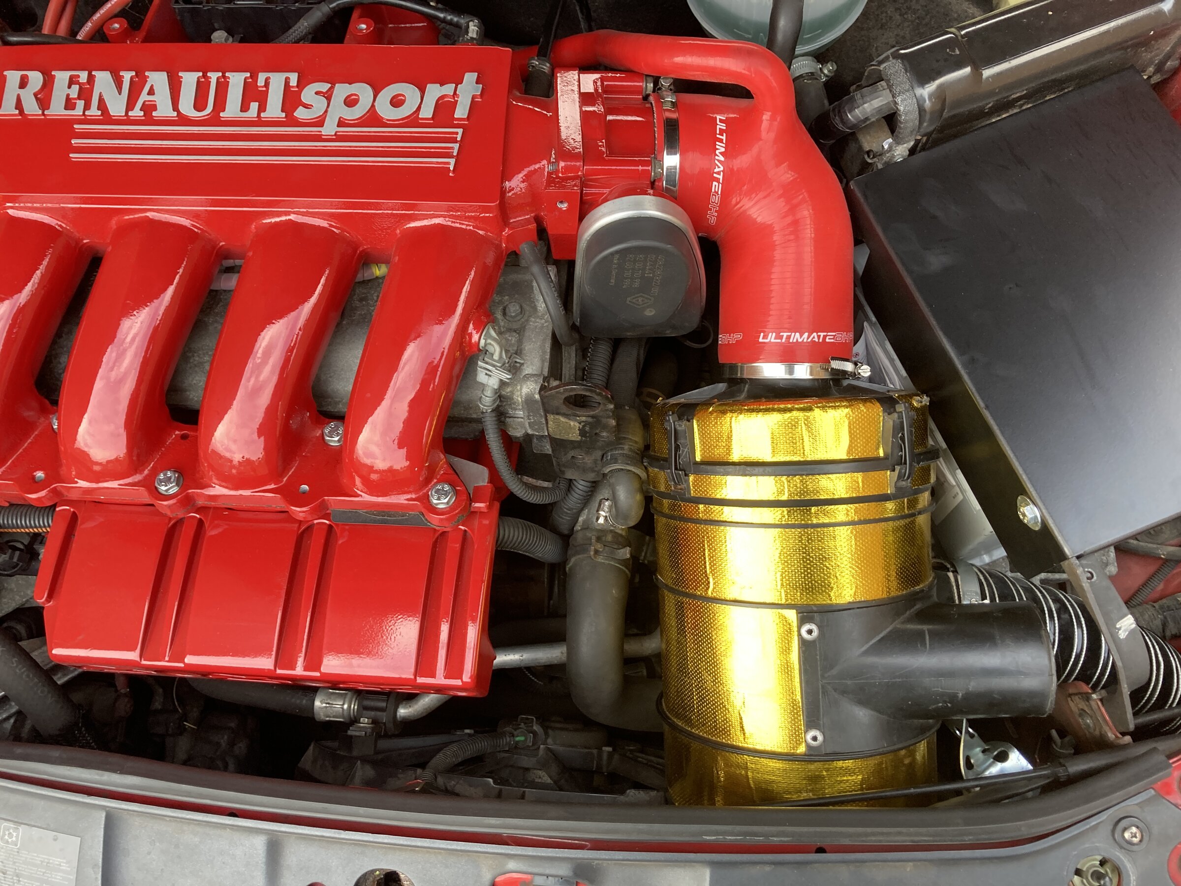

Pic is using oem ducting atm, one fits over the lower inlet, one slots in to upper inlet (fragile stuff that oem ducting!)

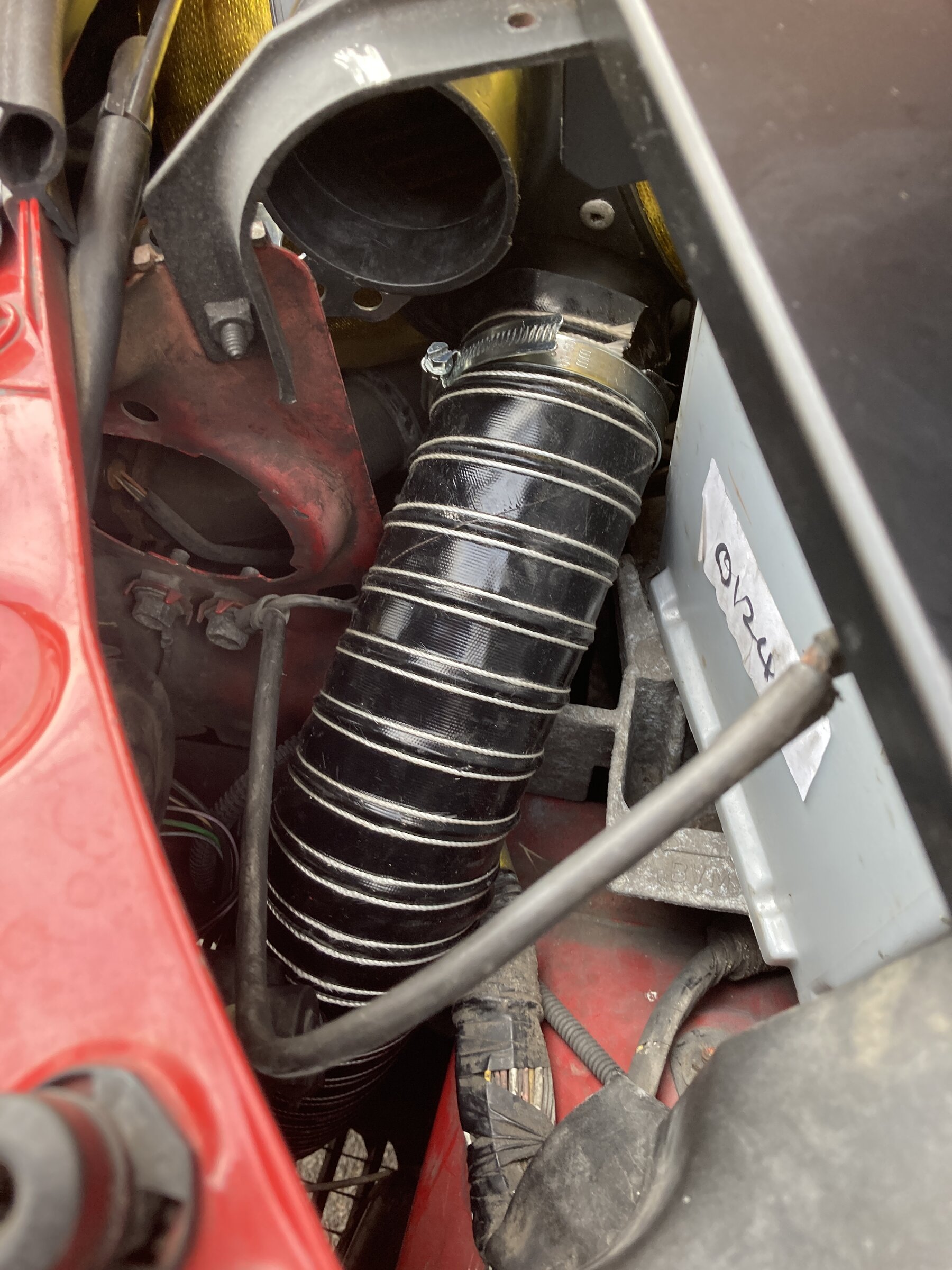

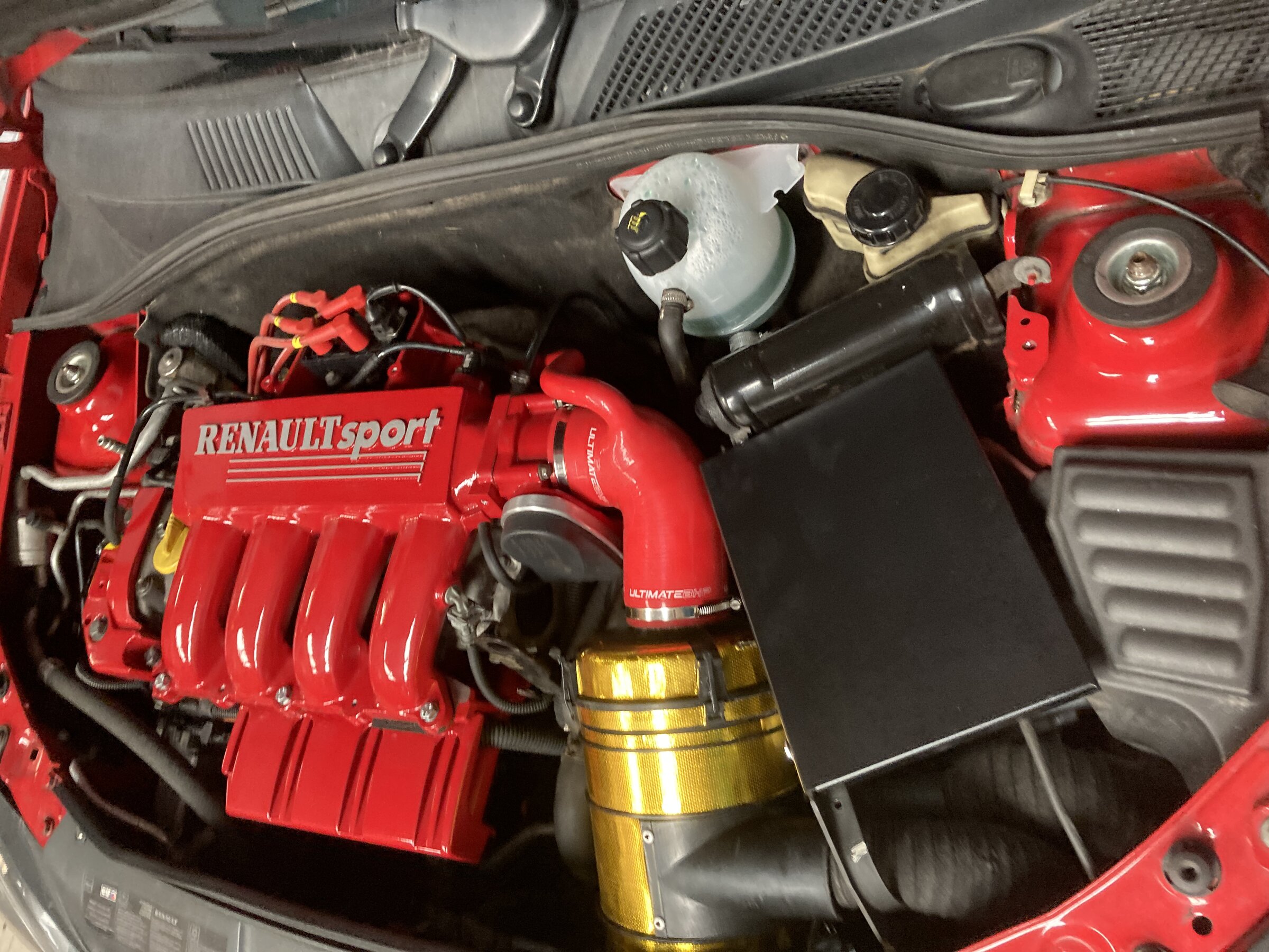

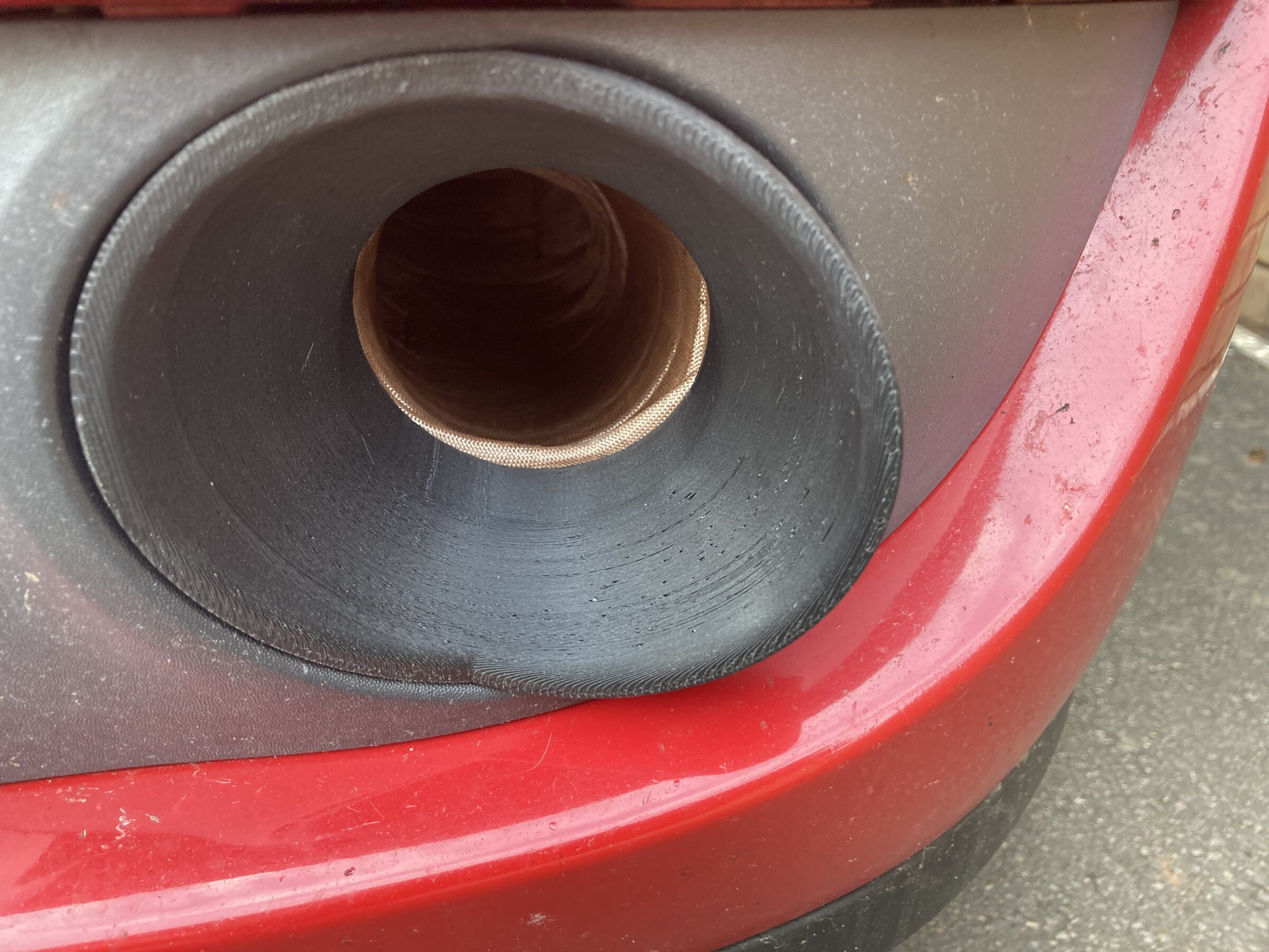

Parts arrived, fitted, seems to drive more smoothly, sounds a bit smoother and looks good too I reckon; better than fog lights that I never use!
Half a metre was perfect length, had to slowly work it between the bundle of wires and headlight adjuster. I've left the top inlet as is for now. Remap next week :p
  182FF
That is one tidy looking engine bay, I love it!
Thanks for using my ducts, glad you like them!
