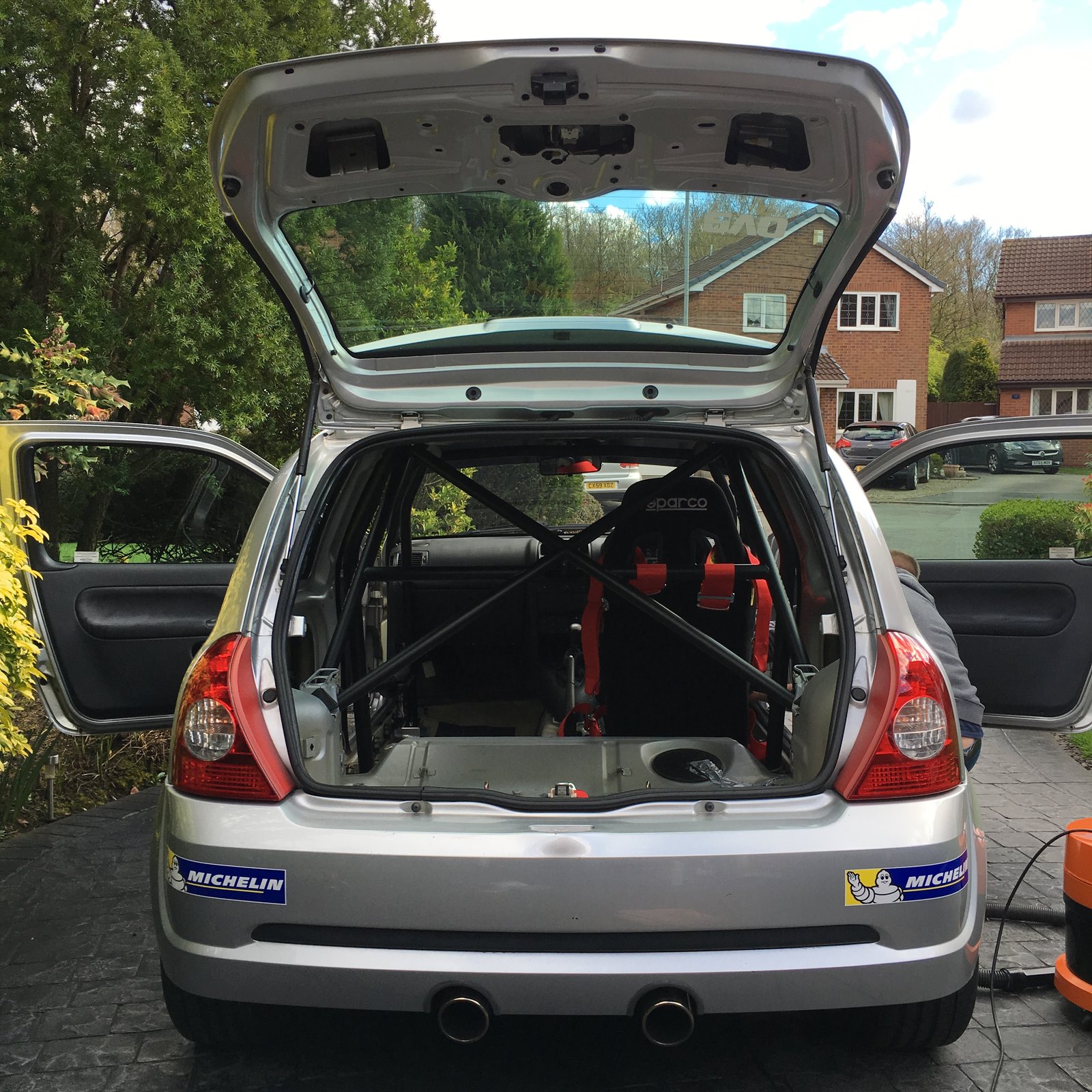

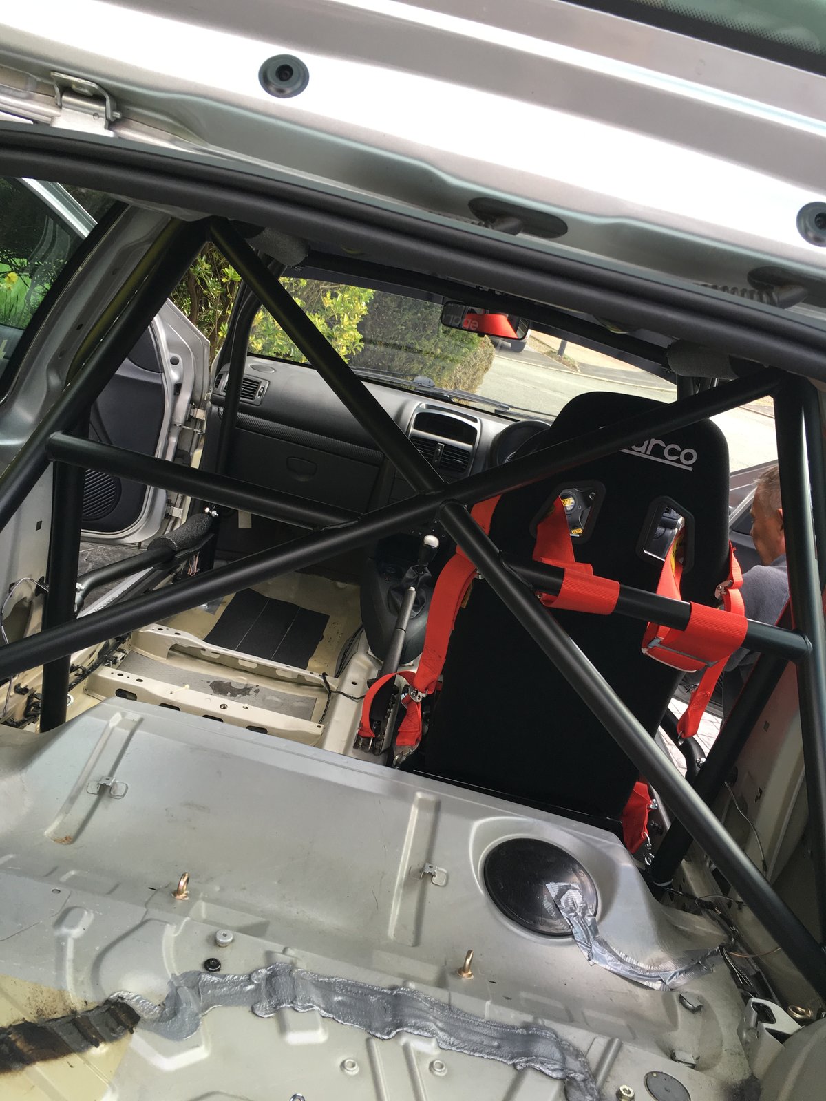

Markfish > Safety Devices > job done
I couldn't possibly say I took it to Amery Motorsport to have it professionally fitted, it cost a pretty penny but I don't mind when the finish is so good.
Thanks. Easy to fit the MF cage?
Fitted my safety devices half cage, as long as you can get someone with decent welding skills to weld in the spreader plates on the floor it isn't that difficult to fit really

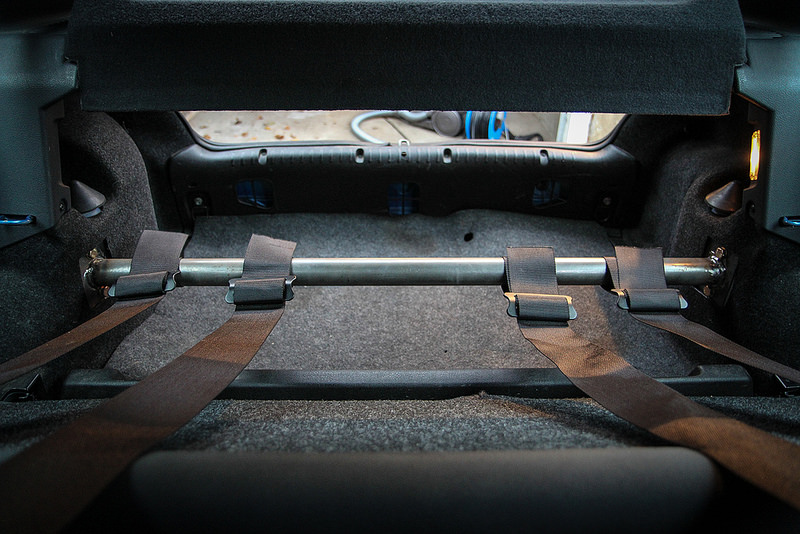

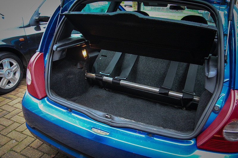

I wanted a harness bar, as I didn't want a full cage.
This is a 'bolt in' job with spreader plates etc.
clio-2014-11-update-4 by Adam Lister, on Flickr
clio-2014-11-update-1 by Adam Lister, on Flickr
I don't know specifics, as I got it done for me. However, the angles of the shoulder straps were much better than using the seat belt holes.
Not to mention the resealing of the underside, as it bubbles so it needs scraping off then sealing.
