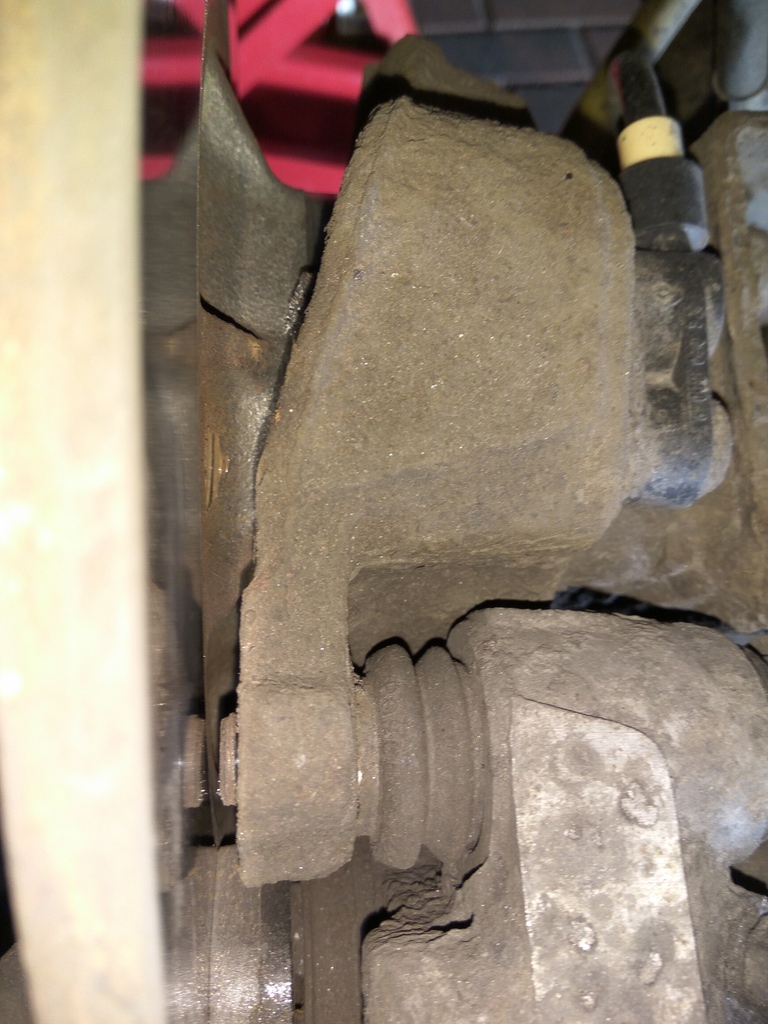

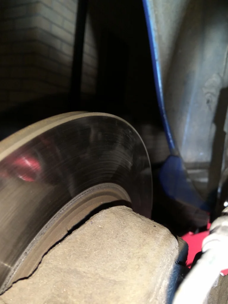

After taking the wheel off and looking around i noticed that the caliper bolt was now touching the back of the disc.
Tried taking pictures, but as it was around 10pm, the darkness made it difficult.
Rear of disc:

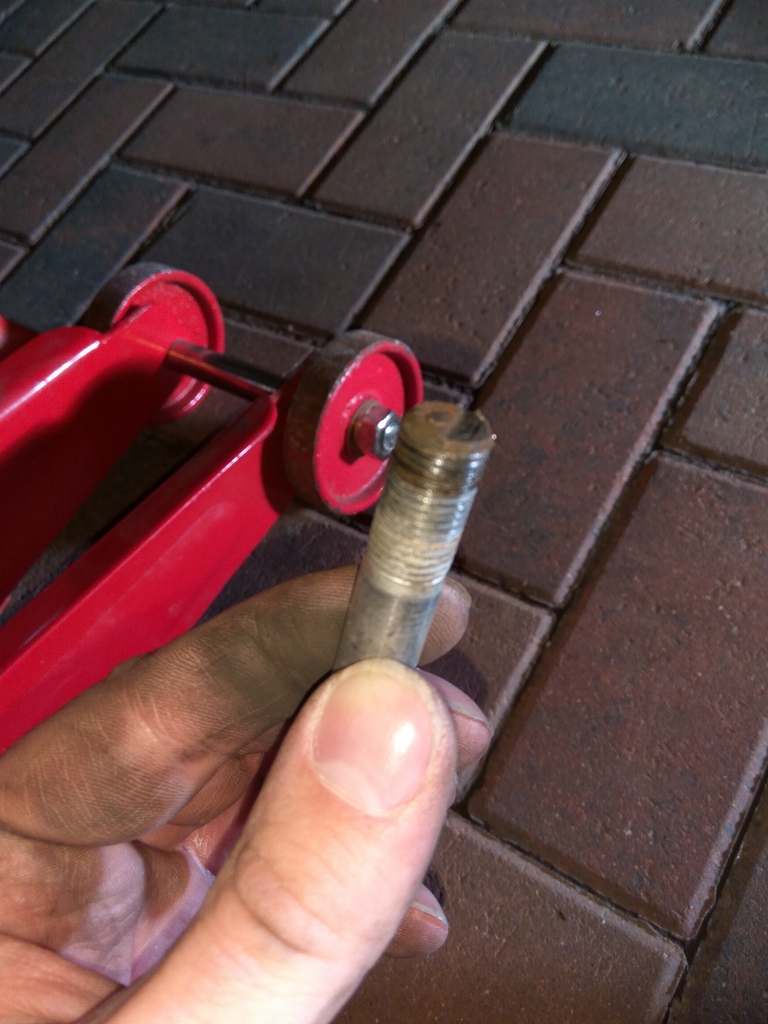

End of caliper bolt:
I managed to find a couple of washer (taken of my squat rack/cage), that spaced the bolt back about 1mm.
However i'm lost to explain how this could have happened, and whether there is a problem somewhere else causing this that i need to look into. Anyone got any ideas?

The wheel/disc, still turns freely and smoothly now the bolts are out the way.
The strangest thing is that it's been fine for over 2 weeks, then all of a sudden it started rubbing last night. The only thing that has changed in that time is that i had a full set of tyres fitted on saturday morning, though i'm struggling to think of why that would change anything.

Check that the bearing circlip hasn't popped and allowed the rotor to move. I had this happen to me when I had a bearing replaced and the circlip wasn't set in the groove properly, car drove fine with no issues for weeks until the circlip finally popped.
TBH if they were genuine rotors I would be surprised as I thought they came with the bearings prefitted iirc? But you never know...
