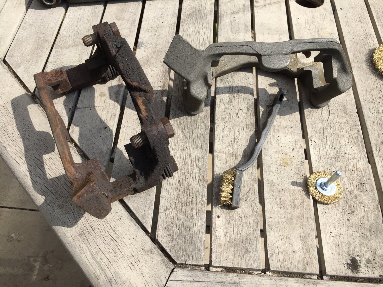

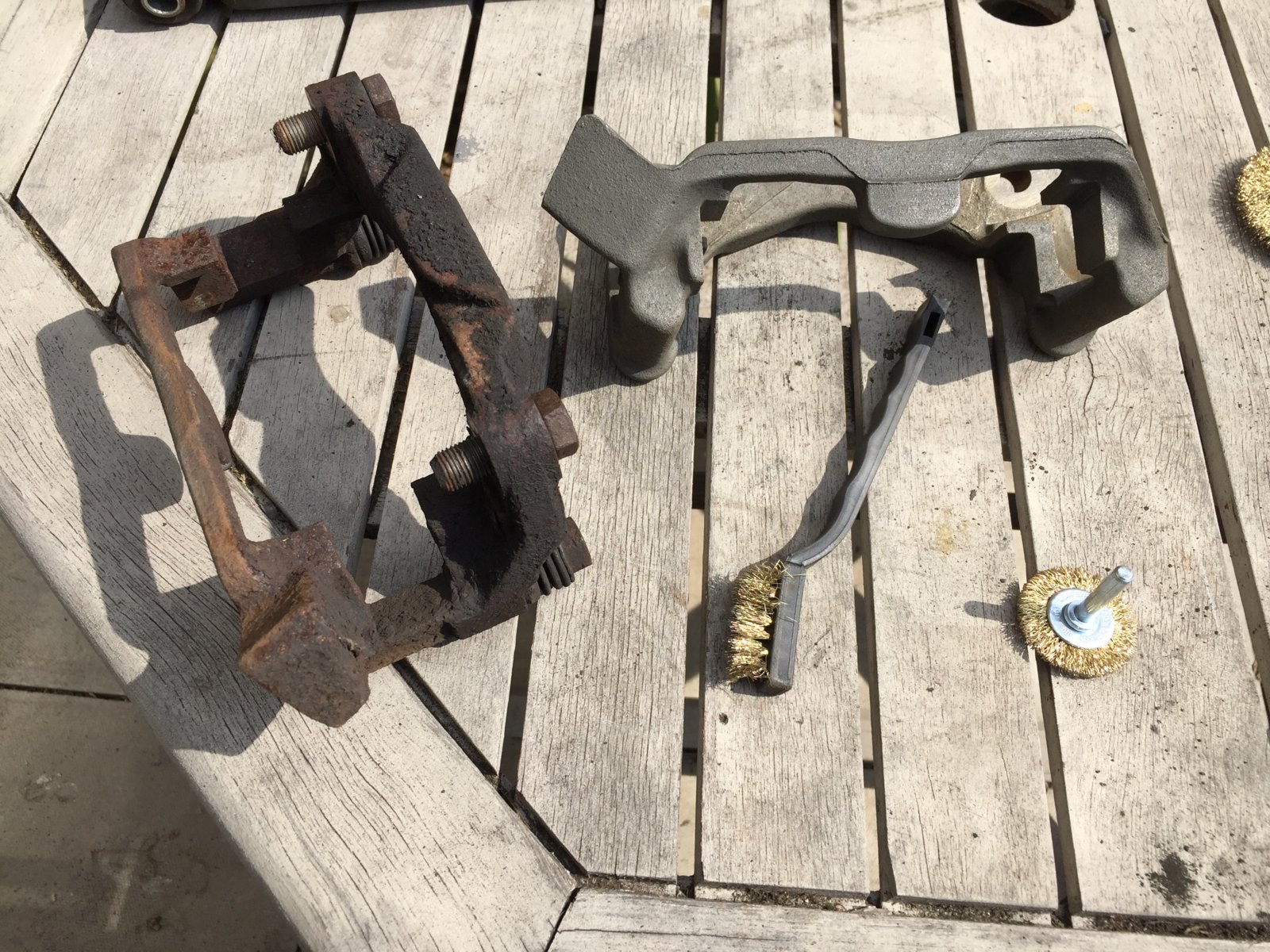

This is a before & after of the carriers @Sidnancy. Serious time has been spent on wire brush/ wheel & a long bath of detox c.... bolts seem ok just need a good scrub & I’ll grab some Loctite to be on the safe side. Will swap for new bolts later this year but need to get the car back off stands quickly as working out of a parking space & need to keep moving the car annoyingly. Thanks for the responses so far.
Looking good! Thanks for the pics!
