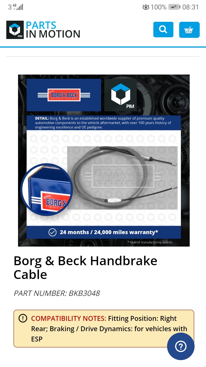

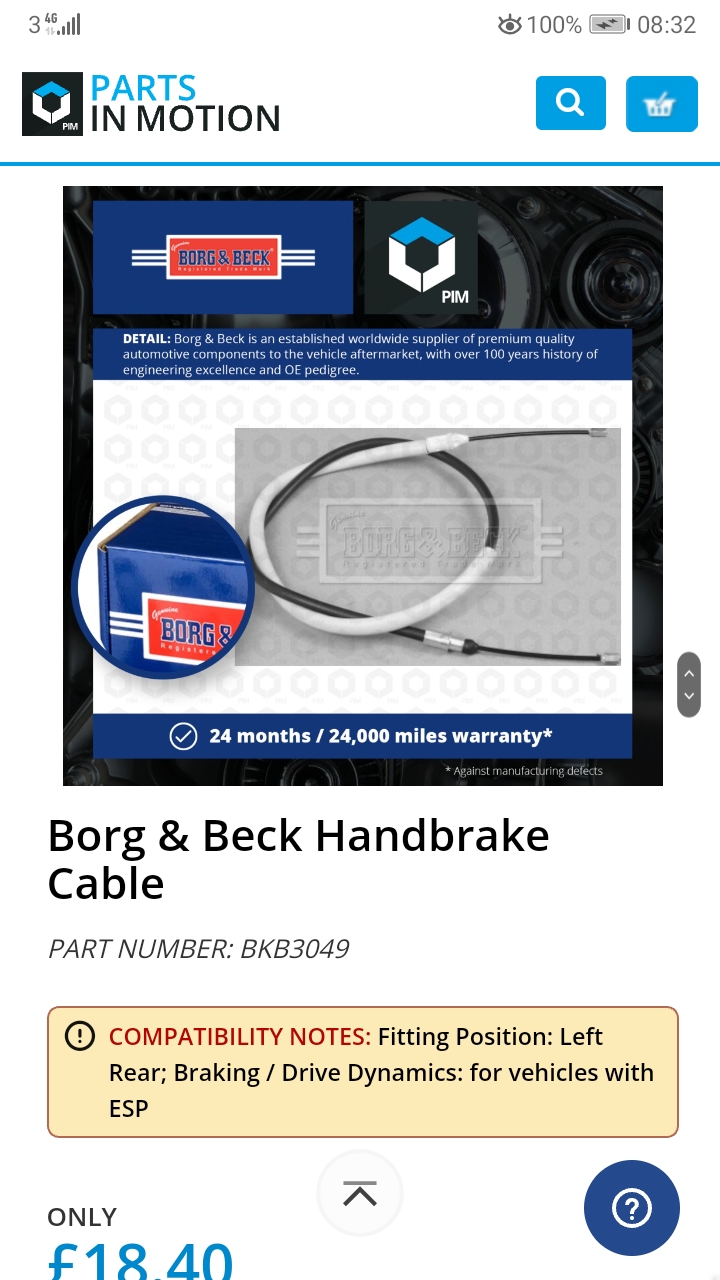

I haven't started on the handbrake cables yet (had to cut one to get the caliper off). Any suggestions?

MRBILLYUK
  FF Jeden Osiem Dwa
