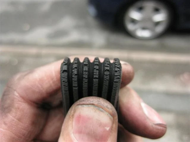

I've just changed mine @ 33k and its been changed before i had it, so its had 2 aux belts on along with a cambelt. 51 plate btw
Glad i did change it look at the state of it. Make sure its been done mate :S

did it myself with loads of help from a friend, just bought the belt as the full kit got replaced at 5yrs so it cost me £20 for the belt from renault
I wouldnt have said so, you do have to know what your doing. If it wasnt for my friend being a mechanic and having the knowledge then I wouldnt have tried it alone.
Not so much of a big job its just the engine is so tightly in the little shell that thingshave to come out to make room headlights etc..
