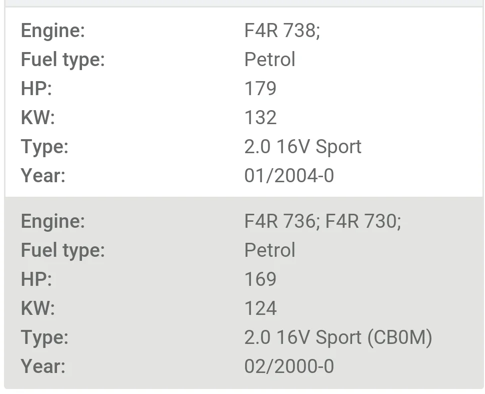

I need to replace all my followers and having looked on Trodo's website, they have INA finger followers but for the engine code CBOM which I believe is the phase one engine.
They're quoting (amongst many others) as fitting these F4R engines. One is the 182 and the other a phase 1 172
Now these are significantly cheaper than I've found elsewhere, but I wanted to confirm with those in the know, that these will indeed fit my phase two.....or not as the case may be!
The INA part number is: Finger Follower, engine timing INA 422 0009 10
Cheers!
They’re all the same mate in the 1*2 and 197/200.
Make sure you definitely use INA ones as well.

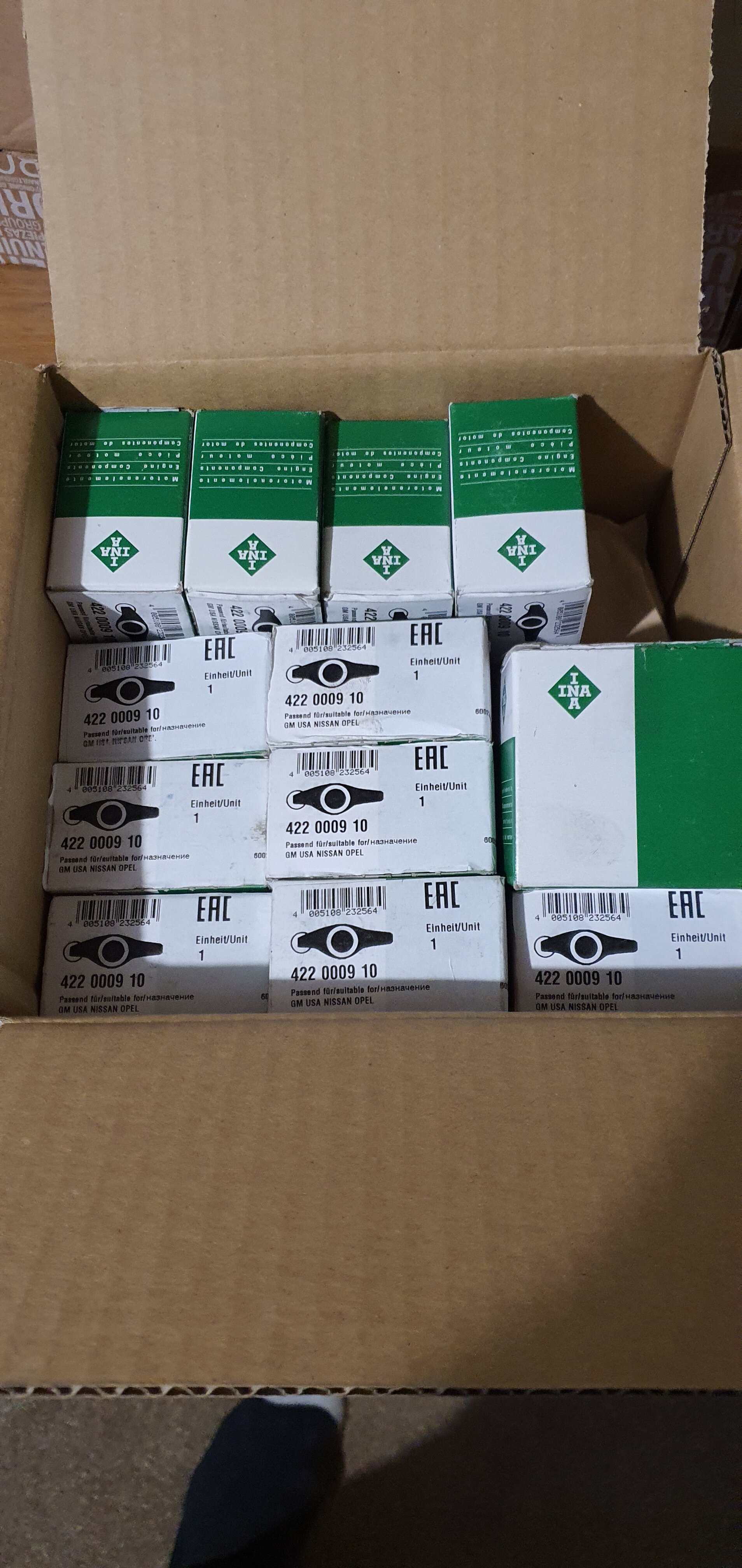

16 INA roller finger followers arrived today from Trodos in Latvia.
Genuine INA. In the uk I was looking £200+
These were £76 delivered!
Second time I've used them now and defo recommended 👌
