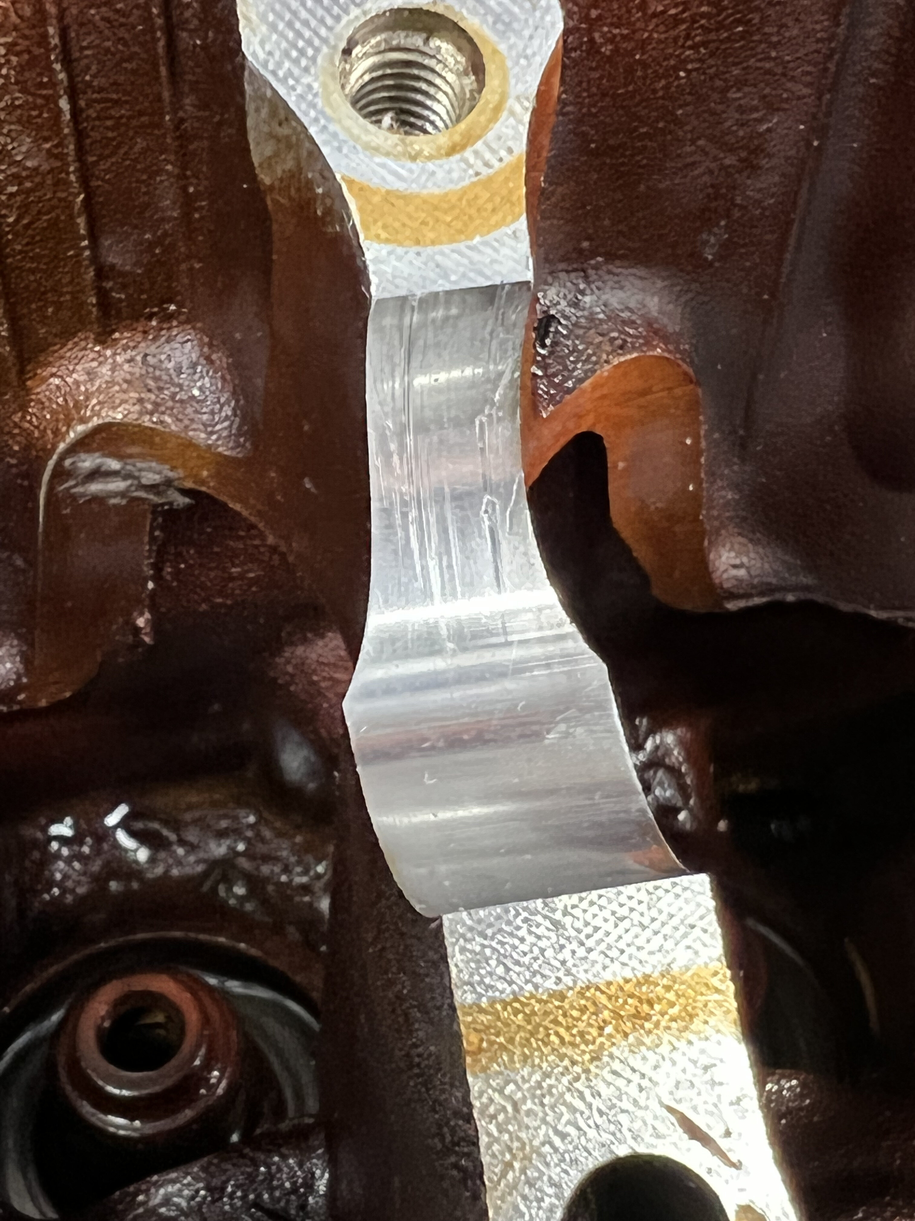

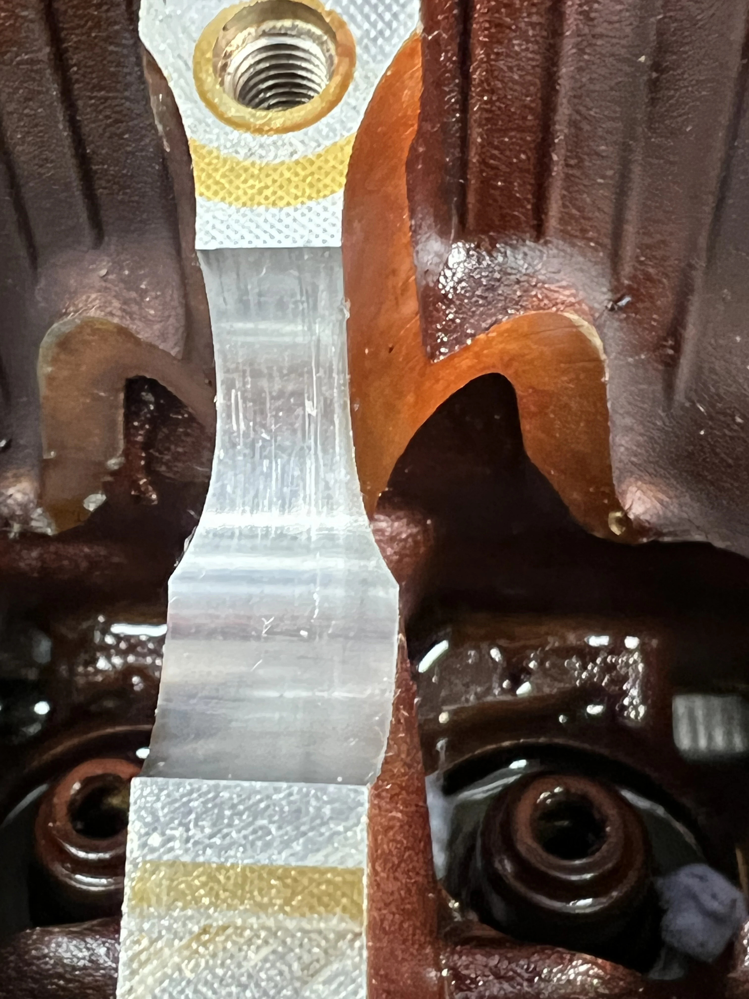

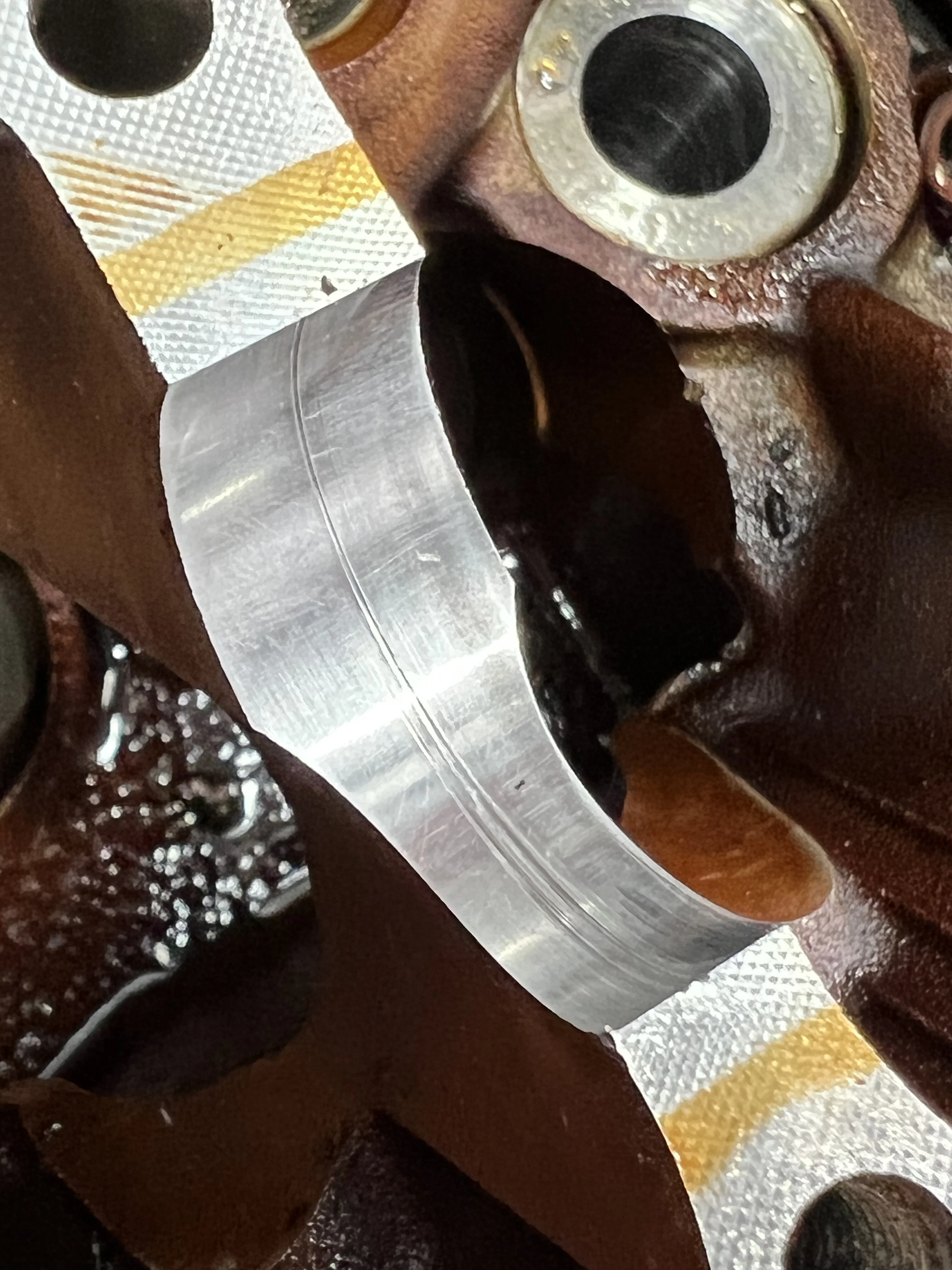

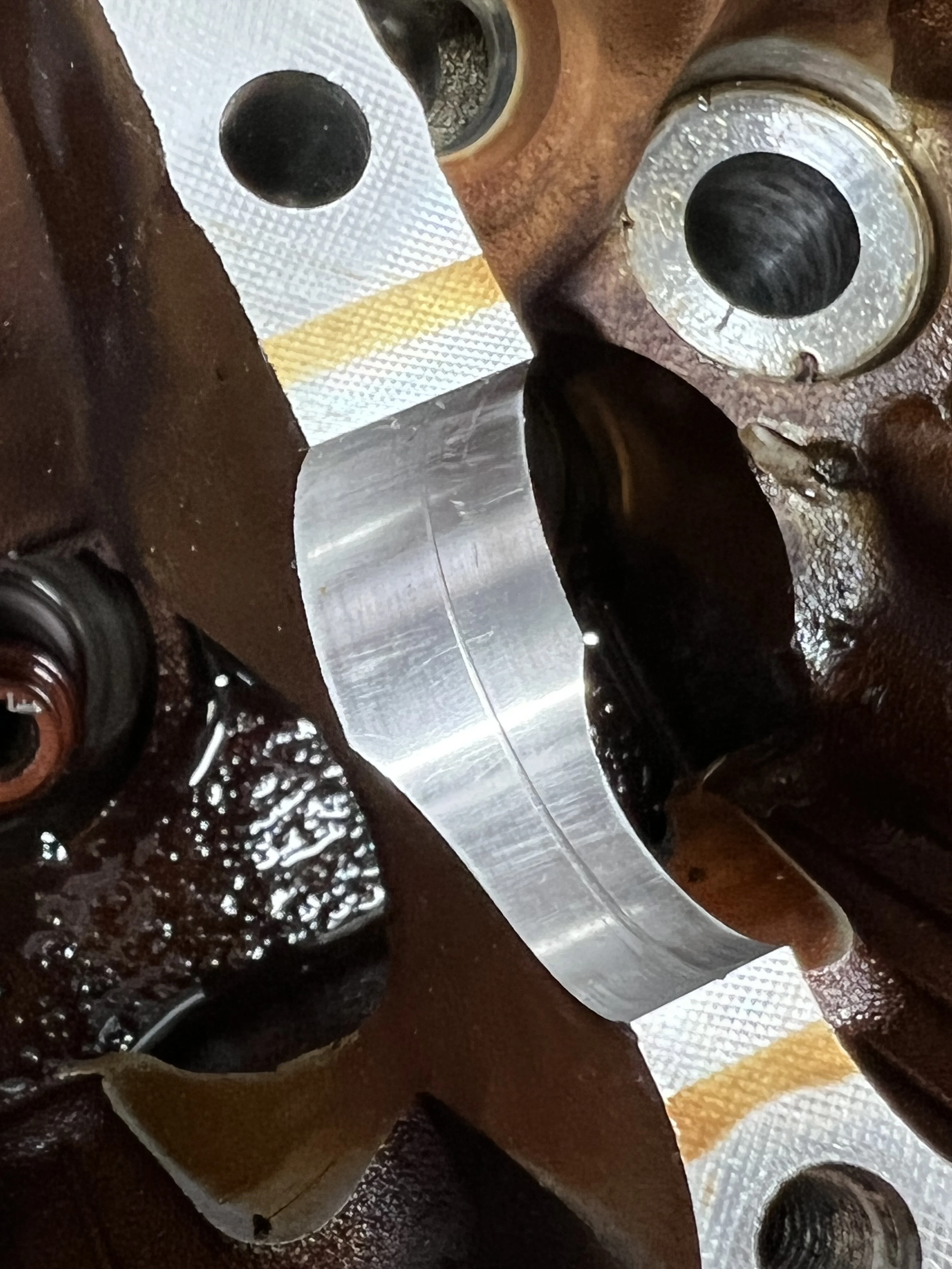

Rather than hijack the other thread, is it worth taking off the high spots and using this head again, or is it scrap?
Inlet Side
Exhaust Side
Thats nothing on the grand scale of things. Could take the high spots off if your fussy, id prob just send it as is.
Only need to be real fussy if its going to be a mega money high rpm build.
Though i was being a little over the top, its just being rebuilt for road really. Thanks!
They almost do you know! Maybe i need to worry about where all the others have gone in the other journals then🤣
They almost look like machined grooves for oil lubrication 😅
