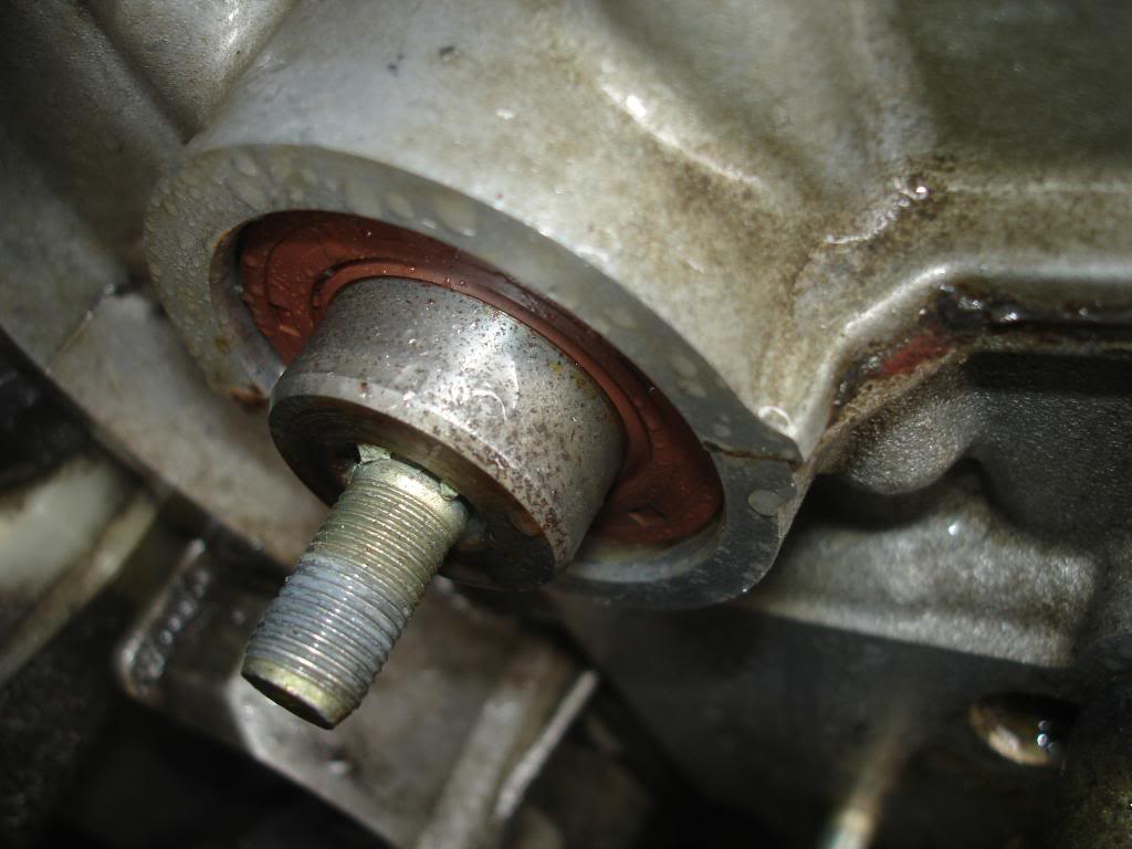

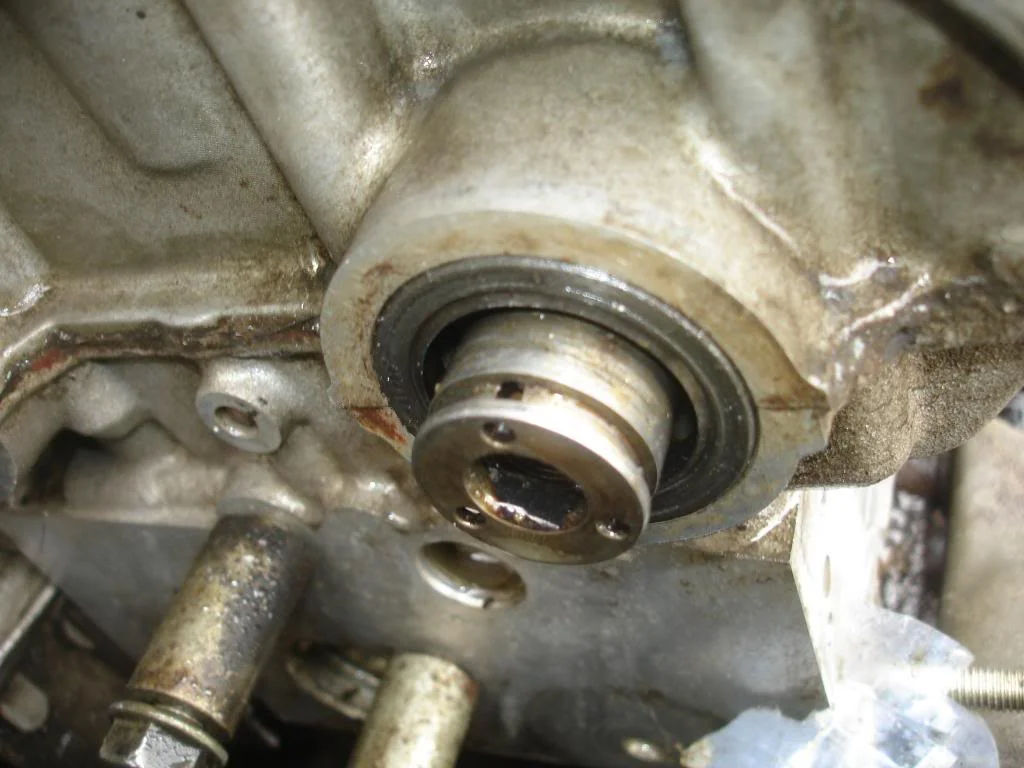

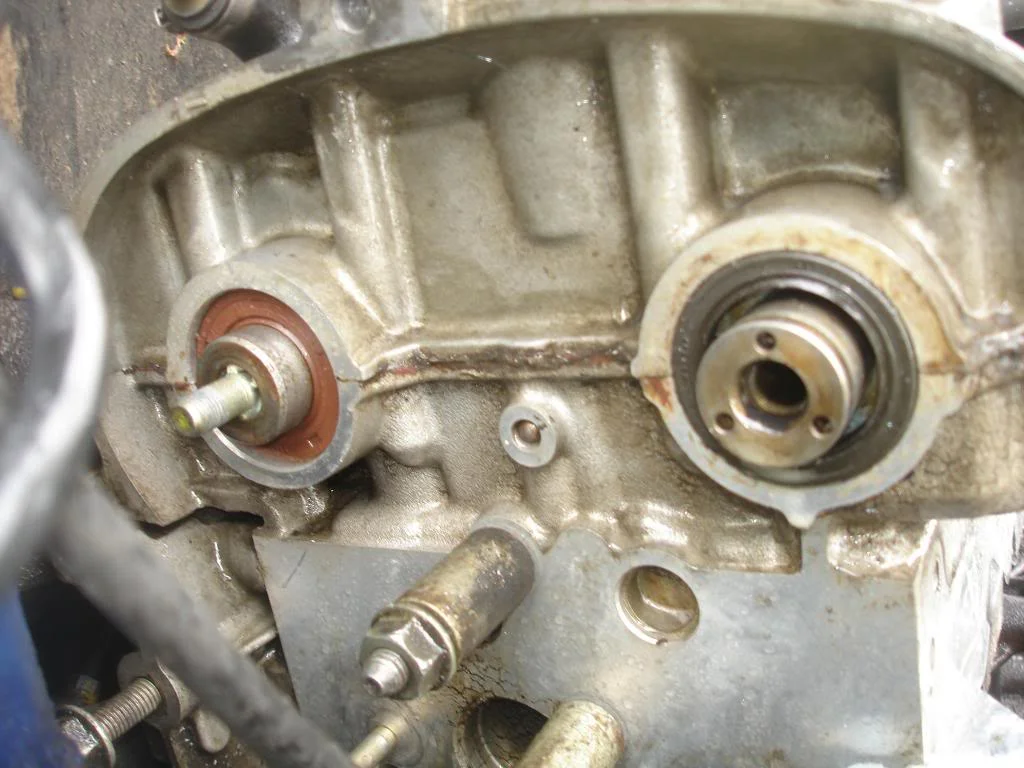

Hi i was wondering if any one could shed some light on the exact fitting of the cam seals, this is 3rd time lucky hopefully as they keep leaking,:mad:
i realise that the ends of the cams still nead cleaning as thease pics are the old seals but i cant see how else they would fit as i no the way they were the first time i tried was def not right,

Mine all came out with the seal face flush or slightly inset from the outer face so yours too far in and too far out. Grease them too on the running face and make sure they are correct by checking the inlet one on the back of the dephaser prior to fitting.
I'm guessing that the engine has sat for a good time or the cams themselves have sat for a while, they look to have rust spots on, good rub up with a Brillo pad will help.

rocker cover fitted and torqued FIRST, then push the seals in so they are flush with the outer face of the head, not pushed in like on your exhaust cam! Tip - use the back of the crank pulley as a pushing tool ;)

The exhaust seal isnt fussy, can fit flush or be pushed in, it shouldnt leak what position its in as long as its not hanging out the head. The inlet seal can sit slightly pround, it certainly wont hurt, worst case is when the dephaser pulley is tightened it will push the seal in to where it needs to sit.
